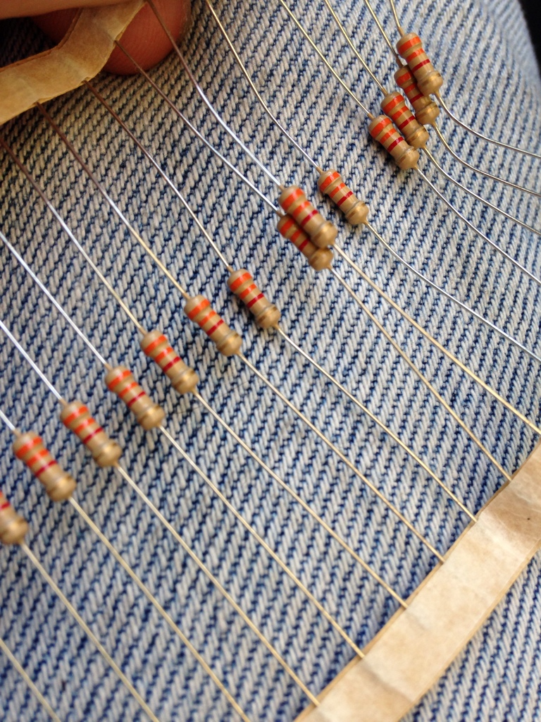

These are the resistors I'm using?
I don't think so as the standard seats where in it when I had it? But there's a thin black cable that just has tape on the end so maybe it was? They are cream and brown not pink and brown, maybe I'm getting a loose connection in the plugs due to the thin wire on the resistor
