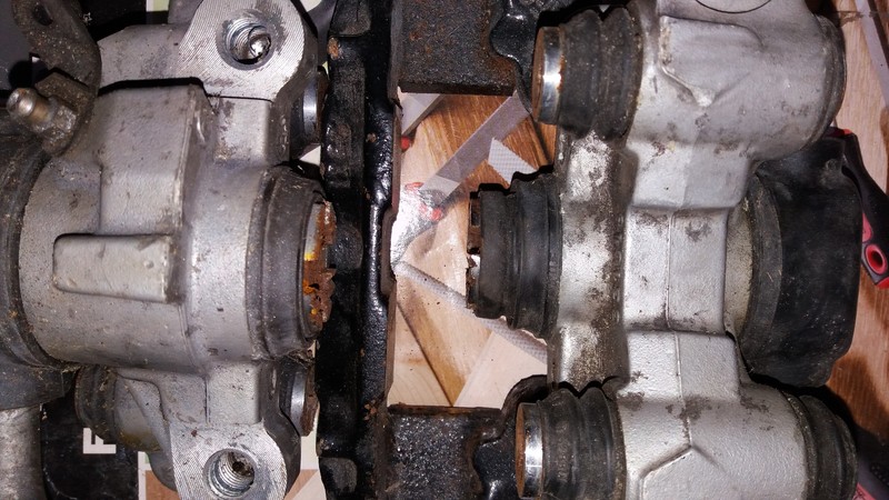

Take it off and start again . The pistons way too far out . Get that wound back in , bolt the pad carrier on first then put the pads in . If the piston is wound in fully you should have no problem getting the pads in . If you can't get the piston back in far enough you'll never get it back together. I always wind the piston in as far as it will go , which is almost flush with the dust cover/ gaitor.
I've just been into my shed a took a pic for you . The caliper on the left is fully wound in , how you want it to get your pads in easily , the one on the right is more or less fully wound out . There's about 1cm difference , and there lies your problem.

Praise the lord, sorted finally thanks to your help :up:
Took all of 10mins once I opened the bleed valve! Why I don't know but it made it dead easy once that was opened.
