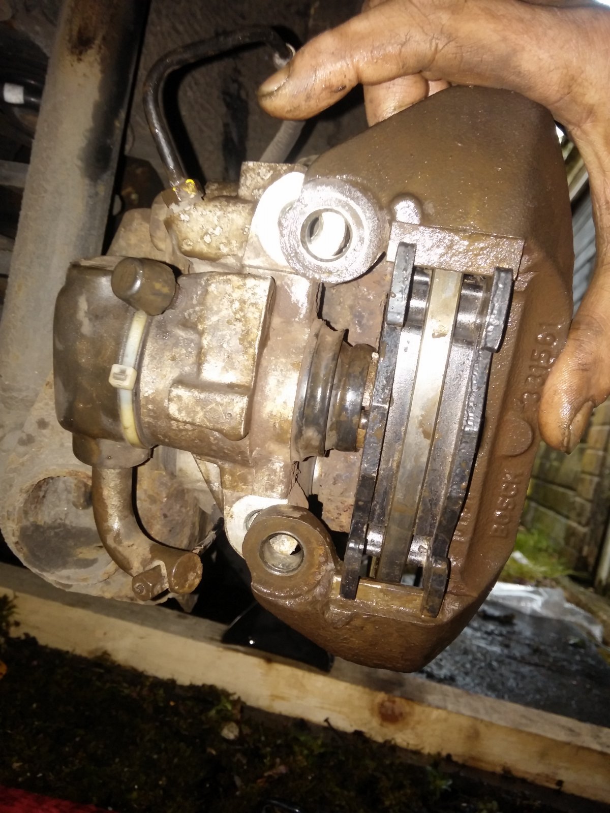

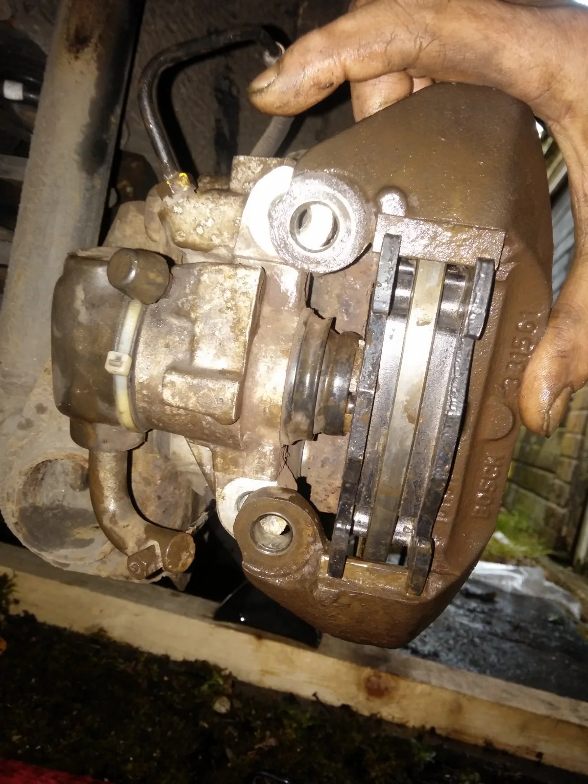

This is as close as I get! wound the piston in, slotted in one pad into the groove both pads fitted then no chance bolting it up - I have slid the caliper as much as I could won't budge anymore

Yeah that piston doesn't look wound back enough.
Actually, do you have a pic of just the disc. Because even if you wind the calliper back, the disc looks too far outboard to allow the calliper back into position.

Well it won't go back no more lads, screwing it clockwise with a screwdriver whilst doing my best to put pressure on the piston but it just spins and spins.

Well it should be going back anyway, so that's what you need to address.

That piston is out miles, are you using a rewind tool on it or anything?
Crack the bleed nipple then try winding it back in.

The pistons out hell of a long way , as stated by others . Did you wind it out that far yourself ? On the back of the piston is a threaded hole that screws onto a thead bar that operates the handbrake mechanism . If you completely unscrewed it you'll probably struggle to get it to screw back on . You'd be better off taking the whole caliper off and working on it on the bench pulling the handbrake lever as you do and you might get it to screw back on again .

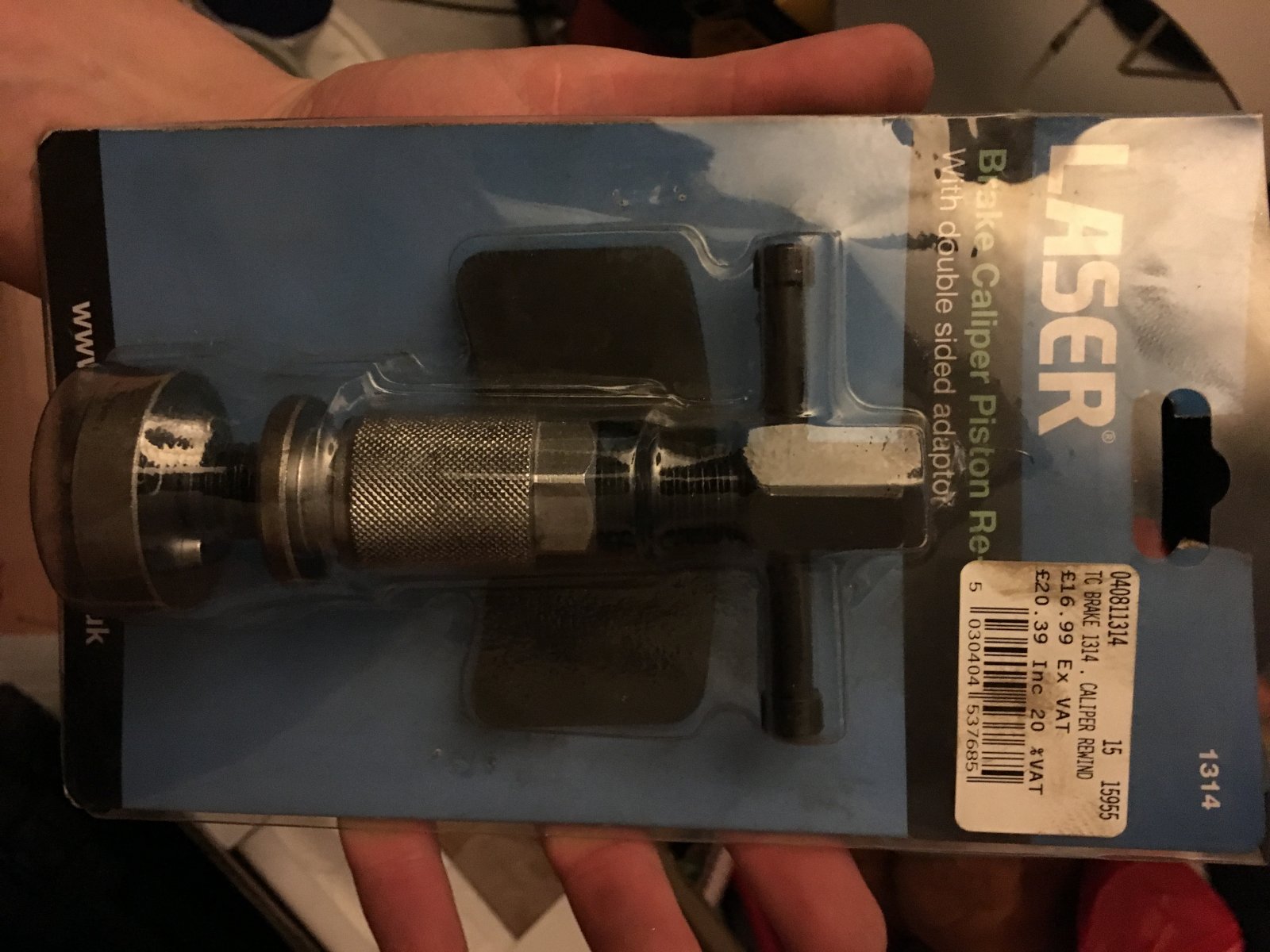

That's perfect. That's what I have. If it's tight. Get a breaker bar in the calliper and a long as f**k ratchet on the rewind tool
I've just realised I can't get to Eurocarparts because... 😞 luckily Machine Mart is a walk away! is that the correct one? noticed they do a left and right hand one.
Knuckles
ClioSport Admin
Here's mine. It looks to have a different part number to the one you linked.
I can't imagine Renault changed the handing of the calipers from the 182 to the 197 though
Leo182
  Blk/Gld 182 Cupped
You'll need the right hand one i.e. clockwise.
Even though it state, Suitable for applications with Citroen, Ford and Renault vehicles.
It's a faff this, going to let a Mechanic pull my pants down next time hassle hassle hassle 😧
You can buy that in halfords. It is £32 though, unless you have a trade card.
Jesus, don't want to spend that!
JamesBryan
  Titanium 182
Some Renaults are left hand wind back. Some Meganes and Lagunas i think.
