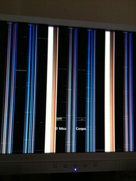

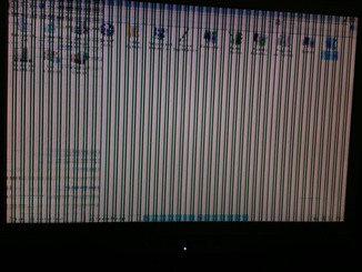

I was on the PC yesterday, just doing the usual thing (no not that)
When the computer just reset and the screen went crazy
Now it will only load in safe mode and I can't see a thing.
I done a search and updated drivers, restored to last point and given the inside a good clean but nothing.
Any ideas?

If it was operating normally with the lines, I'd say graphics card, but the fact it now won't go beyond safe mode, I'm not sure.
Graphics card would still be first port of call for me though, then look at motherboard
