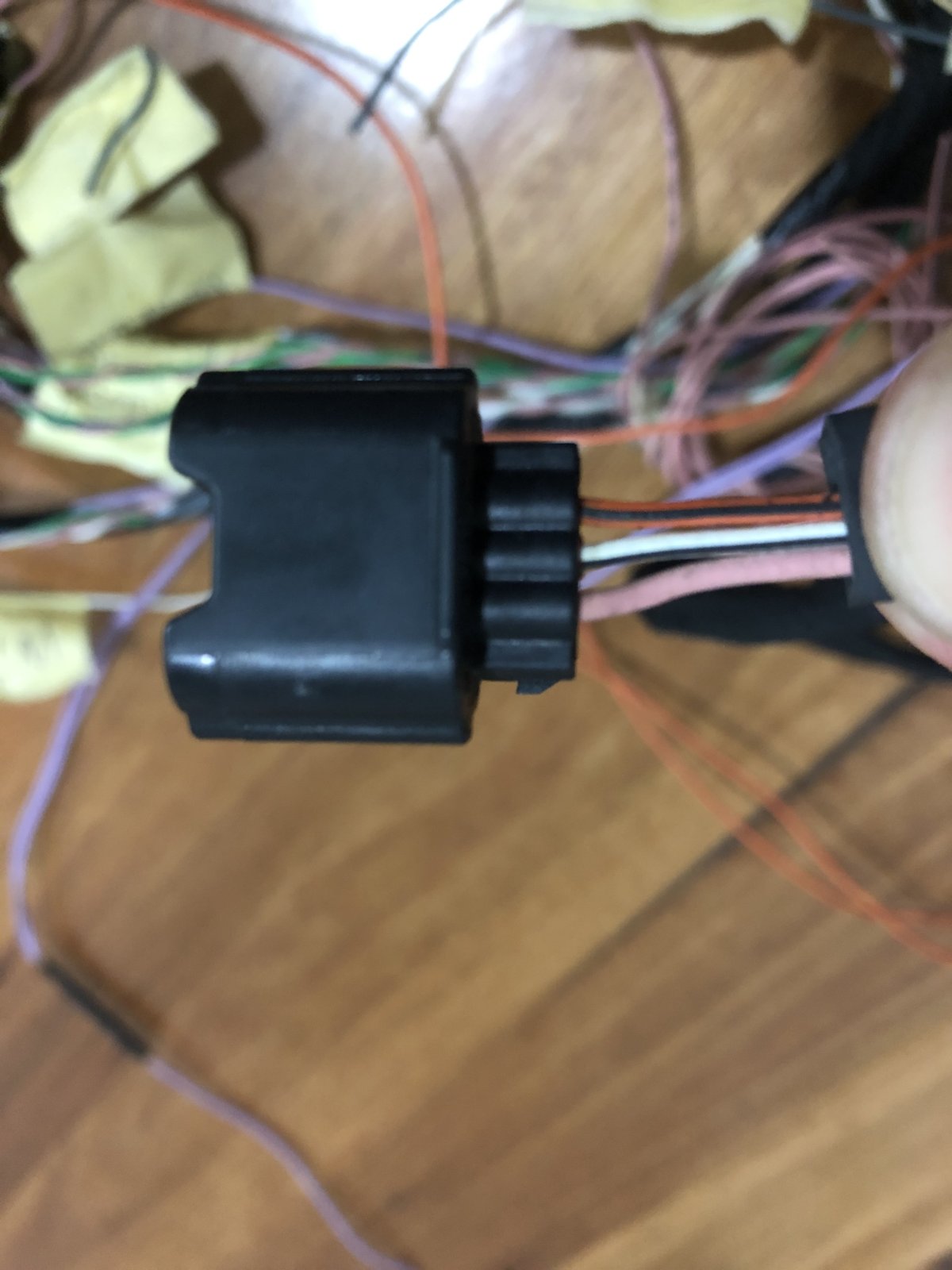

I’m in Australia and struggling big time with a cam sensor issue on a hybrid 172/200 build.
I am trying to confirm wiring and corresponding voltages for a late model Clio 3 RS 200 cam sensor pictured below.
I know the pink wire is a 12+ supply.
There is a black/white wire and an orange/black.
I’m trying to confirm which wire is the signal wire and which is the analogue ground in a stock vehicle.
Also if the sensor wire puts out an earth trigger or is a +12v pulse output. Most importantly if this signal wire should show no voltage when ignition is on or if it sees a small voltage ie +5v from the ECU?
If anyone knows or can check I would be very grateful!

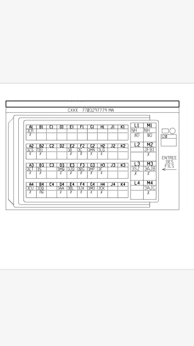

Yes F1 is the signal wire - I’d like to confirm which wire that relates to on the 3 wire plug at the cam sensor.
I have the following:
E2 - earth
F1 - signal
L3 - 5v supply
Looking at your picture above, the black and white wire (middle wire in the plug) should be the signal, so F1.
Just going through my wiring diagrams now that I did when I carried out the conversion.
