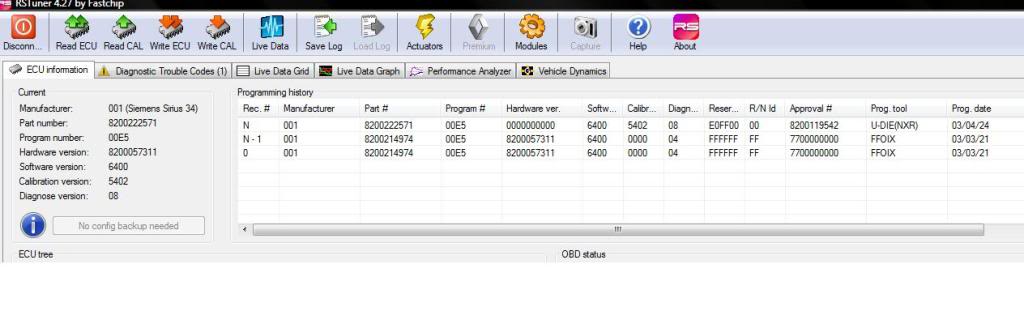

Here is the info from my car
Is the below link the correct one for my car? Is it a cal or a full ecu flash I need to do?

Ok, So I think I need the below...
[TABLE="width: 100%"]
[TR="class: sectiontableentry1, bgcolor: transparent"]
[TD="bgcolor: transparent"]First - 6500_5404_OEM
Second - cal_6500_5404 STG1 RON98_0711
Or this one [h=1]cal 110 6400 1408 RON98 0910[/h]
Do I need the second one? What does the first file do? Will it remap the car at all or does it just update the software.... I have bought the license and the first map is £5 and the second one is £49 so need to make sure I need it before buying it.

Make sure you check your VIN number against the file your downloading first.
New editor won't let me type normal after second link. :mad:
If your VIN number goes something like VF1CB1Nxxxxx then you should be fine with those files.
It is cb1n!

Is [h=1]cal_6500_5404 STG1 RON98_0711 worth the money? There is another one that is only £10?[/h]
Thanks again!
All done, just come back from a blast in the car! It so so so much more responsive lower down! You are right it was worth every penny!
