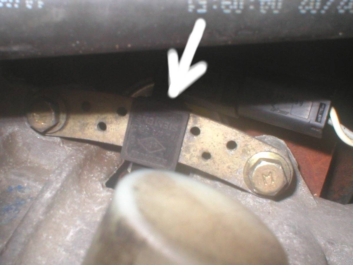

wheres the tdc sensor? il just try both! and yeah it idles at bout 600rpm most of the time, then cuts out when you try to pull out of a junction!

Yeah tried this, the throttle body isnt like it is on a 172, its a stupid plastic box thing! tried cleaning it though. Gunna go to the local scrap yard tomorrow and get a tdc sensor and a coil pack n just try it. Can someone tell me where the tdc sensor is?
It's either on top of the bell housing or on top of the flywheel. Don't know which.
Looks like this.

Yeah that would be great, if you find the problem let me know and if I find it il let you know! I tried to get a coil pack today, no joy! I can get one from Renault through a friend for £45 but I really don't want to spend £45 if it isn't that! Same with the tdc sensor coz that looks like a nightmare to change!!

Low idle and cutting out is almost certainly TDC sensor. Renault have revised them too so there's a bit of loom to alter, nothing major though.
Just had the TDC sensor fitted today and still have the same problem. Will keep you updated. Anyone else have this problem?
