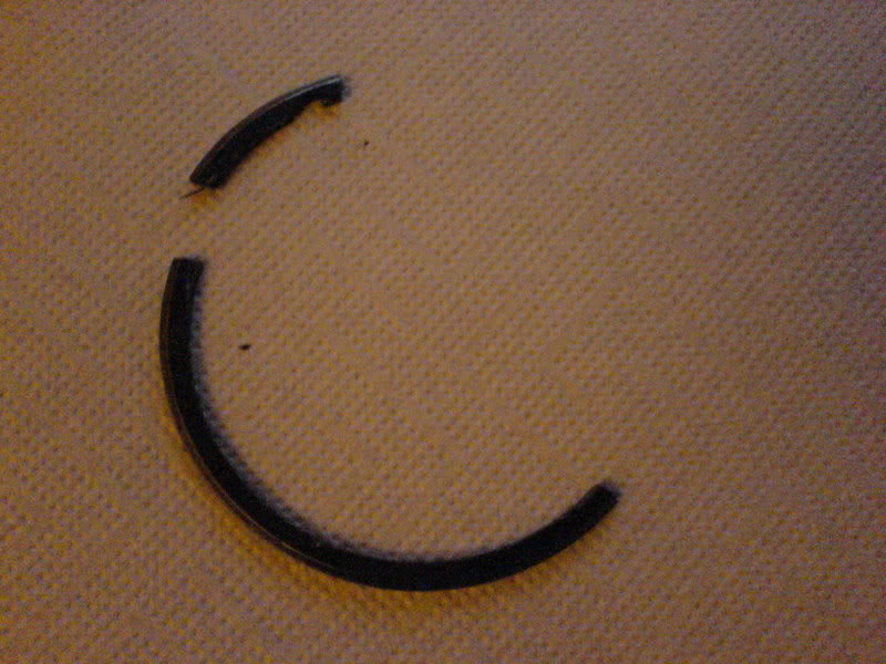

drain the box, whip off the pass wheel remove the shaft and you'll see the diff. circlip will probly be chewed up.
mine looked like this when i had a similar problem:

If it was the diff circlip (what I thought initially) they why can he put into 2nd without the clutch?
If it was the diff circlip then surely he wouldn't be able to put it in gear without the clutch and he'd get speedo drive but no drive to the wheels.
does he have drive in second?
circlip has gone then its like someone has the clutch down all the time (hence being able to roll it in reverse) and speedo doesnt always have drive when the circlip goes. (mine didnt)
only way to tell really is striping down bit by bit.
best thing to do is new clucth and box as if it has gone it will go again.
