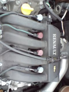

Does anyone know what the small filter is that you can see just at the top left of the pic below??
What does it do and does it do harm not having one.

ha ha,, no you are not, It is the only photo that even vaguely showed it. It is right in the top left, It's a silver topped purple/red(ish) filter that appears to go into the air flow meter, although I could be totally wrong about that. If you see the pic at the top where the wires split before going into the plastic shielding it is just above there to the left.
i would take a pic, but its not there anymore!!
