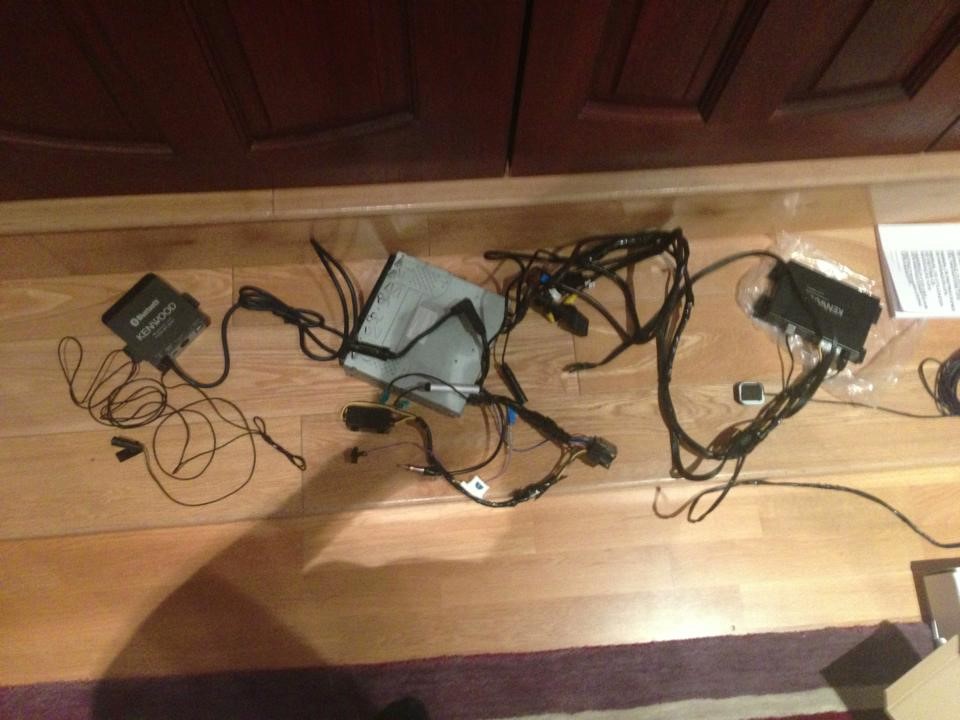

It's a single DIN unit, but that's not really the main problem. No, the main problem is that it has several modules to be attached (Bluetooth, GPS, Stalk adapter) , as well as a GPS antenna + Bluetooth microphone. An iPod cable will be run down past the gear lever too but that's not going to be too hard.
Mainly want to find out where people have hidden stuff, I get that there's (Some!) space between the bottom of the stereo and the heater controls, but are there any other spaces I can wedge stuff into?
Here's the extent of the problem:

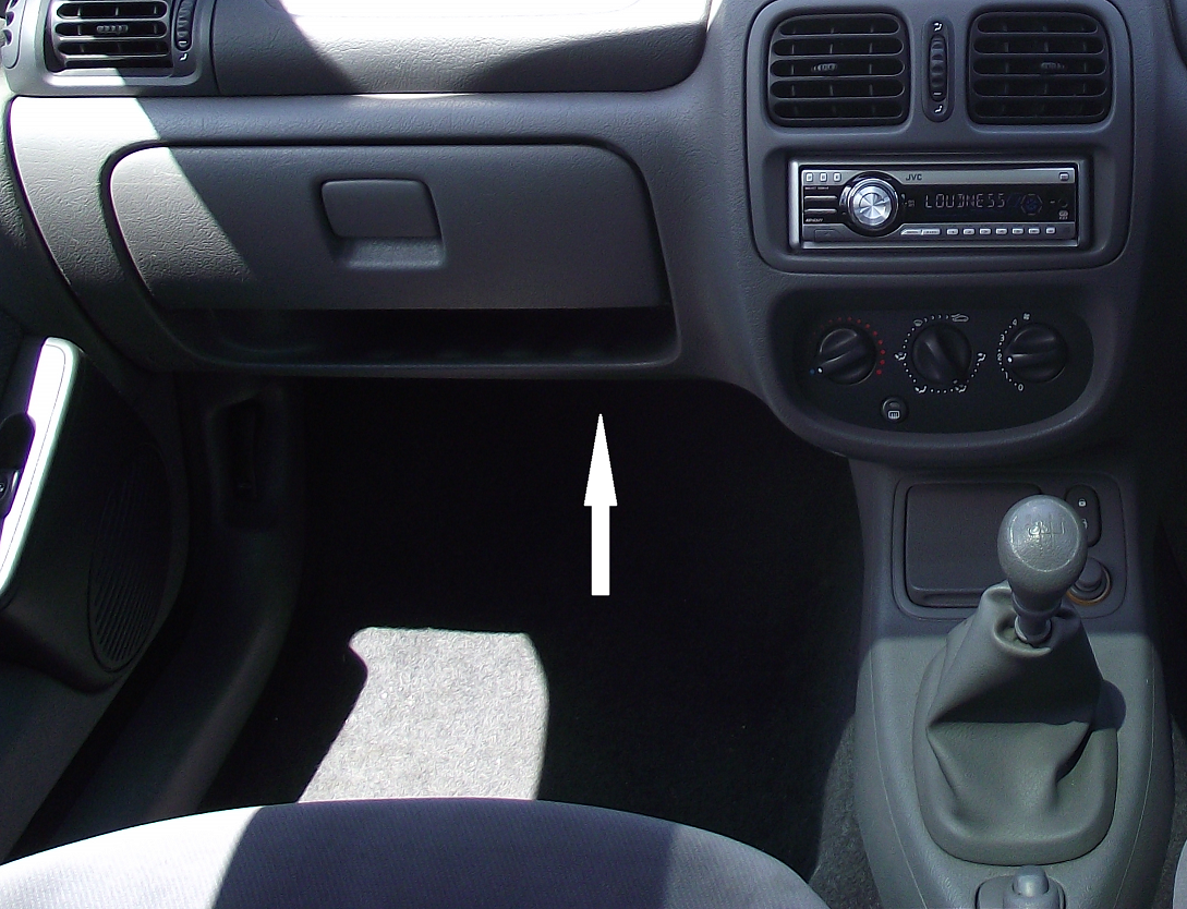

Now the dash top's going to have to come off to run the antenna + mic up the pillars, but I was thinking of putting the extra units in the sort of tray underneath the glovebox, as seen here, and then blank it off somehow.
I had a hard enough time getting just the stalk adapter in with my current stereo so I'd appreciate some suggestions on this one!

You'll be able to find space, there is lots of room behind dashboard, heater controls, etc. Even if you just velcro the units tucked right up in the footwell. Hardest part is making sure all the harnesses are out the way as you slide it back in.
They do however look s**t lol. And looking at your pic, you might have an issue with the screen not being able to pop up fully because the radio looks quite recessed in the surround.
What about up under the passenger footwell near the relays etc? If the cables were long enough, mounted to the underside of the parcel shelf could be good, then run the cables back down the door trims.

Given how easy it is to kick the relays out, I'd be a bit worried about fitting them in the footwells. That said, I would like relatively easy access to the units in order to update them. The cables definitely aren't long enough to reach the parcel shelf though!

I'd Velcro the boxes under the glovebox as already mentioned if the wirings long enough, or behind the centre console / ashtray.
