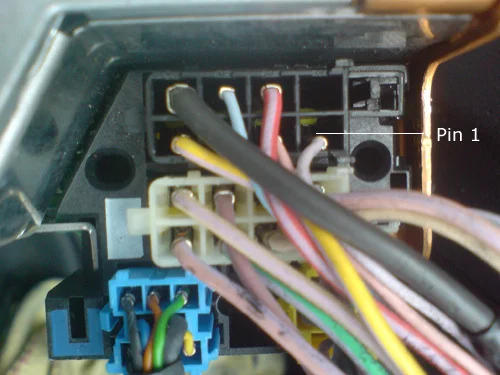

The RCA cables go from the adaptor to the amp and you can pick up the remote from the back of the head unit.
If its the standard Renault head unit, its pin 5 on the connector (the one thats hidden from view) count 1-3-5-7 right to left on that row.
