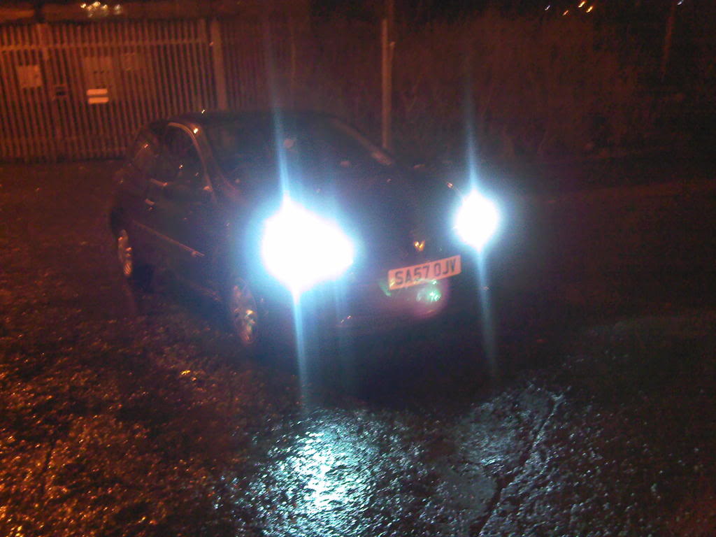

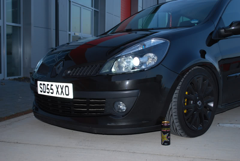

zippo ;) its a tiny pic mate! lol , any bigger pics?
dont wanna goto hassle of getting them, then some police man telling me they are illegal lol :(

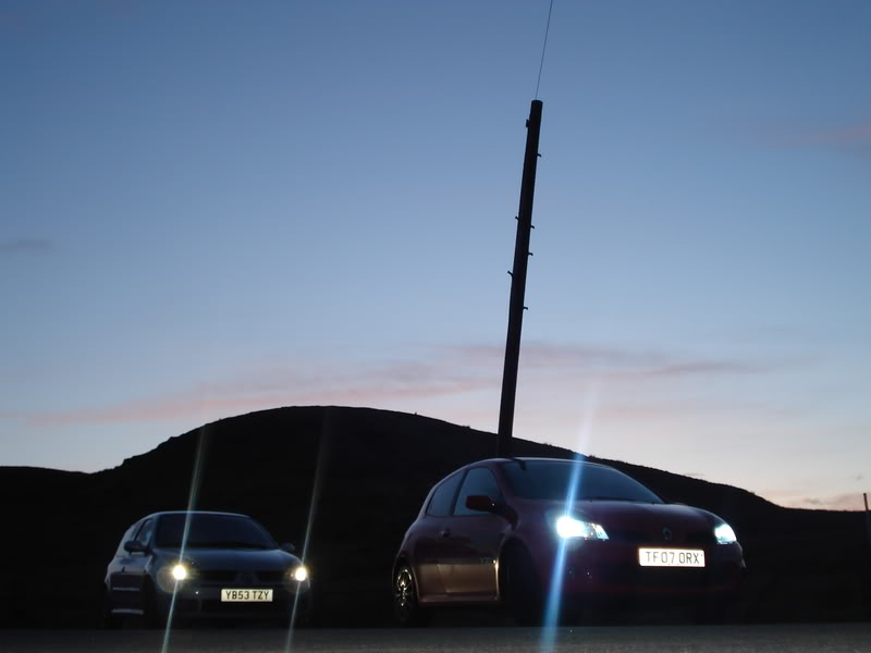

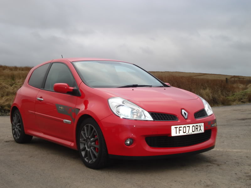

Cheers alan! look bloody brilliant mate! Ordered 8k too! cannot wait now :)
Ill follow the guide on here for bumper removal? take you long mate?
No probs.
I had help from djwjohn from on here mate, he's rather handy with things like that, took around 4 hours in total.
To be fair alan yours looks perfect! Just how I want them too look.

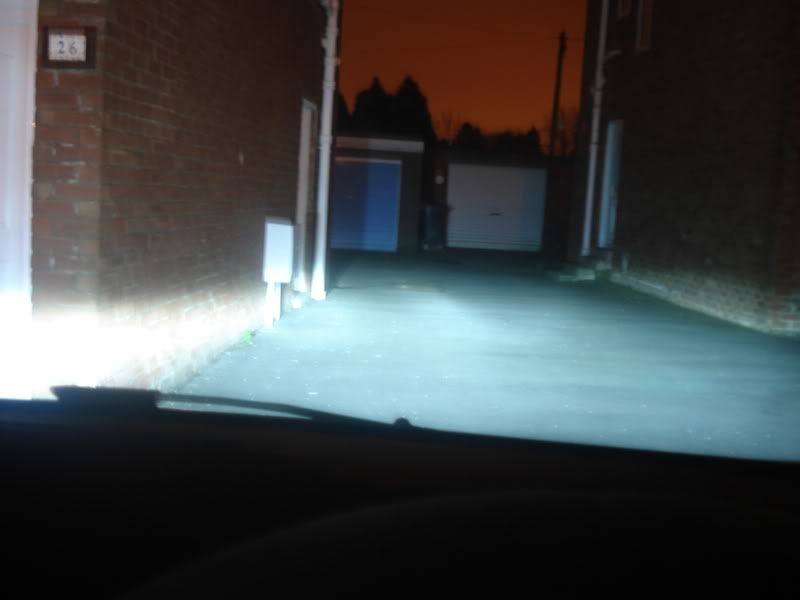

They are illegal but you'll get away with them if you're fitting them to projector lights. However if your clio has projector style lights you'll have HIDs anyway (although other car makes use projectors with halogen bulbs which have a asimilar way of controlling the light). So fitting an HID kit to non-projector lights = blinding lights because of the poor light control (see Zippo's pic!!). There's massive light bleed and no real cut-off so you'll be lighting up motorway bridge signs. If you took a photo of a 182 or 197 with factory HIDs at that angle you'd be able to see them lit up but there'd be no glare (unless took took the photo at the beam height).
