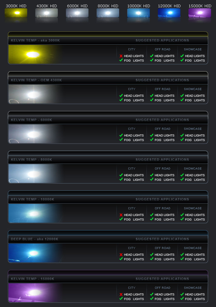

I find this to be a more accurate chart tbh.
As you can see, 6000k is just about right.
