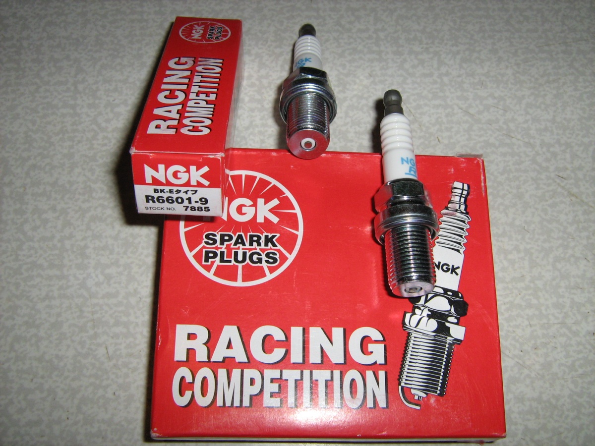

NGK R or NGK R9 is the option whatever grade they are mate.

pic
Yeah if you got it all for cheap no brainer. like you say it's a compelling option anyway really.
Cheers for the plug info Paul, I'll look in to them when I'm back.
