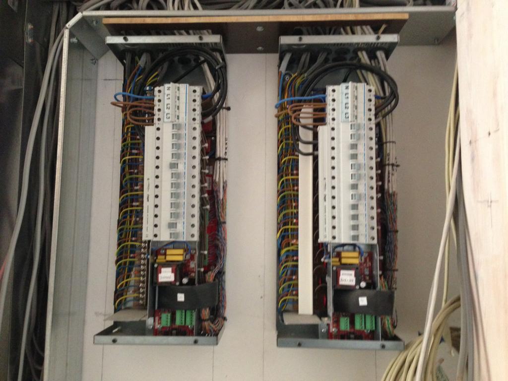

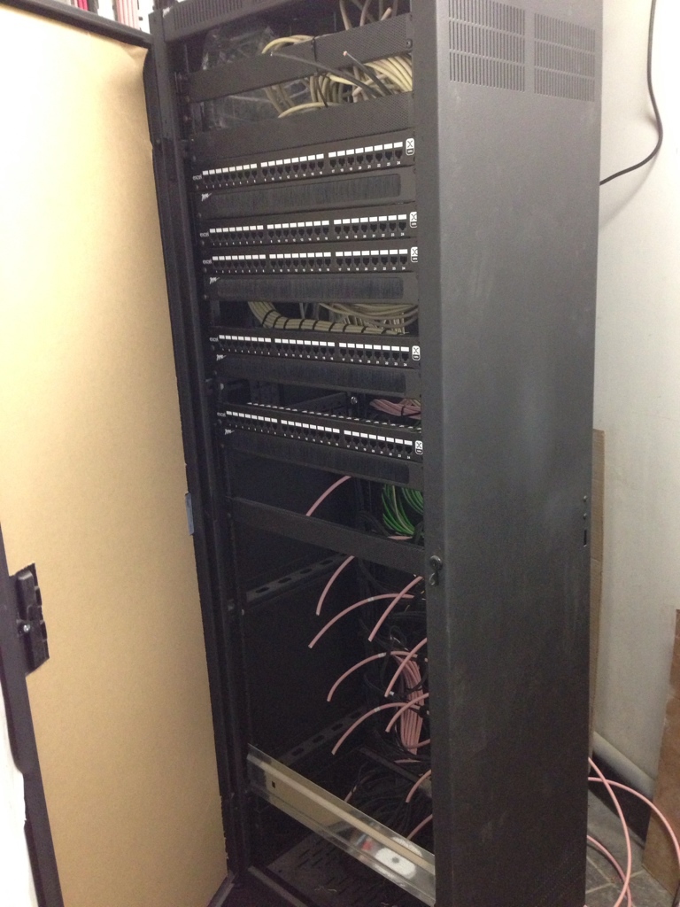

Lighting racks are now all wired up, finding the control loop of cables was a bit of a mission as half the house isn't built yet as the pool room has had to be taken down and rebuilt so there were open cables everywhere. Having found all those now we have our full control loop and keypads have started going on the top two floors.

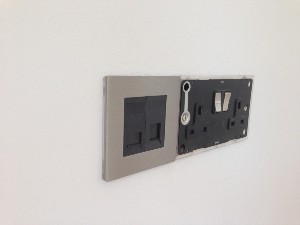

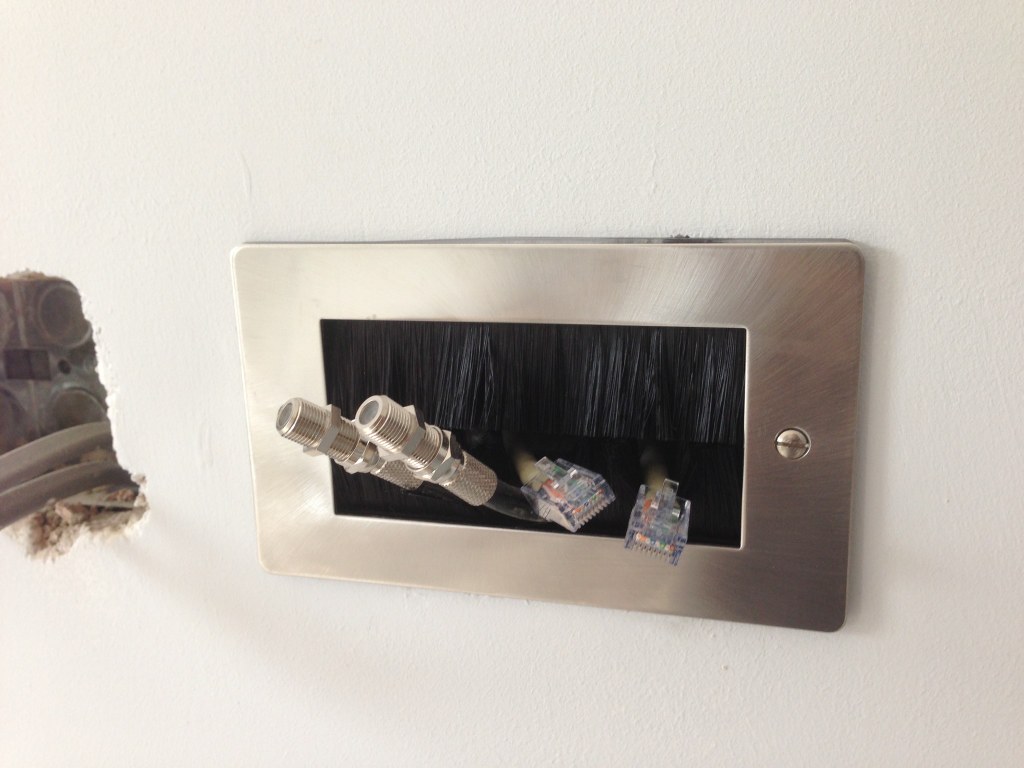

Also been able to terminate plates on the top floors and clean areas on the ground floor. Anywhere where a TV is to be installed we are using a brush plate so cables can come out behind television freely with no kinks or extra joins, the ones below have been pushed into the void!

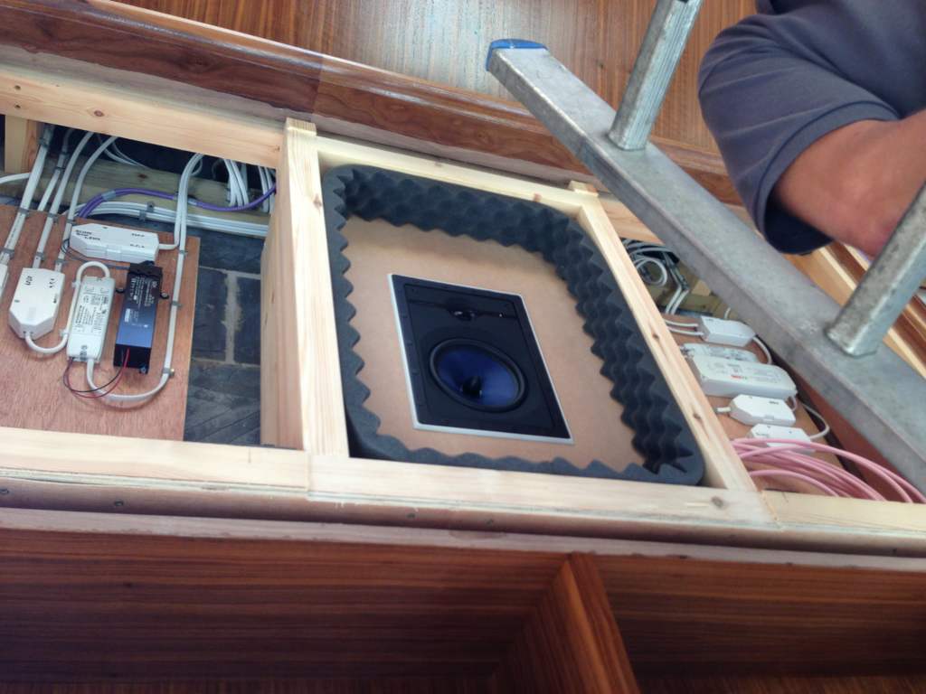

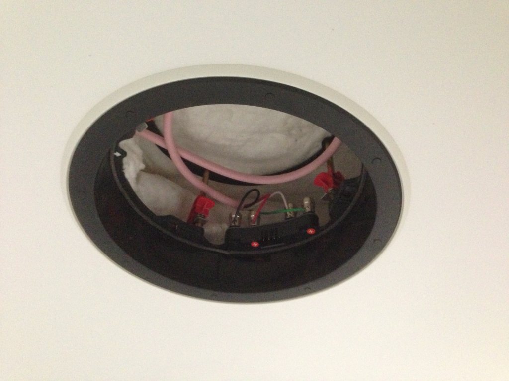

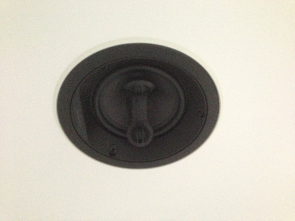

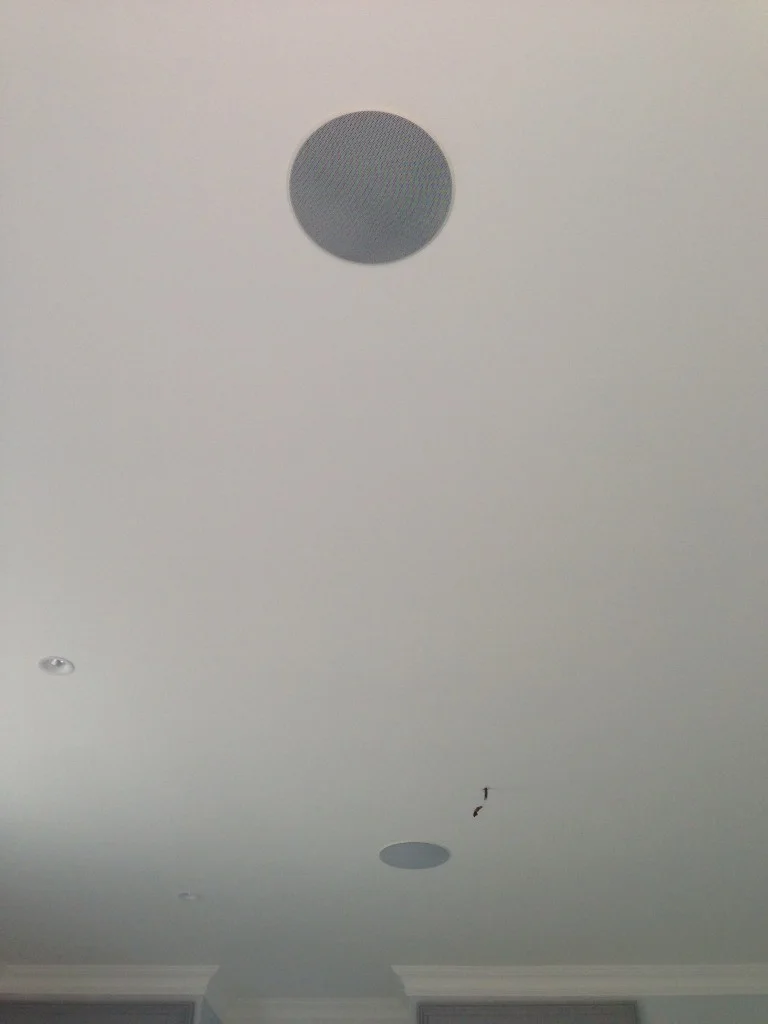

Speakers have also gone in on the top two floors, this is a Bowers & Wilkins CCM664SR speaker which is a stereo speaker in one unit, mainly used for small rooms such as bathrooms. This is the first part and then the speaker is put into the frame.
And then the final look, in a different room, using Bowers & Wilkins CCM663's.
That is as far as I've got with pictures, but most Cat6 terminations have now been done in the rack downstairs, with exception to areas that have no sockets yet due to the rooms being at a different stage, the basement has only just been plastered. We also fitted all the high level CCTV cameras during the week which are now up and running. We're now ahead of ourselves there in all honesty until the place is a little cleaner. Ideally looking to start installing equipment in the first rack so we can get the rest downstairs!

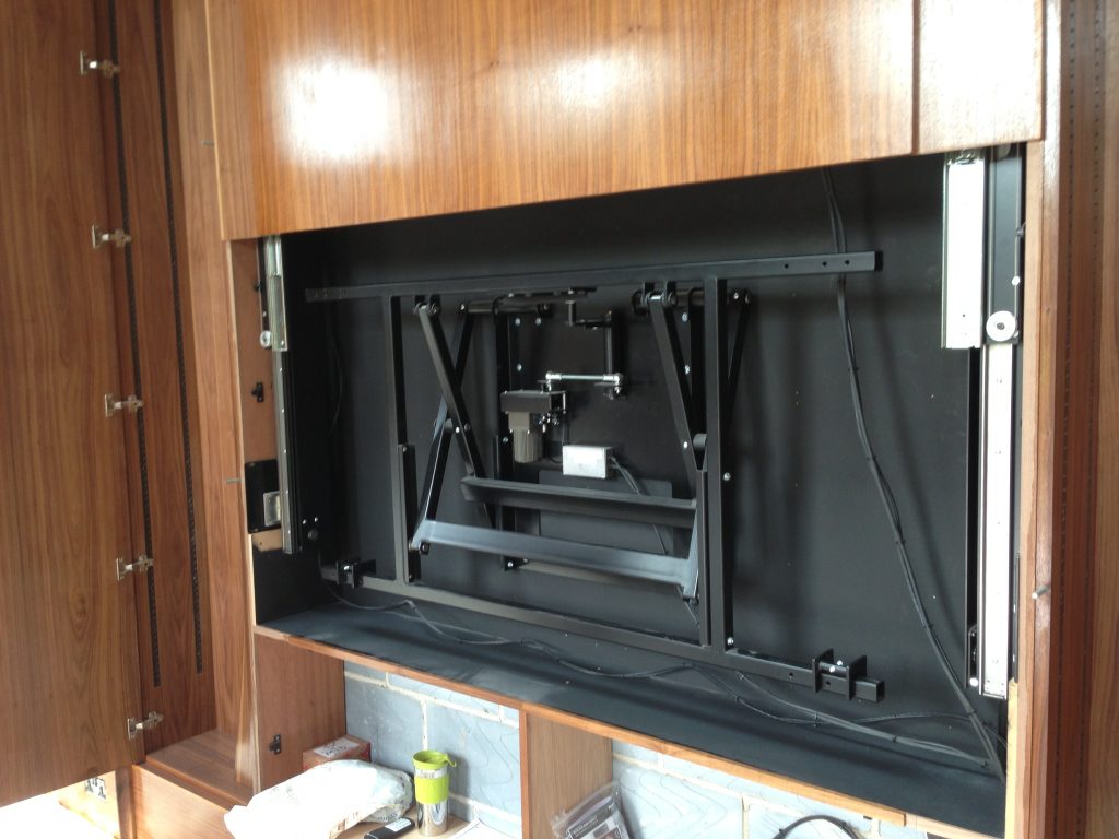

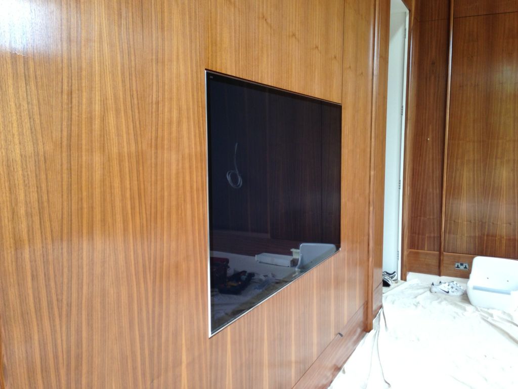

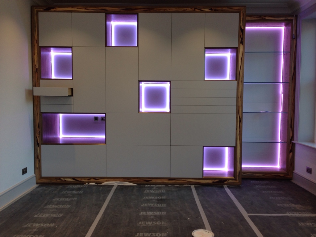

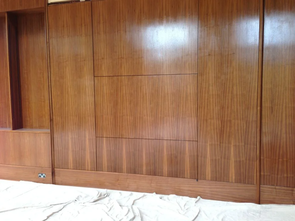

In other jobs recently, this week we fitted a 65" Panasonic plasma into a wall. The wood panel goes backwards and up and then the television moves forward flush with the wall.

Concept is brilliant but wood panelling jesus h :dead: 60s flashback. And I have no doubt how expensive it was.
  182, SQ7, Trafic
The guy is like 70 odd, getting a grasp of the whole room it is a mega room! Dread to think of the cost of it, the guy doing the French polishing was there for a month!
Doesn't look like a 65", deceiving being on a large wall!
First thing we said, the room is about 5m tall with that wall being 3.5ish! Anything smaller would of looked lost.
Where's the sky box etc?
Plant room behind with a data/comms cabinet and AV rack.
We did the speakers yesterday, hidden behind wood panelling with grilles. Didn't get a finished picture.

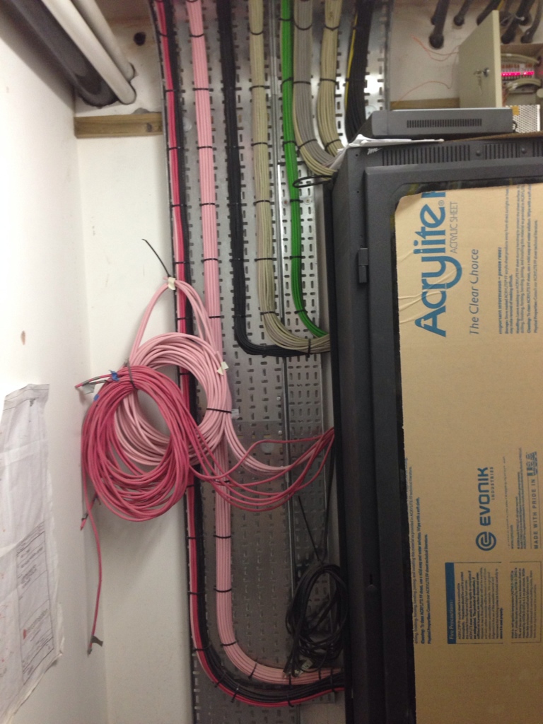

So in September the original builders fell out with the client and work halted for a month. New builders came late October to carry on.
So far outside I've got most PIR's up and all cameras possible, customer had extras wired which we now need to get too.

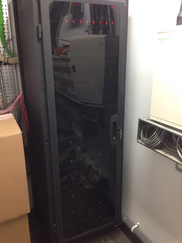

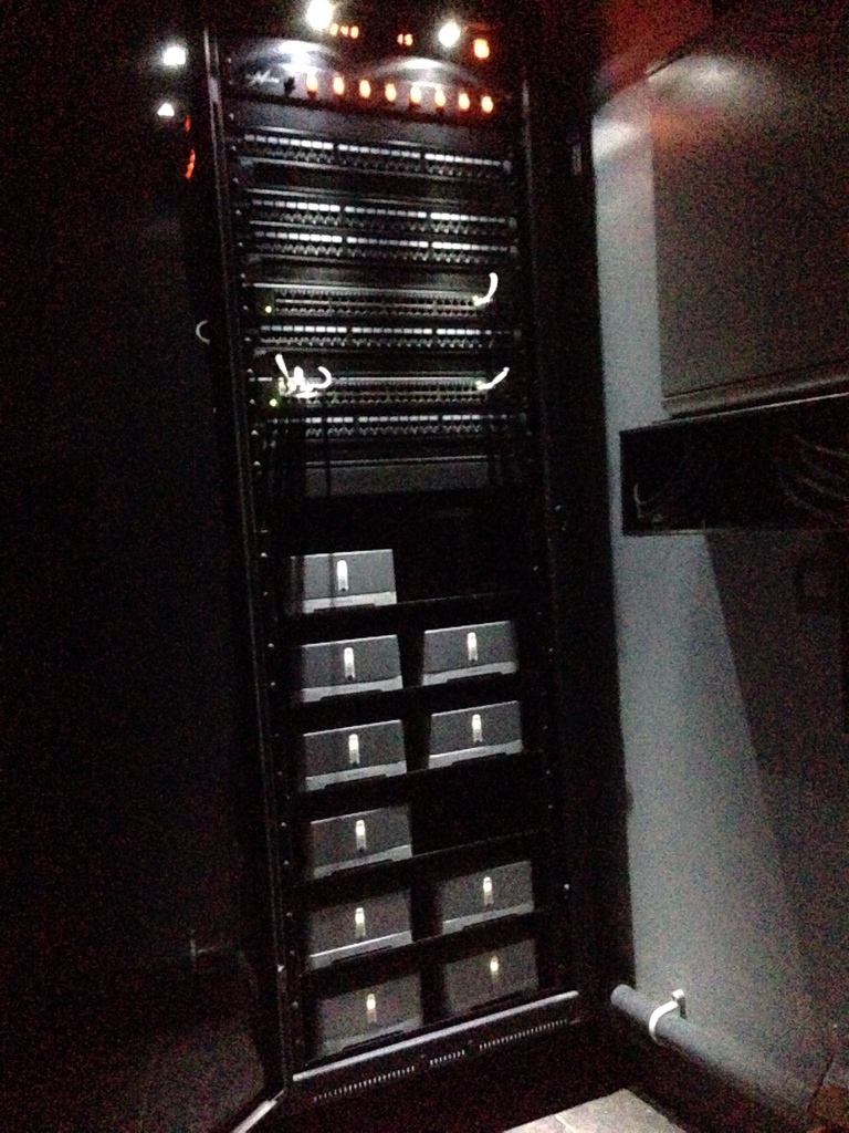

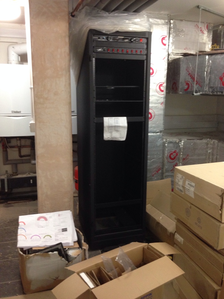

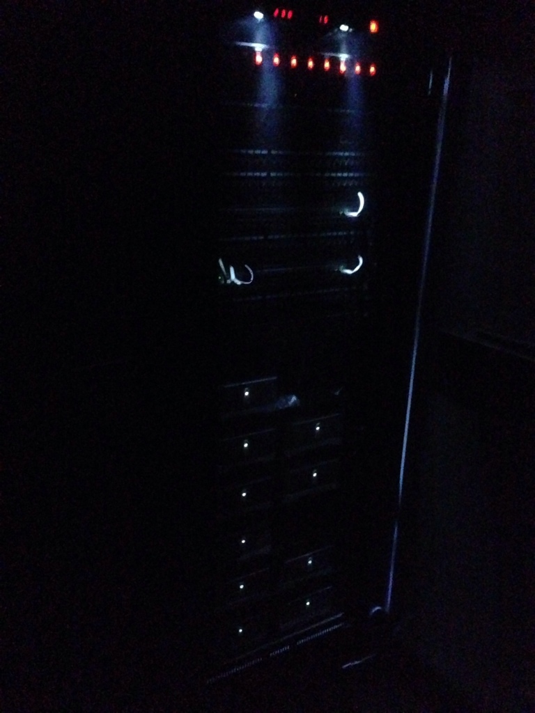

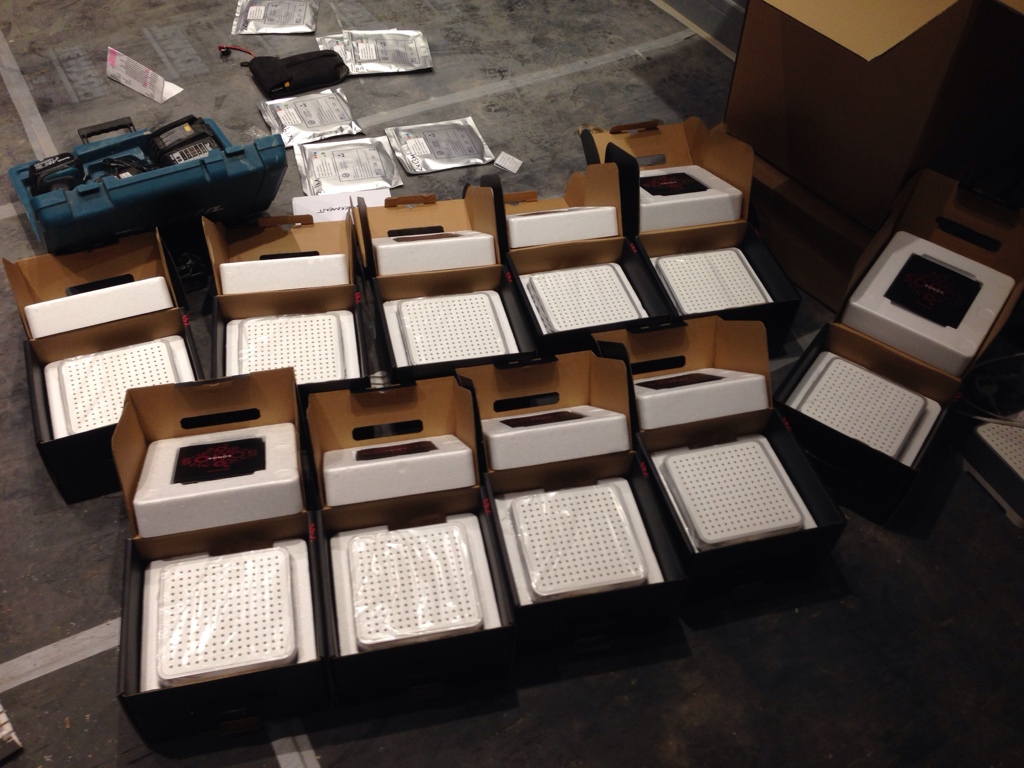

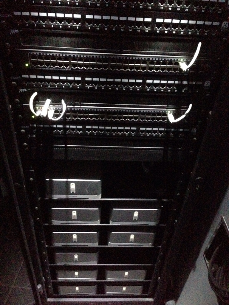

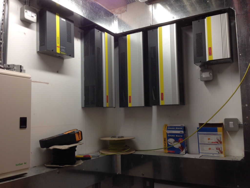

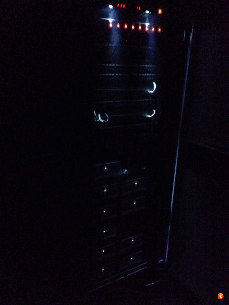

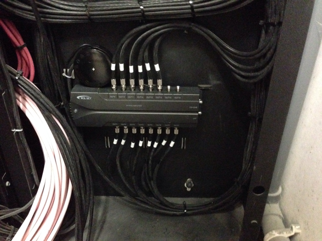

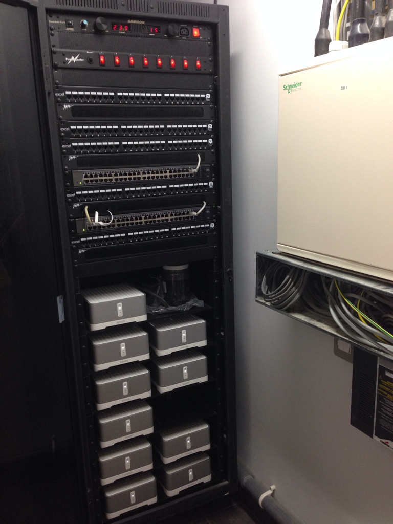

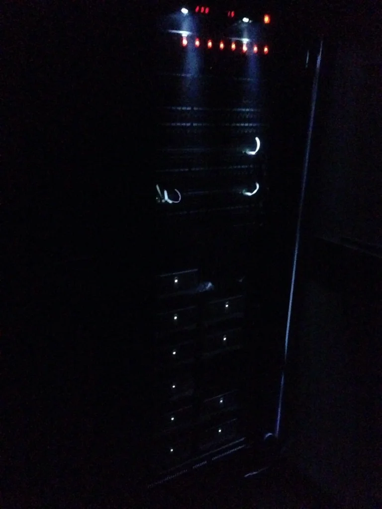

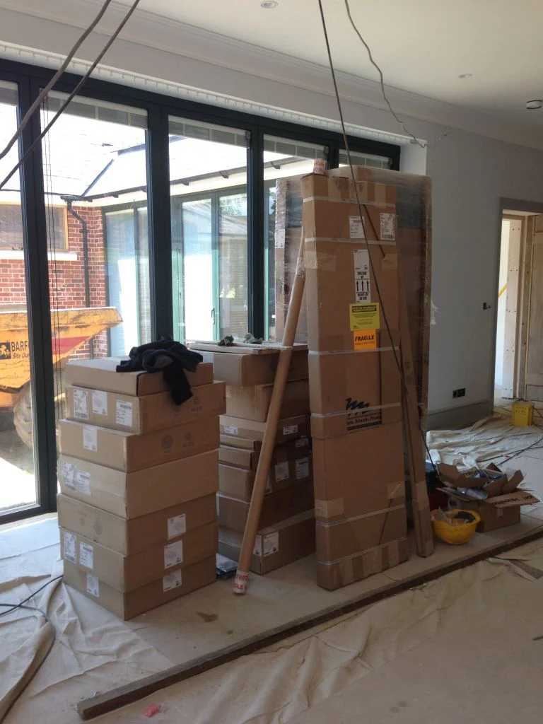

This week I got to get stuck in on the first/right hand rack with data and audio. So along come 10 Sonos Connect:AMPs for the internal zones. Also power distribution and individual switches for each row of Sonos Amps.
Racks also have a couple of heat extraction fans each.

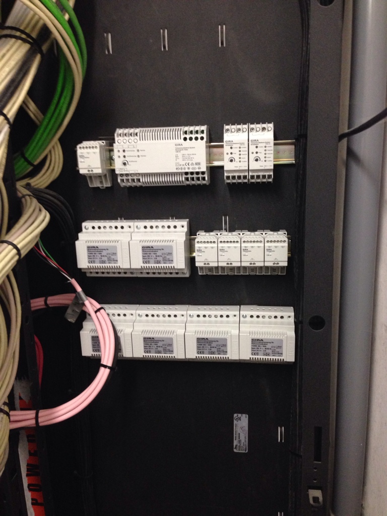

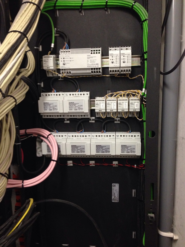

In the back of this rack we have the Gira door entry equipment, TV distribution, satellite distribution and CCTV PSU.
All photos below are ones I've taken in order.
And I can finally start the second rack which is mainly AV for the lounge and cinema room.
Won't be back until next week now, but exciting starting to see it coming together now after 2.5 years ago when we were doing the drawings!
