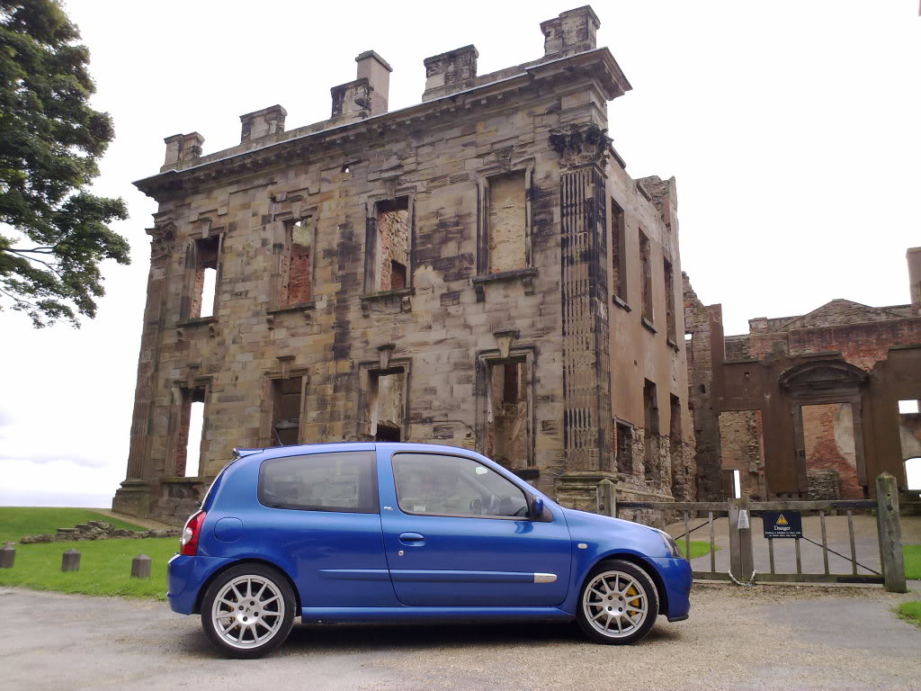

Fitted pro-lines to my cup and although there isnt much of a drop, it just levels the car out a bit. As for driving its kept the cup feel but feels more sure footed and less roll.
Not a close up but you get the idea (nice overalls!!)
  RIP cup, now 172ph1
lol looks higher than mine in that pic! well im going to get some pros next month hopefully may aswell try them for the price..
