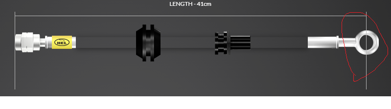

Does anyone know what's the size for the Brembo caliper brake hose fitting ?
I am trying to make some custom Hel brake lines, but I don't know the fitting size for the brembo caliper ( from a Clio 197 / Megane 225 ).
Is it Banjo M8, M10 / 3/8" , M11 / 7/16" or M12 ?
I suppose the fitting angle is straight, right ?

M10 and a 15-30deg angle helps

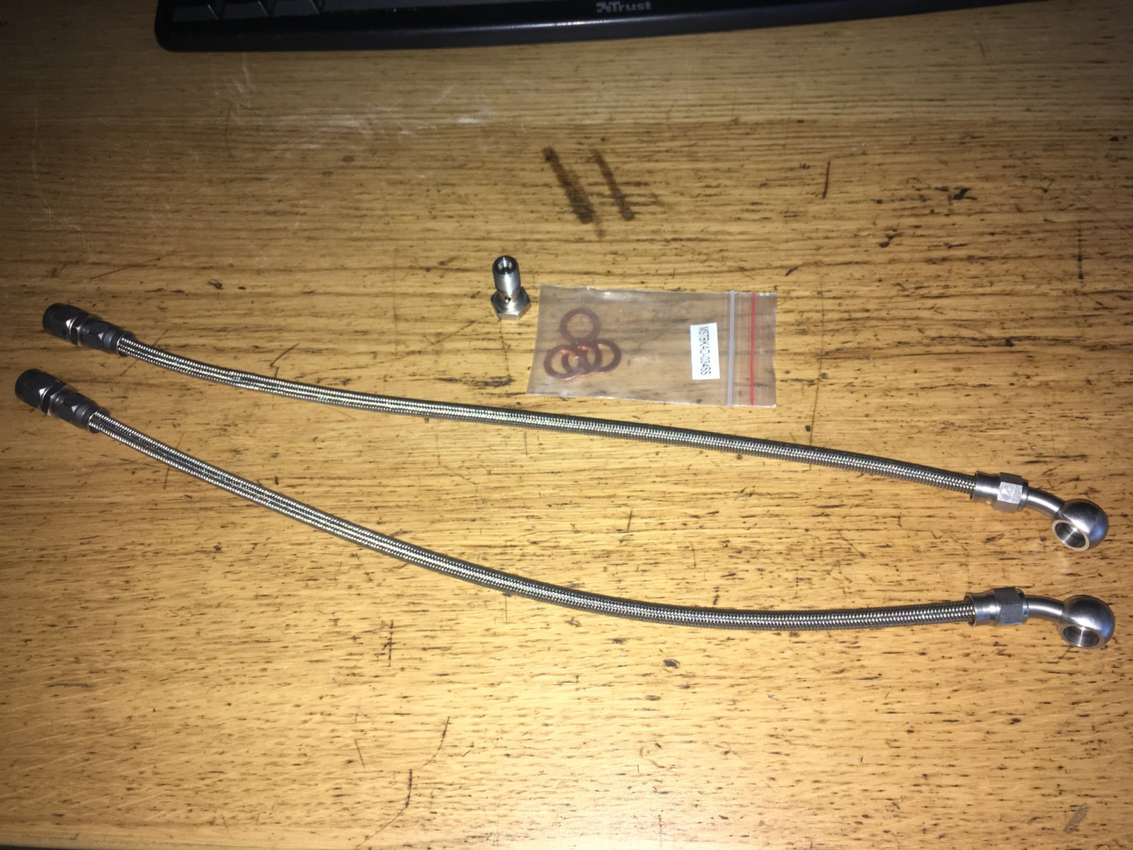

Digging up an old thread! does anyone know what length theyre meant to be? I bought these ones and they much too long:

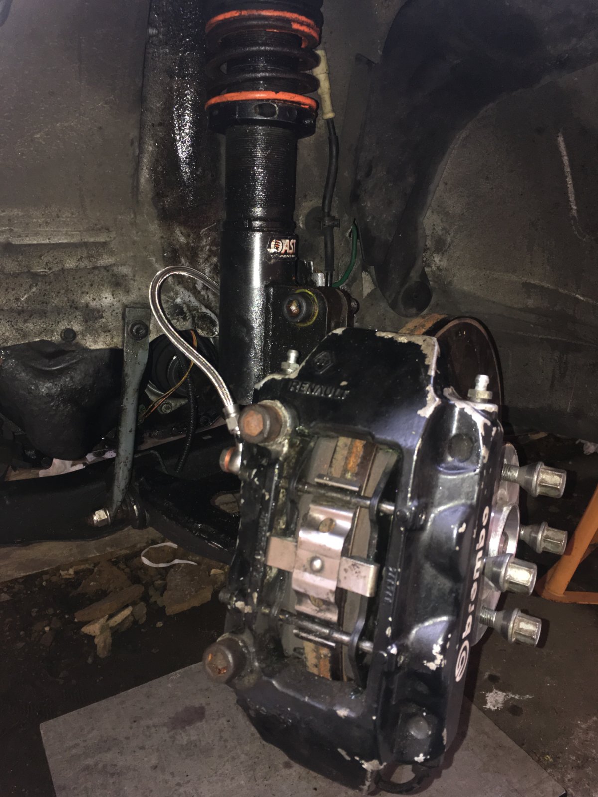

I just cable tied the extra length to the shock with a bit of fuel hose round it
Not had any issues and the cars done 7 trackdays and about 6000 miles

Good to know, ive reached out to them to see what they say, but it sounds like they are just overlength and this isnt a mistake on my order.
Still got some time before the builds finished so I might change them for some better fitting ones if they offer a refund.
They've offered to let me return them and replace for a length of my chosing... trying to work out if i can be bothered to take them off and work out the correct length.
