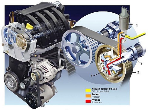

Google comes up with this if its any good
My alternator mounts perpendicular to that. Its exactly like that crappy diagram I posted.
I couldnt figure this out for the life of me.
