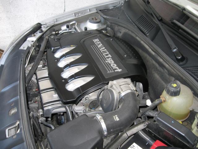

You mean like that ?
Nice job on the engine bay MoRpH3uS:cool: simple yet effective! saying that polishing ali can be a mother of a job lol
