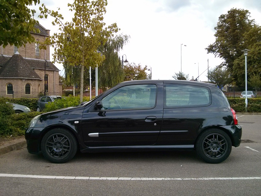

Hey Davyyy... The ride is pretty fine to be fair (but stiff with the engine mounts)
It's the fact it's so low that drives me mad. I work in a forest and do a lot of country roads (potholes etc) along with it being impossible to go over speed bumps normally.
I just want it back to standard now (I'm old and boring! Haha)

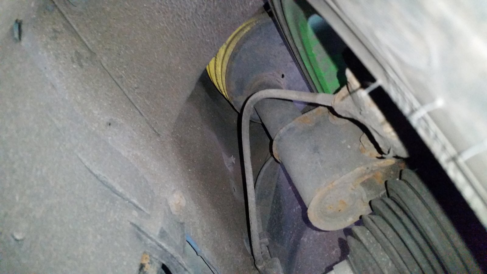

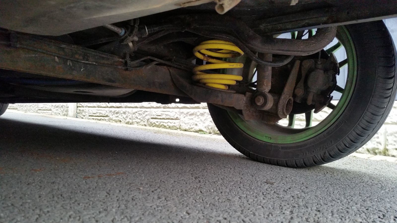

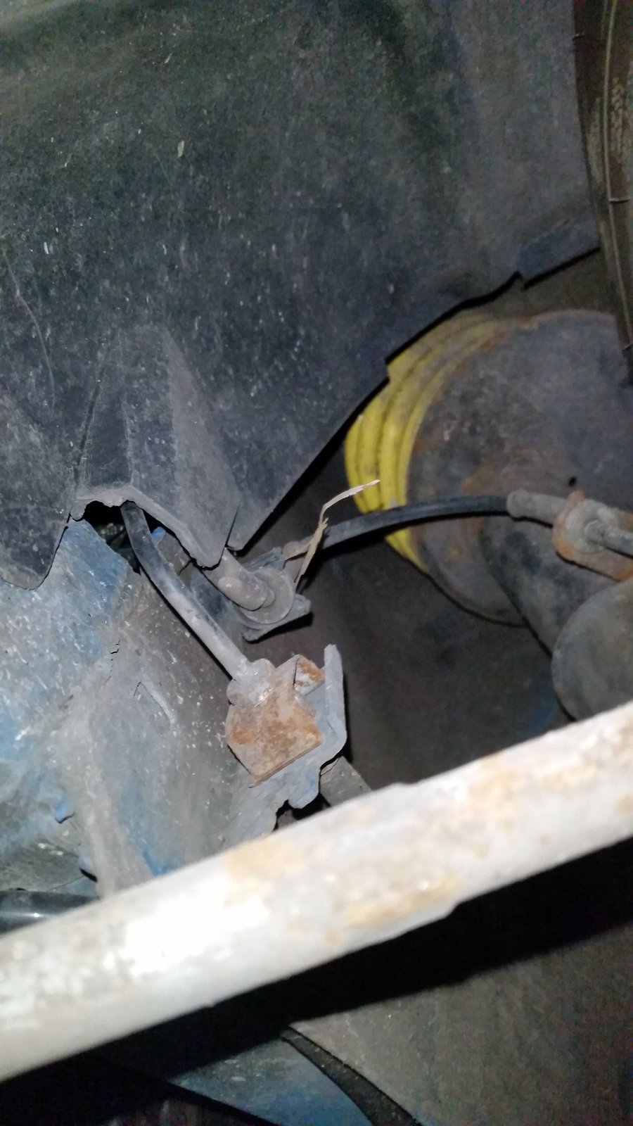

Daft question - just from under the arch or engine bay too? (Will get one in daylight)[emoji2]
  Clio 182 FF

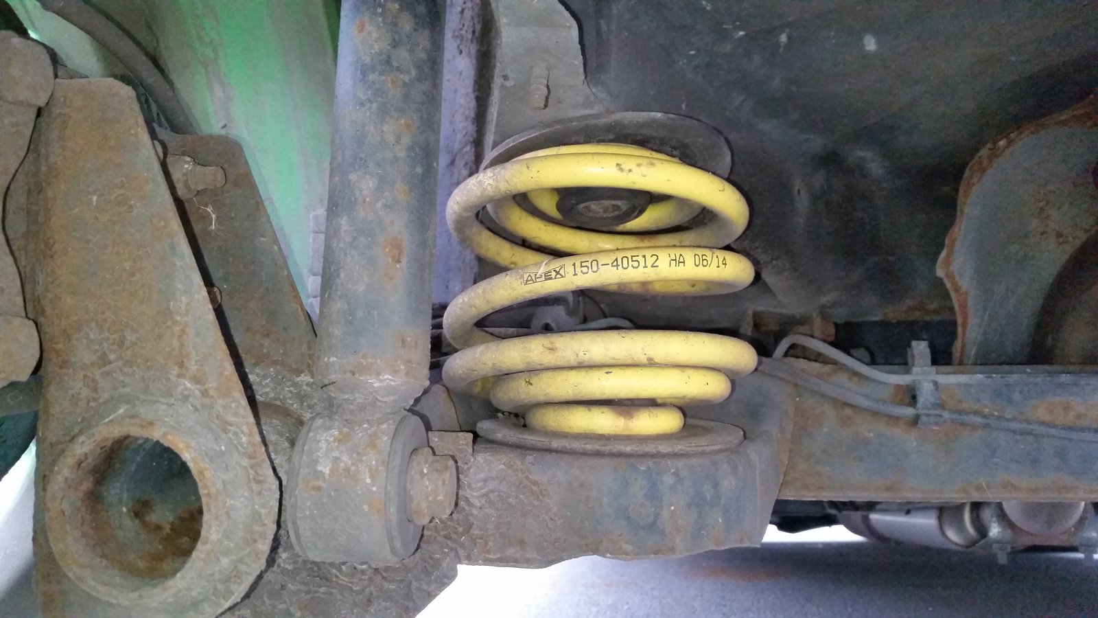

Here's the pics... Just freaked my neighbour out trying to get them.. lying on the floor.. then forgetting I've still got mud all over my face as just got back from mud run... oops [emoji14]
Ol’ Tarby
  Clio 220 Trophy
Apex springs. Going from reviews on here I've read, they aren't the best for ride quality
  Clio 182 FF
Yeh, spotted that... not been under it before so never really looked. I want to swap them anyway as need a higher ride

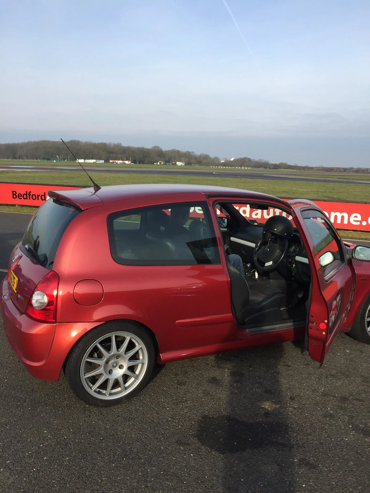

Davyy that's a nice colour! Seems quite a bit higher.. [emoji1]
