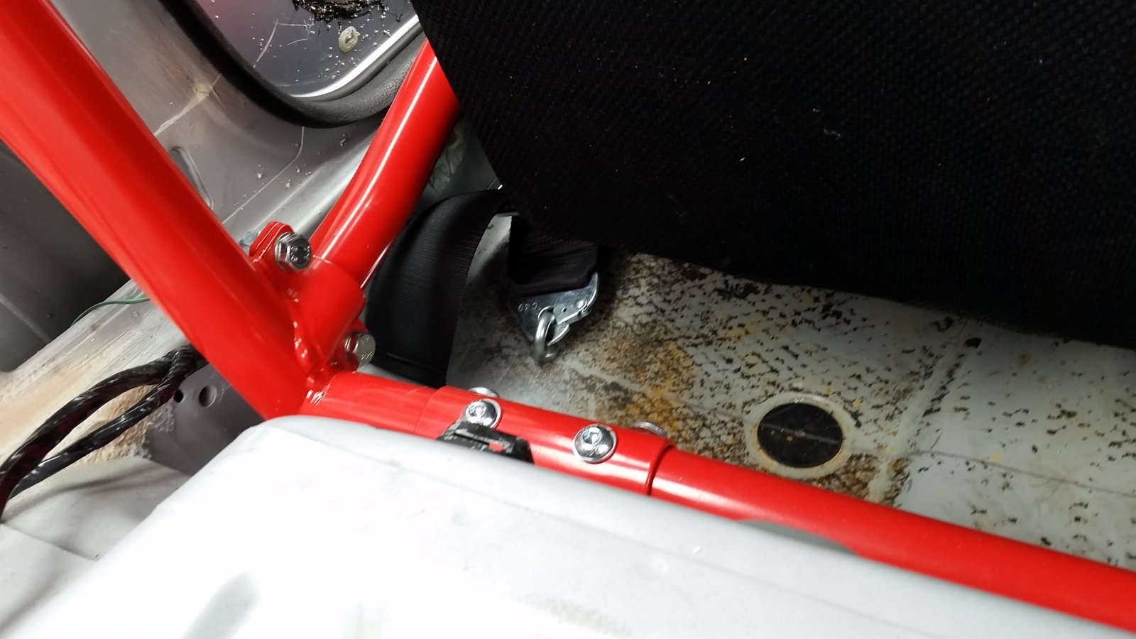

Mine go through the floor just behind the seat subframe, and into strengthened anchor points

I'm yet to fit the inner ones as I've just moved and everything's in storage still but this is where mine are

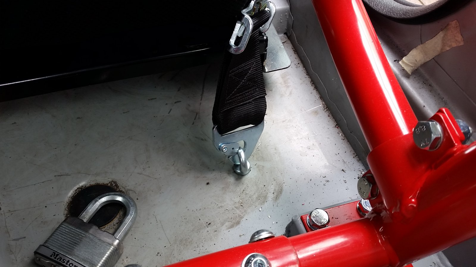

No, mine are the standard eye bolts that came with the harnesses and the floor isn't exactly thick

You can see the fixing point on the last photo where the red cage and black cables are (left side of the cage)

Im installing the ones closest to the doors back in original point but the centre ones will need a new fixing location

To keep harness angles correct, have a look through the schroth guide in the stickies
