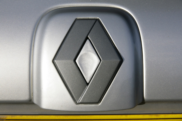

It will be indeed, I only recently purchased the car and want to spray the the front & rear diamonds any idea how they come off...
Front one is the same butter knife trick of working your way round it until it pops off,
it's held in with 3 long pins so you have to be carefull or they'll snap.
For the rear you'll need to remove the plastic cowling on the inside of the boot,
you'll see 3 nuts holding the rear diamond section on, once you've unscrewed them,
the whole rear diamond section just pulls off.
Knuckles
Lol that'd be the first thing I'd do if I wanted to remove anything but the top grill :eek:
The rear diamond Is glued to the boot handle, so pick off the glue, paint it, then regular :)
DaveDreads
Pick off the glue? :S
Far easier to just remove the whole section, mask it up, sand, primer x2, paint x2, lacquer x3 / x4.
Put back on, stand back, take a pic, then shove it in everyone's faces on here. :approve:
