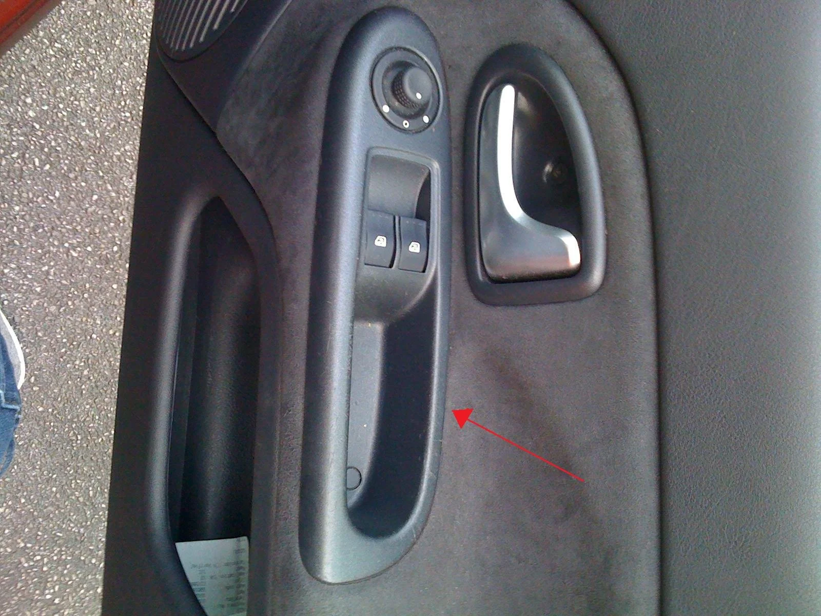

How do i remove this ?
Car  Flame Red 172
Need to get this off to paint it but dont have a clue to get it off, is it just a screwdriver job or is there some other way to get it off
Cheers
Mark
There's a t25 screw under the plastic cover then the whole thing pulls up from the back and out. Obviously disconnect the wiring harnesses too.
