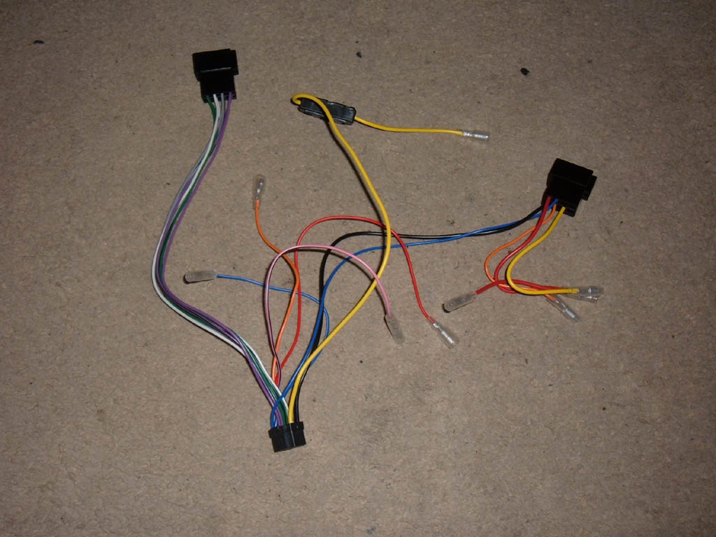

ok, old one out, new one in, doesent work :(
there are 3 blocks on the clio, 1 yellow, 2 black ones
i can connect the 2 black ones up no problem (only go in one of the holes on the back of the Alpine) the yellow block is left out, and the aerial is also connected
alpine not working :(
clios are isoblock which is the same as a aftermarket headunit.
the two black ones should be the only ones connected.
have you maybe connected them up wrong?

i tried all other ways, back to front and tried in the different connectors, but they only go one way
am i doing something wrong , or the unit is poss faulty?
one of the black blocks is for the speakers and the other is for the power/etc. take it the fuses in the HU and the fuseboard are OK? and you're trying it with ignition on? (sorry if that's a daft question)

when i connect the alpine up, the ignition key is out and i have checked the fuse on the HU and the car (stereo only) and both are fine
i tried an old CD player and that worked straight away, u could hear the CD mechanism and the LED flashes
does sound as though there's a problem with the HU then. the red/yellow lead thing is for the memory - they should both be live with the ign. on
one last thought - is this a new unit? you have connected the yellow and red leads in the new Alpine loom? (as they're not connected at all as you take them out of the packaging). again, sorry if i'm asking the obvious here
im going to post a picture of the wire that connected to the back of the Alpine unit
the two big black blocks are the opnly 2 that are connected up (apart from the aerial which isnt shown)
yep - connect the yellow leads together - there's no power
you may need to play around connecting the yellow to the red lead to get the memory working - the connectors will piggyback
hmm, confused now, ive connected the 2 black block connectors up, anything else i need to do?
i havent touched any of the single wires, ive left those as they are
as above - connect the yellow leads together.
the block in the top right is taking power from the car's loom and passing it into the stereo through the block at the bottom - there's no continuity unless you plug the leads in
have a look at the wiring diagram in the destructions for details of what colour's what (yellow and red are power - one's permanent live and the other's switched; neither are connected to anything in the piccie!)
oh right, so why is the yellow one disconected?
so all i need to do is conect the TWO yellow wires together?
thinking about it, do i need to connect the two red wires up as well?

yep, connect the reds as well. as said, may need to connect yellow-to-red to get the memory working. need to play around with it
