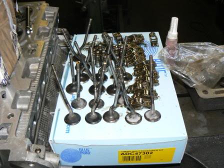

Yeah. You can usually tell by the bent valves.
Like these?
Get it done, mine recently snapped and cost me £1070 to fix!! Seems expensiv to have it replaced but as you can see, a snapped belt causes lots of damage.

You don't need to be thrashing the car to cause lots of damge, I was at low ish revs when my belt went and you can see what it did to the valves!! Theres massive forces involved at any engine speed.
