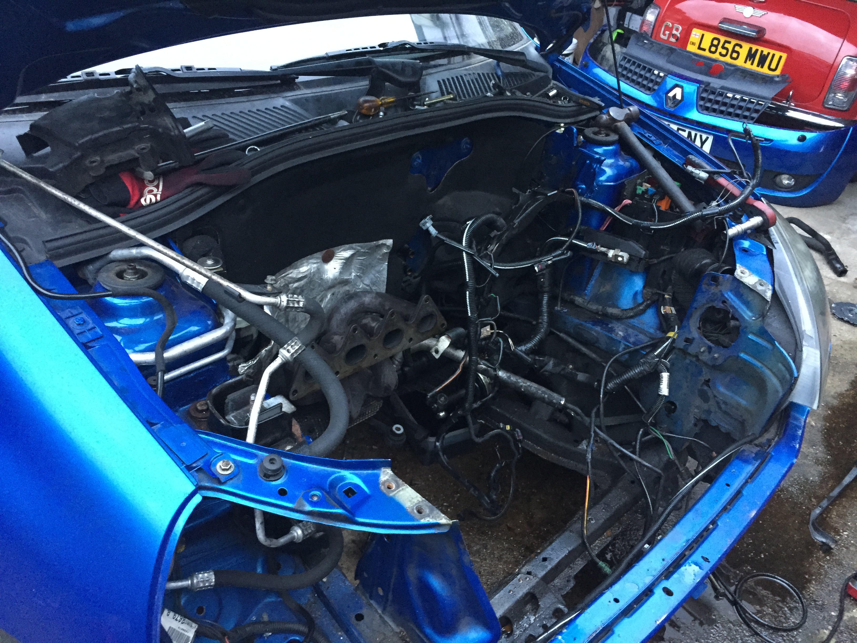

This is how it sits at the moment though

If you have a receipt for the work i'd have taken it back the the garage that did it originally. Problem is, now you've taken the engine out you don't have a leg to stand on.
