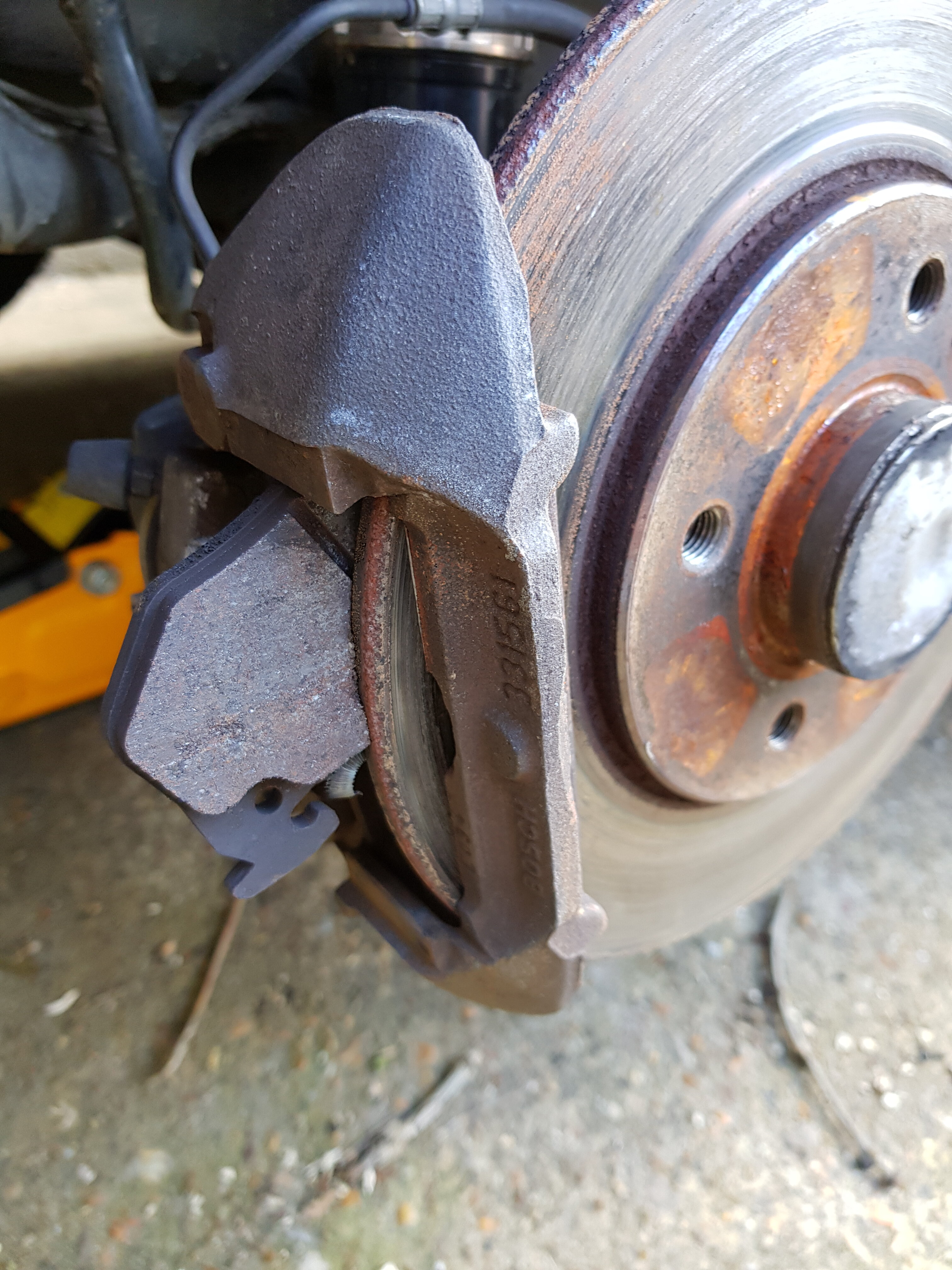

Yeah, definitely don't feel daft, this is how my offside rear pads ended up during a race at Brands Hatch after my first attempt at changing them.
I didn't get the importance of the tie wire on that little bit of 'angle' that slots in under the pads, why the hell are they so complicated.
I do remember braking into Druids and thinking 'that's handling a bit strange, wonder if the tyres are going off' Knob!!!
