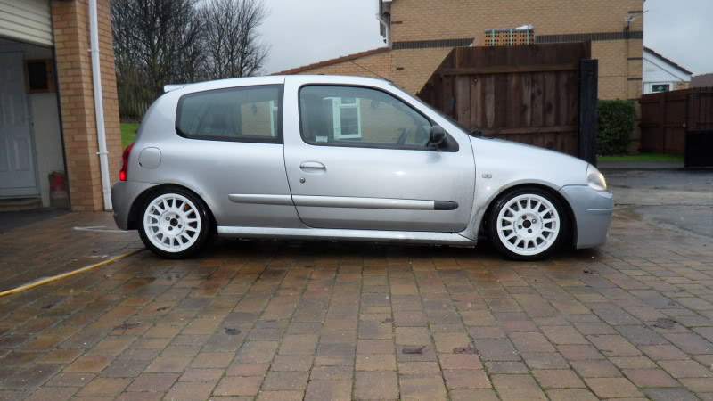

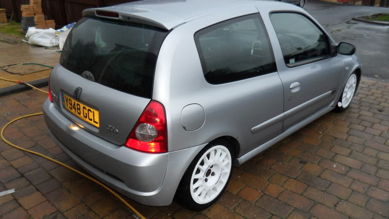

I hate BSX's but that looks bloody good on them!!!

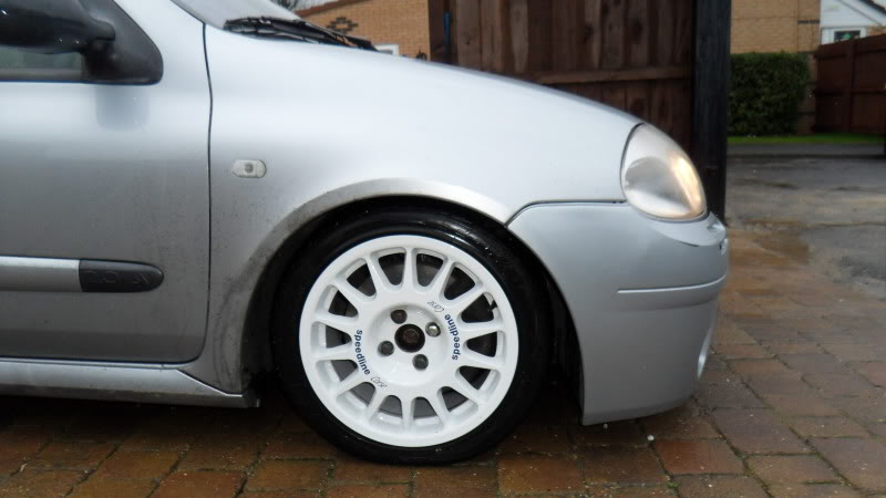

I'm on 16's so I won't be that low however, I'd like my front arch gap exactly the same as yours, the rear is a bit too low for me personally.
thankyou :) im pretty sure youre not alone in that opinion, about the BSX i mean, i heinsight i would have saved abit and gone for something abit more rare,
but i did work hard on getting the stance just how i wanted it!
for any kind of performance based car, i would not advise going this low,
it was an absolute back ache to drive more than 30mph,.
good luck with the lowering though dude!

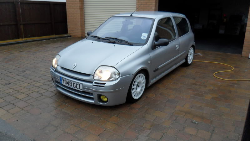

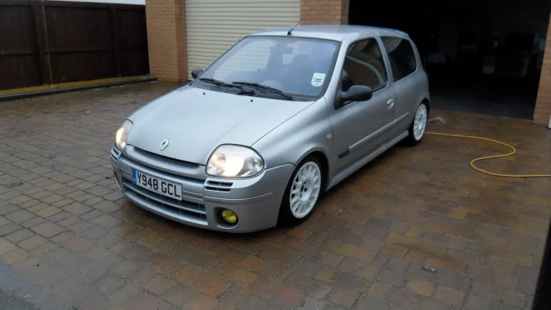

How did you get the stance so good mate?
mine sits
i still have loads off adjustment on rear coil-over :D
this is as low as it will go, wheels h'actually go in this far with people in over bumps as it scrapes inner arch, rear bumper tags worn away :D
and i live in the middle of know where, car gets rallied about, jumps etc, no issues with sumping out or scraping speed bumps.
perfect height imo :D
a while of adjusting,
the rears are custom 90mm springs,
but its sat on bump stops, so i moved it up and down for weeks until i was happy!
no rubbing on the front or rear,
et38 wheels with 30mm spacers on the front,
and 25mm spacers on the rear,
165/50/15 tyres
there is no room between the tyre and the arch, cant get your finger between them, but its sat on bumpstops so it doesnt go down at all!
