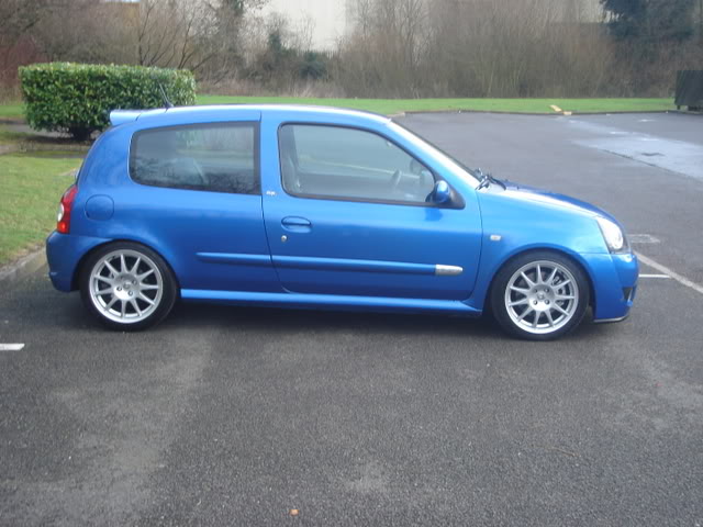

good choice, mine are wound down fully at the back, and low at the front..... The front should always be lower than the rear when looking side on at the car NOT level
The height depends on what you use the car for really. If you do alot B road thrashing i'd only say 30mm as this gives you plenty of spring travel to soak up the bumps. Mine is fine for A roads etc, but can get a wee bit lairy down some B roads...... its set up more for looks tbh!

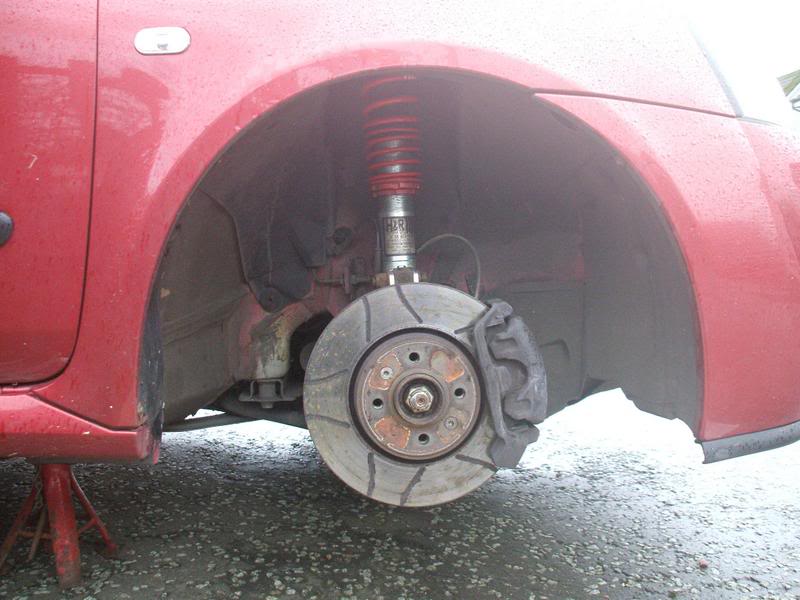

Easy to adjust mate just jack it up and away u go..
Just make sure u set them higher than this before dropping t back down as this was not far from the deck
Gaz_
  Extreme mode
yes, pice of piss matey, they just have two collars (on the front) one adjusts the height,you use a C spanner to adjust it, then when your done, use the other collar to 'lock' it
i adjust mine on thread left on the coilover unit, then double check with the wheels on (tape measure jobbie)
^^^^***doh*** beat me to it, yeah i remember doin that first time too!!! trail and error upon first fitment
