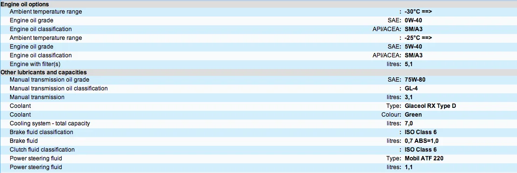

just waiting for the F1 to start but I have a few questions after servicing my 172 this afternoon.
As about how much coolant/water does it take ?
Also I couldn't find the fuel filter? It looks like a standard filter but I just couldn't see it?
Cheers
Here is the info here you need
Excellent ill print that out
well I only got about 3L out of it even though I turned heater to hot ? I removed bottom hose (right pig) is there any other way to drain all the system?
cheers
Buy the genuine Renault Type D coolant, it's ready to pour in and the right coolant for the engine
