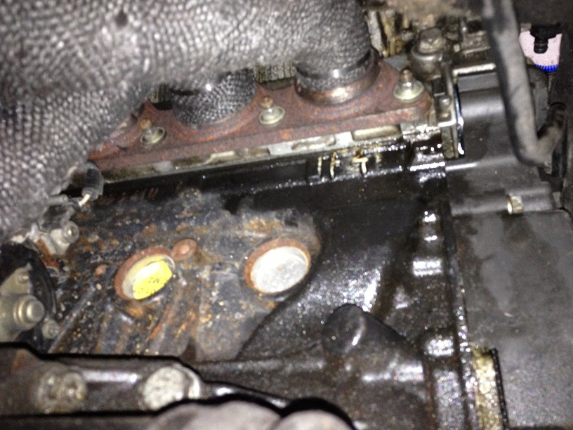

Finally got my 182 manifold on, along with a custom sports cat to keep mr MOT man happy.
Now the car's had an oil drip for ages, but it's only a drip, and I always thought it was the sump gasket.
I've had it up on axle stands for the last 3 weeks while the subframe was off and the manifold change was taking place.
On saturday, whilst bolting the manifold up, i noticed my oil leak wasn't the sump as suspected, but seems to originate from higher up.

How screwed am I? This engine is at 44k, of that i've only done 2k since it went in 3 years ago, and while it was out it had belts / pulleys etc.

How much oil you loosing mate? I had oil down the back of my engine and it was cam seal cover.
I'm sure someone more knowledgeable will be able to help soon. I would probably be most worried about soaking that manifold in oil as that's a good way of starting a fire.
it's only a drip at the moment, its probably only loosing a couple of ml every 100 miles.

you think it's a cam seal sam? i can take the top cover off and get more pics if you think it'll help?

don't think cam seals were done, i know the rest was though, ive still got the box of old bits somewhere
