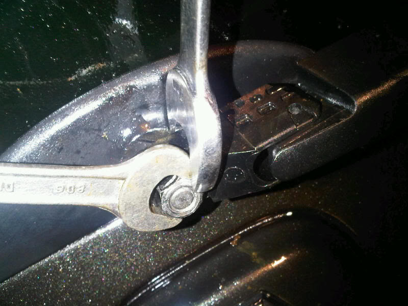

Bearing puller to get the wipers of their taper usually works, they get rather tight to say the least. Water usually has to enter the cabin through the heater and I can't remember any other entry points that side from memory. Check the skuttle drain in the center would be the first port of call.
  Clio 172mk2
like this
  BMW M135i
^ Thats just asking to scratch the f**k out of the scuttle cover though. If they won't come off with gentle pursuasion then what Typan's posted would be a good idea.
  MK3 GTI golf 16v
next to where the nut was just push down with your palm hard a few times ( it will like pop inwards) then it will come off
