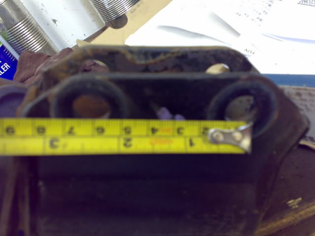

Only real way is to whip off a wheel and check the suspension to hub mounting points. Should measure 60mm between the bolts. If it its 54mm, its not cup packed.

No you can have a spoiler pack (bigger boot spoiler with red brake light, lower front bumper splitter) and then the suspension pack.
Here's where you measure (you'll see with the wheel off)
oh right excellent so i might have a chance of having the suspension then, yeah i saw that picture on another thread but it didn't say what the size would be if its std suspension
