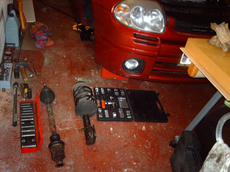

See the sockets in the red box that I have below and the long bar next to the foot pump.
