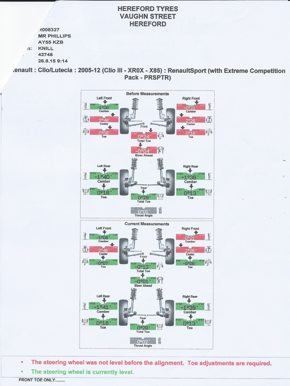

Got it Hunter Aligned today, but couple of things that I wanted to check :
Hunter Alignment by Jimbob_2705, on Flickr
Firstly, have they used the settings off a Clio 197/200? Just looking at the year of manufacture...
If so is the 197/200 set up differently from the 182 - I'd assume so, so just want to be sure it's set up right
Also, anything that could do with changing/improving?
I see that both the Caster is out, and the Front Right Camber, would a camber bolt solve this?
Rear end looks spot on though, well it's all green which has got to be good haha

looks like they have gone off the clio mark 3,mine was done off the f4r engine clio mark 2
imprezaworks
  Mk5 Golf GTI :)
The rear camber isn't adjustable without them. Your rear seems more than I thought it would be.
Although no expert and can't remember what the standard camber is. I had 2 degree shims on mine and the rear was, er 2 degrees lol.

chap who did mine,said when the clio sports are lowered it is best to get camber bolts and the tyres tend to go in a bit,if that makes sense.

Gonna get some ordered, only thing is I'm wondering if I'll have to pay for it all again if I just want the camber adjusted! Possibly a stupid question but would fitting camber bolts adjust the toe setting?
Also, do spacers (would be a rear axle spacer, and normal front ones) affect geometry settings?

I've been under the impression spacers don't. Are you fitting the bolts yourself?

i just think if they care about customers etc,you will come back,i have too have new track rod ends and tie rods after the euro car parts failed after 3 months,they are fitting those for £25 and a free set up again,i would get the powerflex camber bolts on ebay cheap enough and free post.
