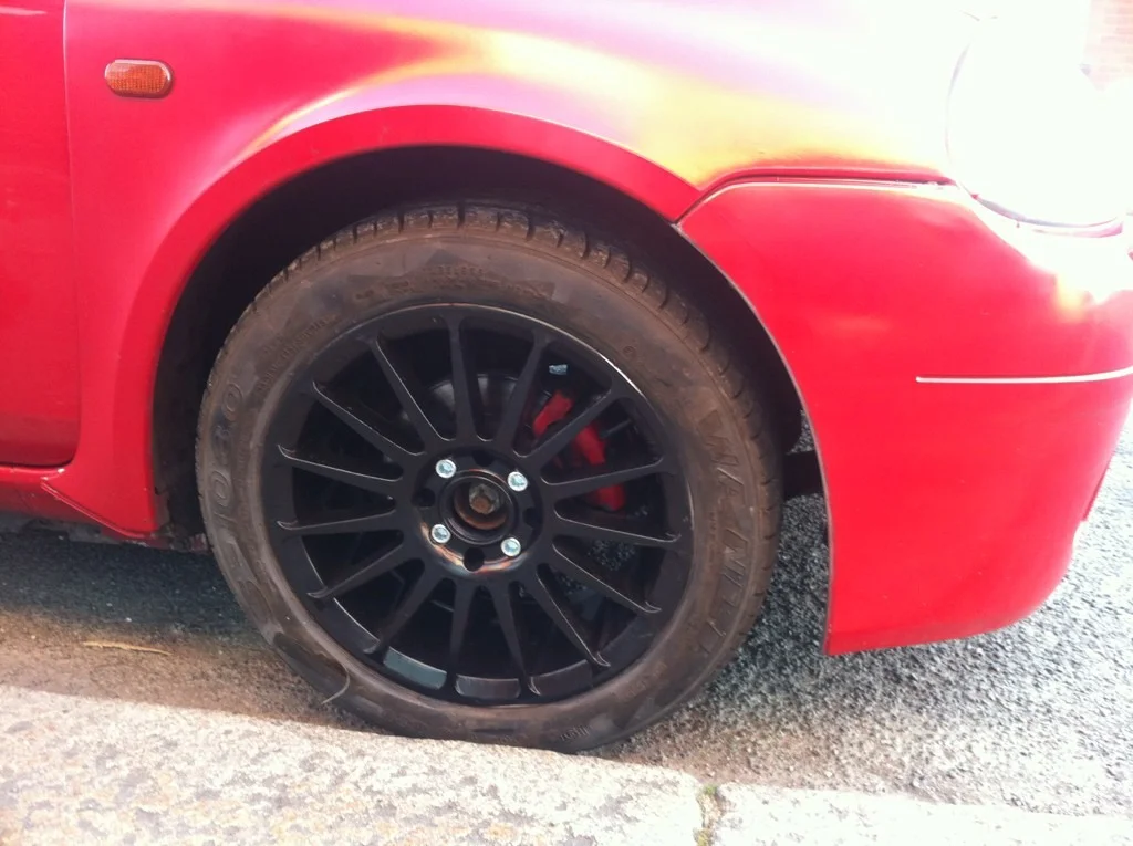

Right today we have changed my drivers side drive shaft which was a suspect to a sudden jerky kind of knocking when turning and under braking from the front of the car. Took it out after the drive shaft replacement and what do you know... Still knocking like a b**ch and still juddering (as if buckled wheels)
Right pulled it back onto the drive let my dad take it out and watched closely as he drove and my passenger wheel looked like it was wobbling. Pulled it back on the drive and wouldnt you know the bolts where loose???? Weird I tightened the gits up! So took it back out for a test, so far so good how ever every so often on turning the knocking and juddering returned. So brought it back in and tried taking the wheel off 3 of the 4 bolts came out the other got jammed real tight and after a bit of a wrestle it snapped.... FFS its 8pm now... Not in the mood just got in from work so took the caliper and disc off and drilled out the bolt. Time to get tapping tomorrow and see if that helps at all
If it start knocking again what the hell could it be? Im stumped? Checked the wheel for a weight and there is no weight on that wheel (possibly never had one? Possibly fallen off) as it was half way through a Journey this problem occurred. Think the wheels need a VERY good re balance? Or am I looking at the wrong thing here?
As much input is sincerley appreciated im only insured on my dads car till Tuesday and im not really mechanically minded and he goes to Scotland for work tomorrow for a week so im going it alone :(

Checked the ball joint?
What happens when the car is jacked up and you grab top and bottom, and left and right and give it a wobble?
That will be one of the things I'll check when it's all back together mate when it started it did it after 30mph and severely under braking the steering wheel would shake and it felt as if I had a puncture
I actually don't know mate :( they have been painted Over any form of identification lol they look sort of Like turinis
  182
If the wheels are becoming loose it is down to no spigot rings.
Also are the wheel bolts chamfered like these??
  Dodgy one
If you have the wrong bolts for the wheels, They will come loose no matter how much you swing on them, tapered bolts for tapered seats etc.
Ordered some Spigot Rings today for £16 delivered
72.6 - 60.1mm rings I think these are right we shall have to see. The mechanic at work said I shouldn't have run the wheels without the Spigot rings as the bolts have come loose from trying to hold the wheel in position and keep it tight to the hub. He said they aren't toleranced to hold a wheel in position more holding on.
Once I tap the hub out today Im hoping the rings will be here tomorrow and ill put it all back together and see what happens if not, ill be doubly stumped as to what it is :(

You properly worry me. I genuinely think you should consider stopping working on your car yourself and start taking it to professionals.
The bolts you have are a 60 degree taper, are the wheels the same?
28mm thread does not seem very long, how far through the back of the wheel do they go?
Do a few things tonight please, just to save you from killing yourself...
Jack up the car, take a wheel off, poke the bolt through the hole on the wheel and check it fits tight, i.e the taper is the same angle, you should be able to tell either by eye or by wobbling the bolt around once in the hole.
Second, take a measurement to see how much of the bolt makes it through the wheel when it's off the car.
Anyone who says don't fit spiggot rings is mental, why do you think cars have hubs? Lets just bolt flat metal to flat metal than put extreme stress on 4 12mm bolts whilst flying around bends creating G forces with over a tonne of metal....?
Also, are the wheels the correct PCD? You're not forcing on 4x108 or something are you?
Get looking on the back of the wheel for any numbers at all.
They stick further than my standard bolts, They go all the way through the hub (about 10mm further than my standard bolts) (Although will measure tonight)
They feel sturdy enough no play in them and they sit all the way in the bolt hole (head flush with the top of the bolt hole on the wheel)
Will do tonight mate
Im no mechanic nor have any mechanical experience (I have a mechanic but when I ring him hes always busy and just says do it yourself it's easy) So I put them on, not thinking
Yep they are multi-fit and 4x100 mate holes line up perfectly with the bolt holes on the hub
Thanks Rob :) I shall do all those check tonight when i'm home and report back
Just a quick update...
Spigot rings and new bolts should arrive today. Tapped and rebuilt the passenger hub back up yesterday. Checked the thread length on the bolt when its through the wheel its 20mm of thread when the bolt is in the wheel... sufficient?
Also checked the angles of the bolt chamfers and the wheel they look and feel exactly the same from what I could tell.

your brave for bombing it down the motorway with no spigot rings :nono: hope it gets sorted mate :)
  Cliosport 182 FF
Its the missing spiggot rings,a bmw i had developed a juddering for no reason so after getting wheels rebalanced etc we found the problem was the rings were made of cheap plastic and over time some had got soft and stretched with the heat from the brakes etc, a friend of mine at the tyre place i go to wrapped a few of turns of insulation tape round the hub instead of the knackered spiggot ring and the juddering disapeared, i drove it only till i could buy some metal replacement rings
Most plastic spiggot ring are made from tougher stuff now and dont go soft,if you buy plastic dont get the cheap ones, better still buy metal
Cheers mate as its turned out I've had no deliveries today :( ffs! Needed my car back on the road for the painters tomorrow unless I out my steel wheels back on hmmm might do actually
Right... Baffled is not the word?
Put my car back to the standard 14" steelies as a temporary fix until the rings come... Took it out for a test to see if the knocking had gone (being standard wheels they should be fine) low and behold, knocking still there? Under acceleration and turning its more prominent what the hell! Rang my mechanic he said replace the passenger driveshaft now FFS what else. Ive rung another local mechanic Equipe, and asked can I bring it in tomorrow morning for inspection so im going at half 8 to have it checked over my mechanic hasn't seen it in person and I have no idea what im looking for. Id rather have it checked by a pro than go buying parts willy nilly to change them and find its made F all difference... What else can I be looking for it's meant to go for painting tomorrow aswell and I have to go Ireland in it next week... Its looking grim... Very grim :(
Just been out for another look and smacked both front wheels with my hand and the drivers wheel is solid where as the passenger wheel has a wobble too it? I did record a video but my phone is playing up and doesn't want to save it but could it be possibly a wheel bearing? I've put it under too much load and it's packed in?
