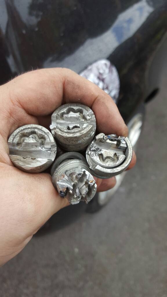

So the key to my locking wheel nuts snapped and after several phone calls nobody wanted to know because they have a spinning outer ring that makes it a pain in the ass. Had enough waiting and trying to get another key etc so out came the grinder, chisel and hammer...
Anyone had a similar situation and used a bit of an unconventional method to get them off?

What did the wheels look like after that?
I've managed to remove a set of them with the rotating outer ring before. I smashed a smaller socket on and the outer ring gripped the centre and came undone.
  RS 200 CUP
They looked like they had been attacked with a grinder but they were going to be scrapped anyway so wasn't very careful. They had already been curbed to hell and back so I wanted to replace them which was when the key snapped

LOL @ that photo! Jesus!
