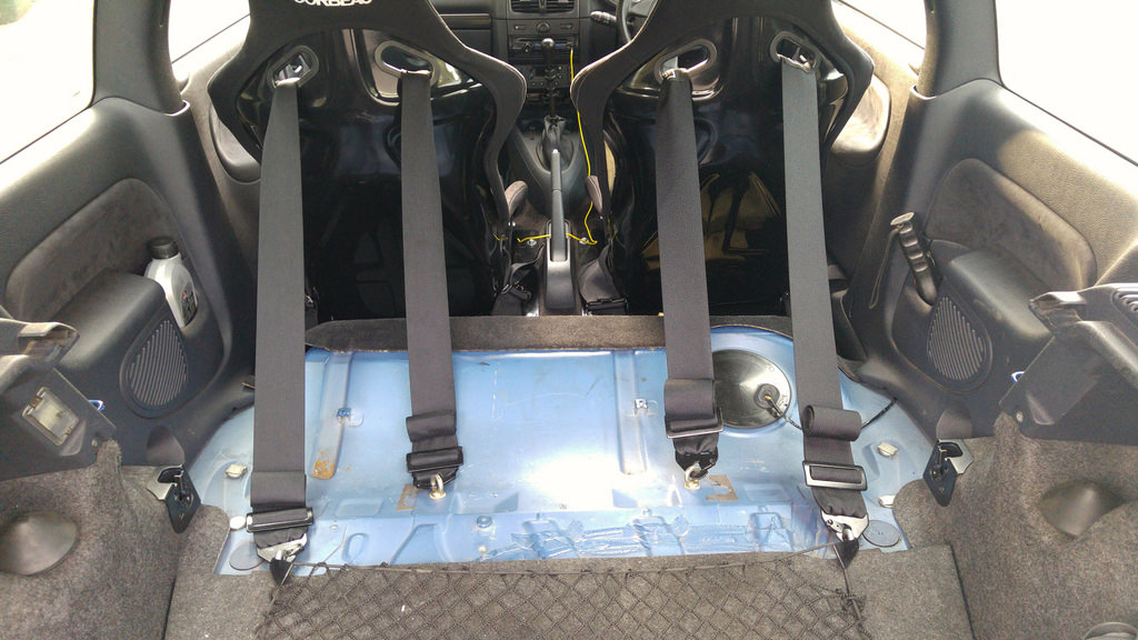

I'll get a picture for you...I run 4 point harnesses so use the OEM seat belt rail for one side and a Schroth B23A for the other side (exhuast tunnel side)

Hi Ben.
I used the OEM Renault bolts for the seat belt rails. I'll get some pics for you tomorrow/ sat.
This was how mine was set up, you can see the different colours, they represent the different thread types so should help.

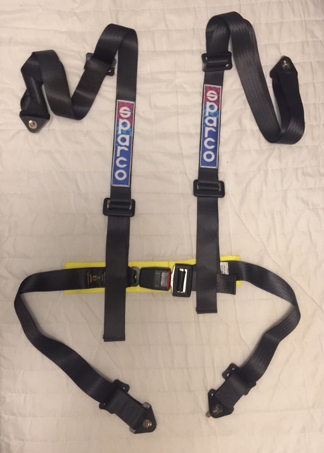

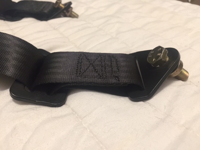

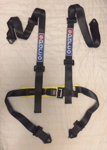

Hey guys, sorry to hijack an old thread but I have a small issue(?) with my harnesses. I bought the harnesses months ago when I bought my clio and only just had another look at them today after about 6 months. The parts that bolt to the car are solid mounting brackets, which are not able to come off the harnesses straps as they are looped on and stitched up (i.e. I can't swap the brackets out for snap brackets that clip onto eye bolts). I'm struggling with where to mount these as every picture I've seen in a clio all have eye bolts and clip on harness brackets. Here's my harnesses:
I bought some of these spreader plates for them the other day, though I dont like the idea of mounting the harness lap belt bracket at 90 degrees to the floor, so is the anywhere suitable in the sill and on the exhaust tunnel to mount them?

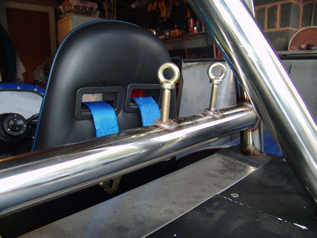

I have a full 6 point cage being custom made and plan on mounting the shoulder straps to the harness bar by welding in some bushes all the way through like in the picture below (though without those ridiculously long eye bolts that guy used) but bolts them flush to the harness bar.
Any tips, help or advice would be greatly appreciated and to what is best as I'm proper scratching my head trying to decide whats best to do! Pictures and/or links to people who have mounting with the same style fixed brackets would also be super helpful. Cheers.
One of my harnesses had the same so I cut it off and wound it round the bar with a normal bar wrap. It doesn't move and I sealed the end by lightly melting the end like you would with rope.
This might be an option though I'll have to see how much slack I'd have left once I cut them off. Thanks.

I have an OMP passenger one, but not sure what my drivers subframe is, it came with the car. I took @GrahamS's advice (thanks!) and cut off the ends and sealed them with a lighter so that I could simply loop them around the harness bars, which worked well. Haven't done the same to the lap belts yet as I need to check that they will still reach where they'd need to be if I cut the ends off those too.
I could mount them to the subframe bolts, I just ideally didnt want the harness bracket to be bolted in at a sharp and the the direction of the harness straps, so was looking for alternative mounting points. If the lap belts wont reach the floor I'll look into drilling a new hole and bolting to the side mounts.

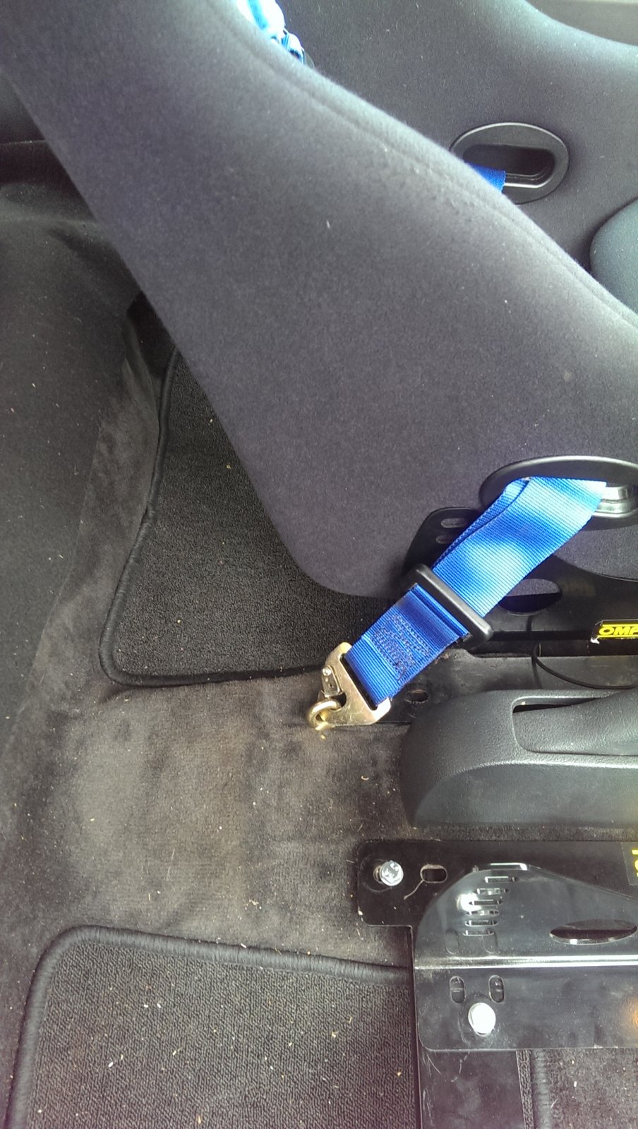

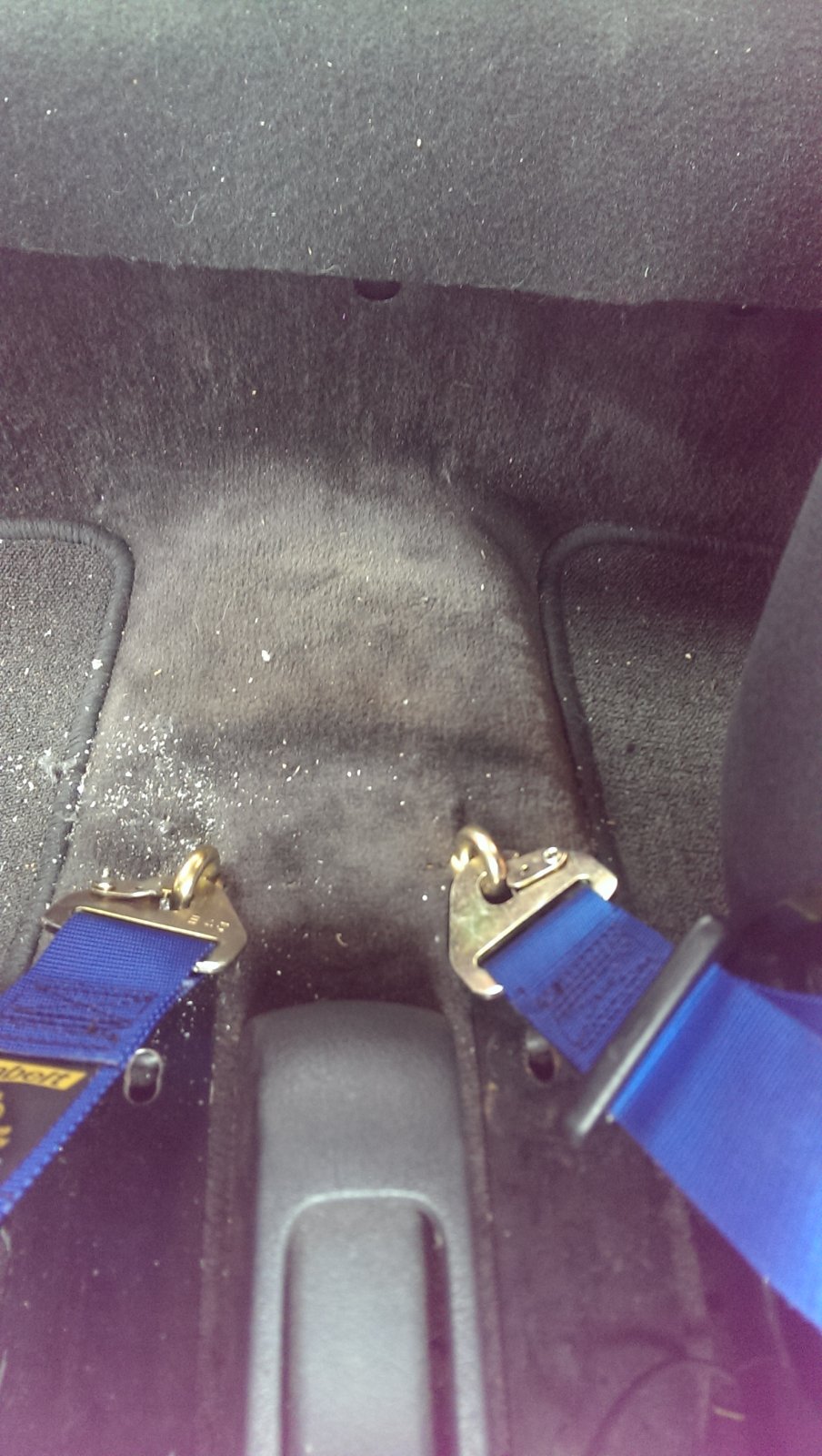

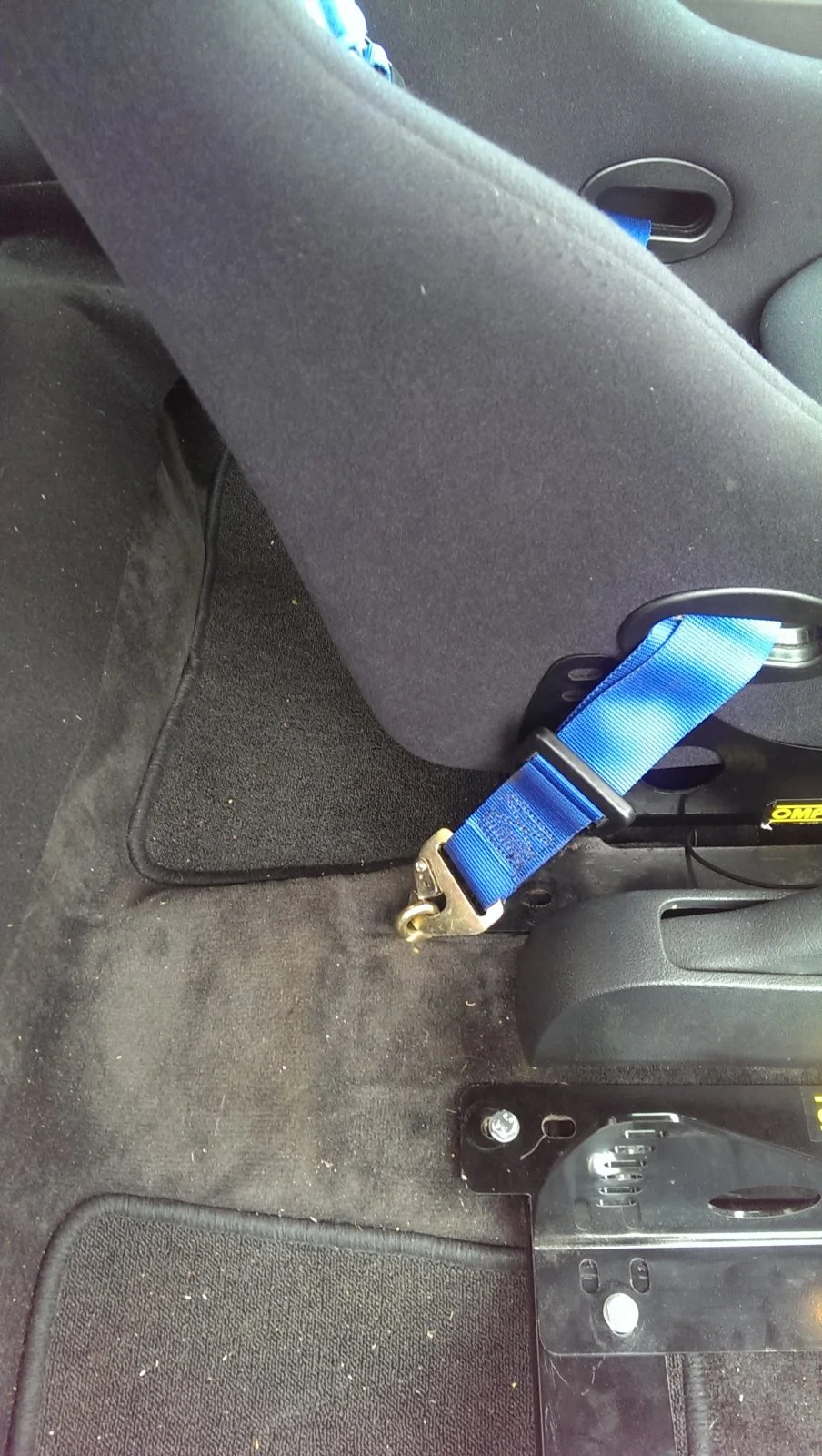

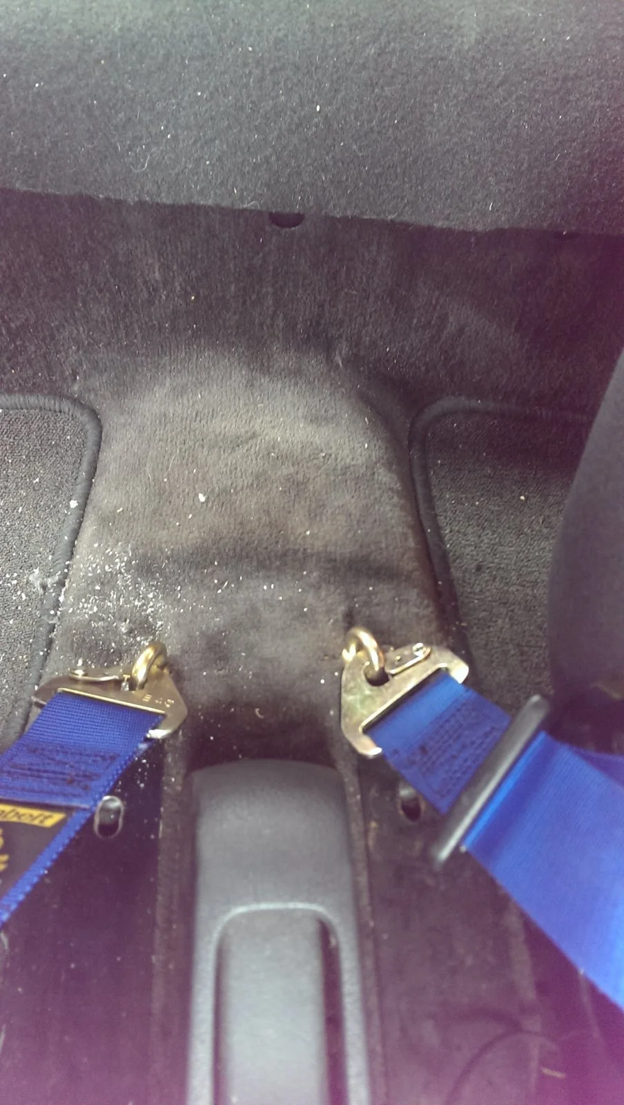

Mine are bolted through the floor just behind the seat subframe and spreader plates tack welded in the exhaust tunnel.
And outer lap belt to an M10 eye bolt in the original seatbelt mount hole
