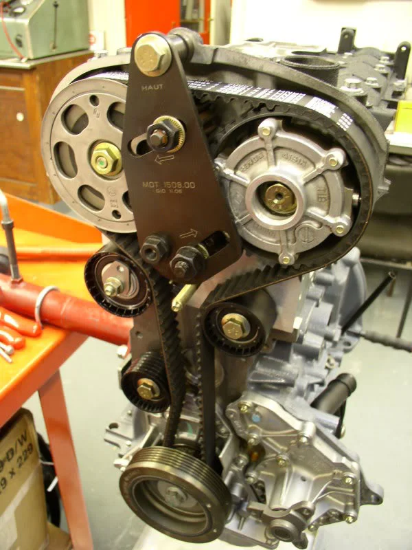

Just seen in another thread that Fred posted a pic and the pulley i have been given looks like the exhaust pulley.......

  LY 182
the one on the rights the dephaser, id imagine the dephaser would be a hell of alot more

Went into Renault again today and they were sure they sold me the right one! He said the pulley i wanted wasn't a de-phaser. Went to have a look at the parts screen with him and the picture shows the pulleys from the back, as if u were looking from the flywheel end.
What a stupid way of displaying something!
Got the de-phaser ordered now tho
