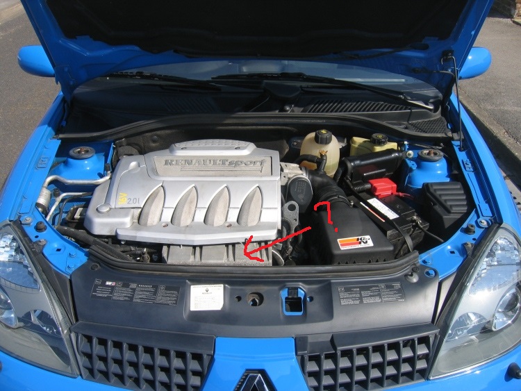

Could some one tell me what part this is? (photo not of my car, but expertly indicated with paint/touchpad mouse)
Basically when I got the car this was loose so tightened it up, but heard a rattle last night and discovered it is coming loose again. There seems to be 3 holes for fixing this, 2 of which i cannot feel any bolts/threads, and one which I think is a thread with bolt.
Any advice on how to tighten this up, or do any parts need to be replaced?
Many thanks
Steven
I thought that when having a feel, but cant see because of angle, only seems to have one stud, any idea if these can be replaced? - preferably don't want it falling off down the road
10mm. Sould be anti loosen bolts like whats fitted to the exhaust manifold.
Thread size m8 x1.25 but with a 10mm head rather than the 13mm head
