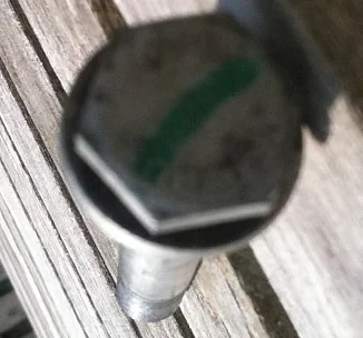

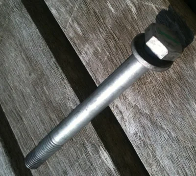

OK, I am still trying to find the cause of the loud metallic rattle that starts at 3K revs on my Clio 182. Today I am looking for anything obvious under the car, and undo the circular plastic hole cover in the undertray just behind the fron bumper, as it doesn't seem to be on properly. Guess what falls out of the hole?
It is 115mm long, around 10mm thick, has "Verbus" written on one side of the head, and "10-9" (or similar) on the other. It also has a green paint strip across it as can be seen in the photo.
Could anyone please tell me what this bolt should be doing? I am hoping whatever it should be bolted to is the cause of the rattle...
Cheers everyone.

lower alternator bolt, ive had them come loose a few times, get it sorted ASAP otherwise the aux belt "could" come off and jam the cambelt = bye bye engine

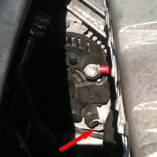

Fred - master as always. If I look down onto the front of the engine facing the car with the bonnet open, is it the hole at the bottom of the right side of the altentator? If so then it does not want to fit in, which suggests the alternator has moved a little. I'll drive it very gently the quarter of a mile to the local garage first thing in the morning to get it sorted. Is it simply a bolt back in job - no worries about the aux belt?
Last question - would this bolt have been removed when I had the cam and aux belts changed?

Fred and other clio experts, is this where the bolt is meant to go, at tip of red arrow?
  Lionel Richie
yup thats the one, and yes i slacken them off when doing the cambelt change, as i said previously i have had a few rattle loose
