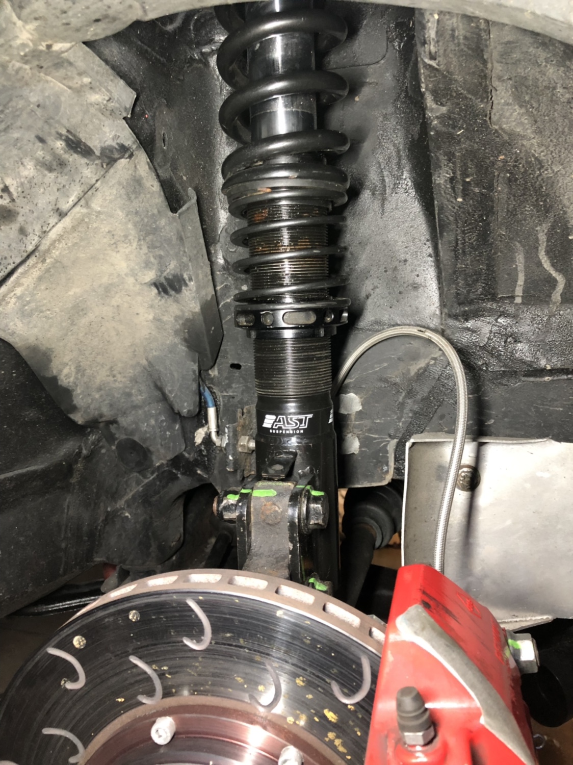

AST5100 (110/90) fitted

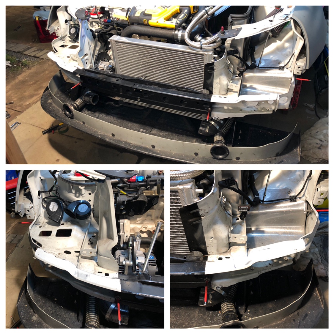

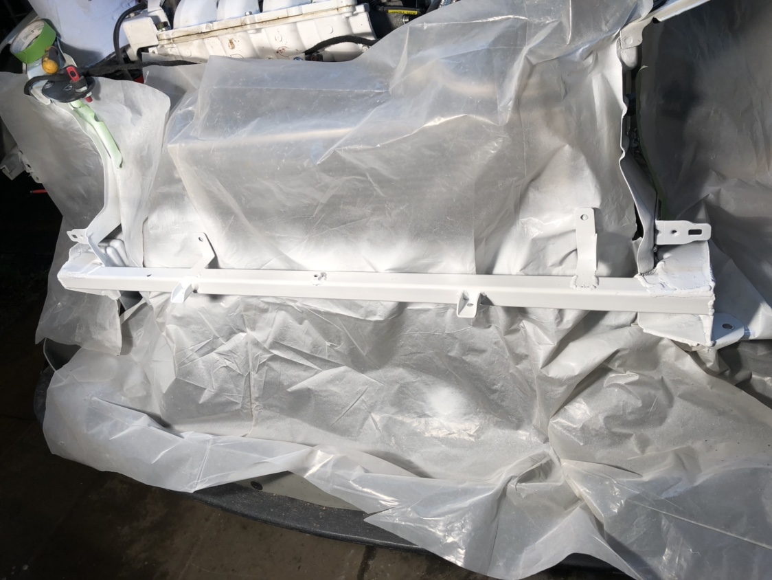

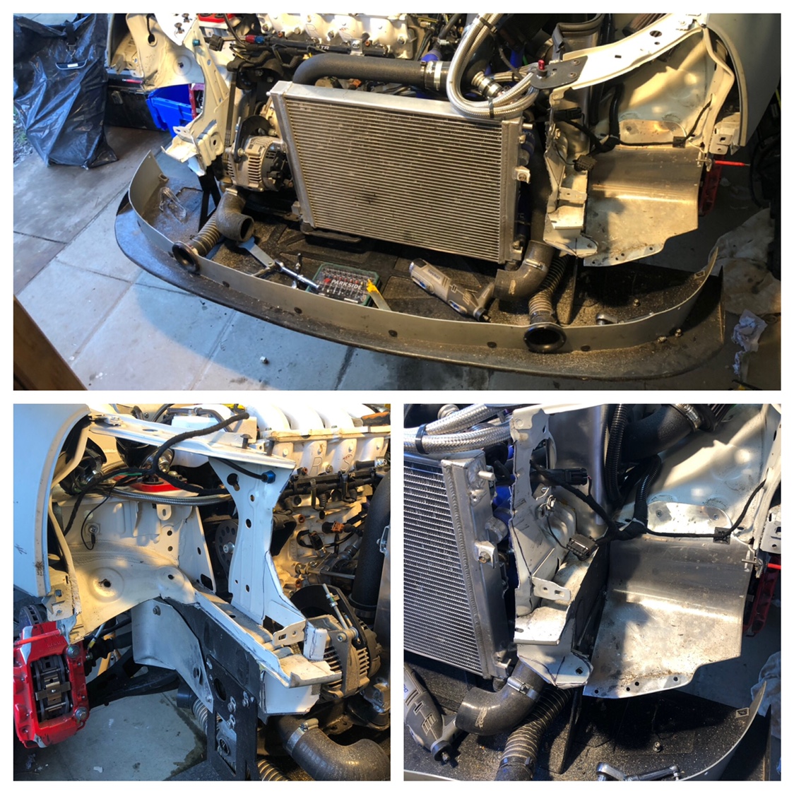

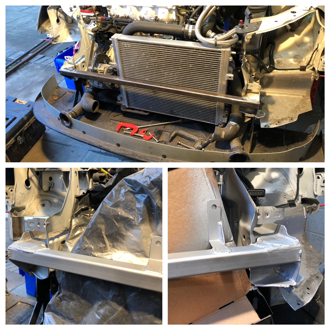

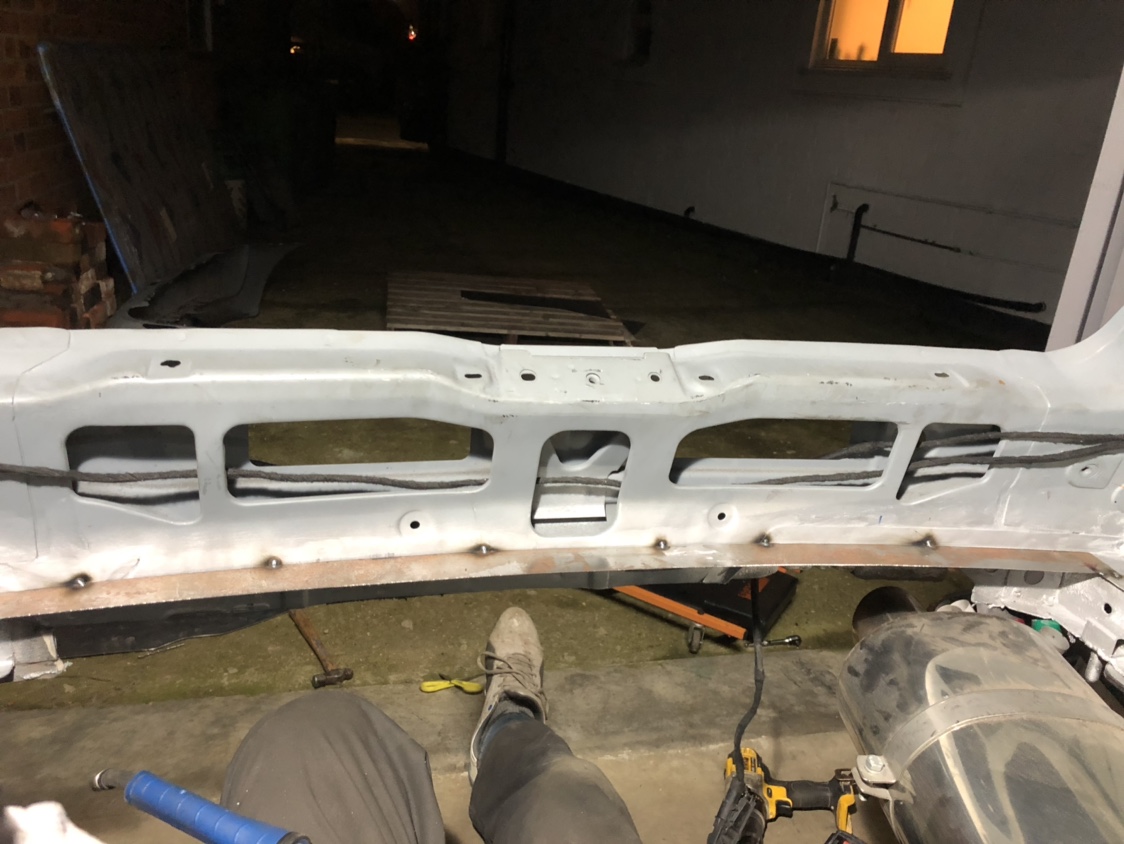

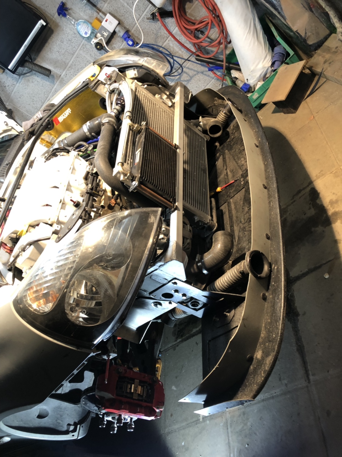

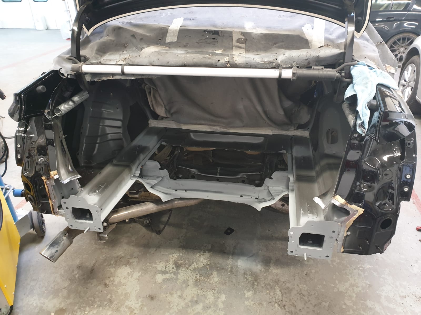

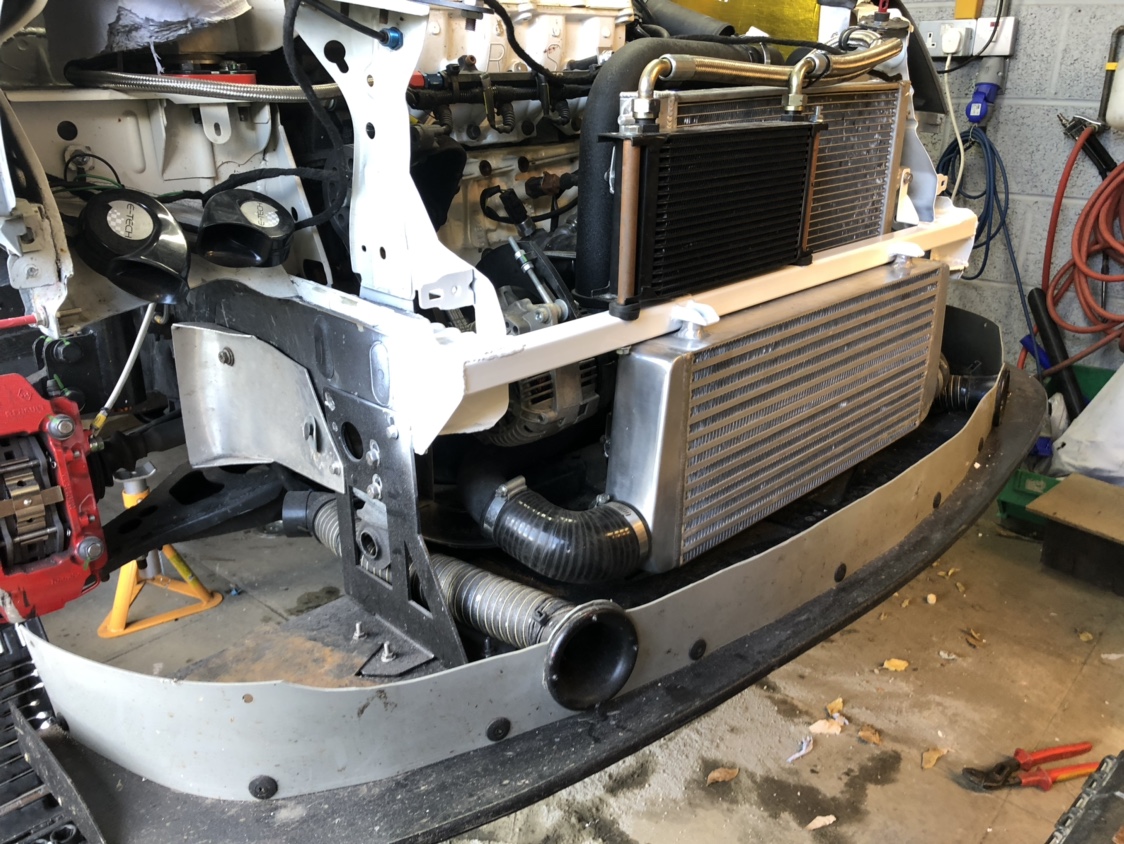

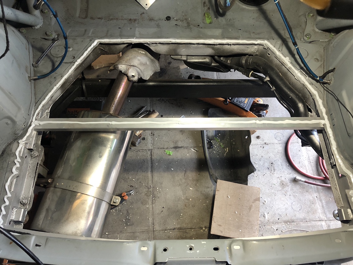

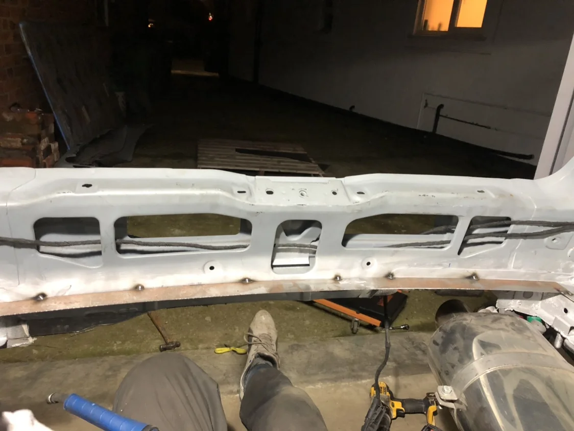

Front crash bar completely removed and replaced with smaller support bar.
Also trimmed everything else that is not essential.

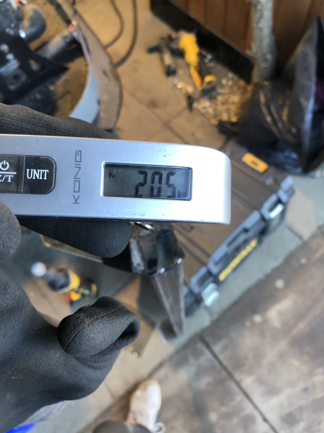

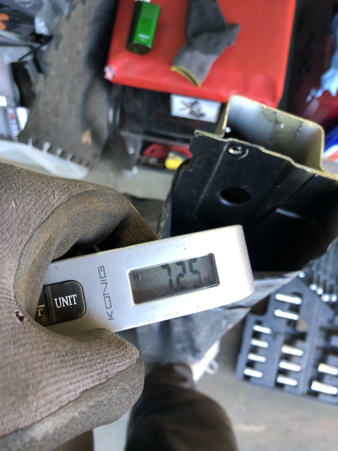

Material removed 7.25kg (-replacement support bar 2.05kg) total weight loss 5.2kg
This is what I started with
After the chop chop
New support bar
Just waiting for a bigger intercooler to arrive.
Now I have more space so why not. Hopefully won’t be much heavier than the original.
ED core size is 550x140x65
Will replace with 550x230x65

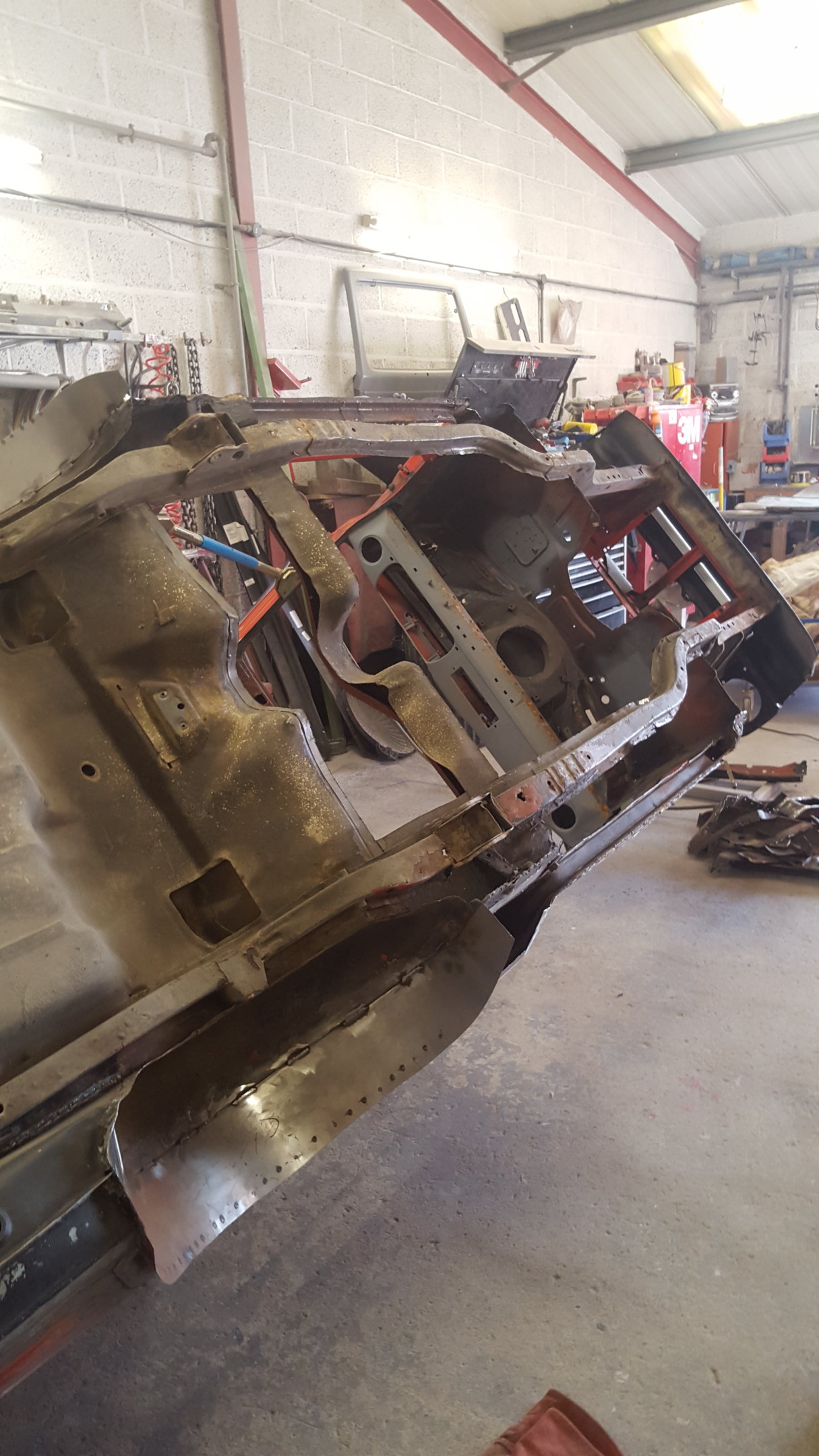

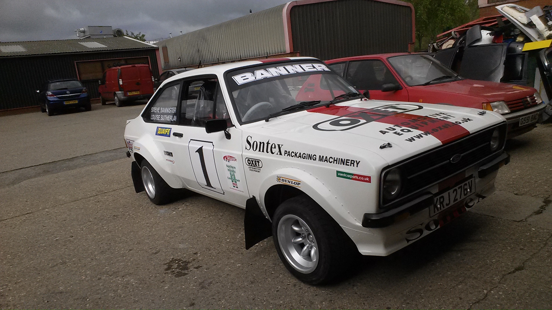

Another option is to remove all stone chip protection from the underside, it's very dense and any excess seam sealer then just paint it. Obviously making sure water cannot ingress into any seams.

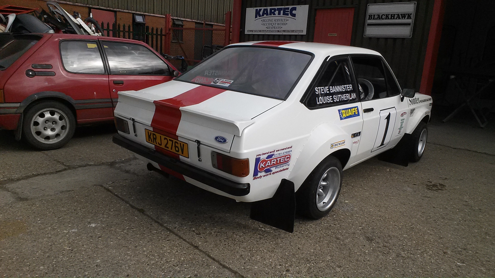

Used to do alot of Mk2 escort group 4 historic rally cars where they were blasted to a bare shell and once primed and flatted we would wipe into the seams the sealer and then wipe out any excess not required so as not to add unnecessary weight

That new cross member gives you so much more room. Nice work.

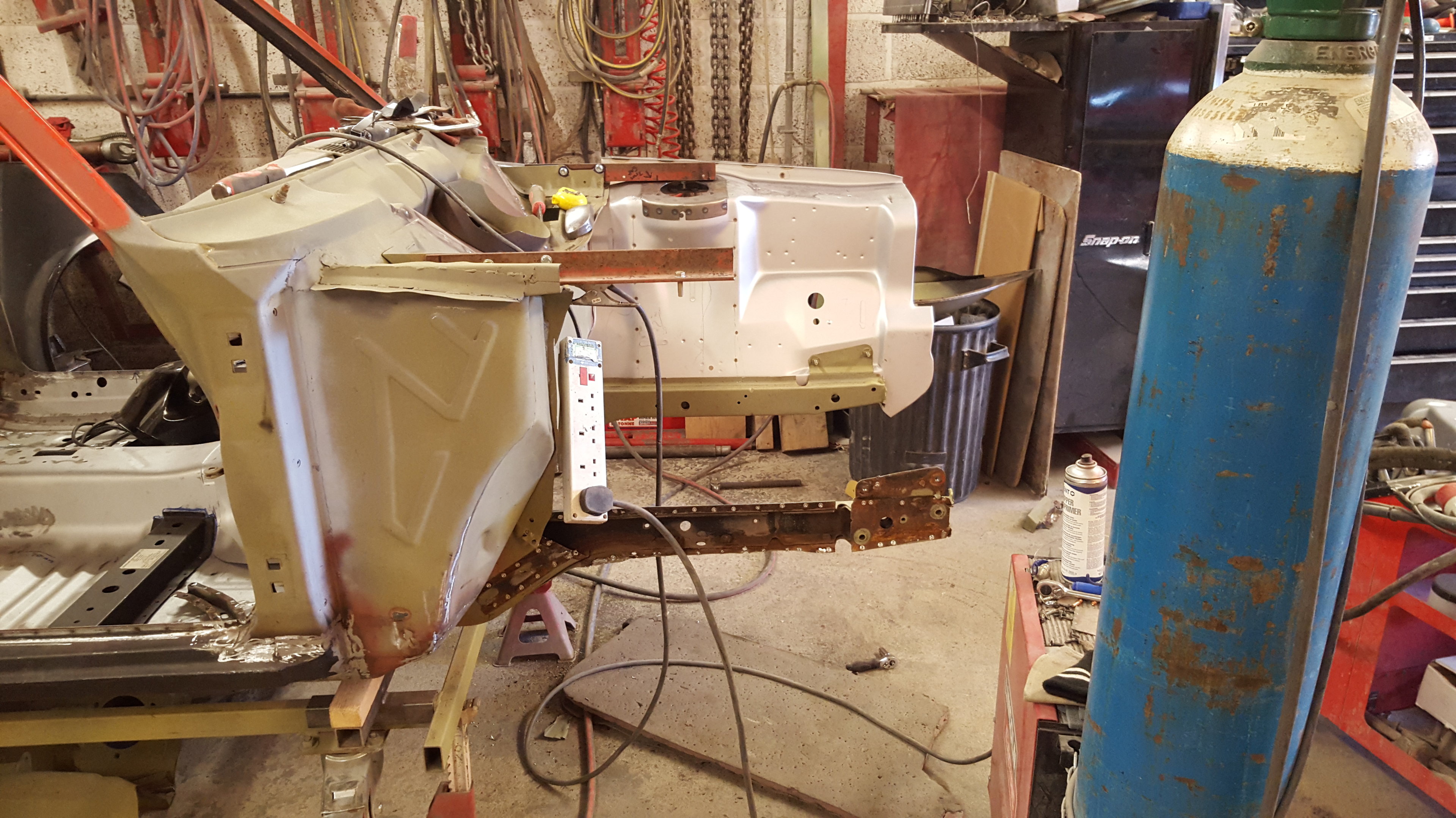

Jealous of your ability to weld.... I need to get on that I think.
I got my shell rolled over on mattresses in my garage (bit pikey) and then stripped it all back. I then had a thin layer of protection added again. Not as much weight saved as removing it all, but I still want it to last.

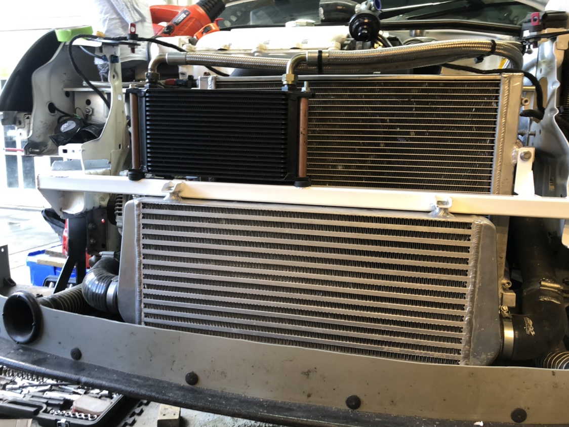

New intercooler arrived.
Obviously it’s heavier than original.
So some of the weight I lost I immediately put back. But I’m my head benefits are greater than 1.5kg difference.
Made new brackets for it out of half box section. Lick of paint and we good to go.
Fits perfect!
I am happy :) and yes I know it’s overkill. Possibly won’t give me anything but tiny bit of extra turbo lag. Time will tell. At least it’s future prove for when I go high boost.

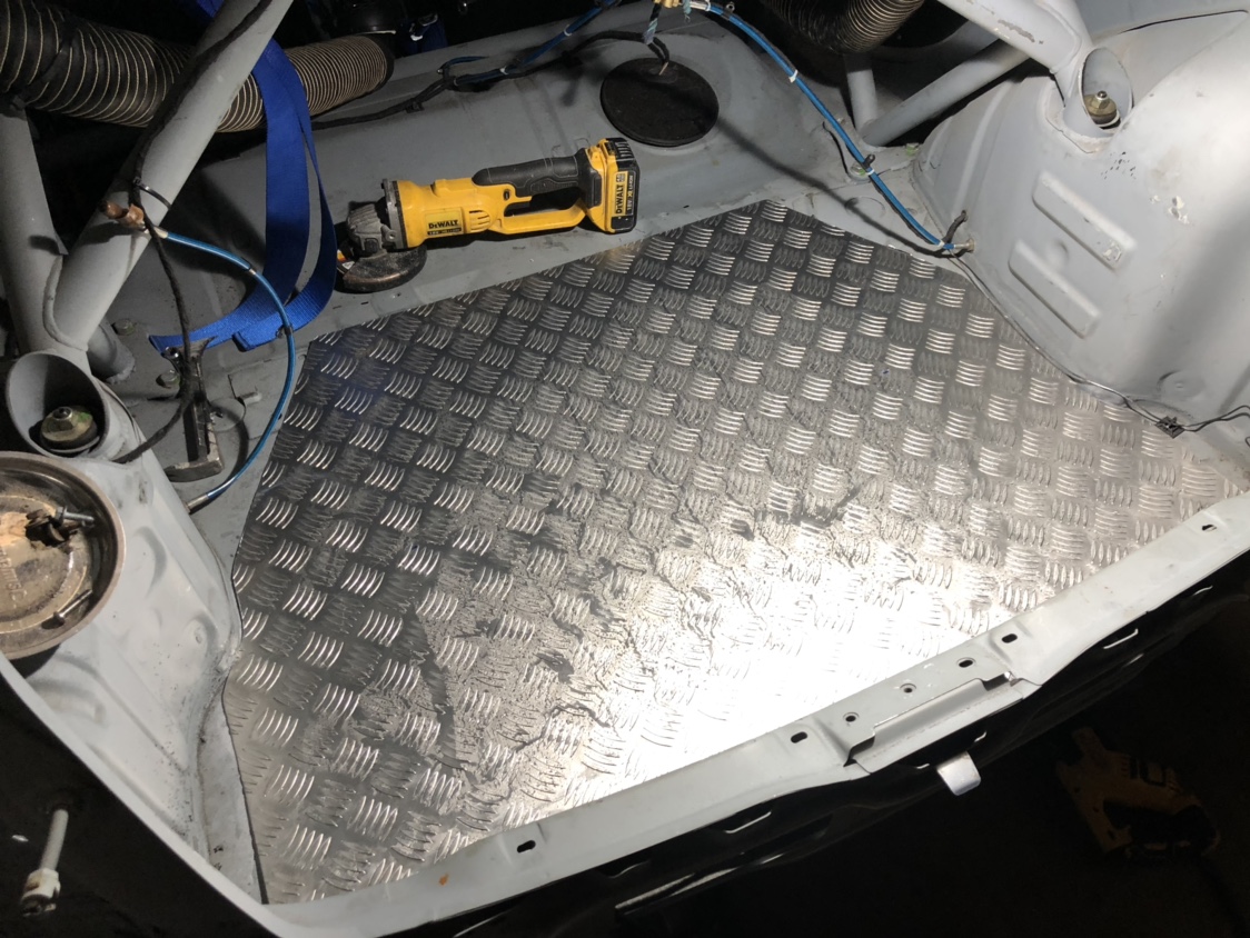

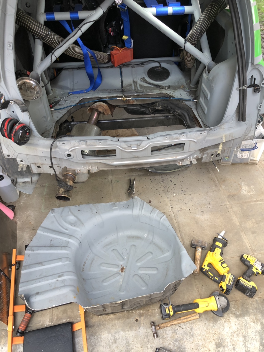

Moving on to phase 2. The rear.

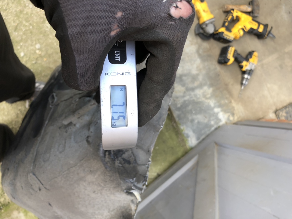

I am actualy surprised how little it weighs. 7.15kg. Was expecting over 10kg.

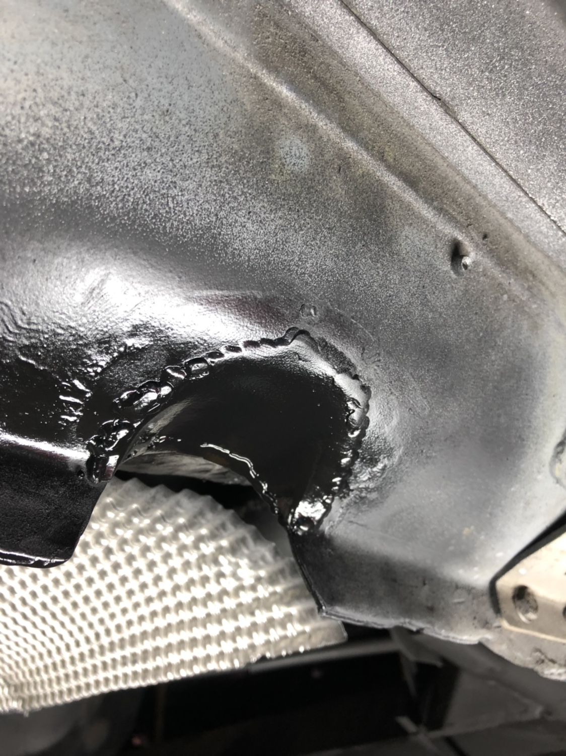

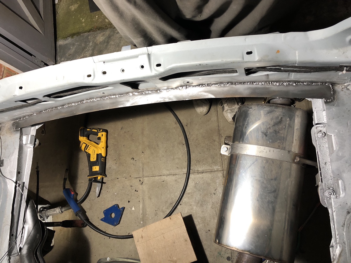

Made a reinforcing lip on the inside so floor can sit on something. Not my best welding job as was spitting and blowing holes :( but will do.

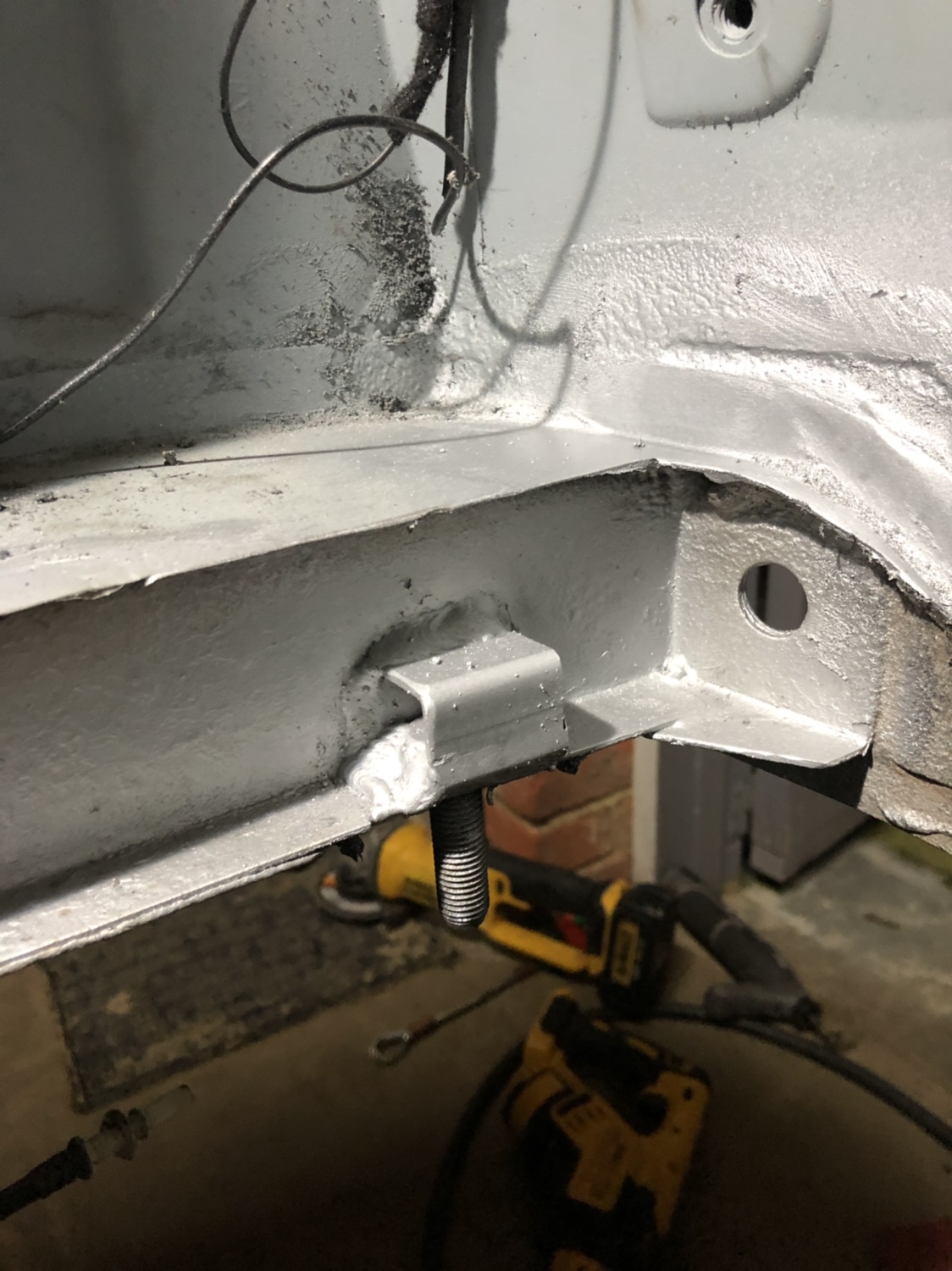

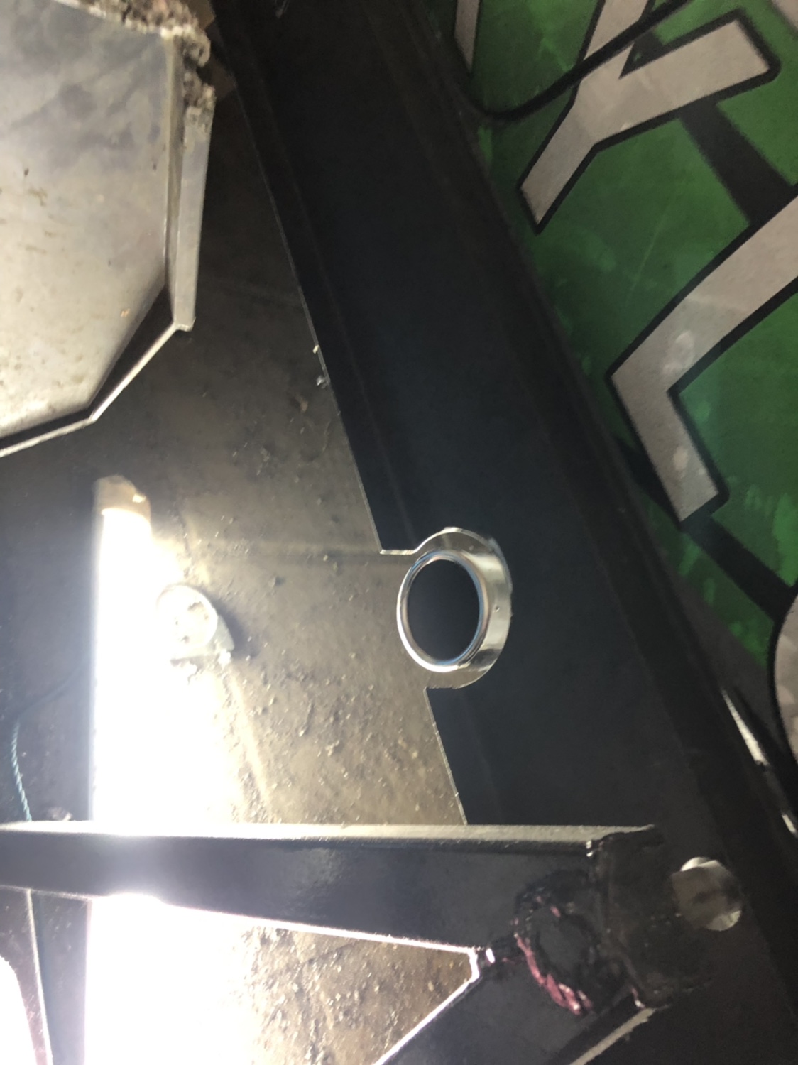

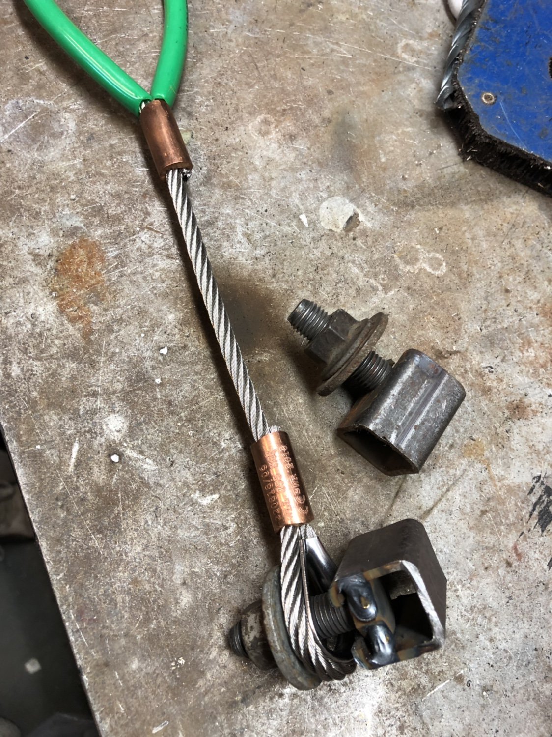

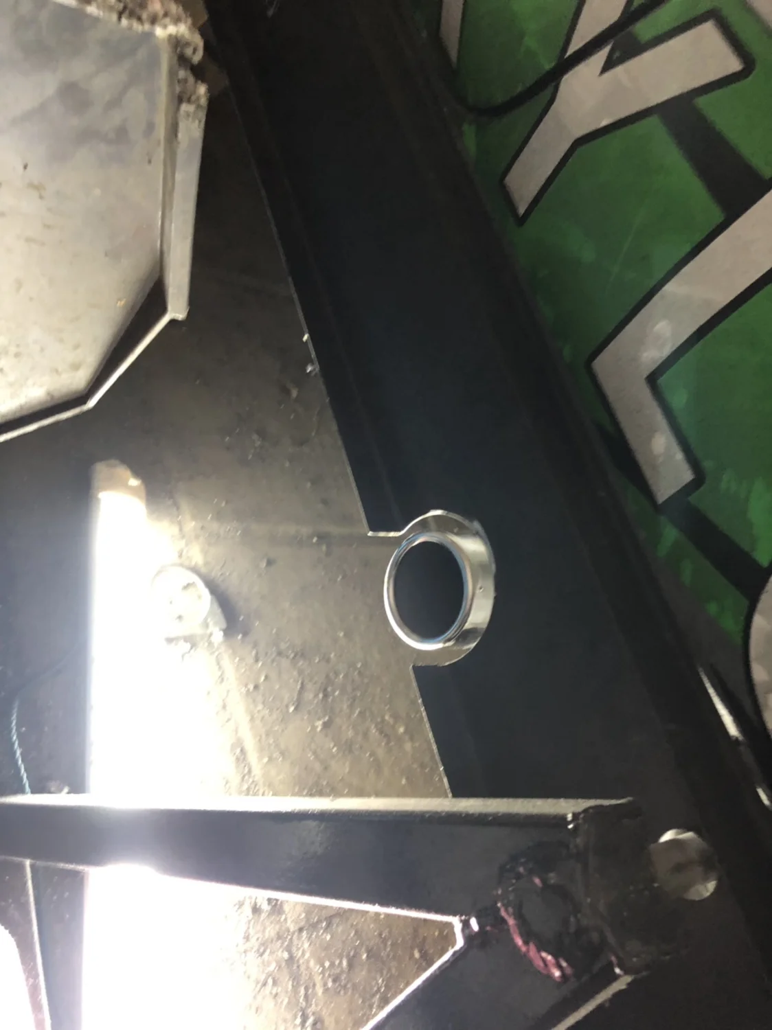

Almost forgot. Decided to fit wire toe straps all round. 4 in total. I know I know. Losing weight and adding it back on. Makes no sense.
So made brackets of sorts out of 25mm box section. With high tensile m12 snug in the middle.
welded to the chassis
should be plenty strong. I hope will never get to use them.

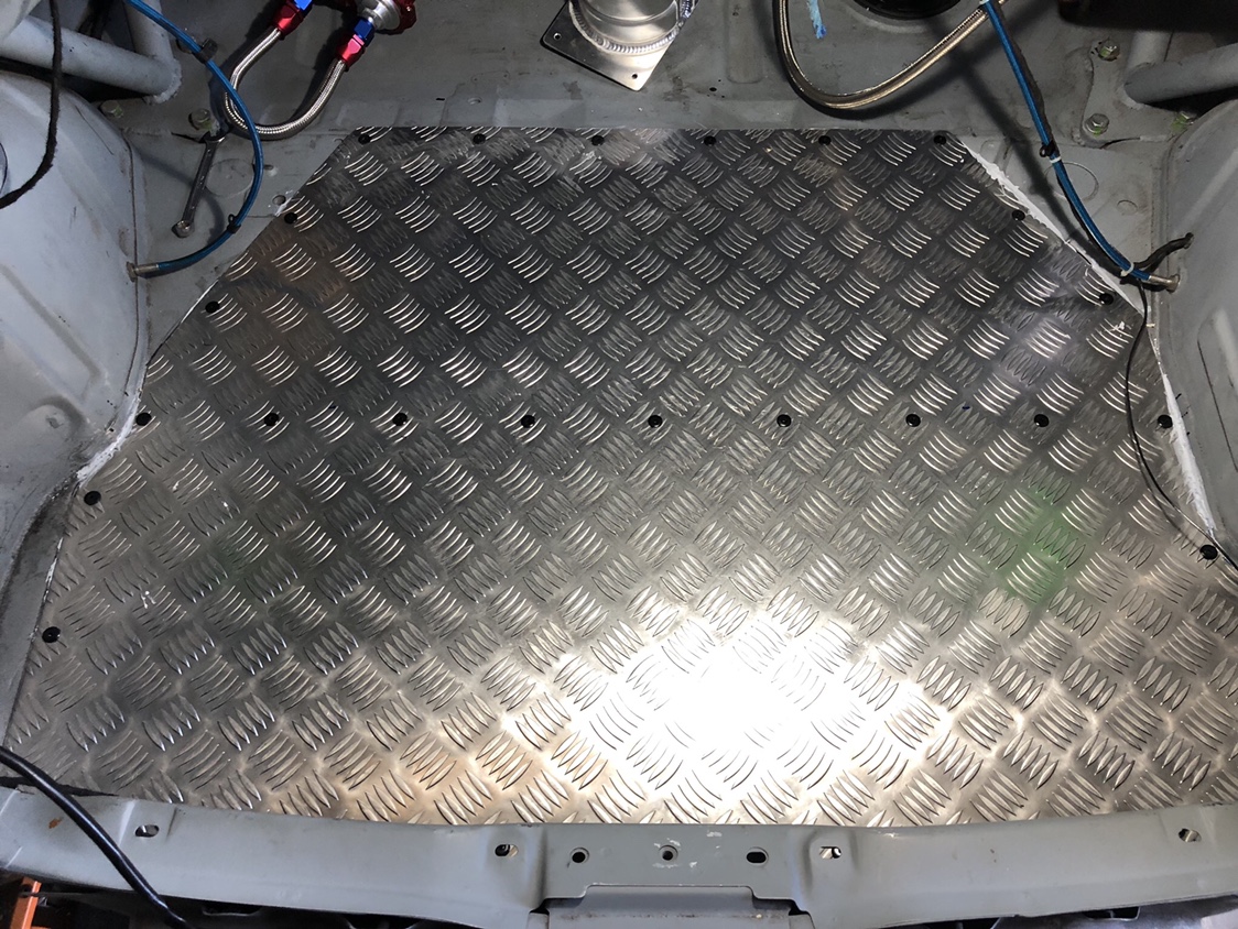

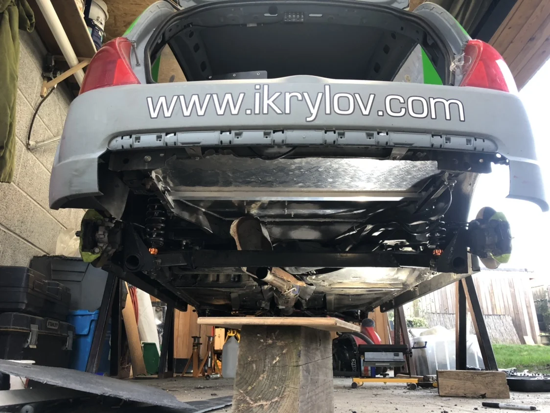

Flat floor cut to shape.
will be fixed in place with panel sealant and rivets. Weight 2.05kg. So overall saving is 5.1kg on rear and 2.95kg at front. Total 8.05kg lighter. Some may ask, is it worth doing all that for 8kg? Probably not. But this will ofset the added weight of swirl pot and a diffuser. So far 3 solid days spent on it. 300g per hour roughly [emoji12].

Galv makes it hard to weld and why it spits so much. We use scotch wheels on the grinder to take paint and galv off to get to bare metal without grinding metal away making it thinner. People don't realise how hard it is to weld 0.8mm body panels. Any monkey can weld 2mm+ so good effort m8
RuskiWeldFab
  Clio 172, RS4 B7
Yeah I used a wire wheel as well to clean as much as possible. 0.8mm welding sucks! At least I wasn’t upside down lol.

Flat floor is complete. Sealed and riveted. Even tho there wasn’t much flex I still decided to introduce aluminium brace in the Center.

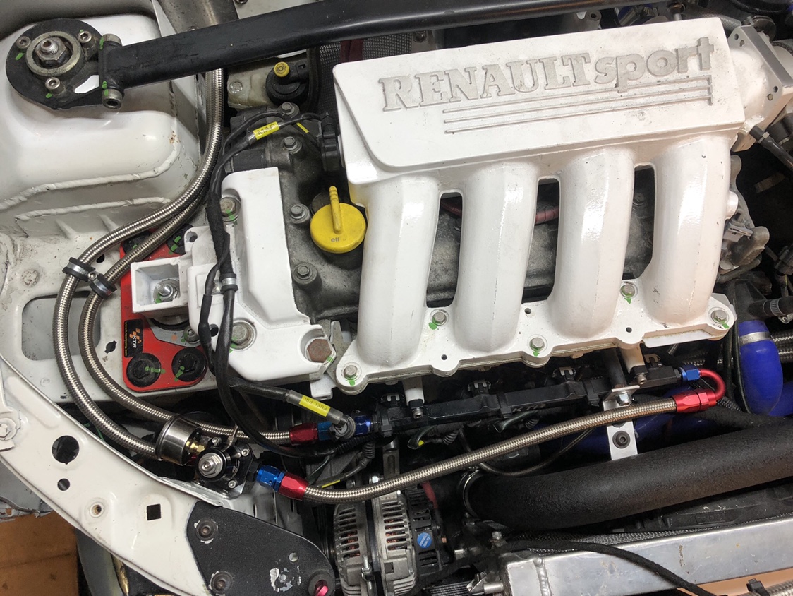

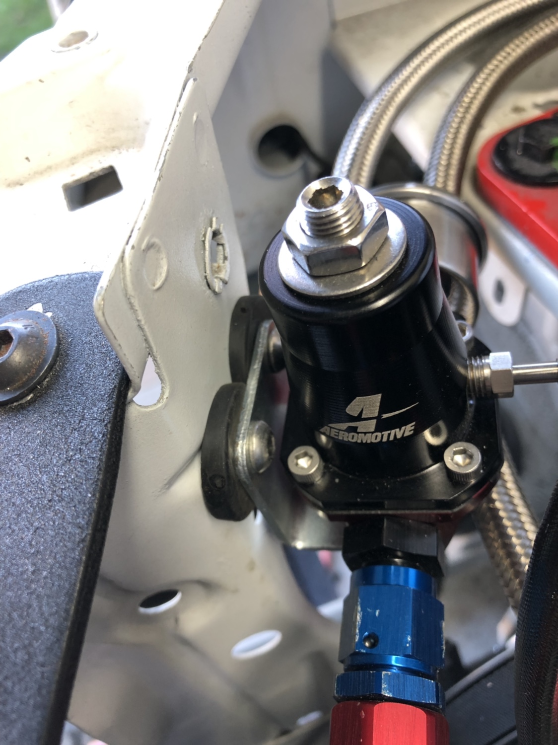

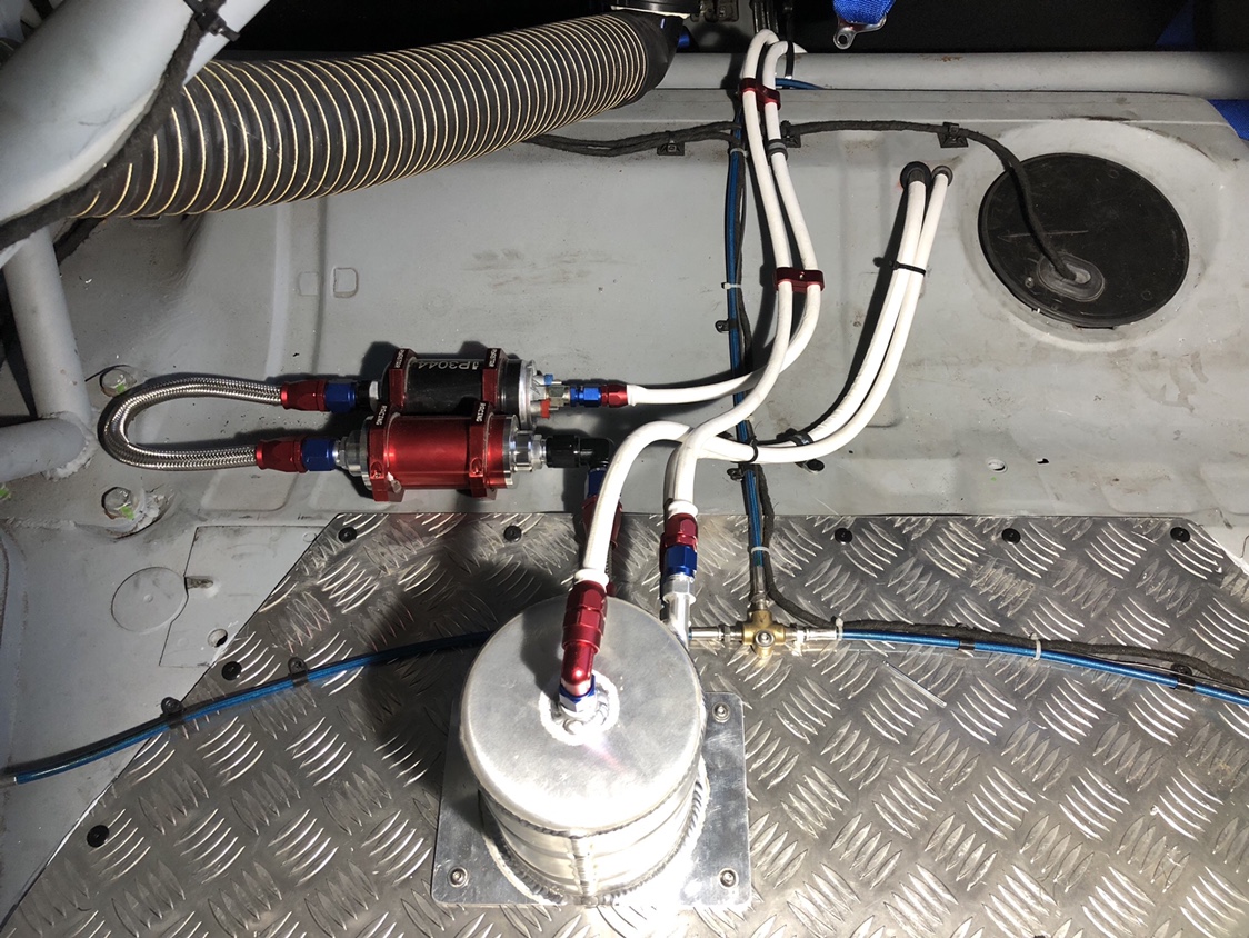

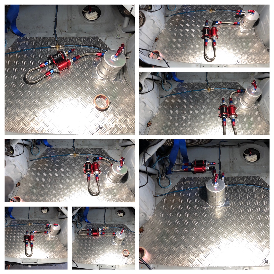

Next was to install fuel regulator and a return line.
Now for the swirl pot.
Struggled to find best position. There were some good contenders lol
decided over the axel as far left as possible probably best.
Here is the final (not quite) version

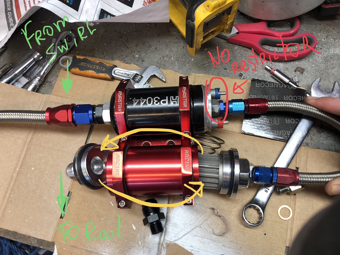

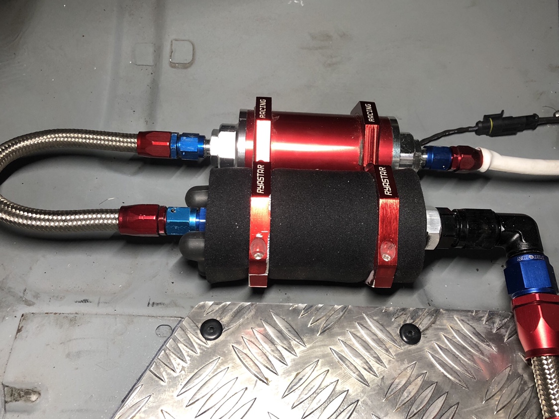

I couldn’t believe how noisy they are OMG!
But mine was sounding struggling. Decided to swap filter with pump. Remove restrictor. Turn filter around. Fit rubber bobbins and some neoprene cover.
Much better!
Adjusted to 3 bar. Should be good now. No more file starvation.

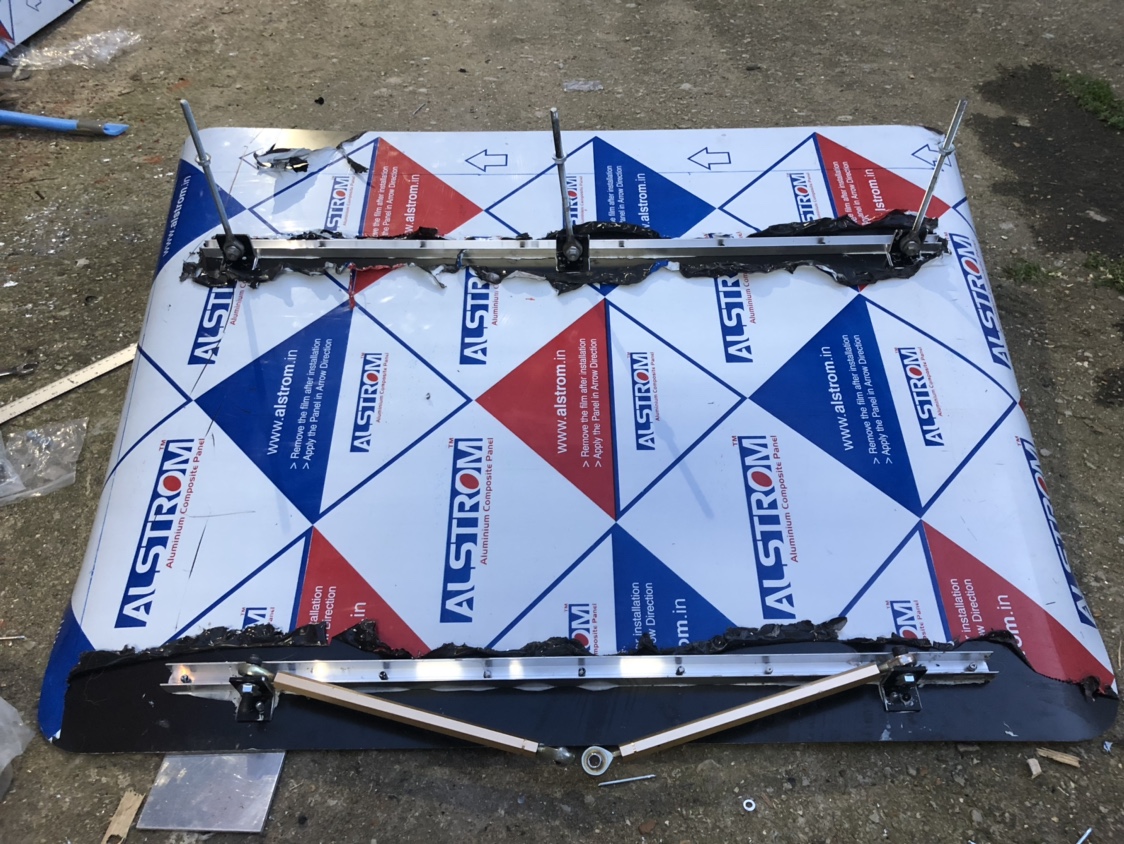

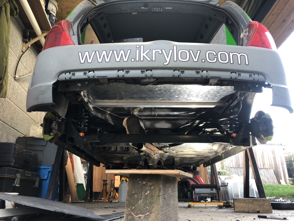

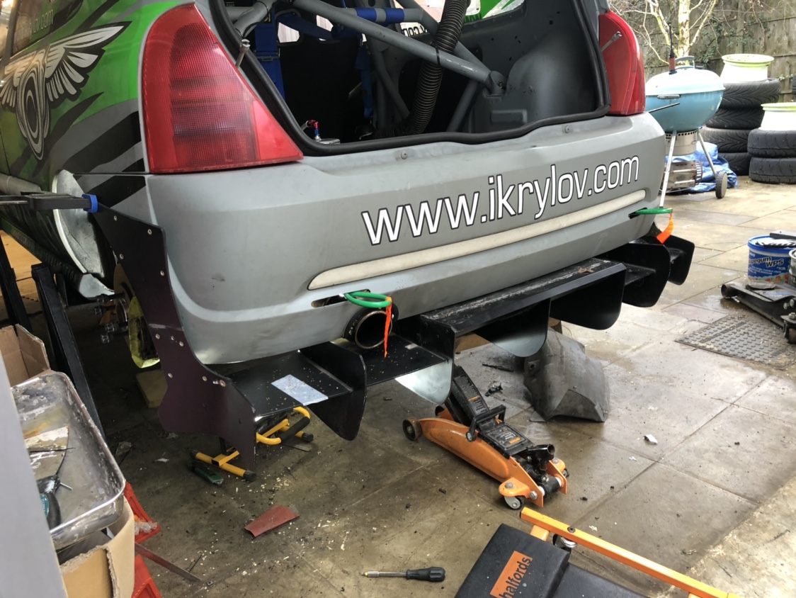

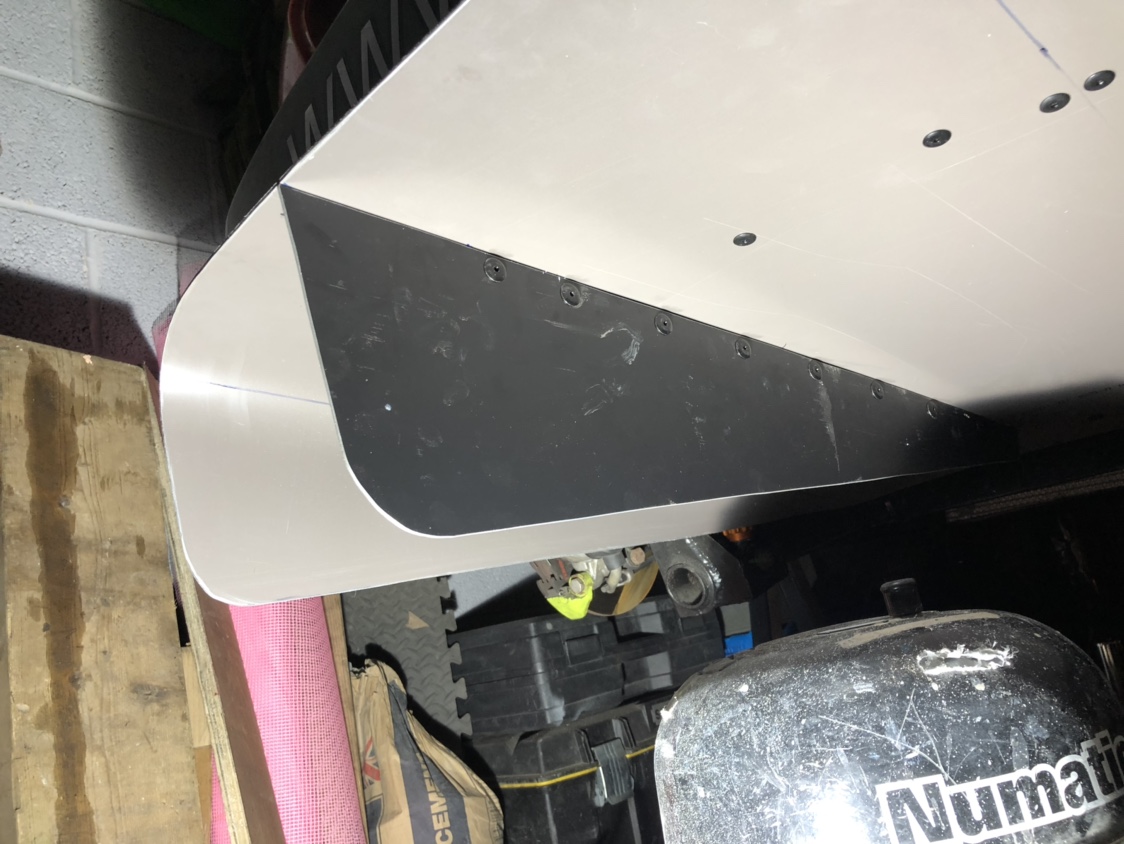

After swirl pot was next stage. Rear diffuser.
Been reading a lot about aerodynamic, flow separation, vortex generators, lift, drag, ... list goes on. To say it’s an easy subject would be wrong.
Anyways. I had an idea of what I wanted.
Previously I bought this diffuser. Looks very very nice! But not as light as I wanted it to be. Especially after all the hard work trying to lose 15ish kg. Wasn’t gonna put it straight back.
Here is the one I bough. By the way, if anyone is interested, it’s for sale.!

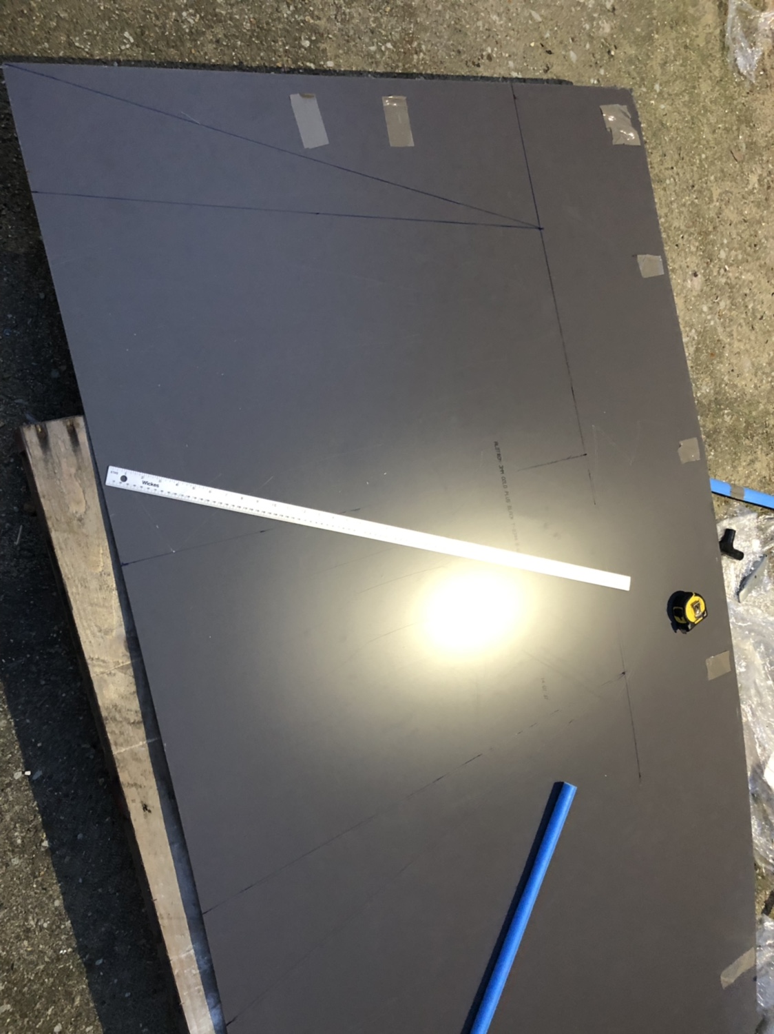

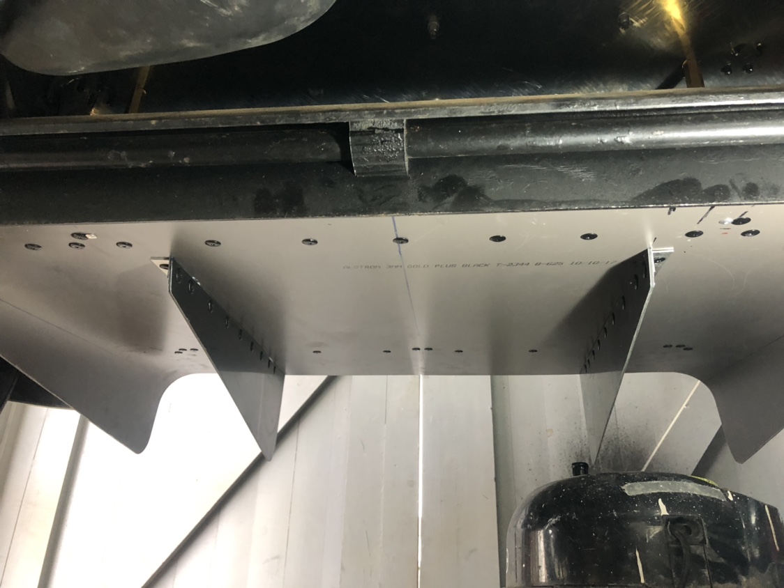

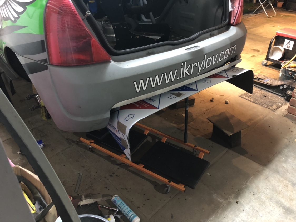

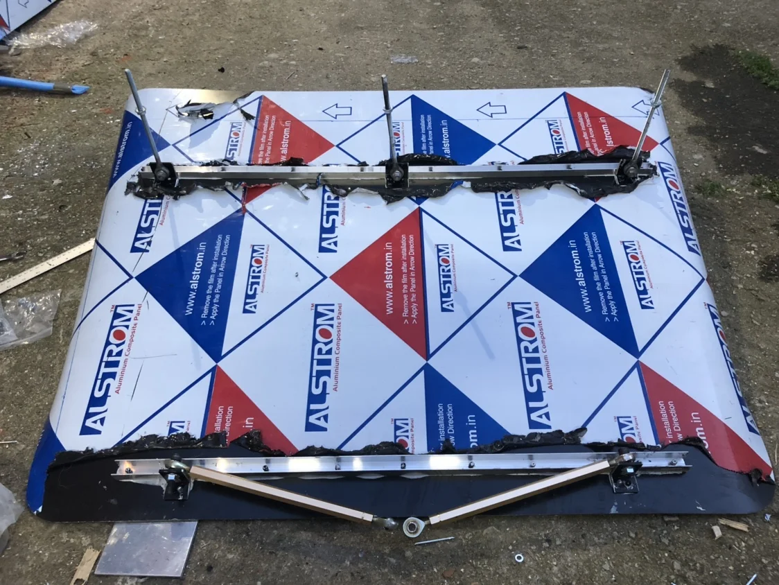

So I measured it up to my car
and decided to make my own.
Used 4mm composite sheet.
Measures once cut twice haha

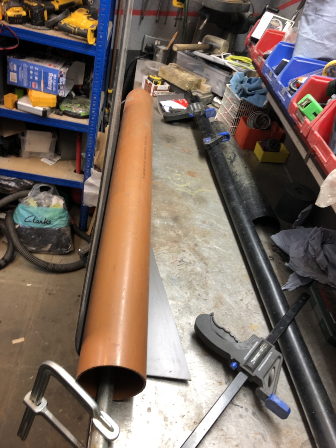

Than I folded the ends with my home made bender using drain pipe.

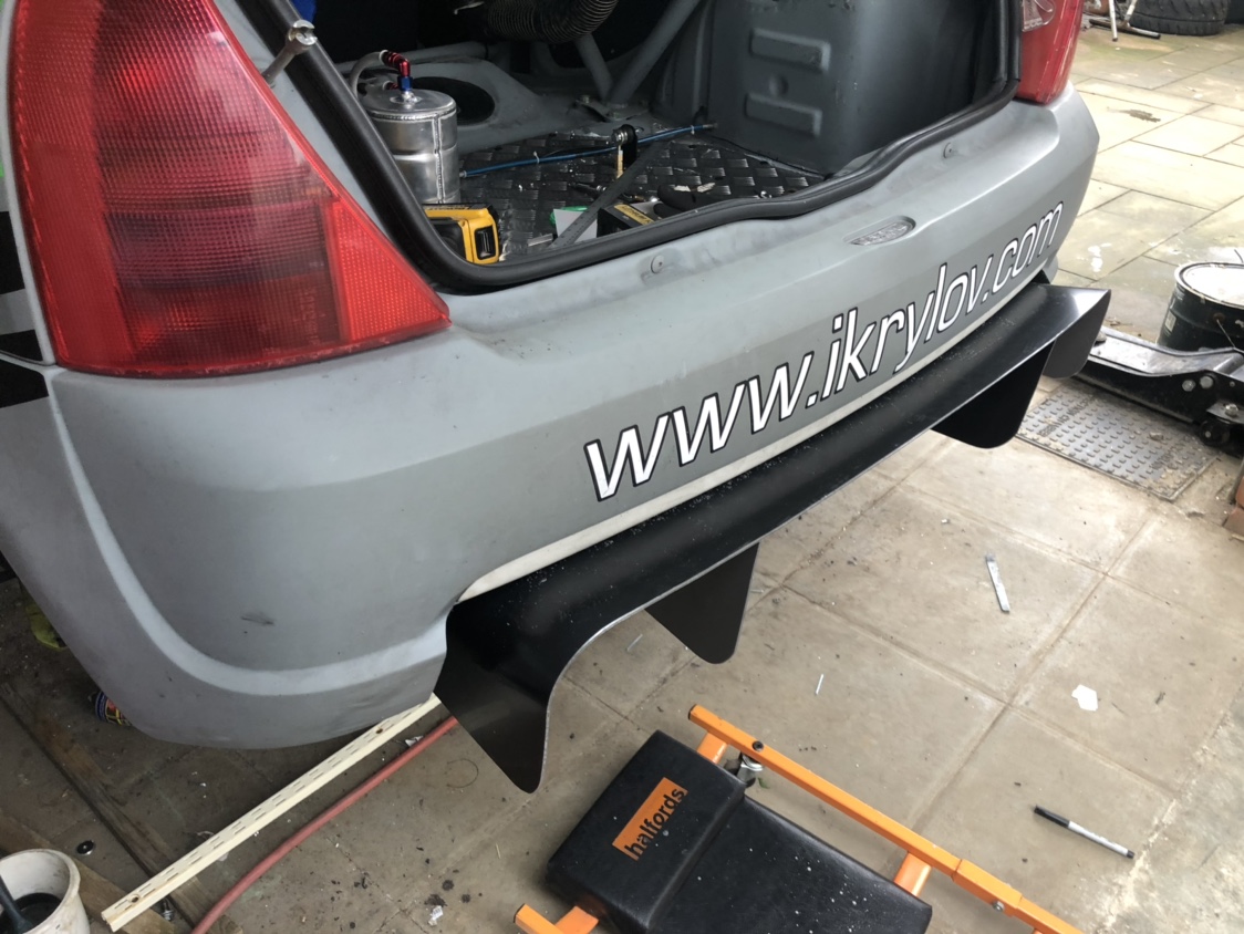

than cut the bumper. (Well I cut it before I bent the sheet lol.)
fits good!

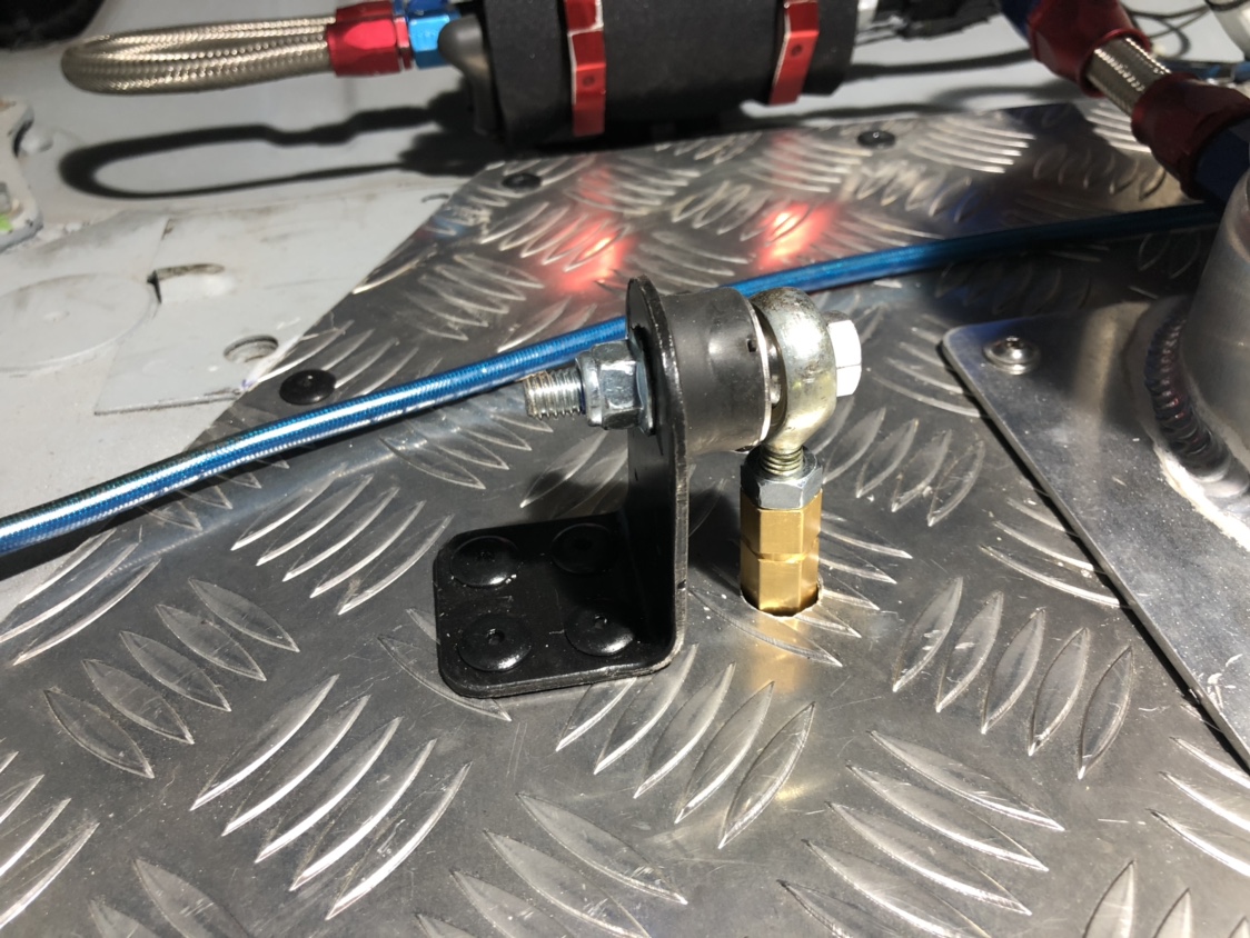

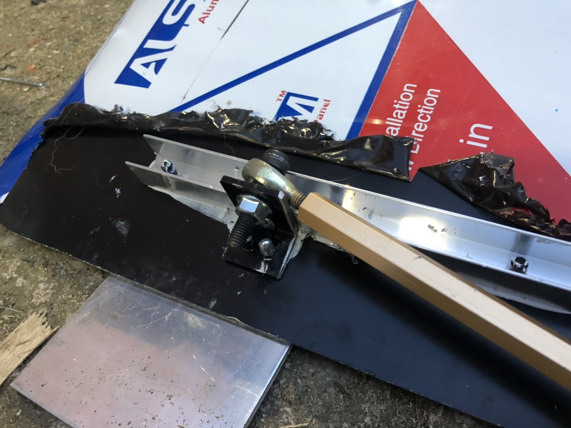

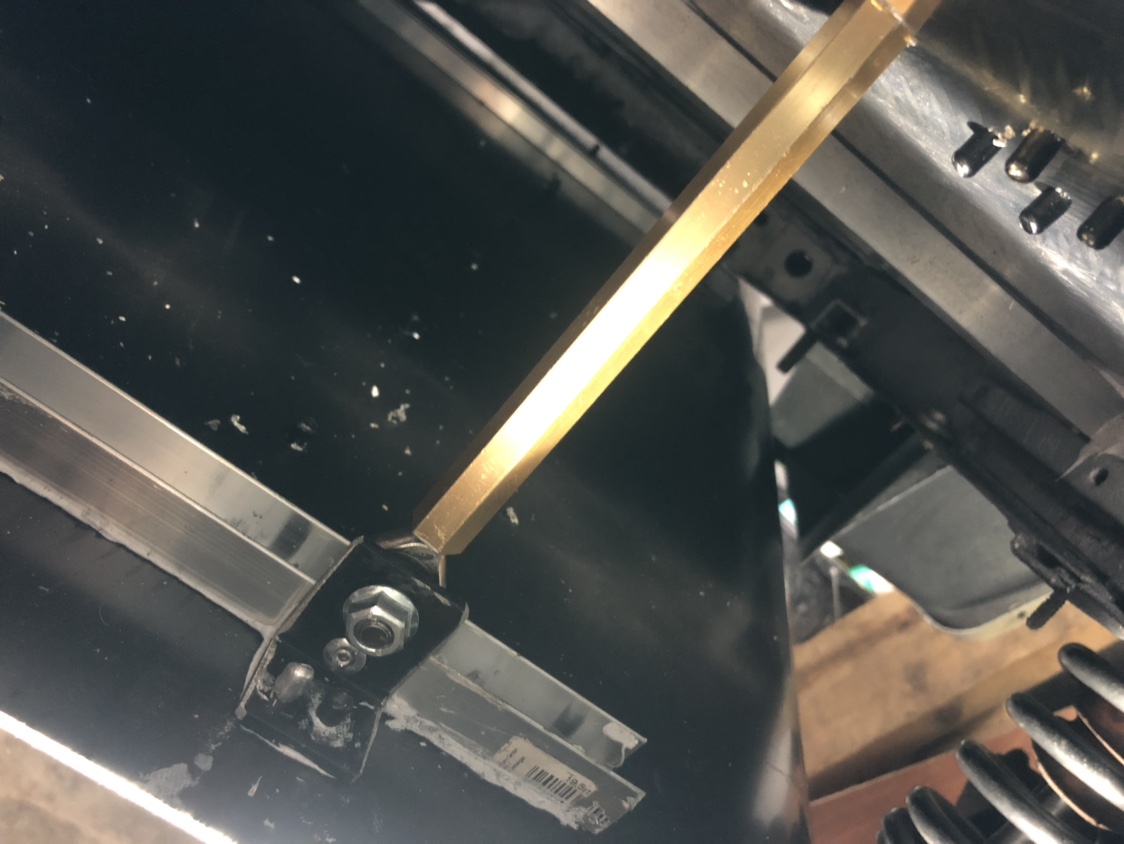

I wanted it to be fully adjustable. Between 6-15deg (will test with tufts at the track)
So used rose joints front and back. At the rear it’s bolted to the floor and can be adjusted by the nuts underneath.
At the front it will be adjustable from inside the car. Again on rose joints and a pair of kart control arms. Made a simple bracket and 20mm rubber bushing. Plenty strong as I can lift myself from under the car
Next decision was how many fences.
Decide only 2 will be sufficient as I don’t have a flat floor.. yet
think it looks mean as hell [emoji41]
Some may ask where is you exhaust? Hmm good question.. here is the teaser if you can call it that
Like I said, will test with tufts for flow separation etc. Will adjust accordingly. I am not expecting 100kg of downforce. But being optimistic here.

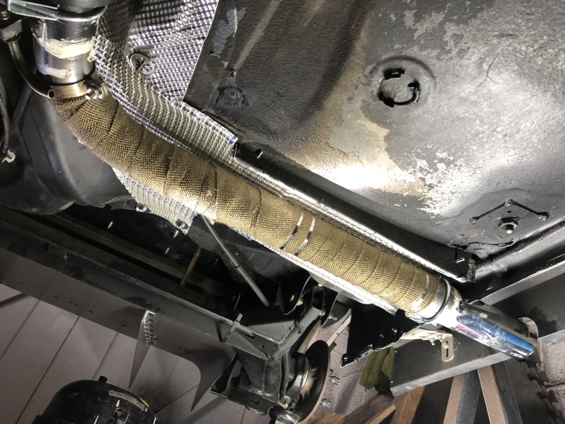

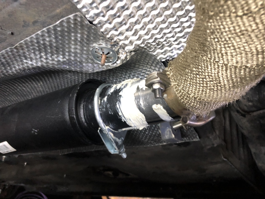

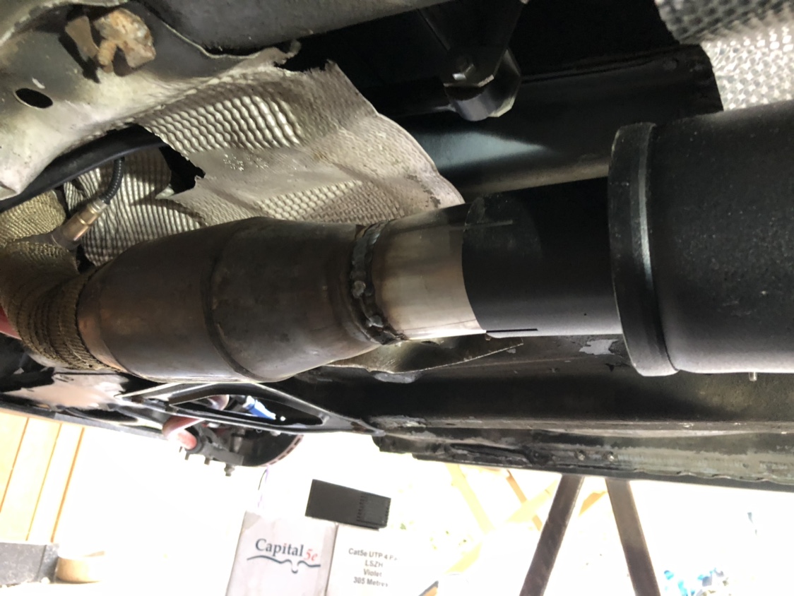

Small ish update.

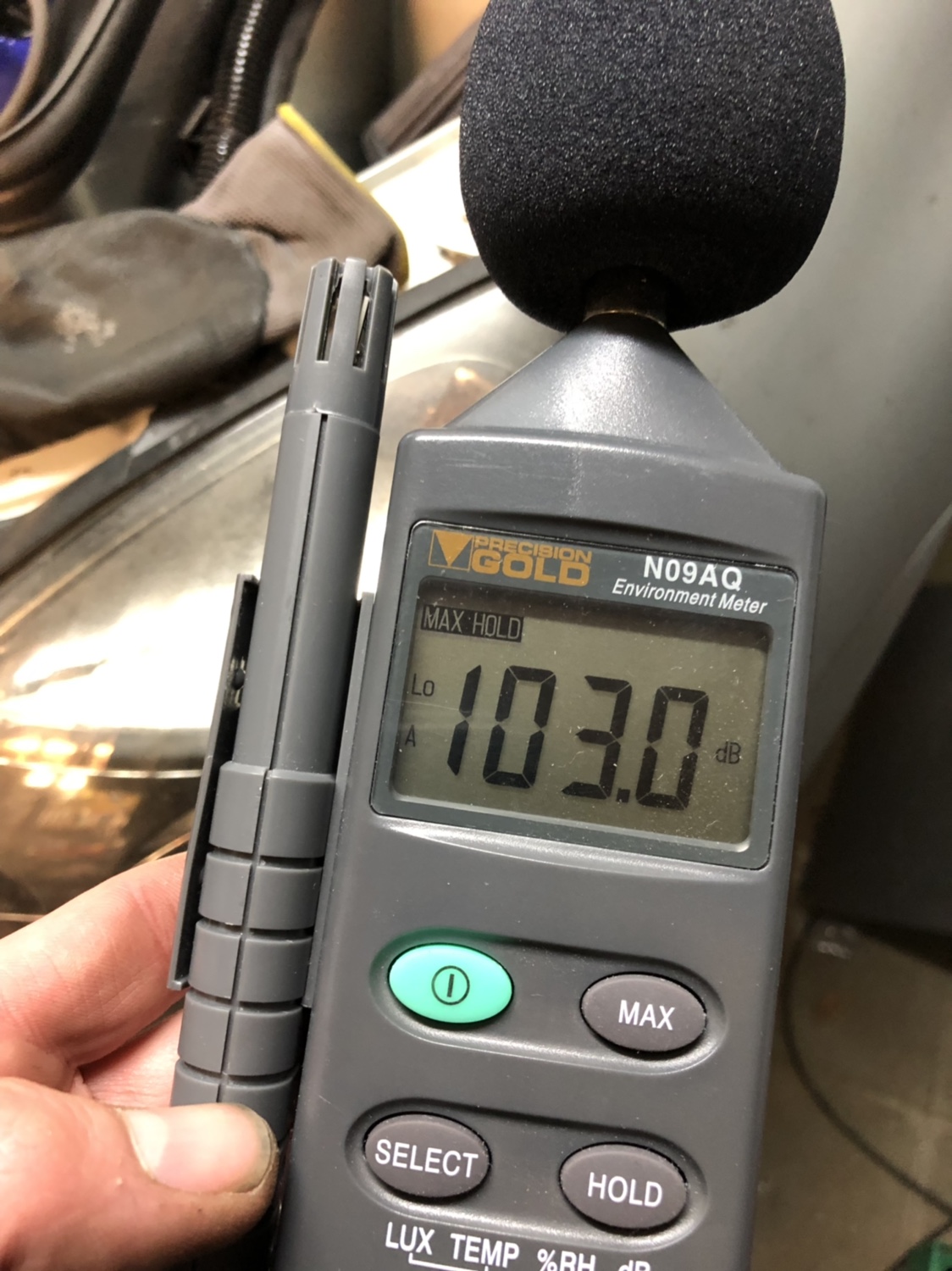

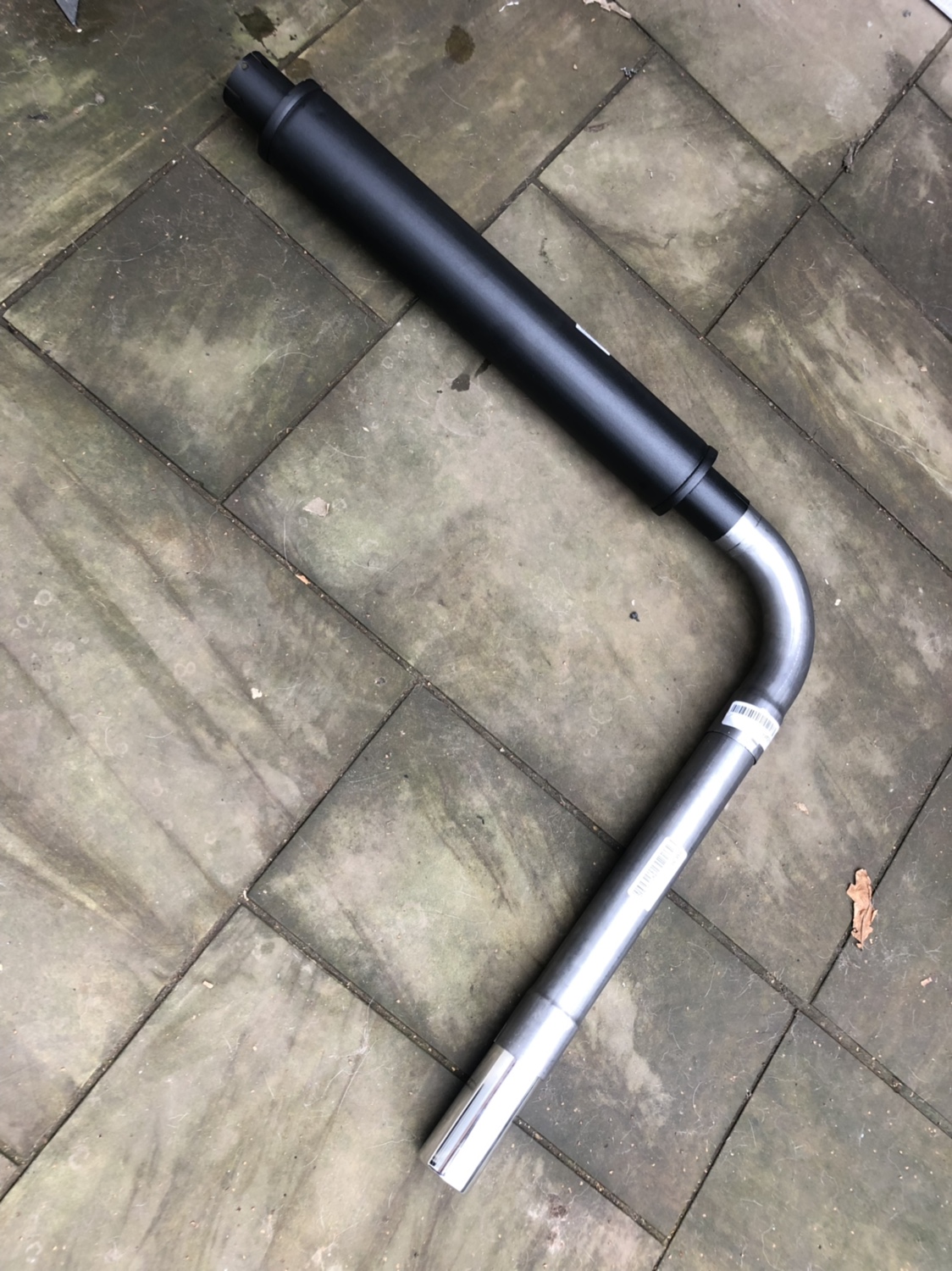

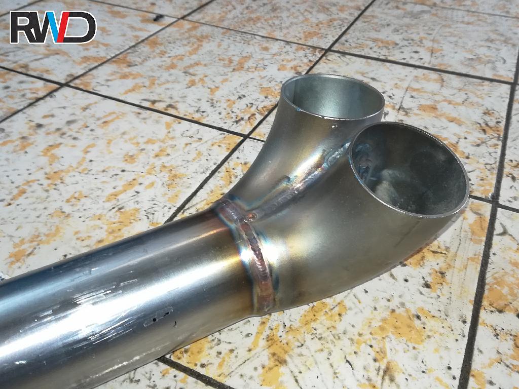

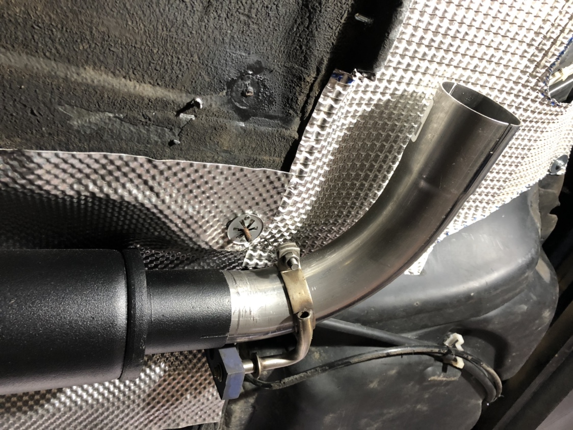

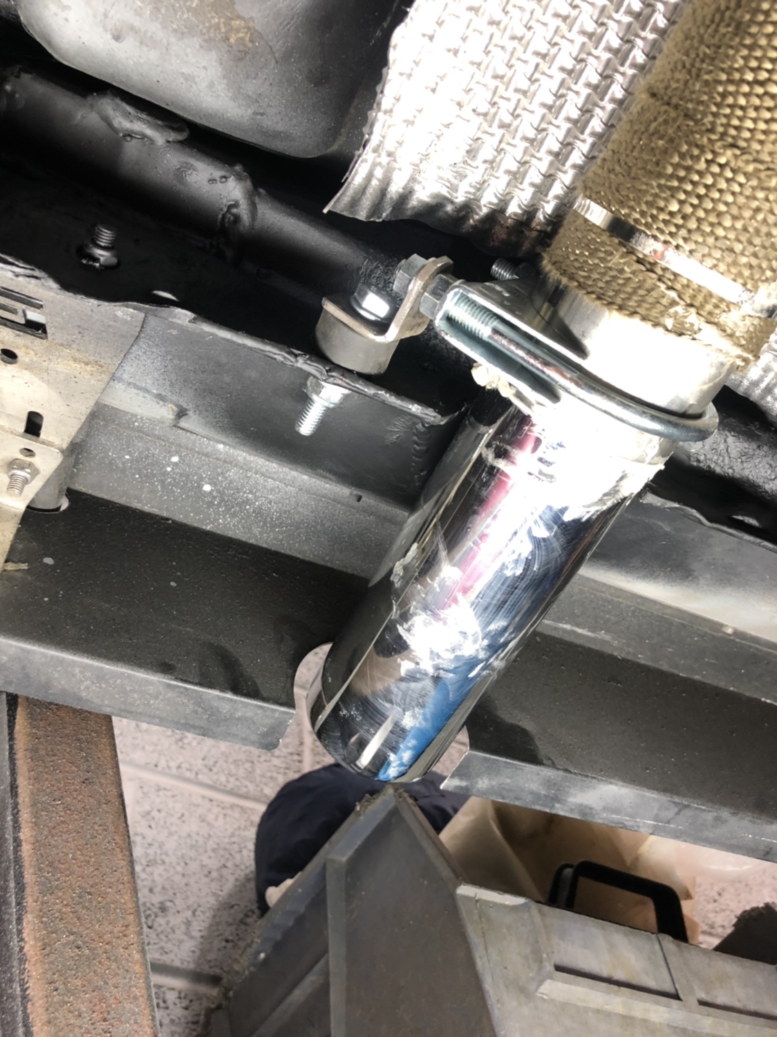

Exhaust is on. And, well I think might be a tad too loud lol. Didn’t even test it properly. Bouncing on the rev limiter at 3k while oil still under 60deg it maxed at 103db. My gauge could be lying. Or it amplifies the sound being close to the garage wall I don’t know. But not even gonna bother drop it in the ground and go for a test drive just yet. Ordered custom 3.5” silencer to go under fuel tank. And resonated tip. A bit more cutting, welding, head scratching and test again.

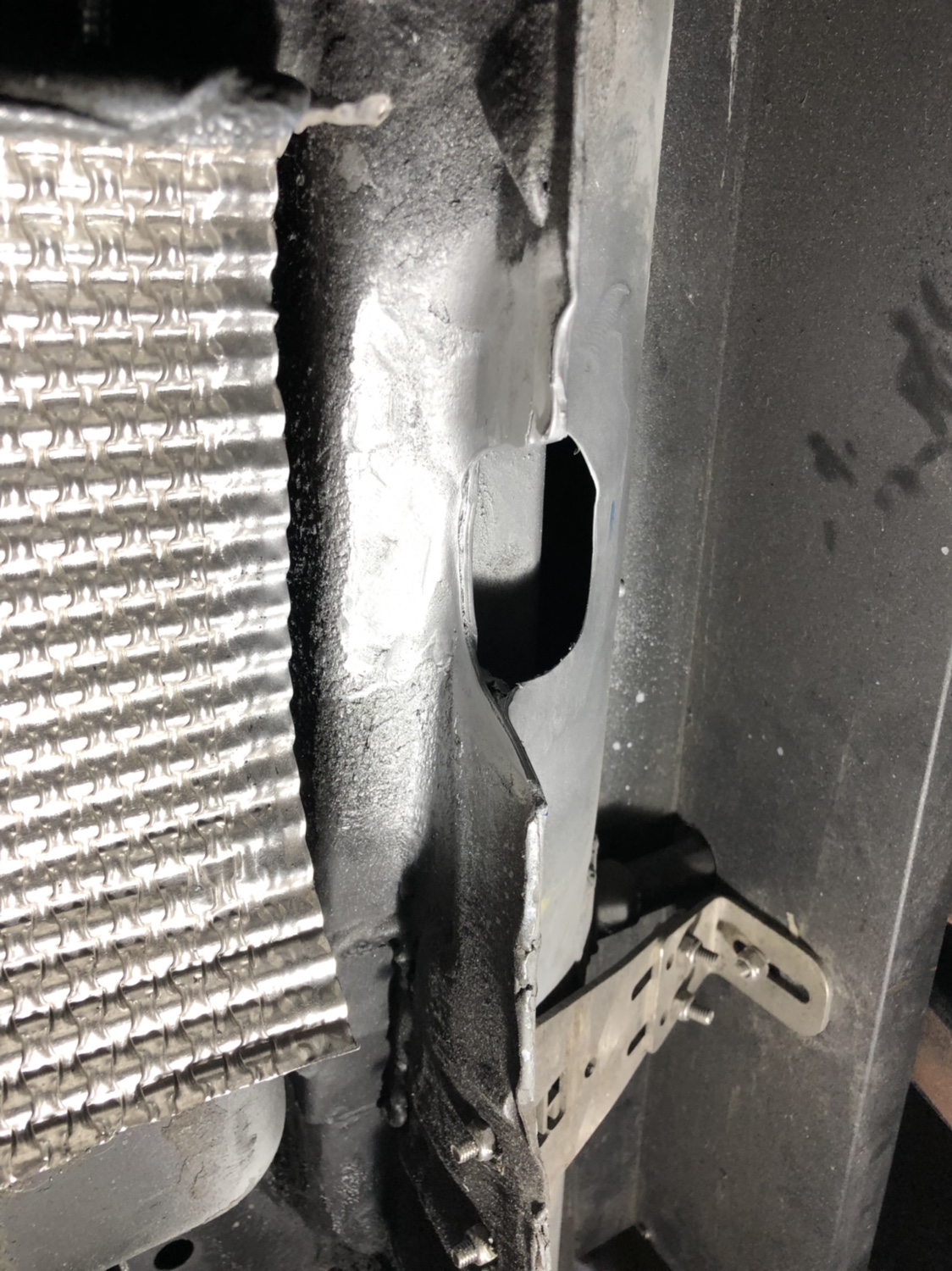

Looks good tho [emoji41] had to make a notch on the frame for clearance as well.
massiveCoRbyn
  Several
Took quite a bit of work to get my side exit under 100dB, although I am NA rather than turbo. I run a big silencer and also some small half moon baffles before the tailpipe
RuskiWeldFab
  Clio 172, RS4 B7
First will try another silencer under the tank. If it doesn’t work, baffles and bigger Center silencer
RuskiWeldFab
  Clio 172, RS4 B7

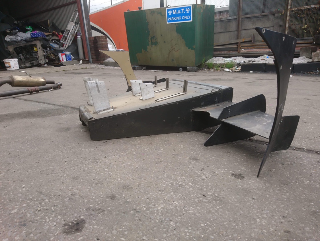

Interesting. Where does this fit? Those aren’t the tips are they?
massiveCoRbyn
  Several
Need to go oval if you can.
Would agree with that. I went from a round silencer to an oval (overall volume was similar) and dropped from 118dB to 102dB.
Two semi-circle baffle plates got me to 100ish, then another two and I was 97dB, so future proof for a while yet.

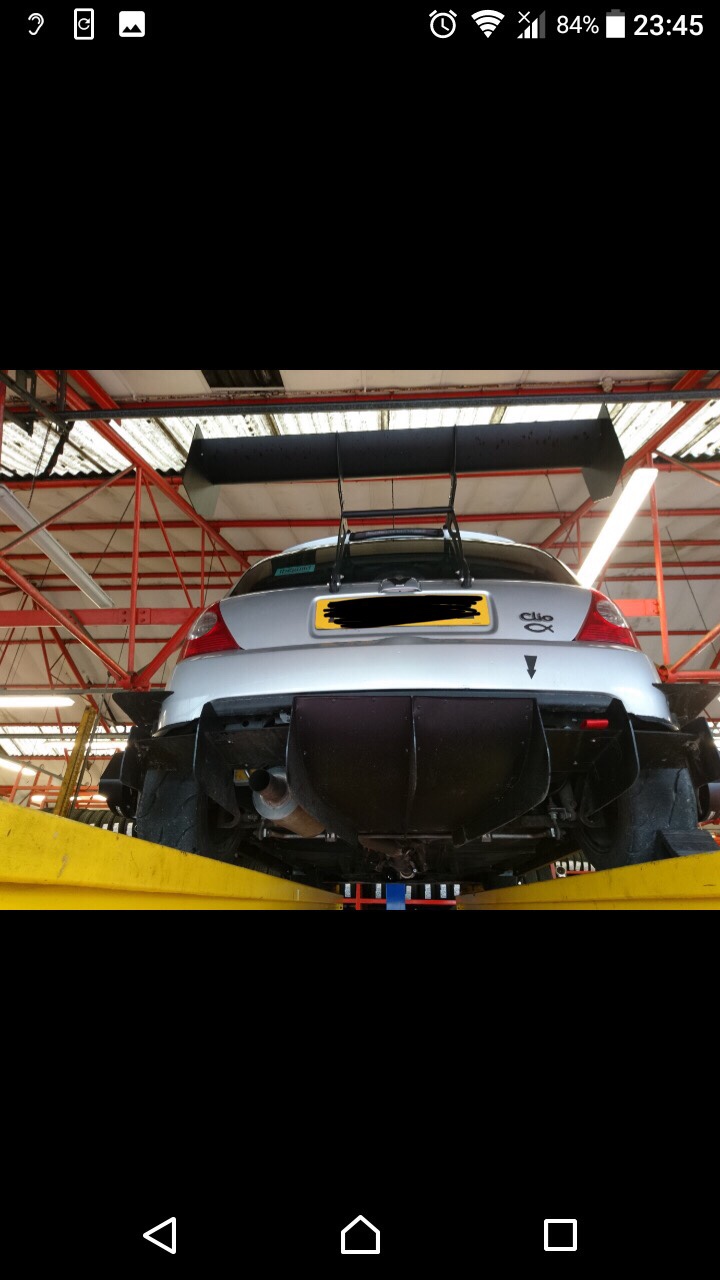

Do you have any pictures of yours mate? For comparison
