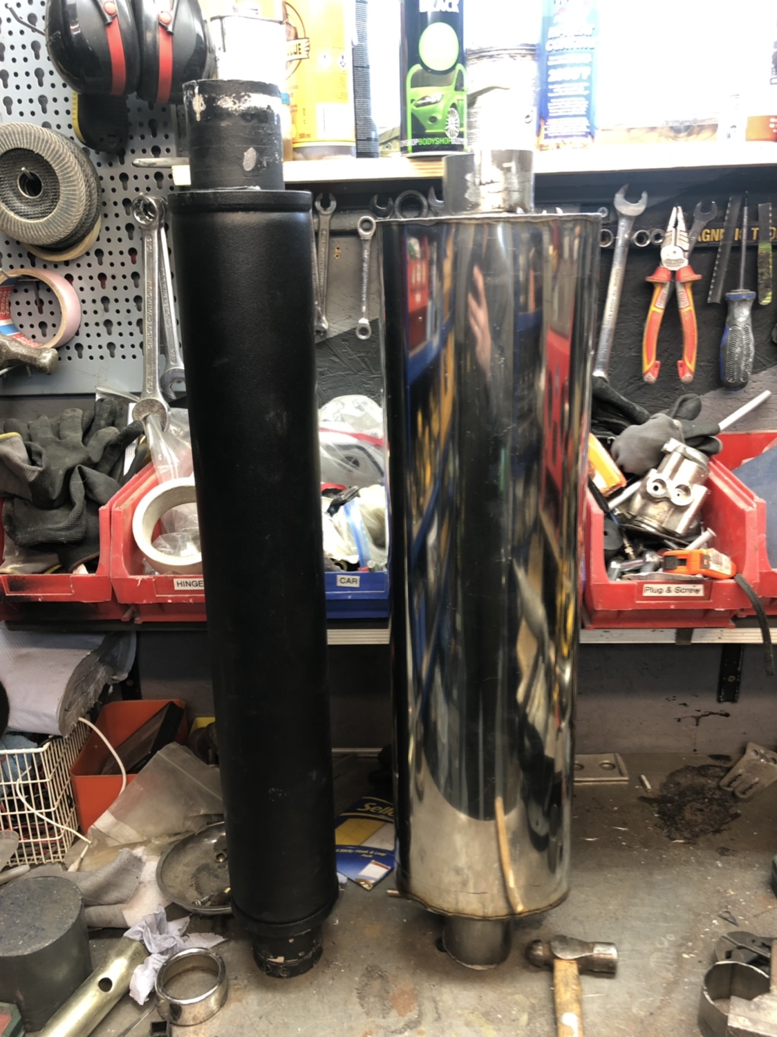

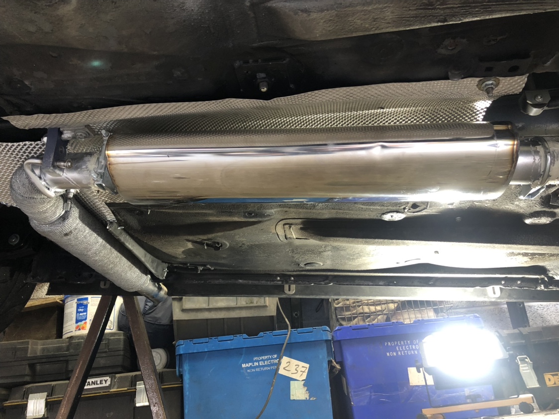

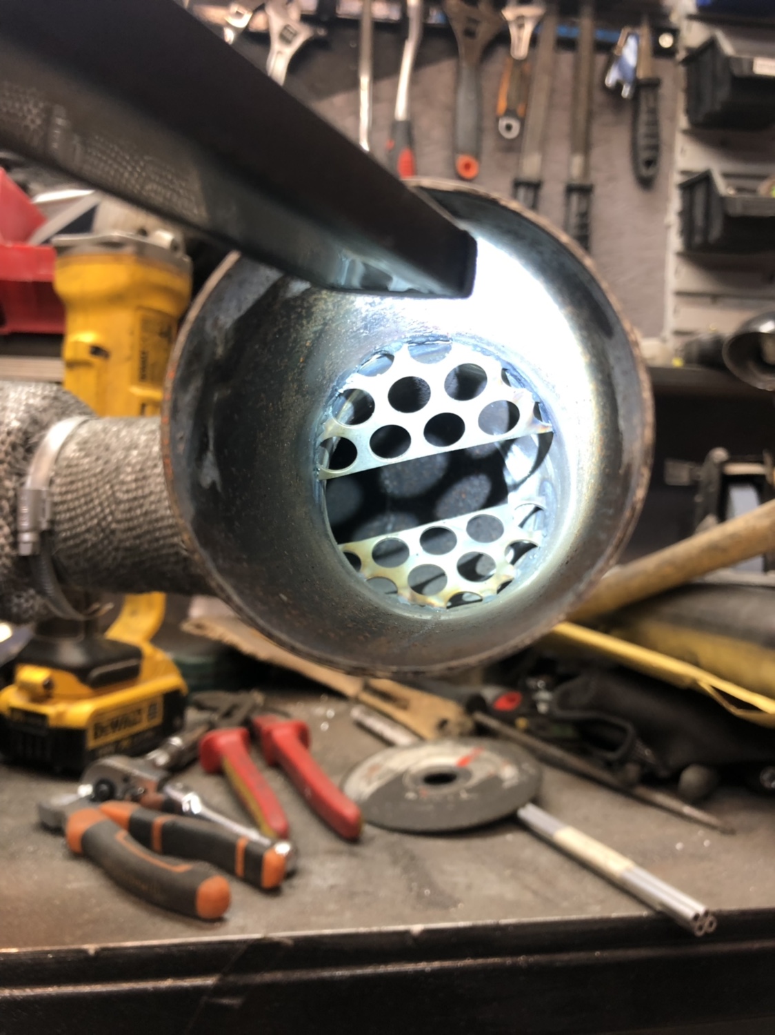

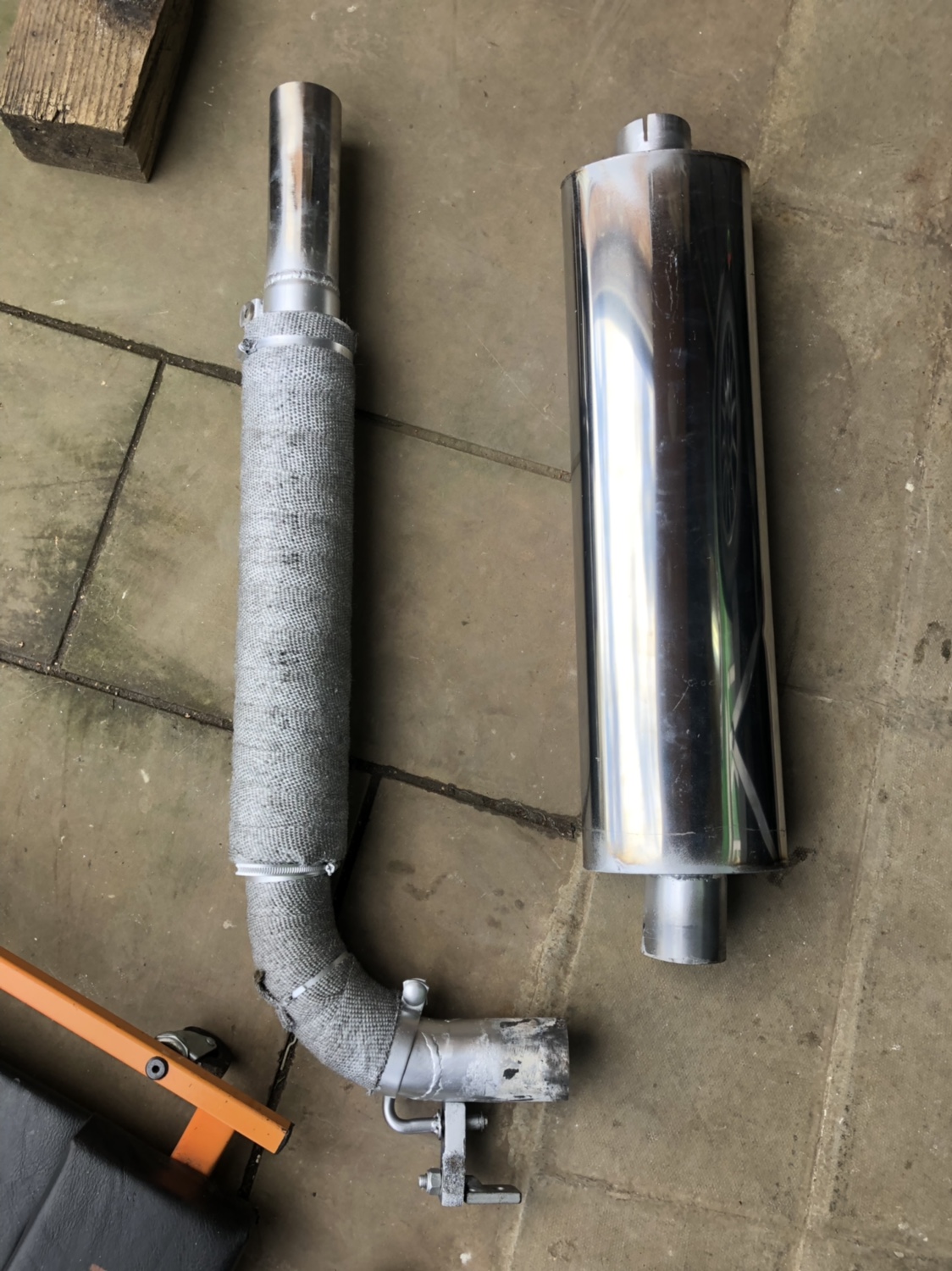

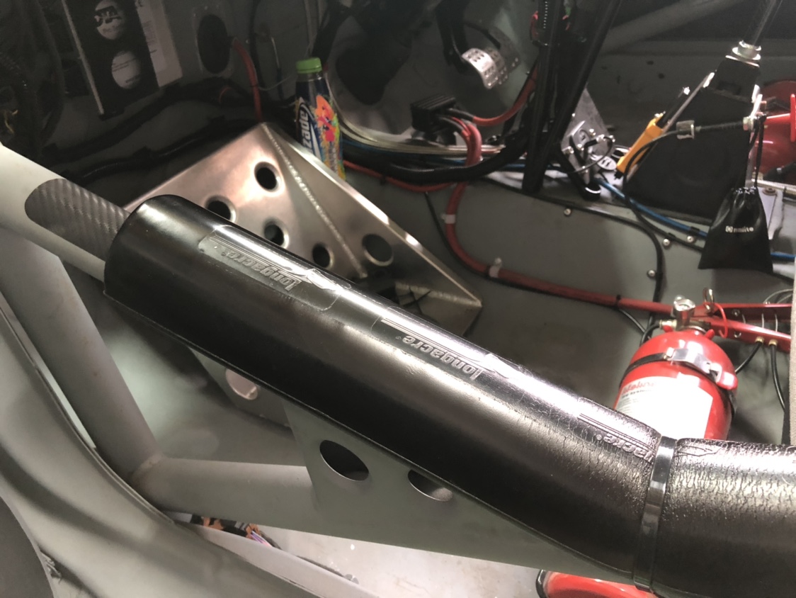

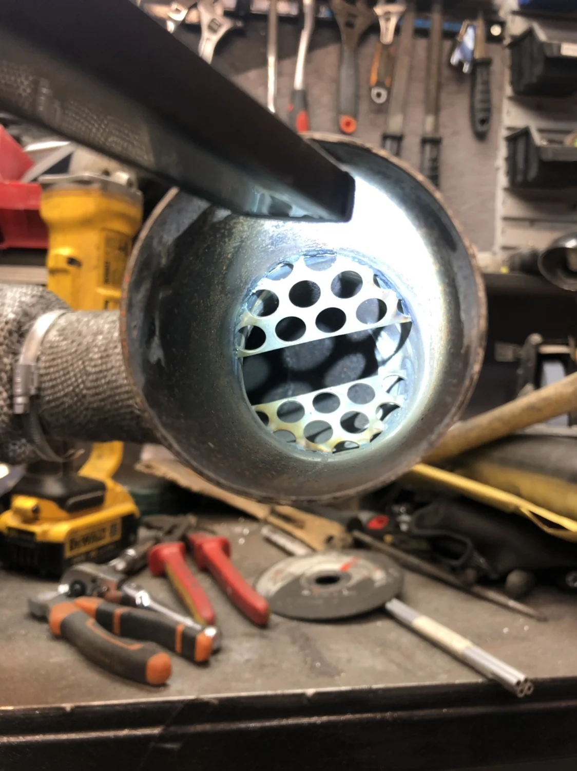

Soo here we go again. 3rd time lucky? Maybe..
Got an oval silencer. It’s 7” wide and 24” long.
Also inserted another 2 half moon baffles in to the pipe. Hopefully this will work!

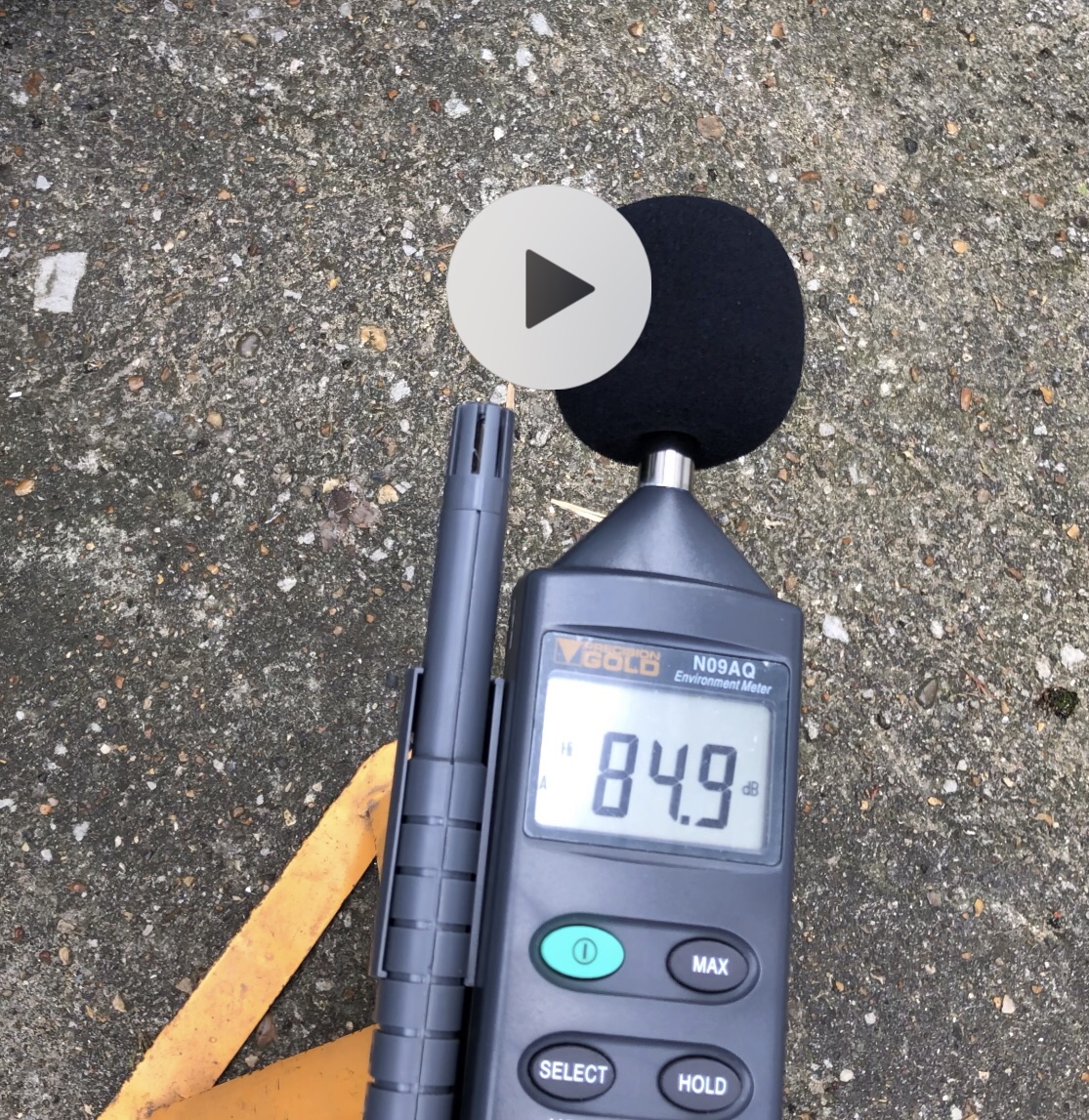

After a test, at idle Db dropped by 5db.
At 5000-5500 it hovers around 103-105 But strangely jumps to 109 as soon as you let off. Strange. Might test against my RS4. I know with valves closed it passes the test. Maybe the meter is calibrated wrong.
Anyways, will buy a Db insert just in case. And test at Bedford on the 1st.

What's it like at 4500rpm? I think you'd more likely be tested at that. Never been tested beyond 5k I don't think

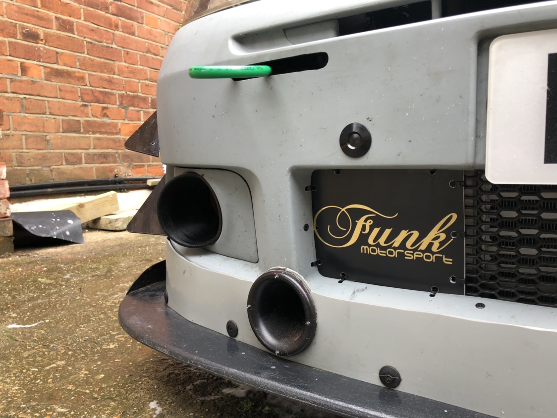

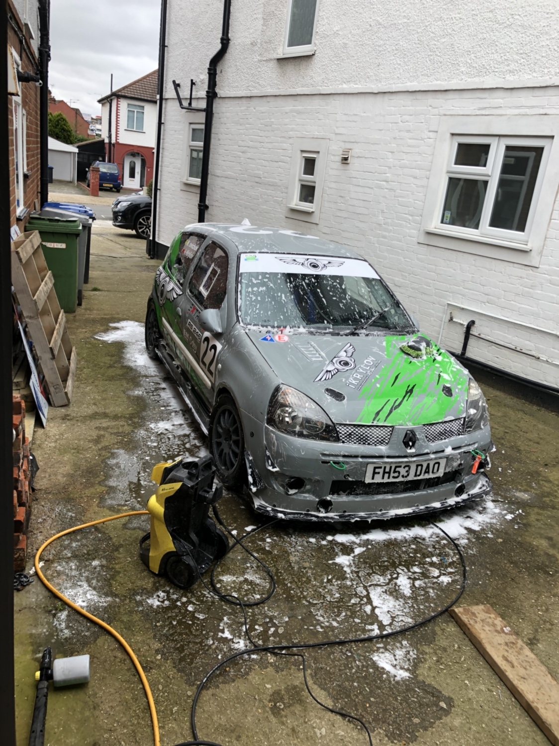

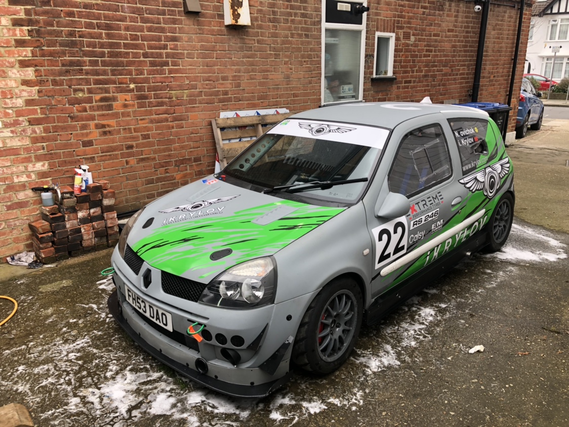

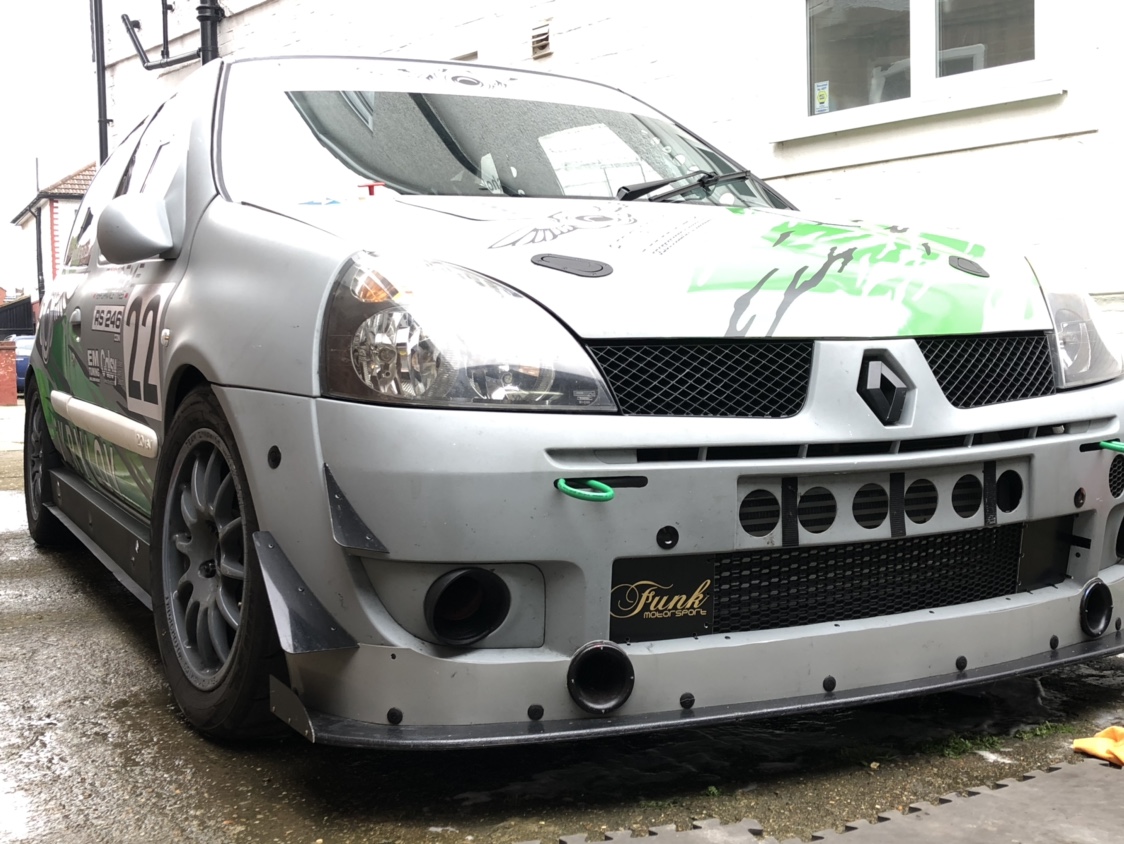

Washed the slag first time properly since I got it haha. Almost 2 years ago.
Also carried on the design on to the sides skirts.
And stuck a funk motorsport sticker that I won on Facebook competition hehe. Looks good! Gold! Who don’t like gold! They supplied my turbo blanket.

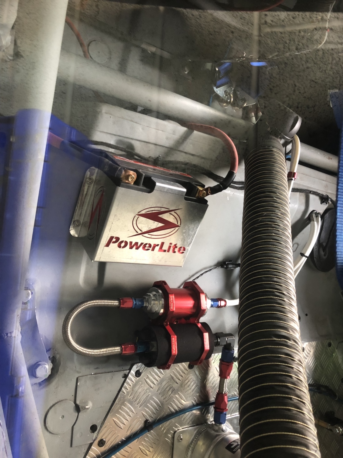

In the never ending quest for loosing weight lol. Fitted a lithium battery. 2.3 kg vs 7kg for odesey.

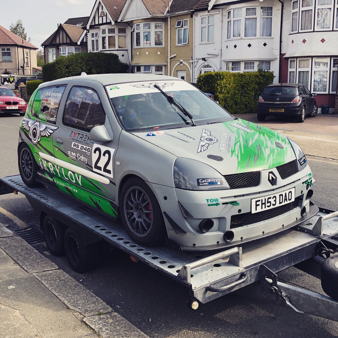

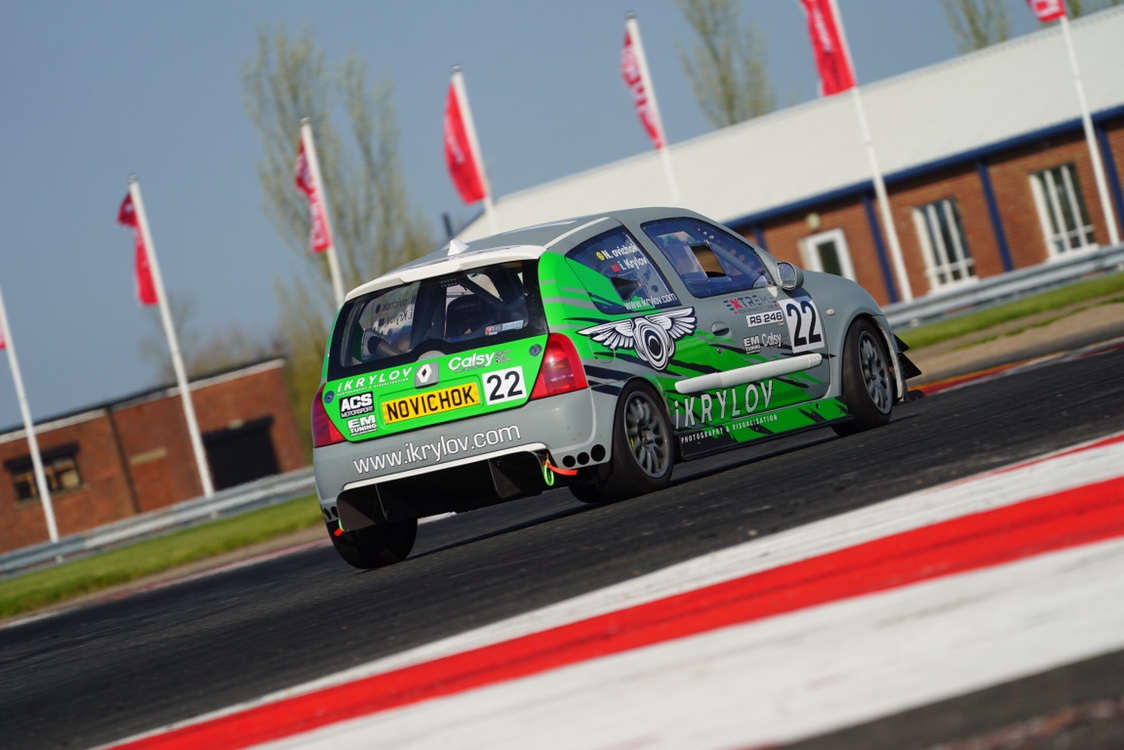

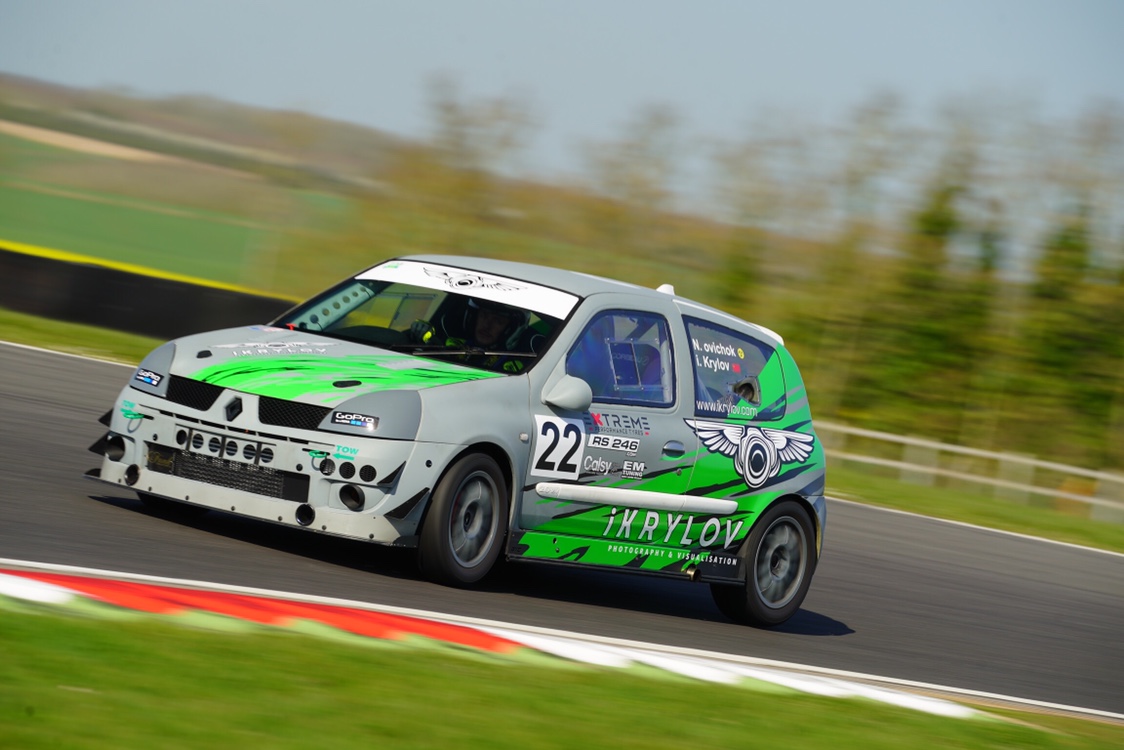

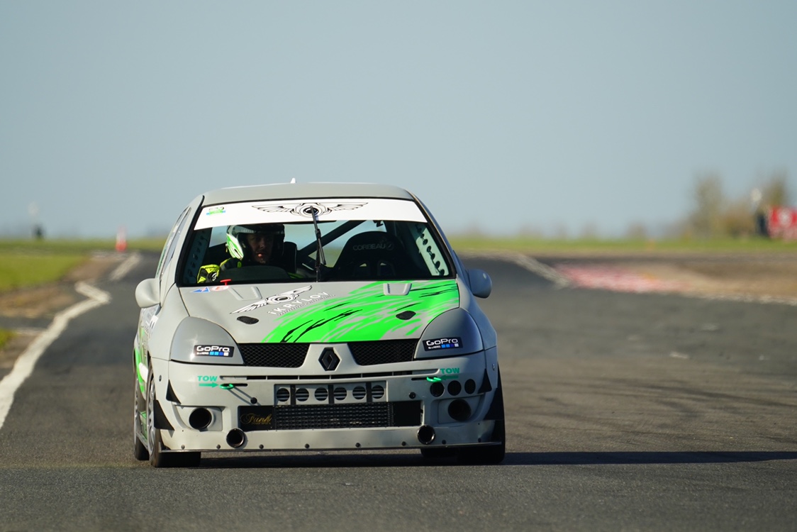

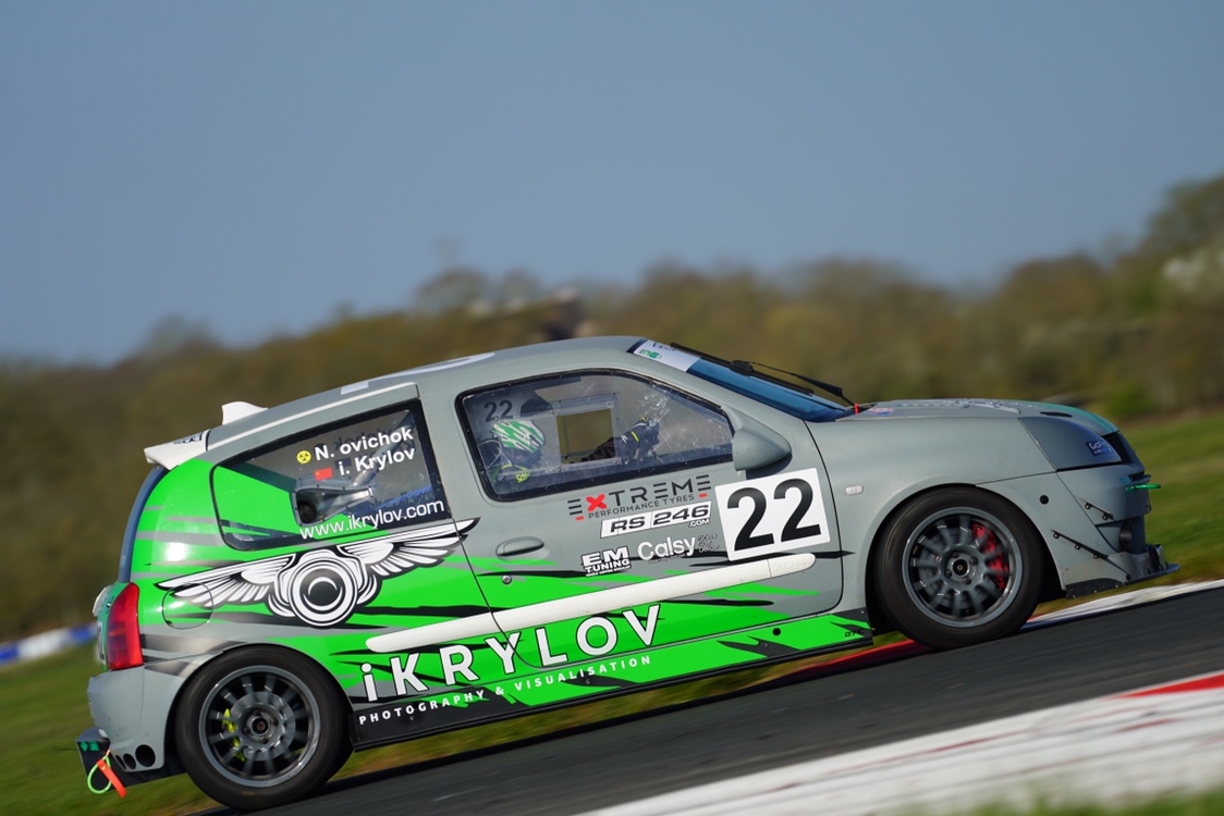

Loaded up for Bedford.
Was a great day!!!
Was testing extreme VR2 R7(front) R5(rear)
Vs 888R. And they are faster! 2.7sec faster :)

I take it the noise test went ok too then?
It does doesn’t it. But maybe tufts are too long? Idealy need flat floor on this thing.
Yes 98static. Was given a caution once when drove too close to one of the mics on WOT. So happy with that.

Very interested to know any details on the Lithium battery as I think my Odessey is shot and I will need to get something new.
I initially saw about them on Stav-tech so was going to look into it any ways.
It does indeed look turbulent under the diffuser, if it makes a slight difference its still worth it. Despite everything people downtalk about this type of stuff, if it makes any positive difference then surely its worth while
RuskiWeldFab
  Clio 172, RS4 B7
Battery is good so far. Very light. Plenty of power. Not much else I can say at this stage as only had it less than a week.
Bought my PS-20 bundle from gsparkplug.com
Use CLUBMEM10 for 10% discount [emoji2958]
It’s near 5kg lighter than my odesey PC680

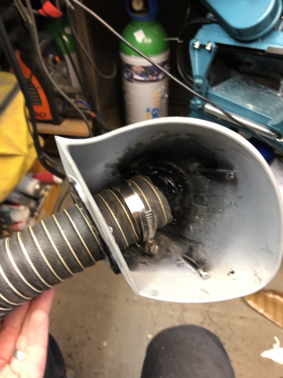

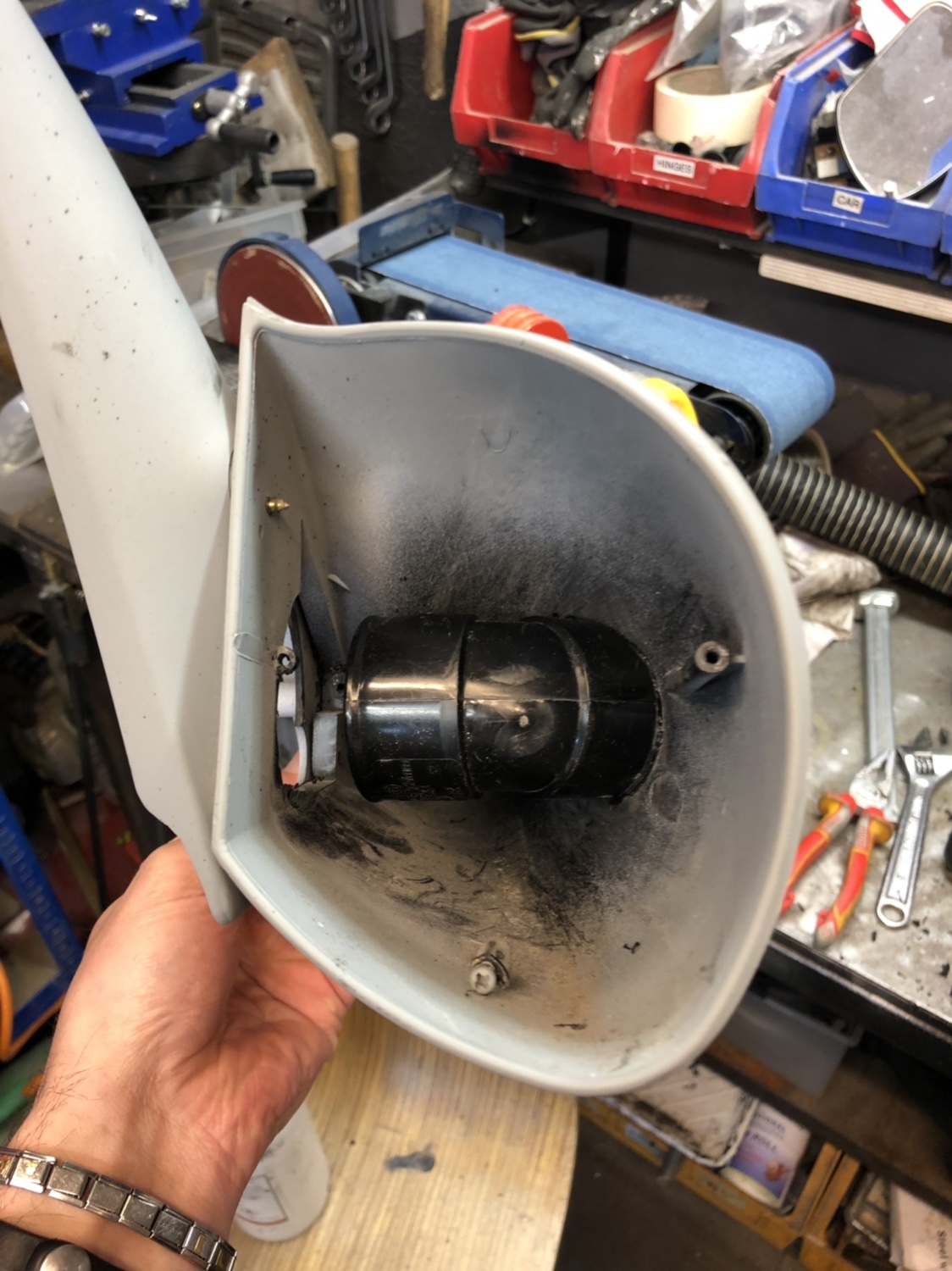

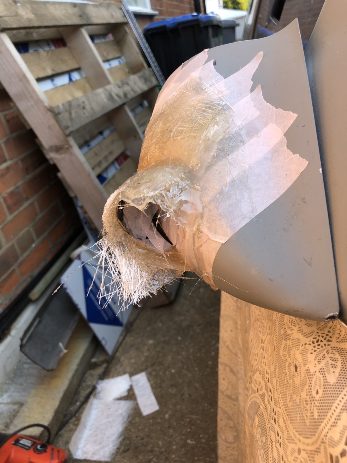

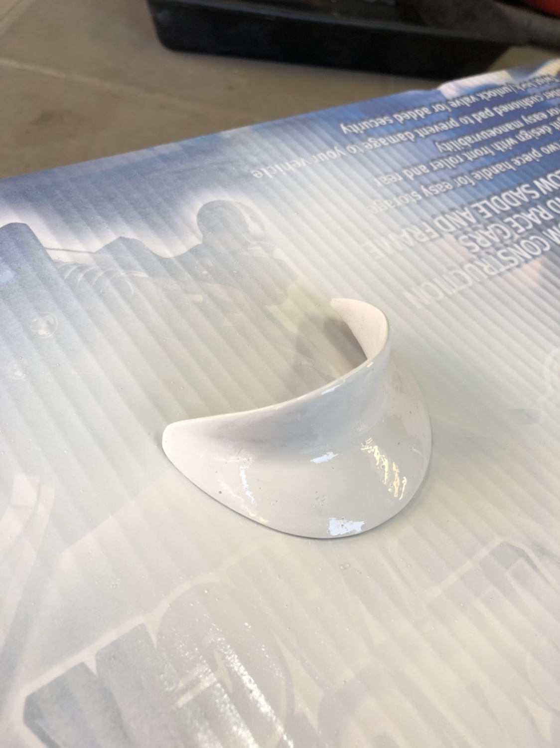

Summer is coming so in order to stay cooler in the cockpit. Decided to make this:
no idea how well it will work. Gotta do something.

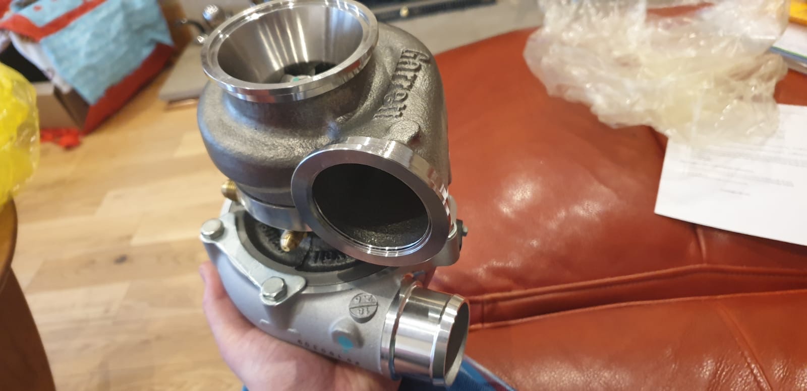

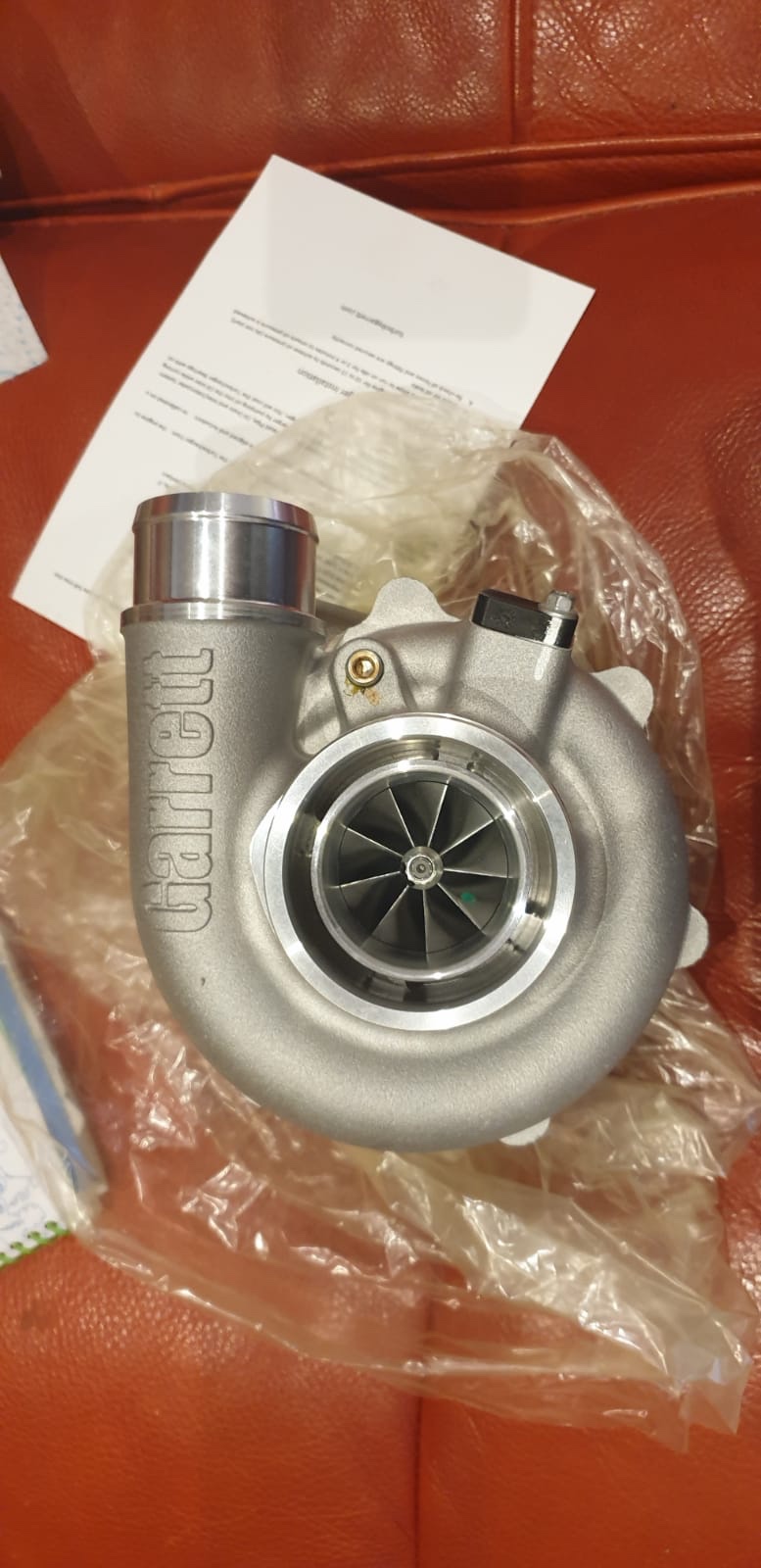

Newest G25-550
Second number is for max power [emoji41] can’t wait to start fabricating manifold for it!
Yet to see either of the G25s make near their numbers on a 4pot. Realisticly it's a 450-500 turbo on a 4 cylinder
  dan's cast offs.
to be fair it's lister for 1.4-3.0L and they are american figures so even if it only makes 450-500 on a 4 pot that's still a decent figure.
plus if you're worried about figures then just go for the G42-1450.
That’s more than I plan to run through FWD anyways :) it’s not about too figures. When @bloke recommended this turbo, I did quite a bit of research and the efficiency of it is quite impressive considering the size! This new gen turbos are Awsome!

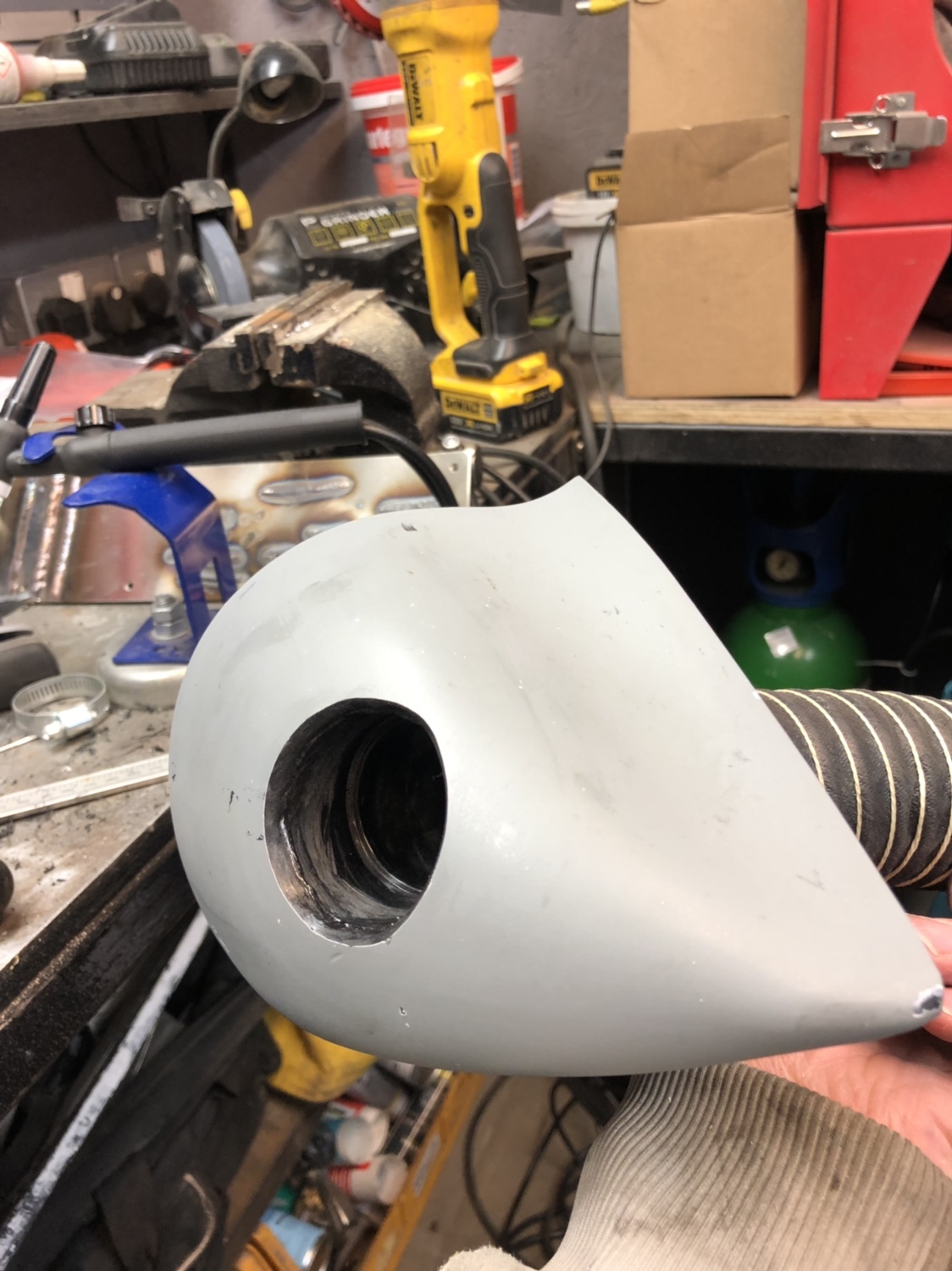

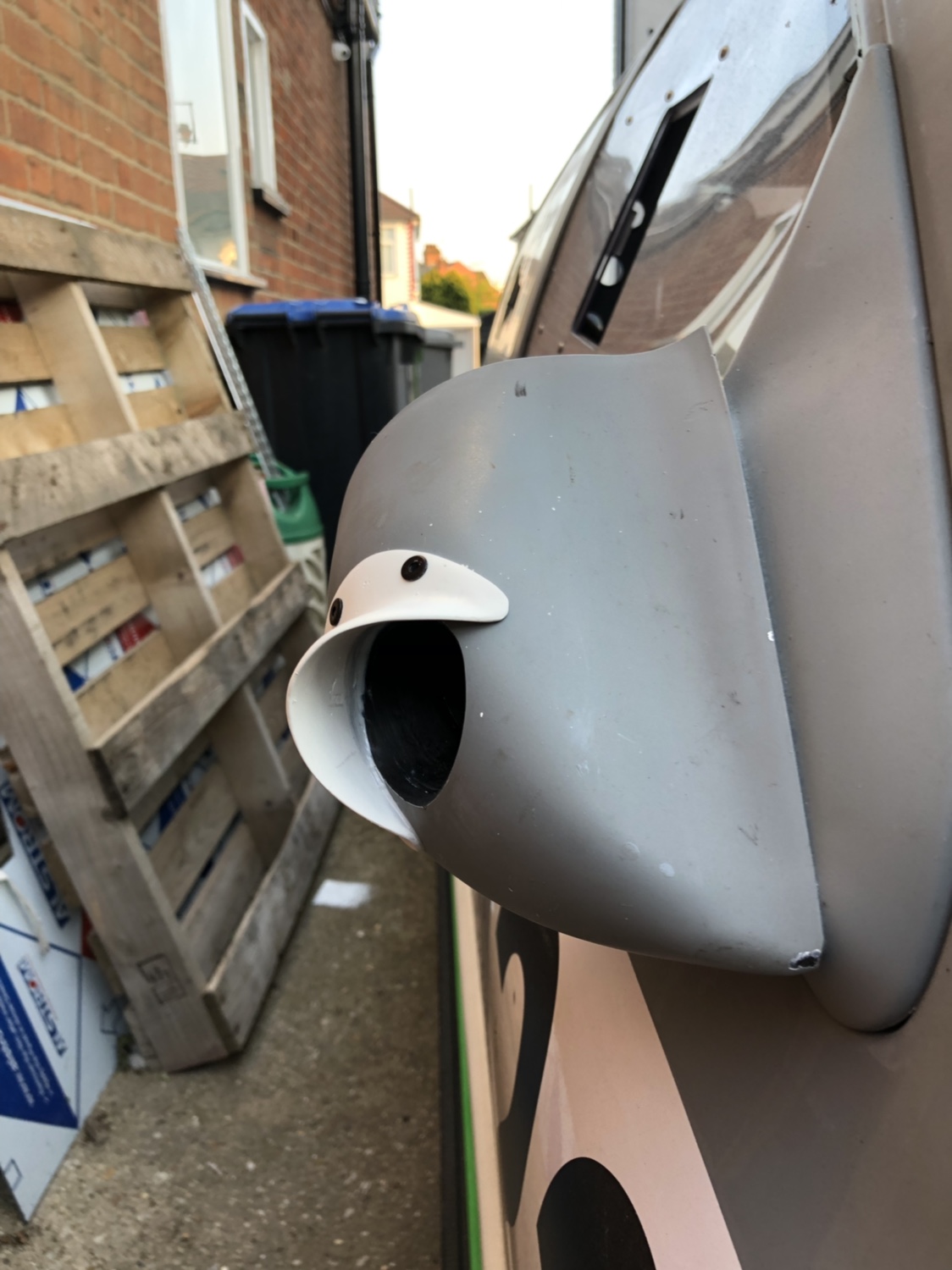

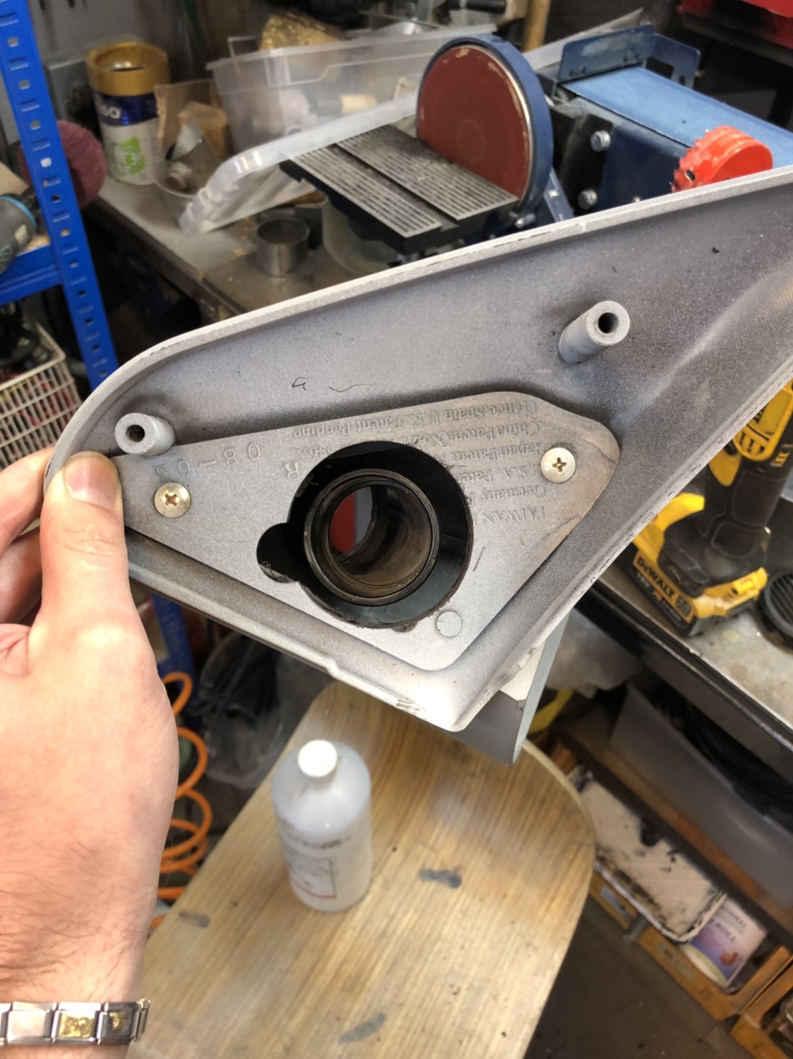

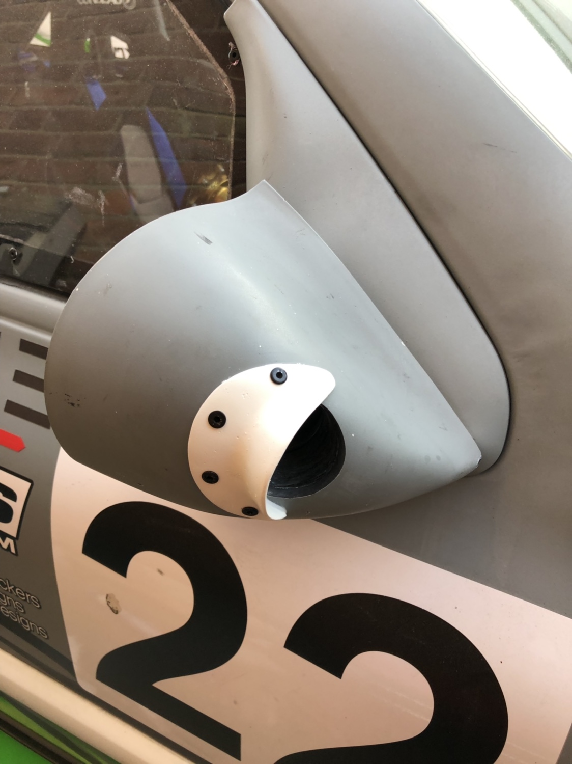

Literally before loading the car on a trailer to go to the ring. Decided my wing mirror needed a little extra help to get more fresh air in. So made this real quick .
a bit of trimming...

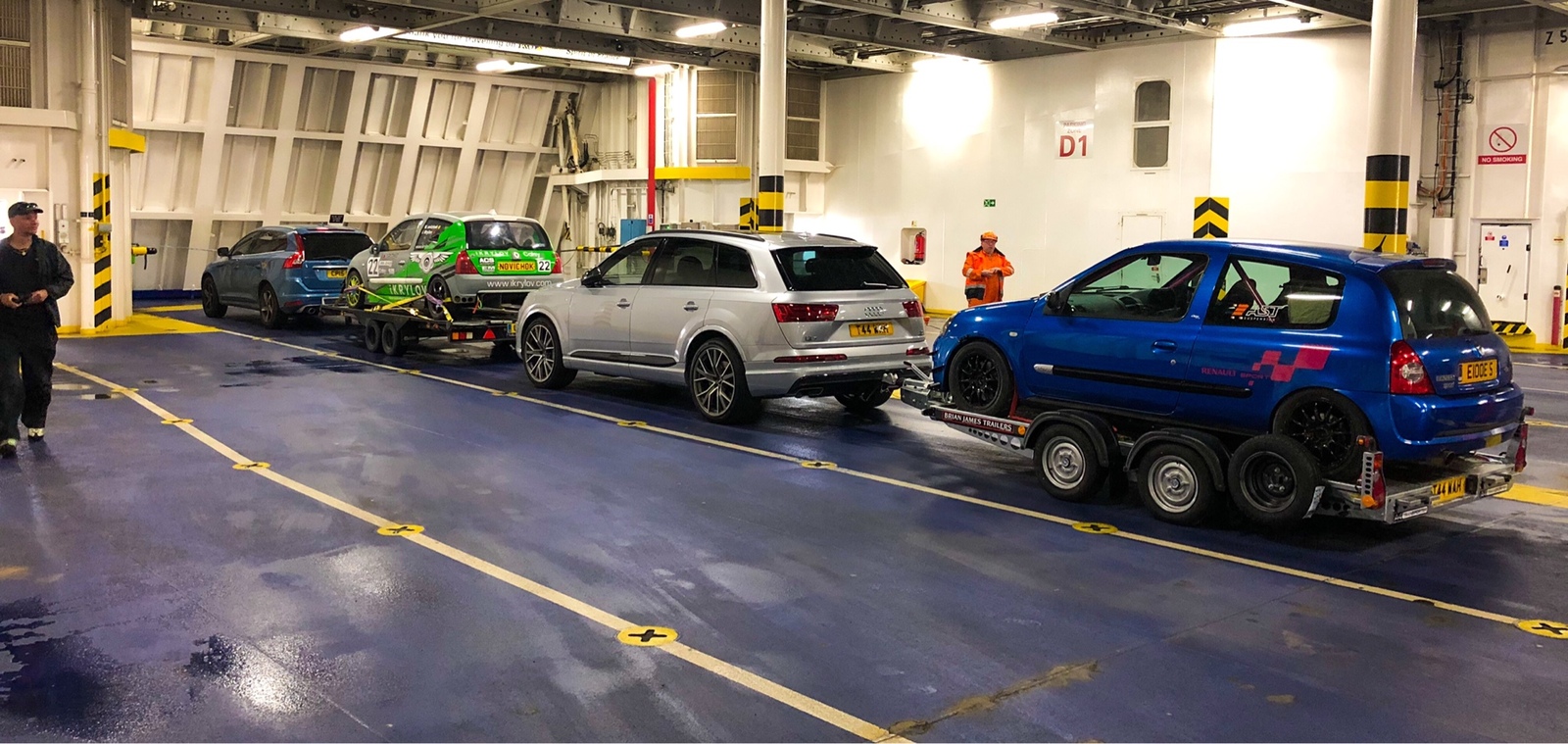

On the ferry :)
And we made it here already. More updates later!
