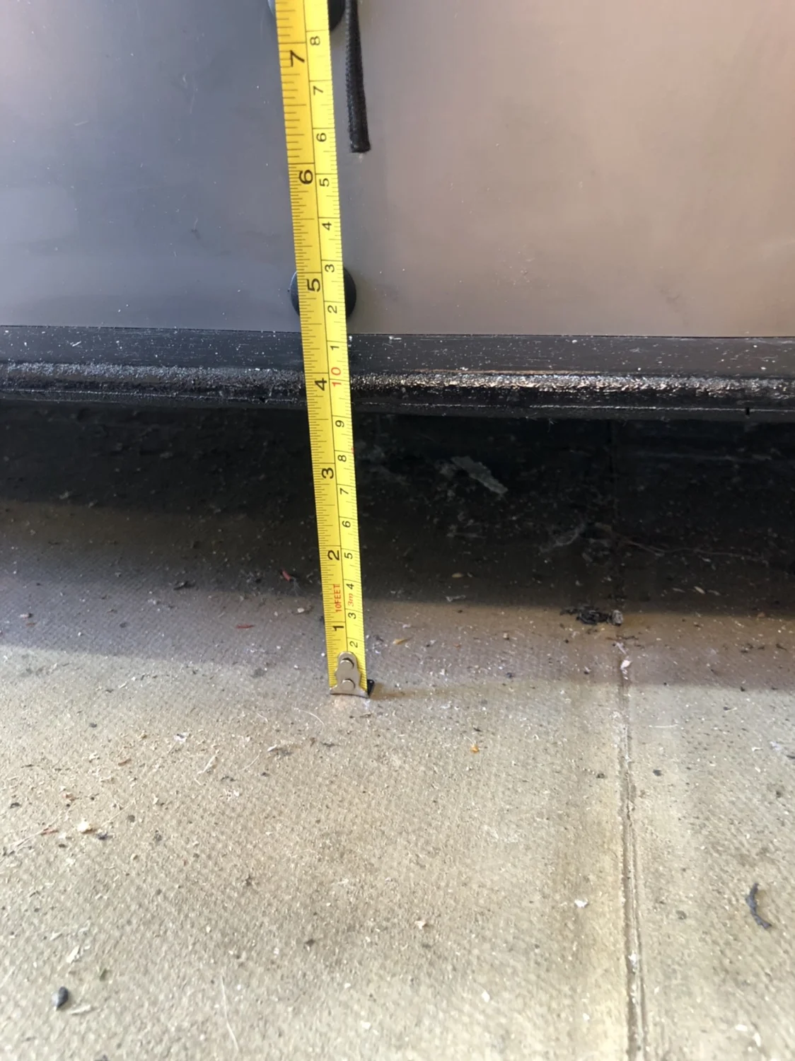

Yeah I saw that. Will try this first see how it works. The problem is, there is literally half inch between chassis and wheel on full lock. So ducting can only go under the car. And not a big diameter. I already tried to fabricate some ducts out of planting gutter pipe by Bering and flattening it. But don’t like it.
What about something like 1/2 inch alloy box section with reducers on each end to fit the ducting onto to? Run it down the side of the chassis leg?
Maybe? I'm needing a solution to this problem also, so looking into different ideas

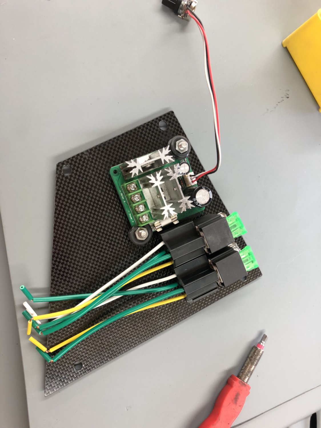

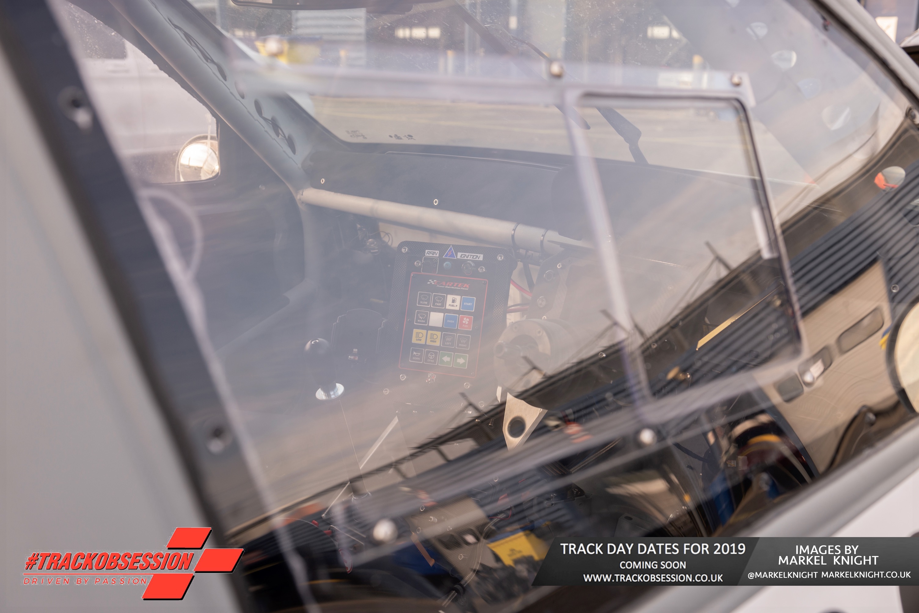

Fitted new heated windscreen (after I smashed the other one with in first 30min on track. Always check your bonnet pins!!

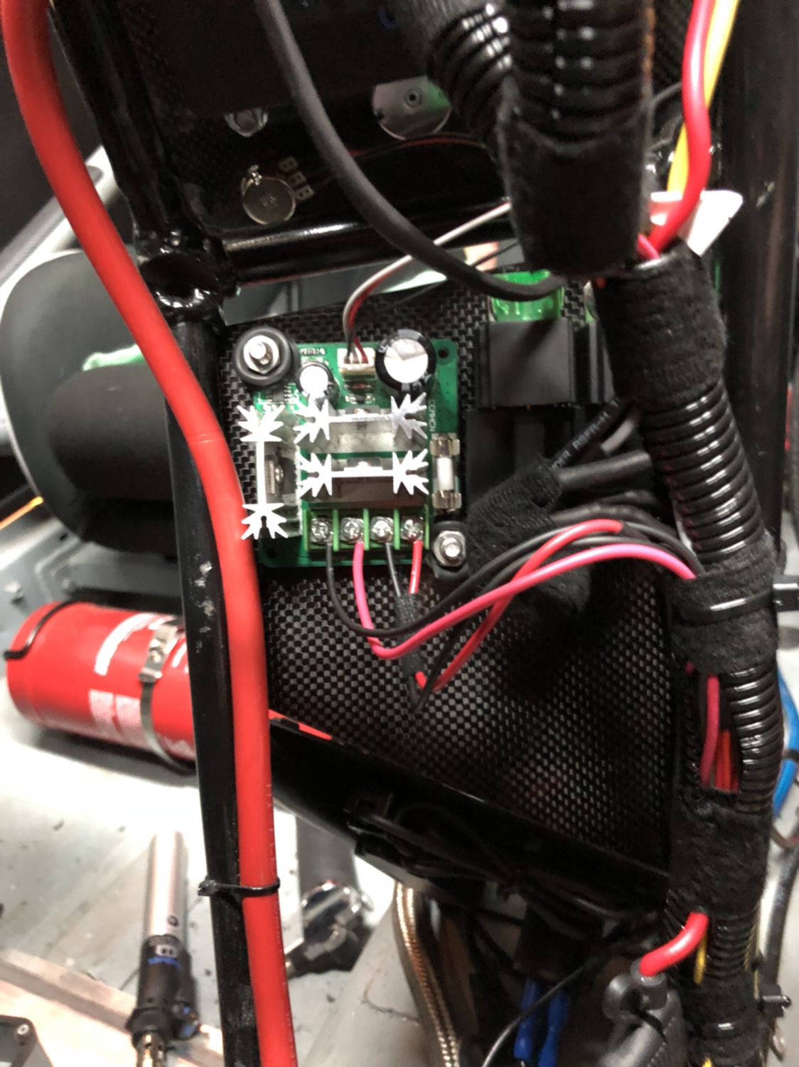

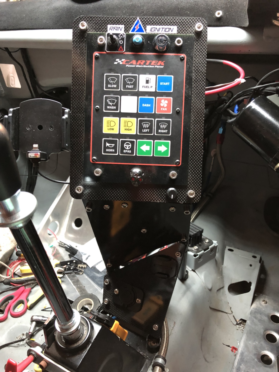

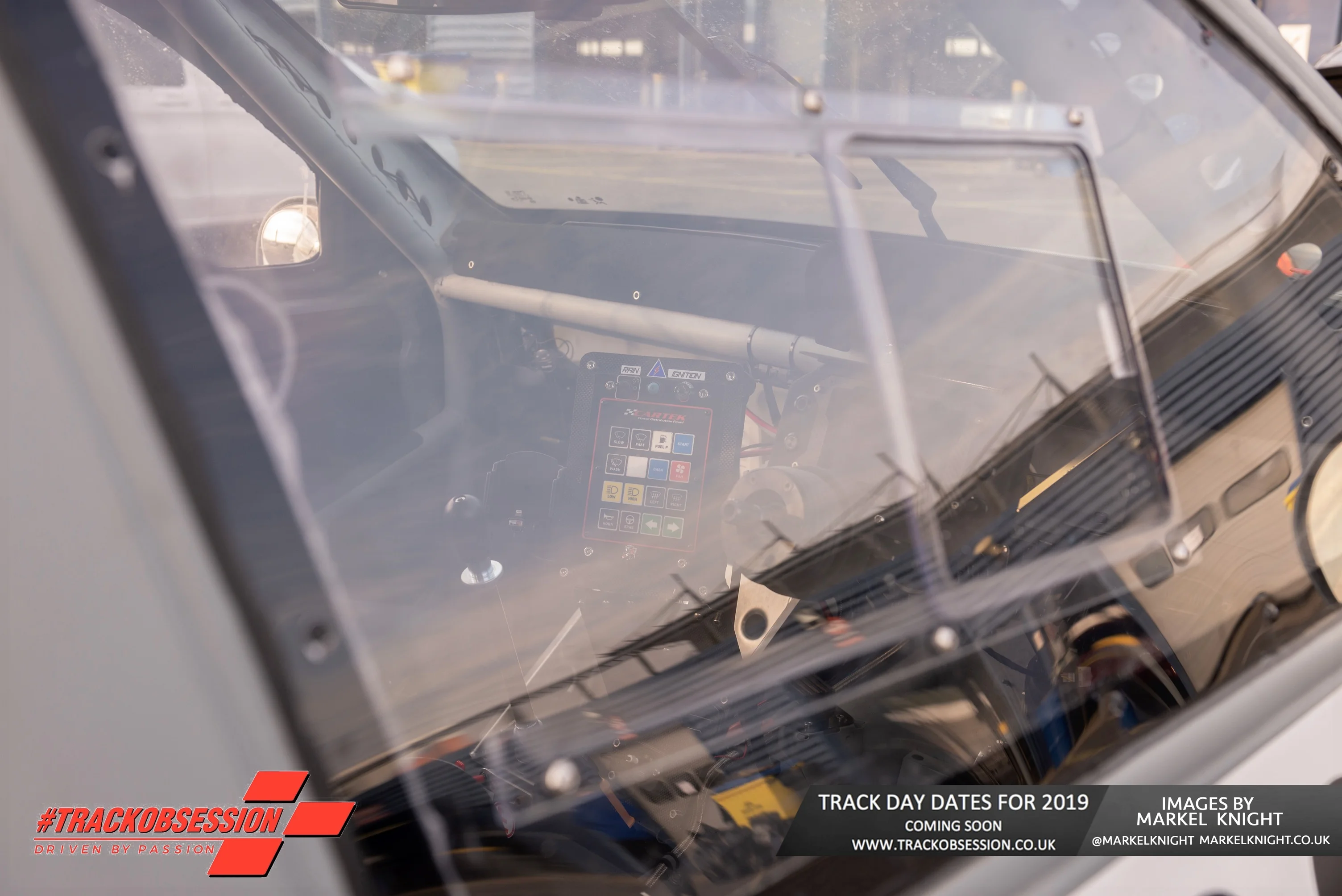

Cartek pdp can only supply 30amp max in dual Channel mode I decided to not use both channels for my screen (4 buttons) but fit 2 fused 30a relays. + PWM controller for speed control to my single wiper.

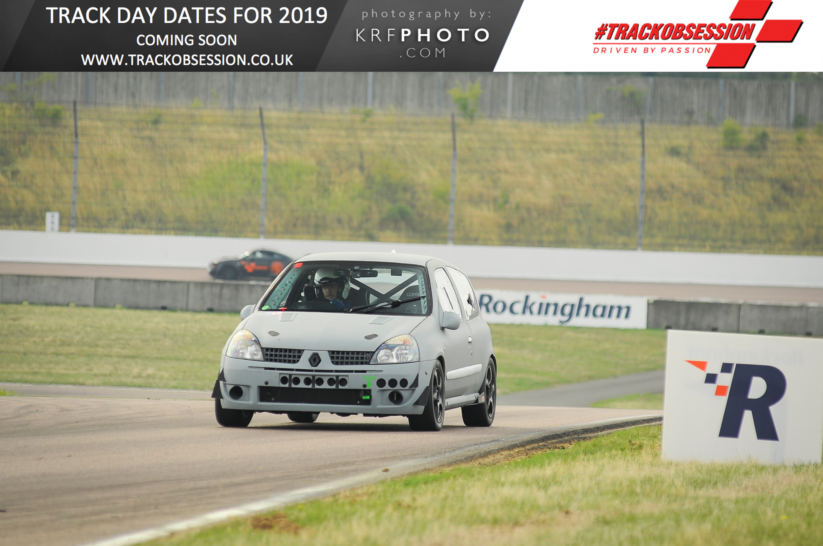

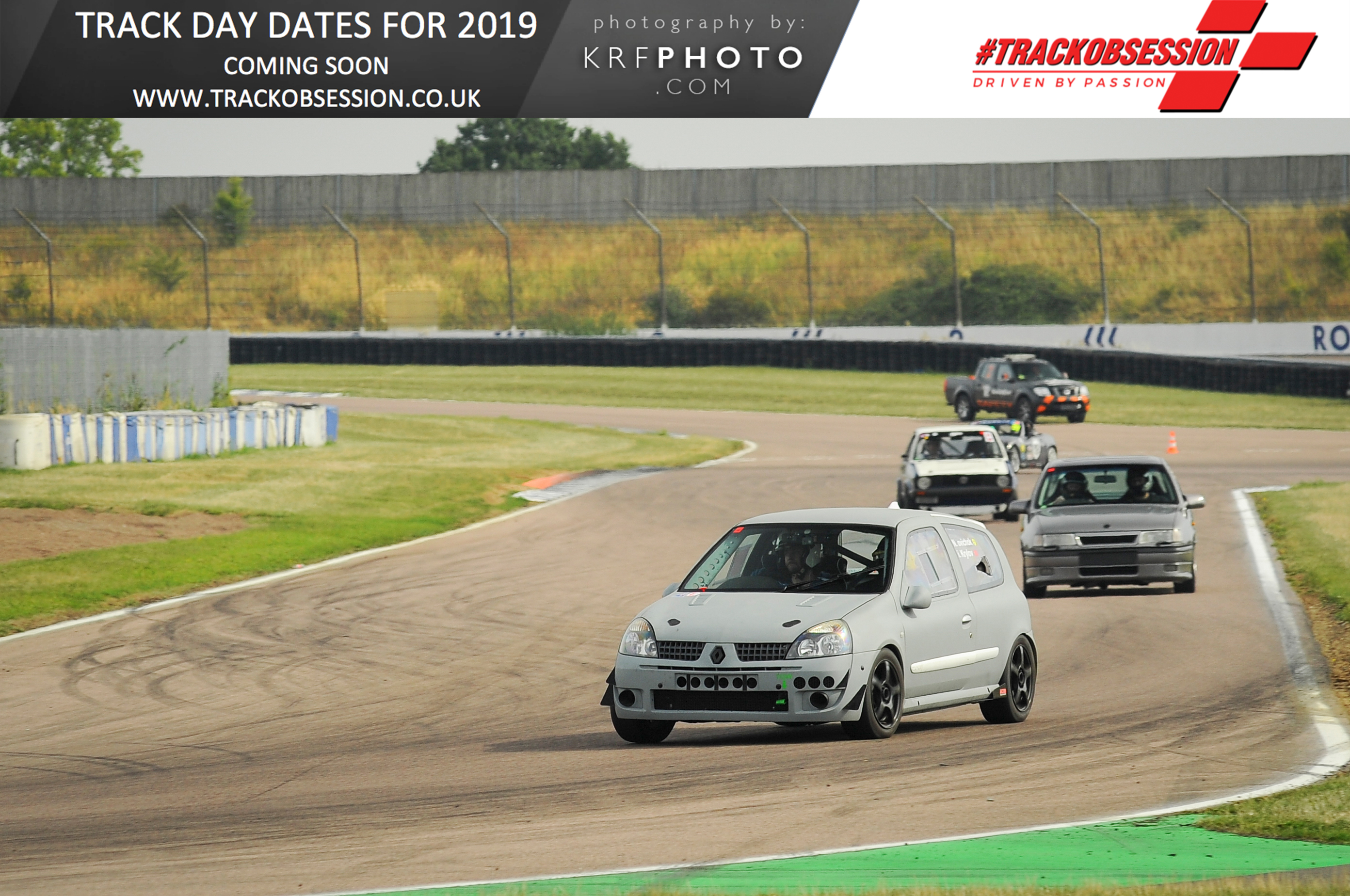

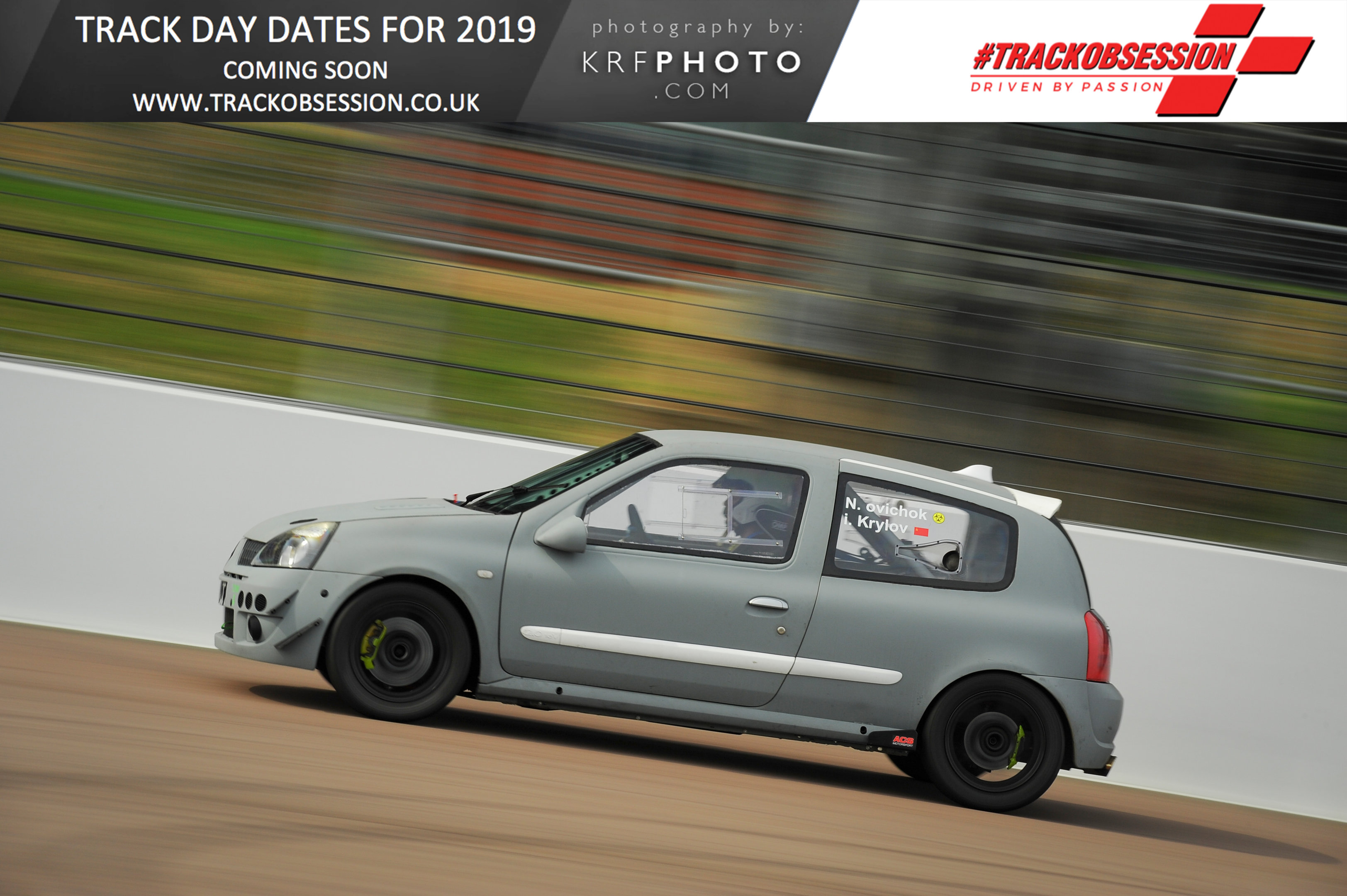

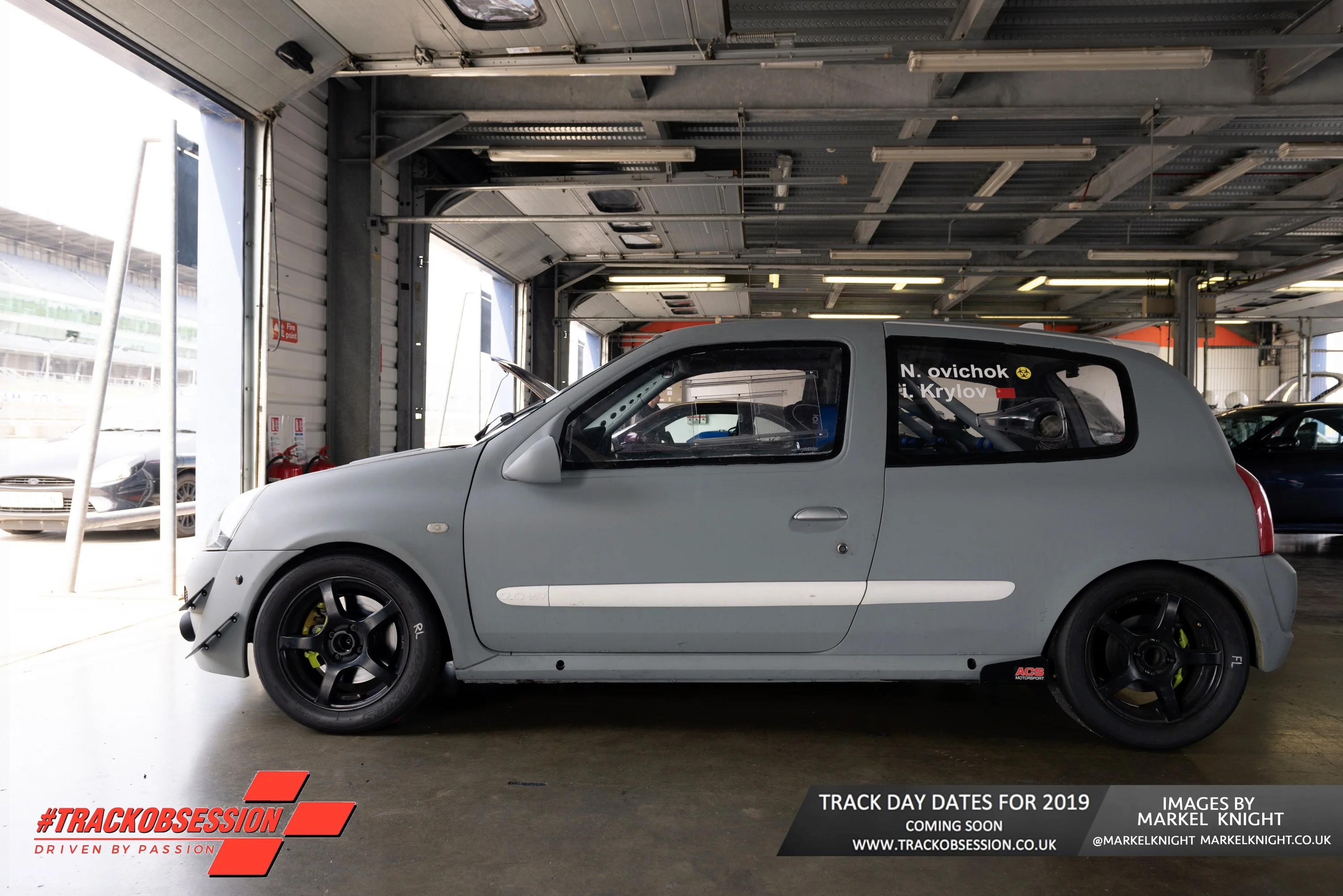

And on Monday went to Rockingham. What a great day with Trackobssesion! Apart from brakes (still having either pad knock back or boiling fluid or air in the system) nothing failed! Worked flawlessly. Best lap 1:34
few pictures from Rockingham on 03/09/2018
next outing 25/09/2018 at Bedford.

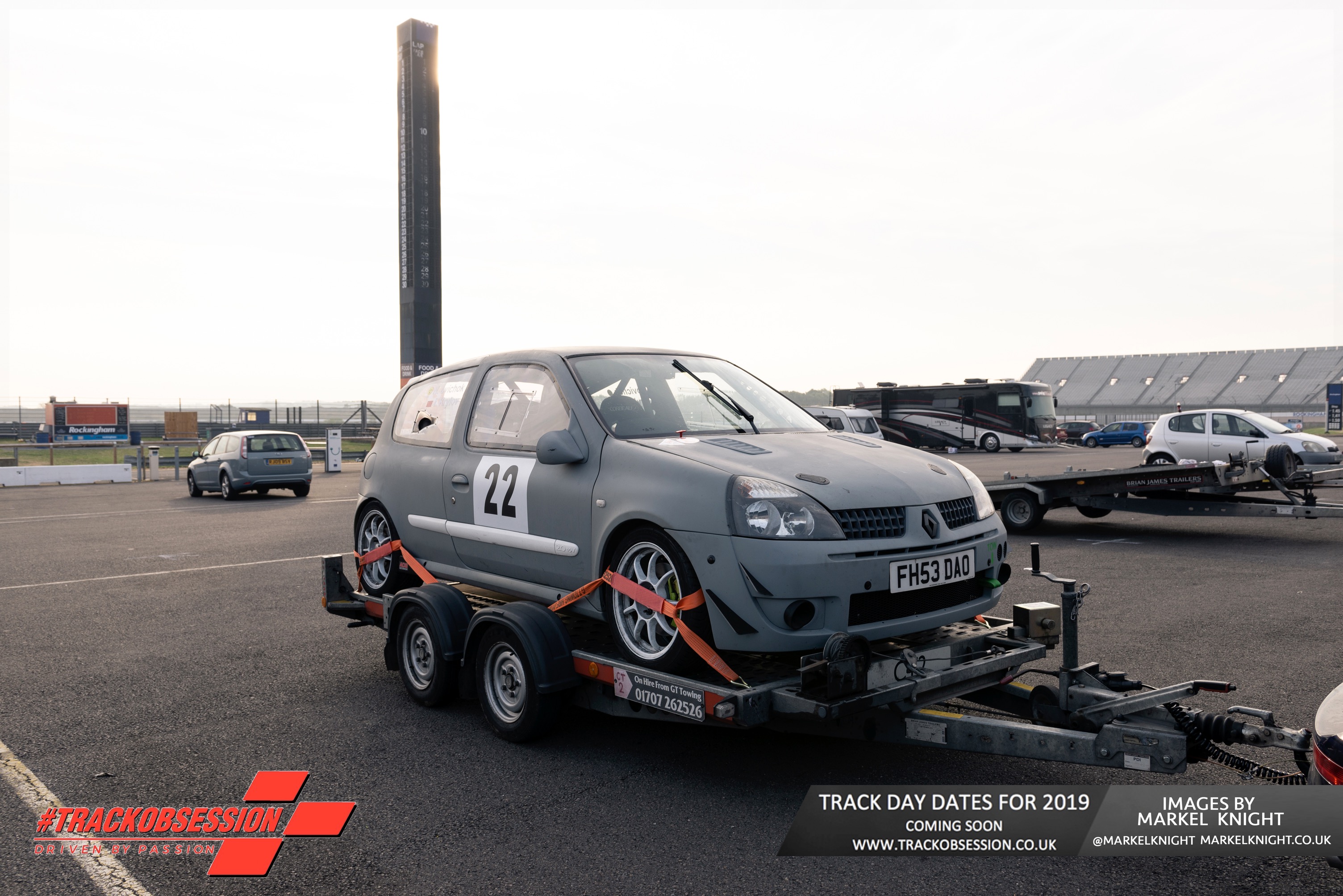

in the paddock

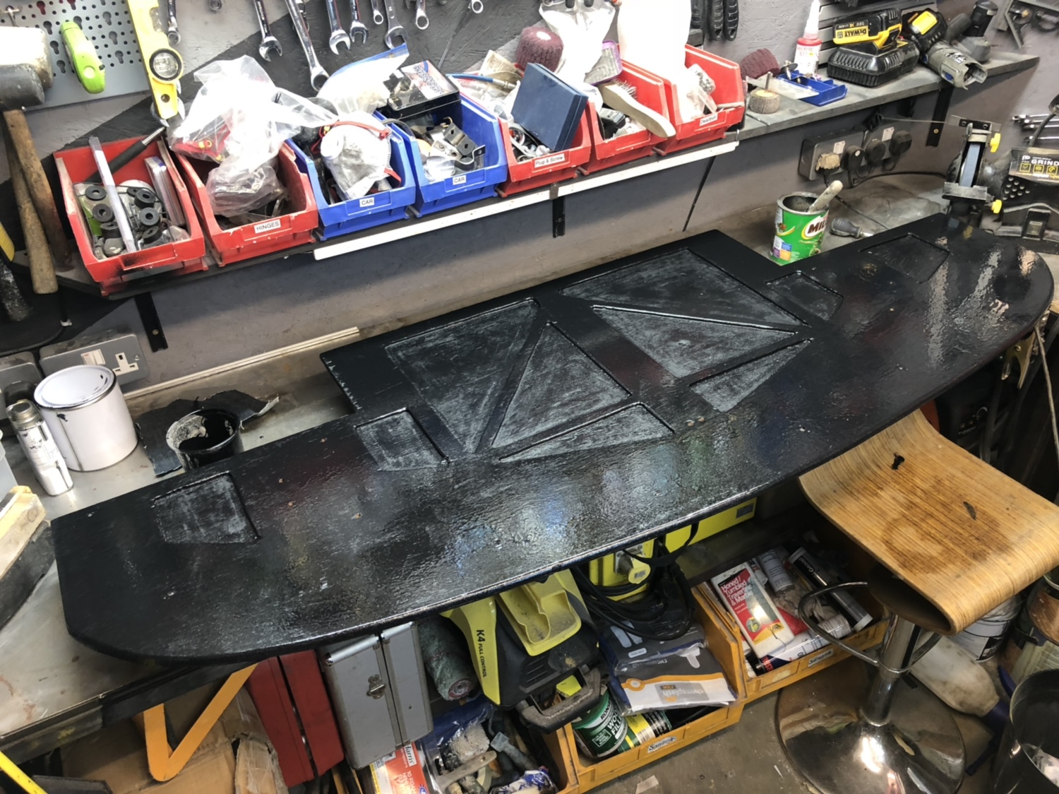

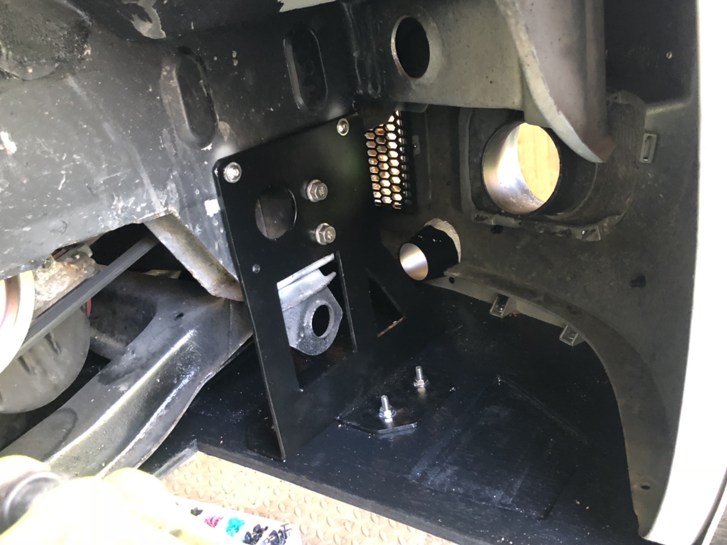

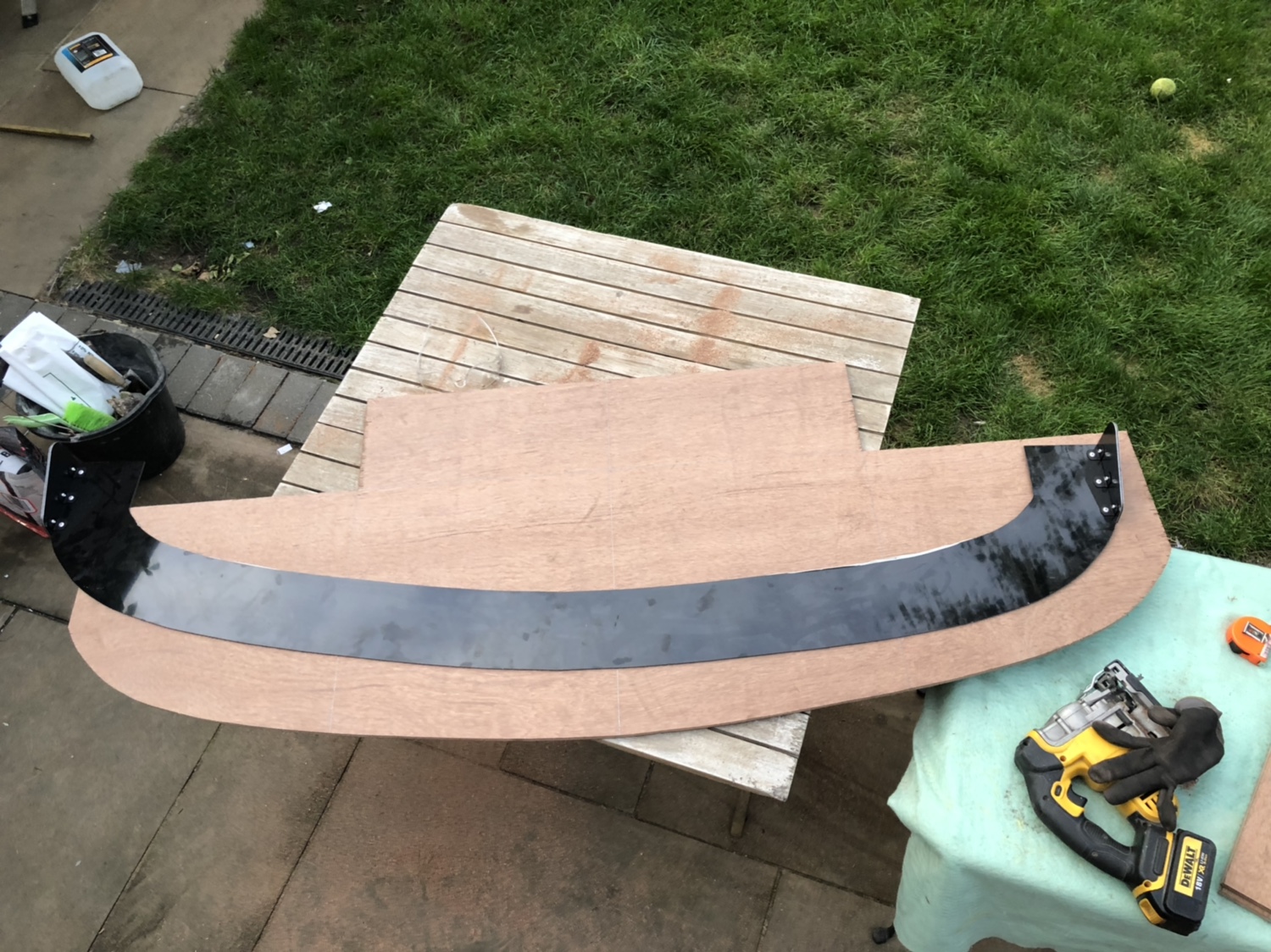

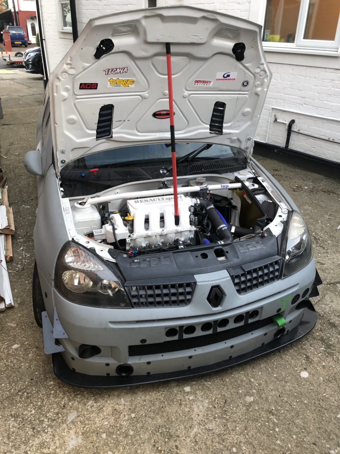

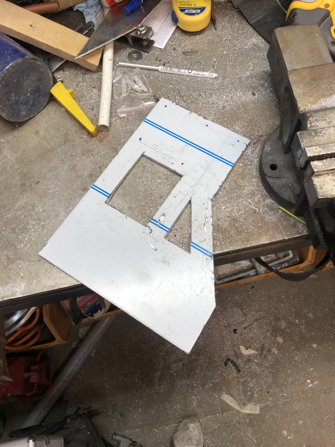

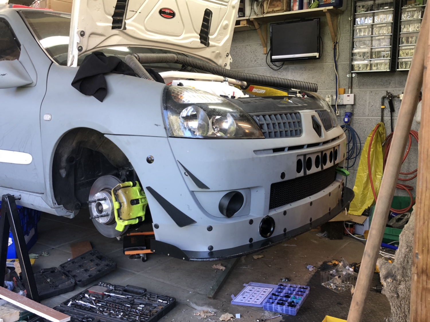

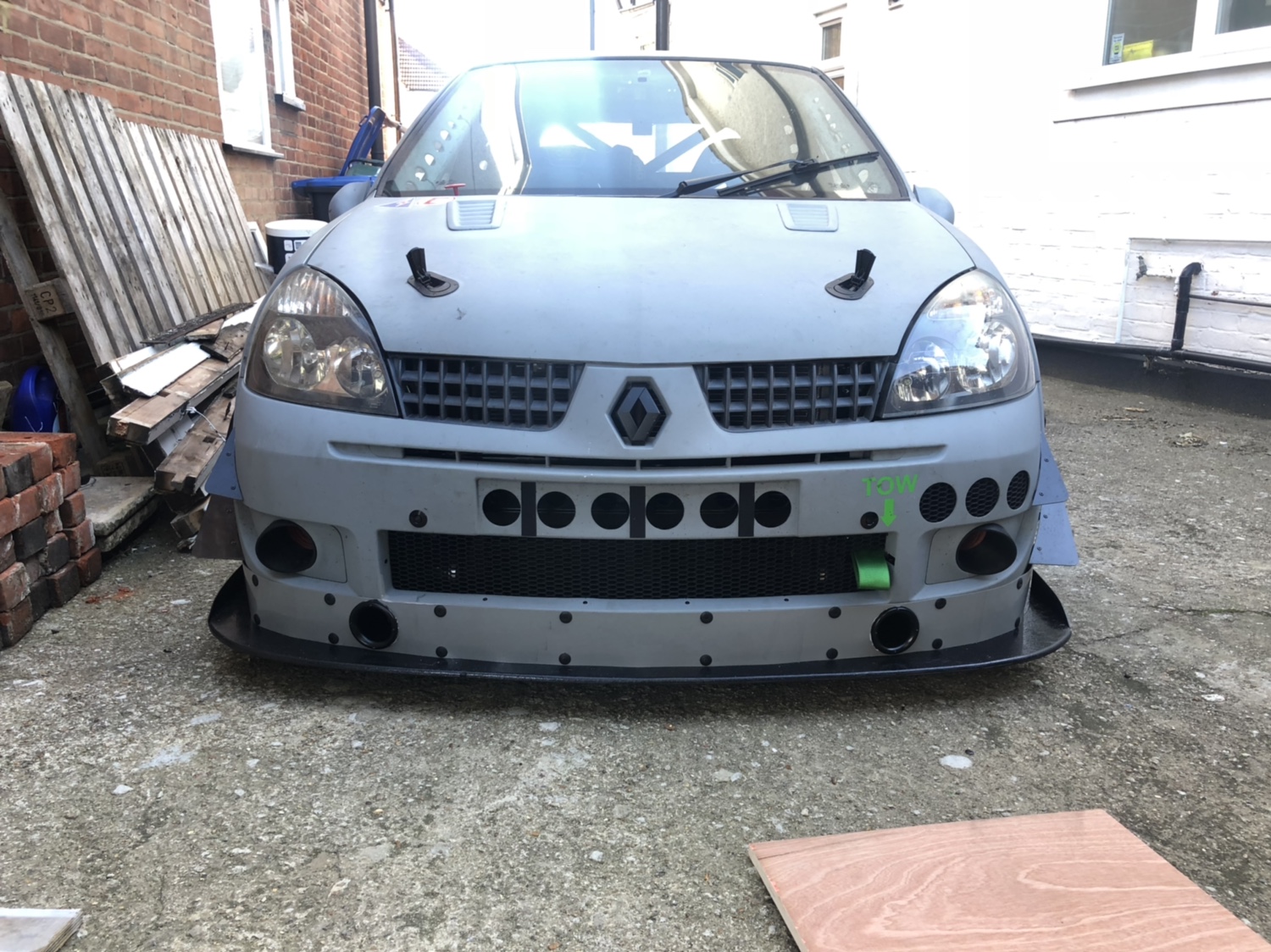

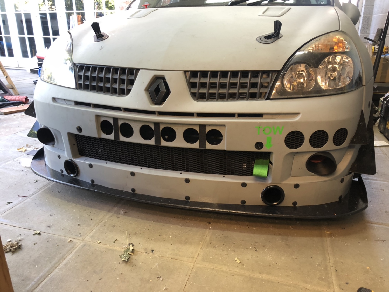

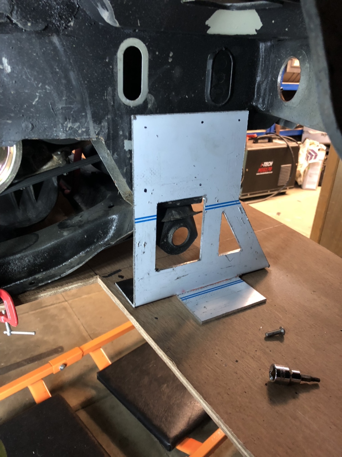

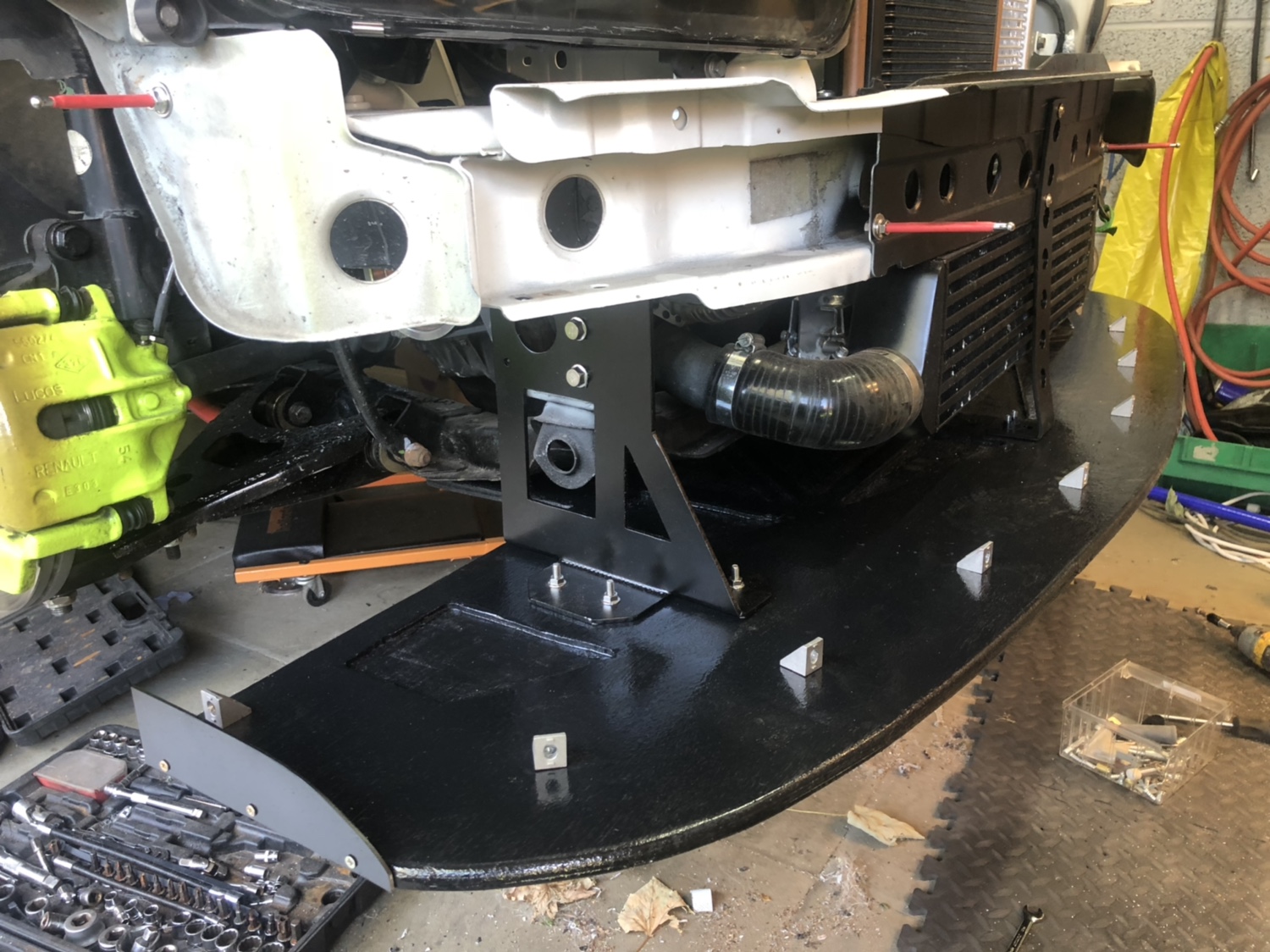

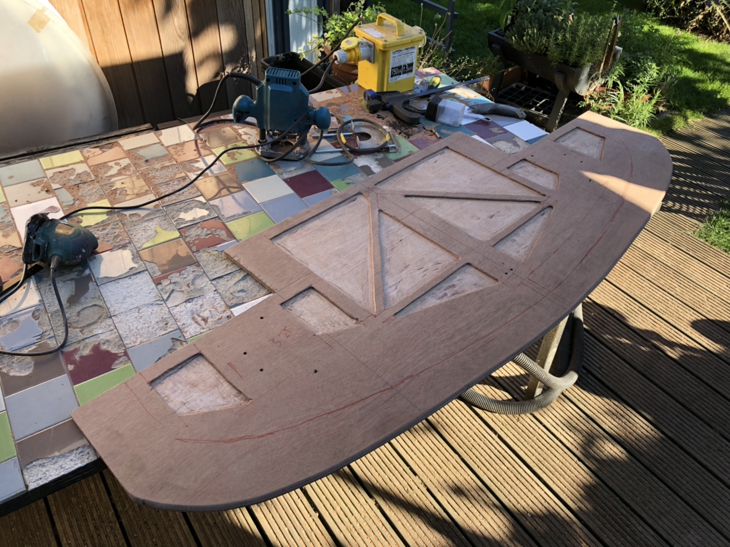

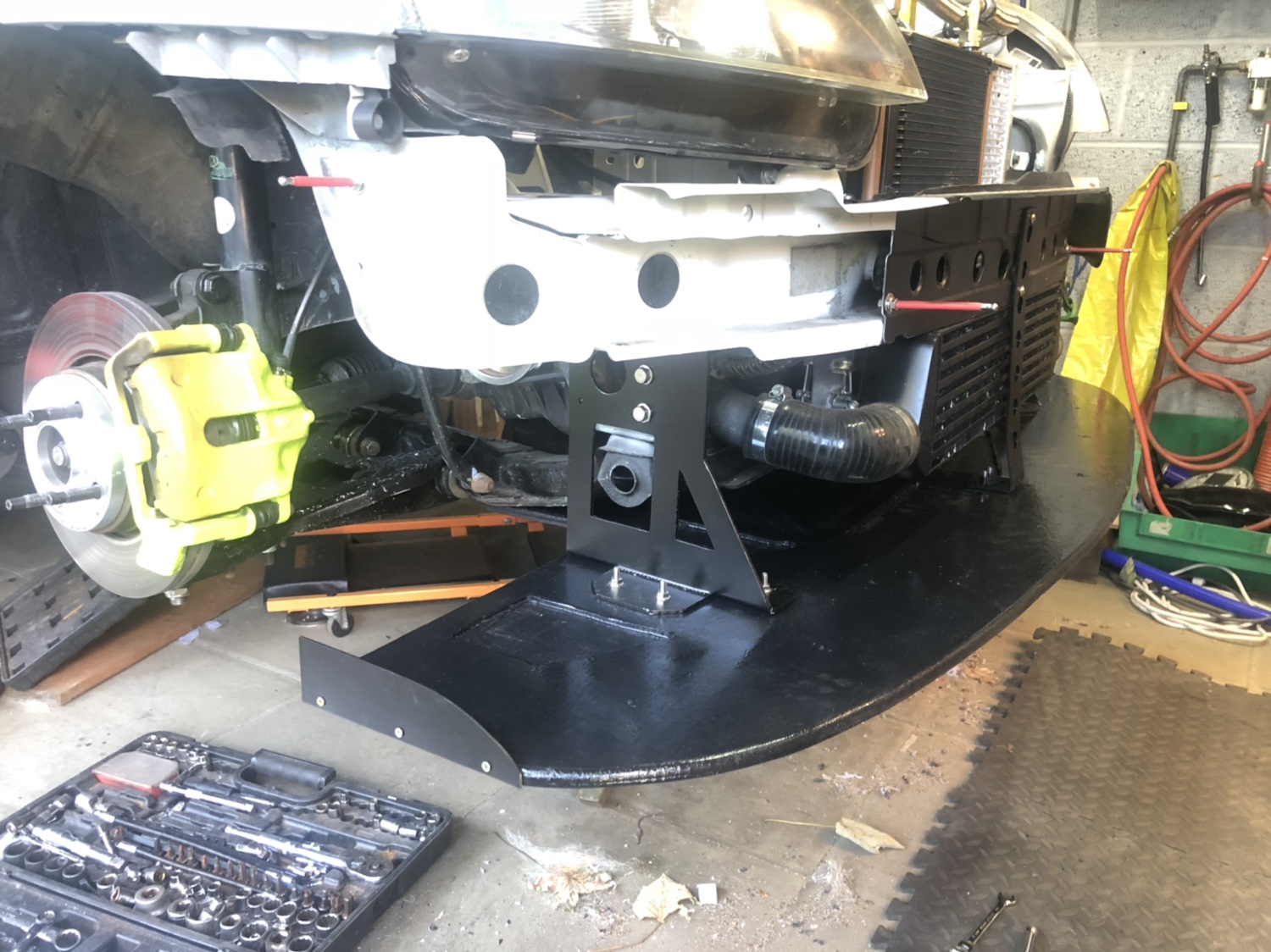

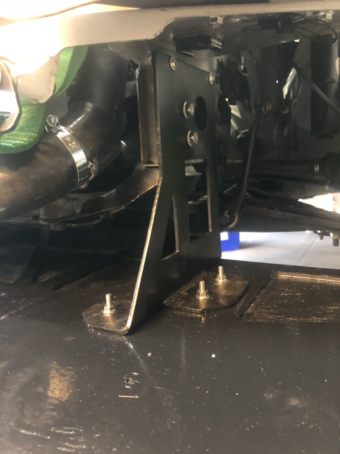

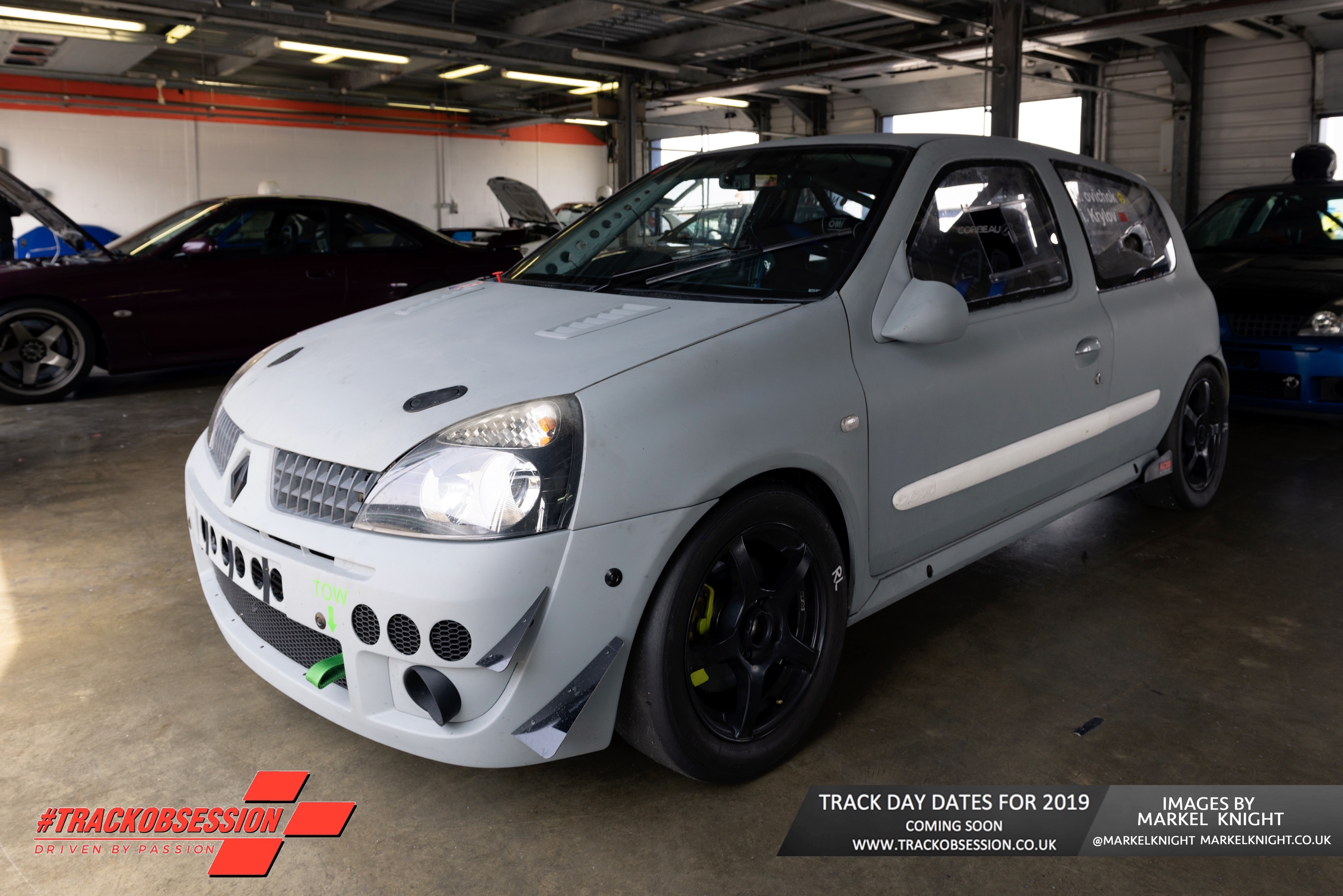

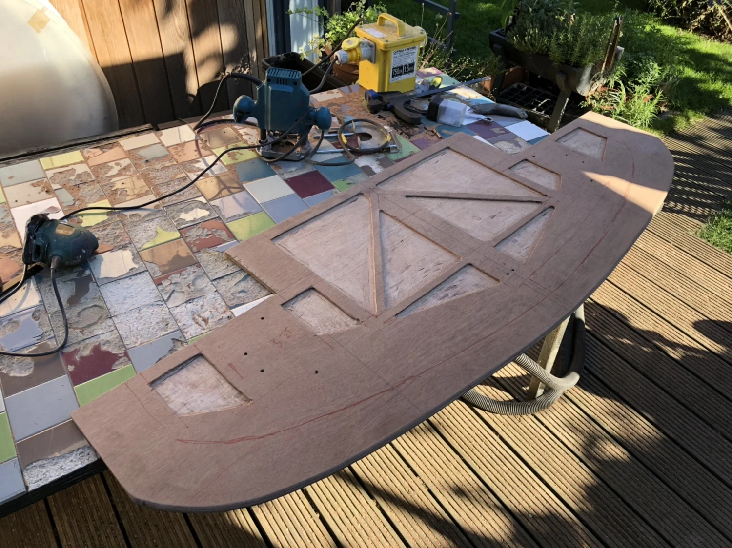

There is a lot of talk about aero pros/cons etc.
But I wanted to try myself. Partly cos I am stubborn and extra 5kg won’t make a difference and partly cos I like making things. Used 4mm ally for brackets.
12mm marine ply

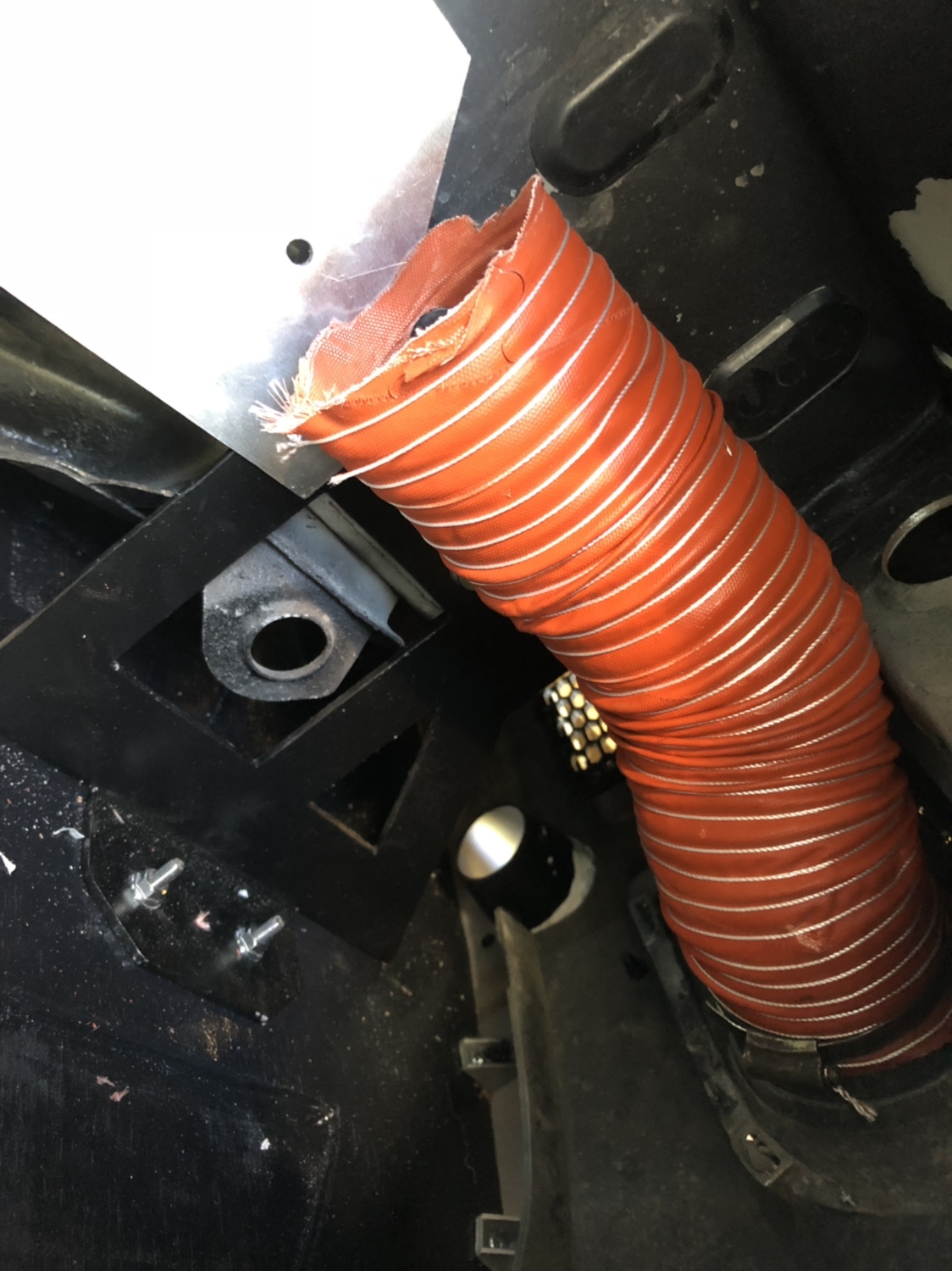

extra cooling ducts,
And lawn edging for an air dam.
Will test tommorow at Bedford. One thing for sure it looks cool and will be hard getting on/off trailer..
Extra weigh shaving
lower ducts aren’t connected yet. But will be routed directly to new calipers with 51mm hose

View attachment 1387612View attachment 1387613View attachment 1387614
Extra weigh shavingView attachment 1387615
View attachment 1387616View attachment 1387617View attachment 1387618View attachment 1387619View attachment 1387620View attachment 1387621View attachment 1387622lower ducts aren’t connected yet. But will be routed directly to new calipers with 51mm hose View attachment 1387623View attachment 1387624View attachment 1387625View attachment 1387626
Looks good Ilya. Just watch the rear doesn't get too light in high speed corners.
I'll be at Bedford tomorrow actually. Look for the Race prepared 350Z. The car will be there from the start but i won't be arriving until about 10am.
Splitter looks mega [emoji848][emoji1303]
And it works mega! A bit too much downforce! Rob was right about rear getting light in high speed corners lol. Did a short off-road course past the pit straight at Bedford yesterday. Mowing the lawn with that blade ha ha. After dialled in suspension a little softening the rears and stiffening fronts just a touch. Need more aero at rear 100%
Little vid from Bedford 25/09/18
I am happy, it’s faster around Bedford than my RS4 by a good 6sec. Not that I was timing or anything. [emoji13]

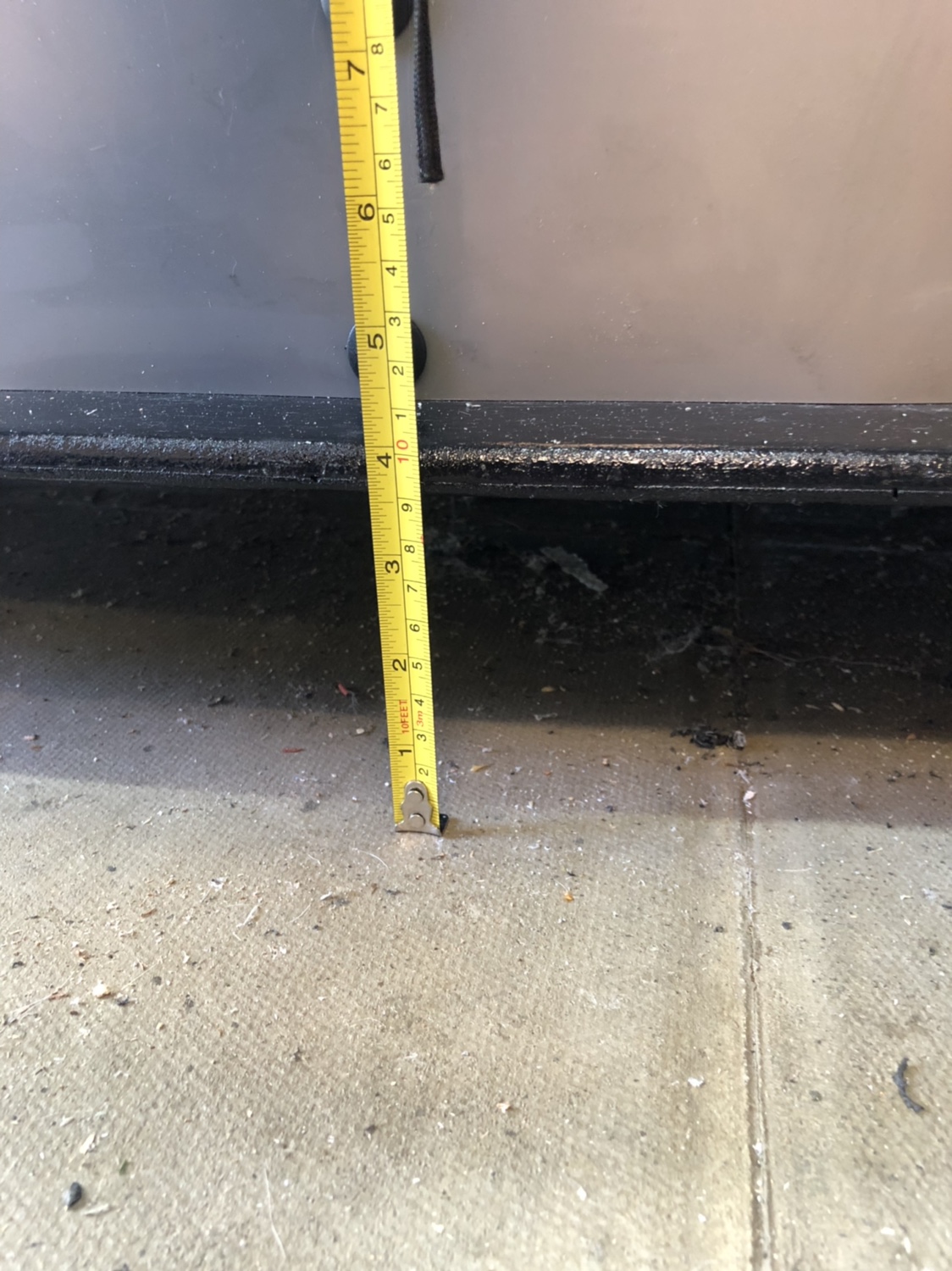

Camera is about 4inch from
The ground. Hard mounted to splitter. A little too low I think. Need to revise that.
