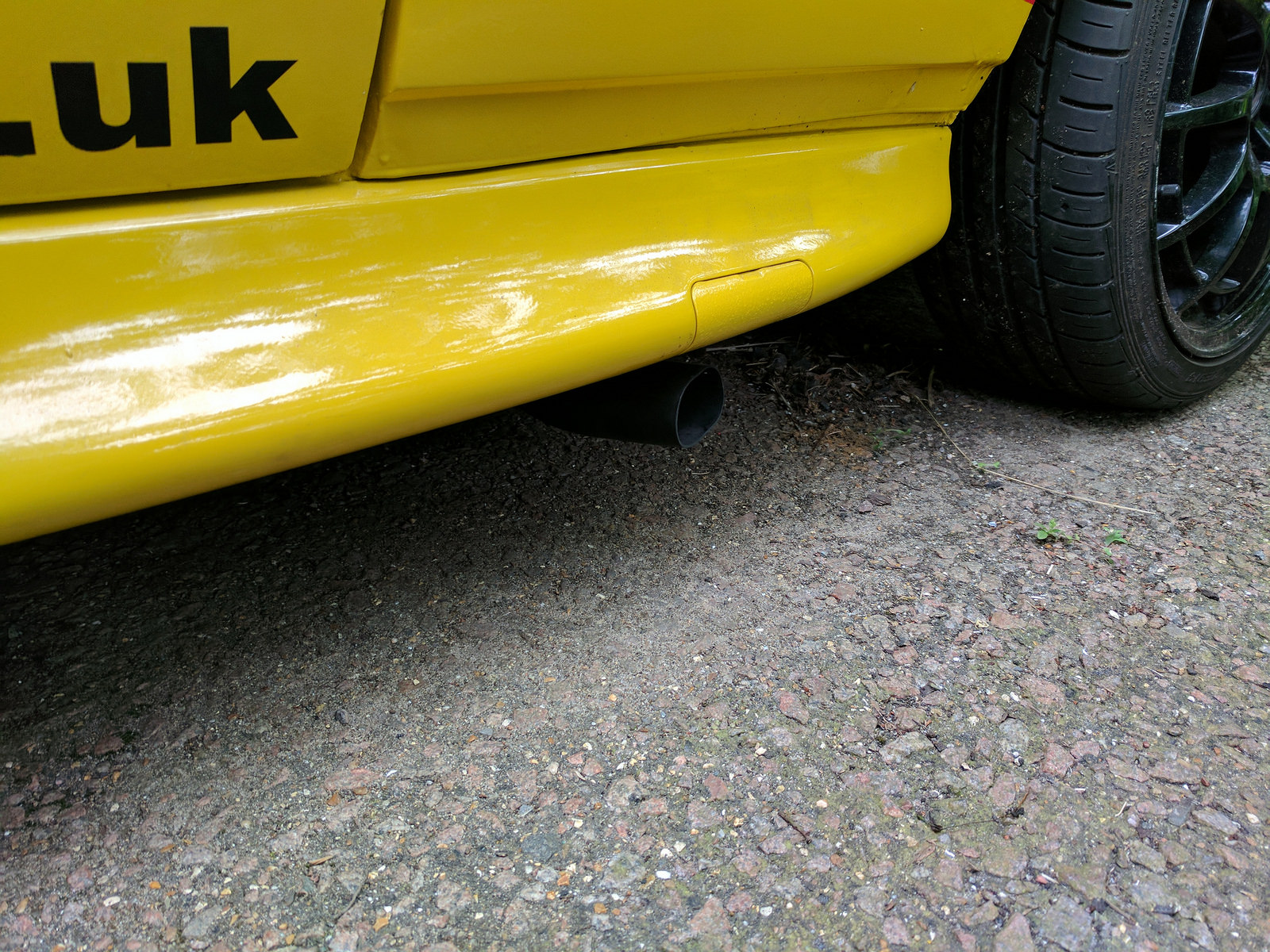

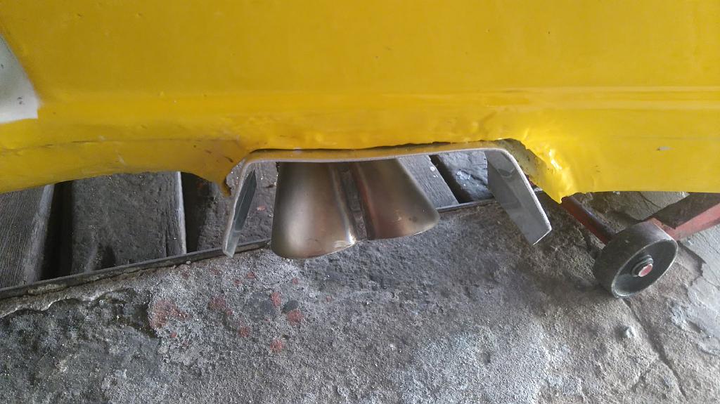

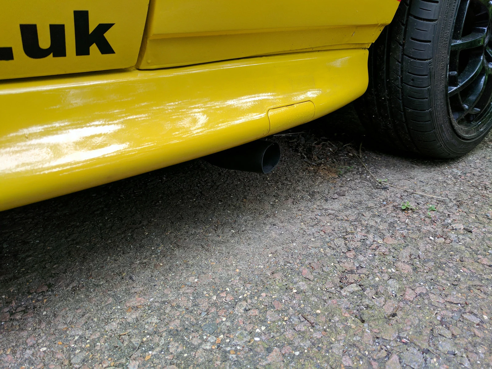

I can't seem to find the pictures I had under the car unfortunately, but this is the exit:
1409159
IMG_20170507_163653 by Jon Scoltock, on Flickr
You can see in this picture that it drops down to come out under the side skirt on my car. I didn't want to cut the sill on mine, mainly because I was lazy. Something I might do in the future if I can be bothered.

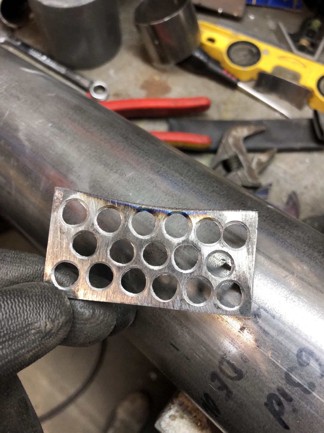

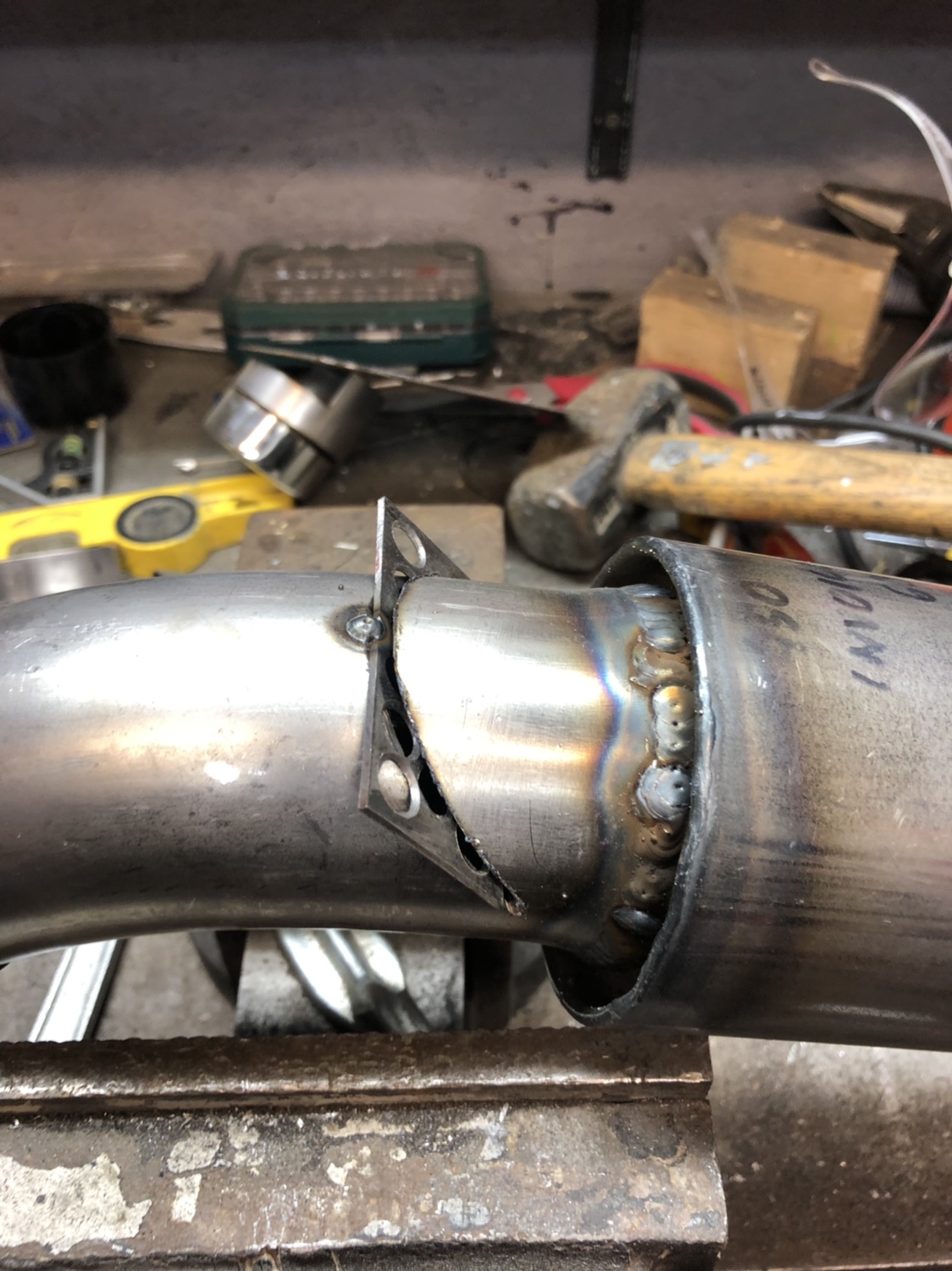

I also made four of these out of 1mm plate:
1409161
IMG_20181113_171503 by Jon Scoltock, on Flickr
I started with just two, but was still borderline, so added two more. On my car, they are between the silencer and the exit. I just cut a slot into the pipe, slid it in and welded. Then put the next one 3" away, rotated 180 degrees, then another 3", rotated 180 degrees again. As I said, using two got me from 102dB to about 100. The second two got it down to 97dB.

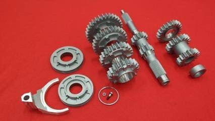

Straight cut dog gears ? Who are they made by ?
Can you not go sequential ? Wouldn't the cost be about the same ?
Yes Dogbox :) made in Holland. Sequential a lot more money. And less tourque. This will handle 600+ nm
Will be beautiful. +cant use sequential in any of the championships. Not that I think I will ever use this car for any. My sole and daughters college invested in this. If I even scratch the fucker I’ll cry for a week haha.

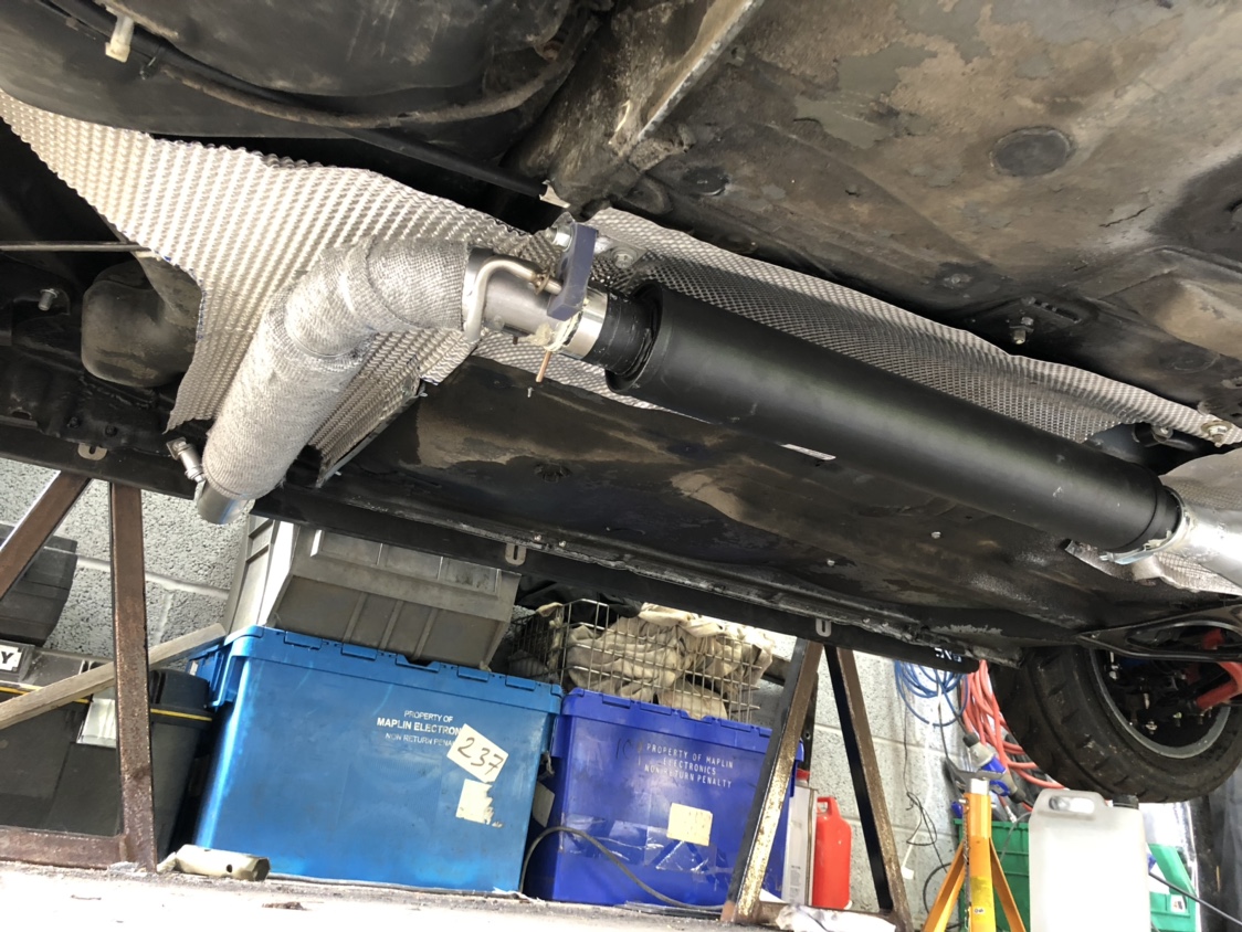

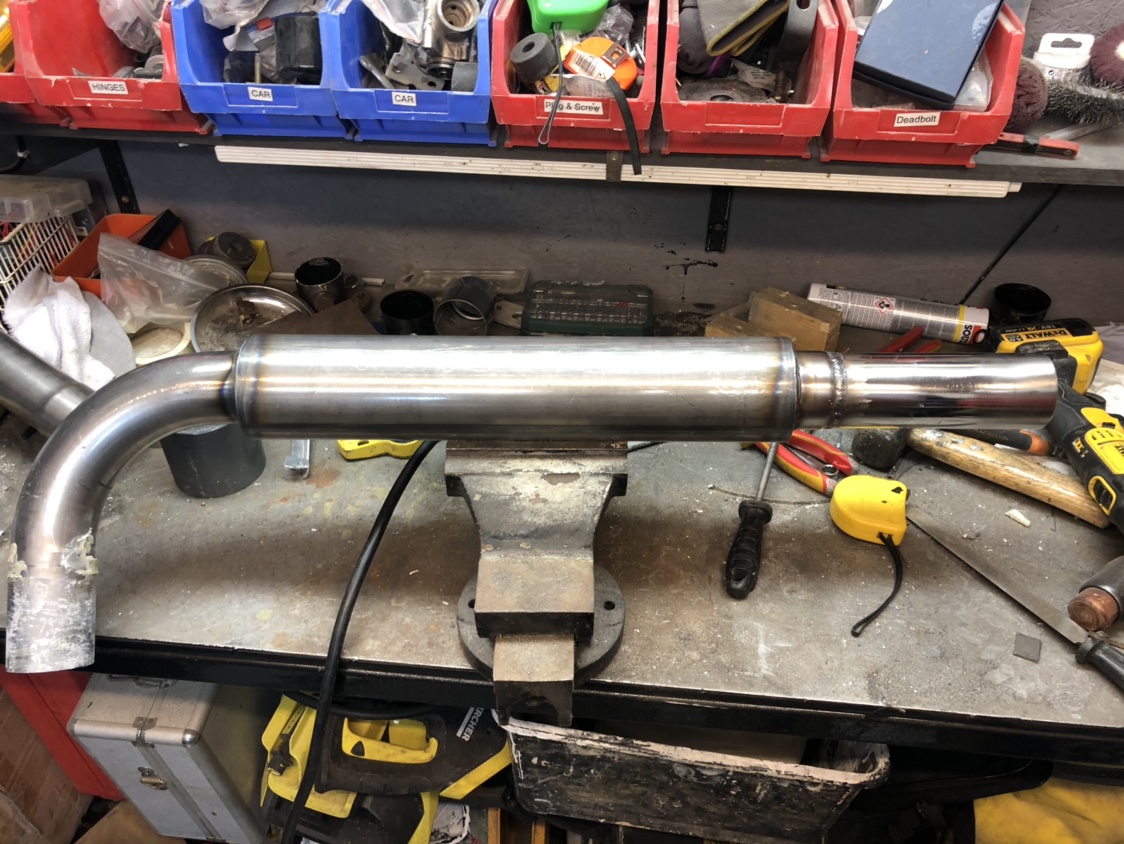

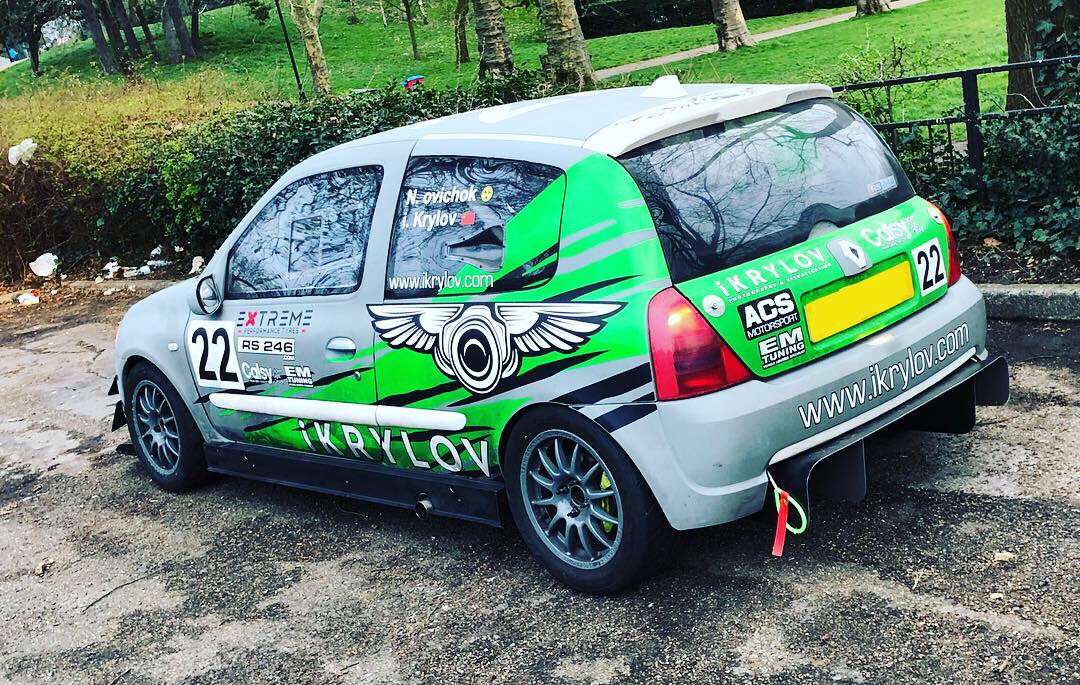

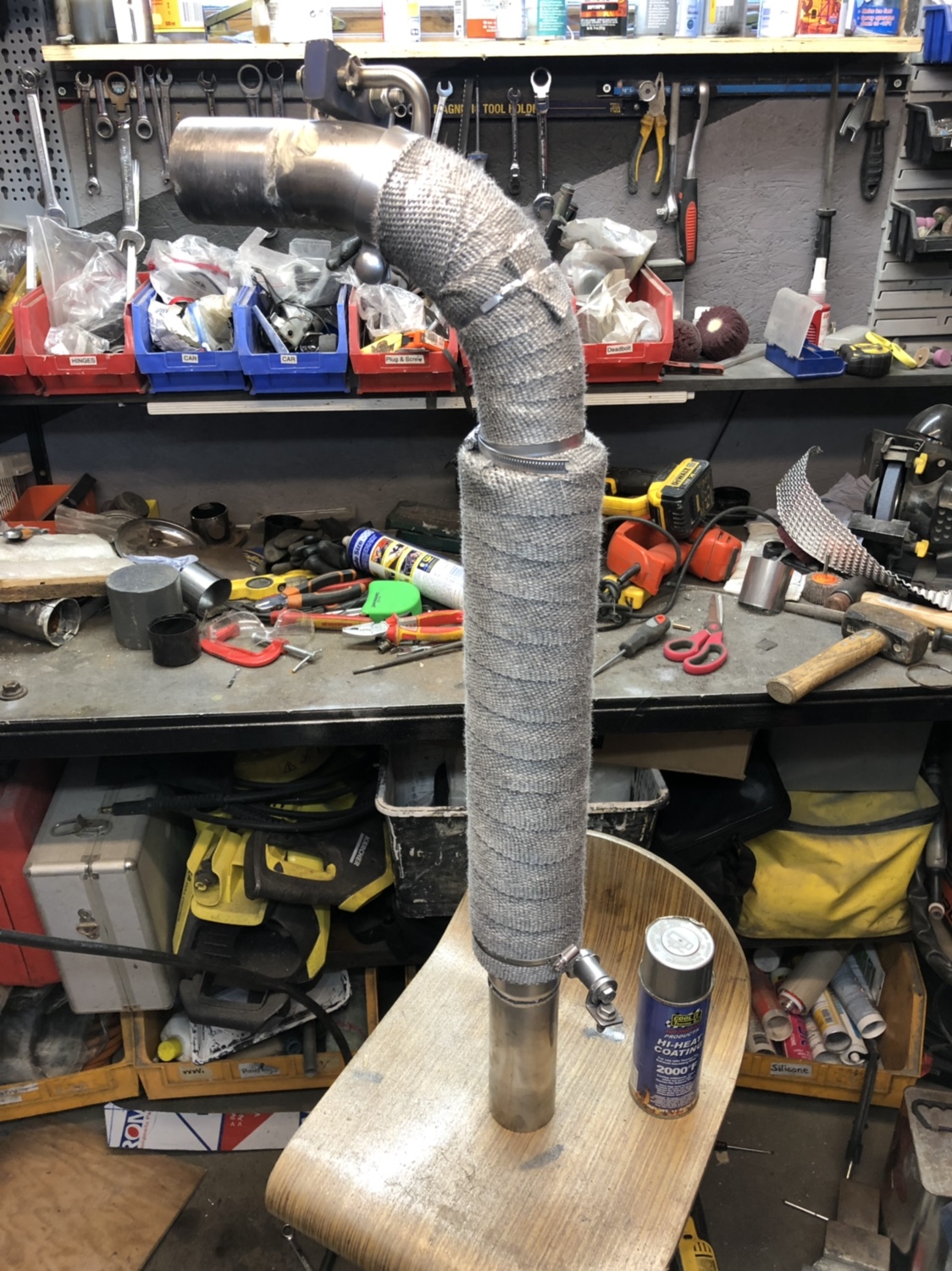

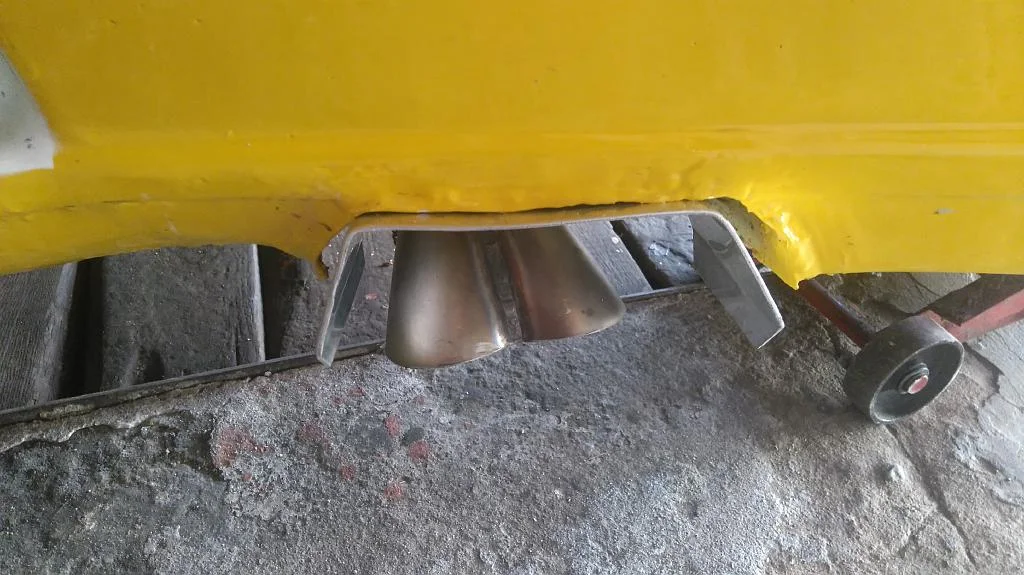

Quick update. Welded a second silencer in place. It’s 3.5” diameter with 2.5” inlet/outlet. 450mm long.
A quick test is showing its way under 105bd static most circuits use. But only at about 4000rpm as didn’t wait for it to warm up. Pointed the exhaust to the open side of the garage this time so it don’t get amplified. At idle it’s 89-90.

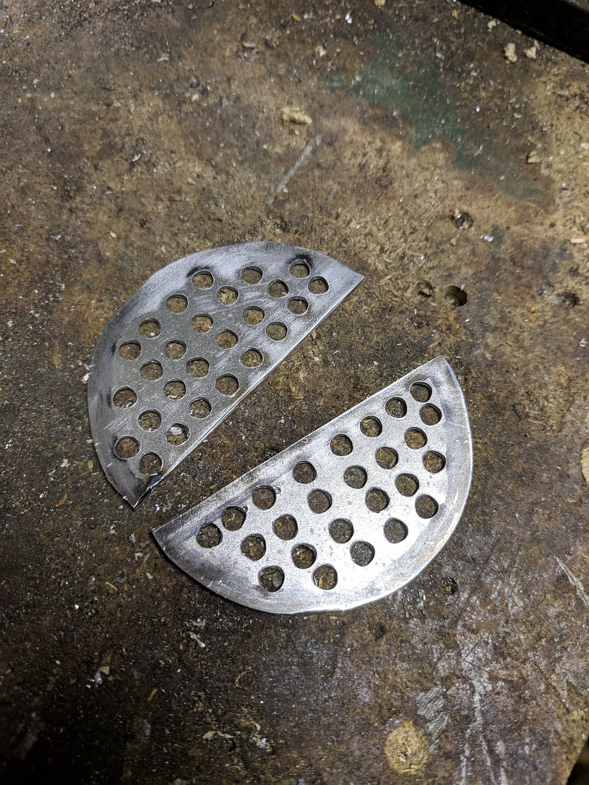

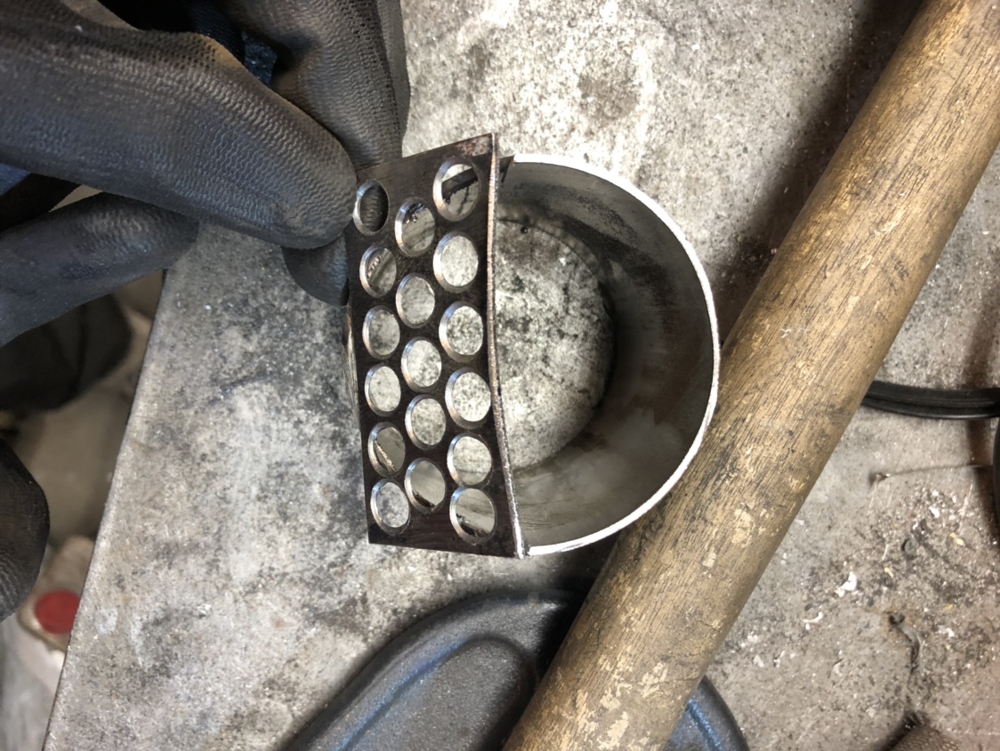

This morning woke up thinking it’s still too loud. So decided to add 1 half moon baffle just before secondary silencer.
Will see. If not enough can always add more. And based on my research this design, angled at 45 deg covering about 40% of the diameter has minimal restriction and negligible impact on power.

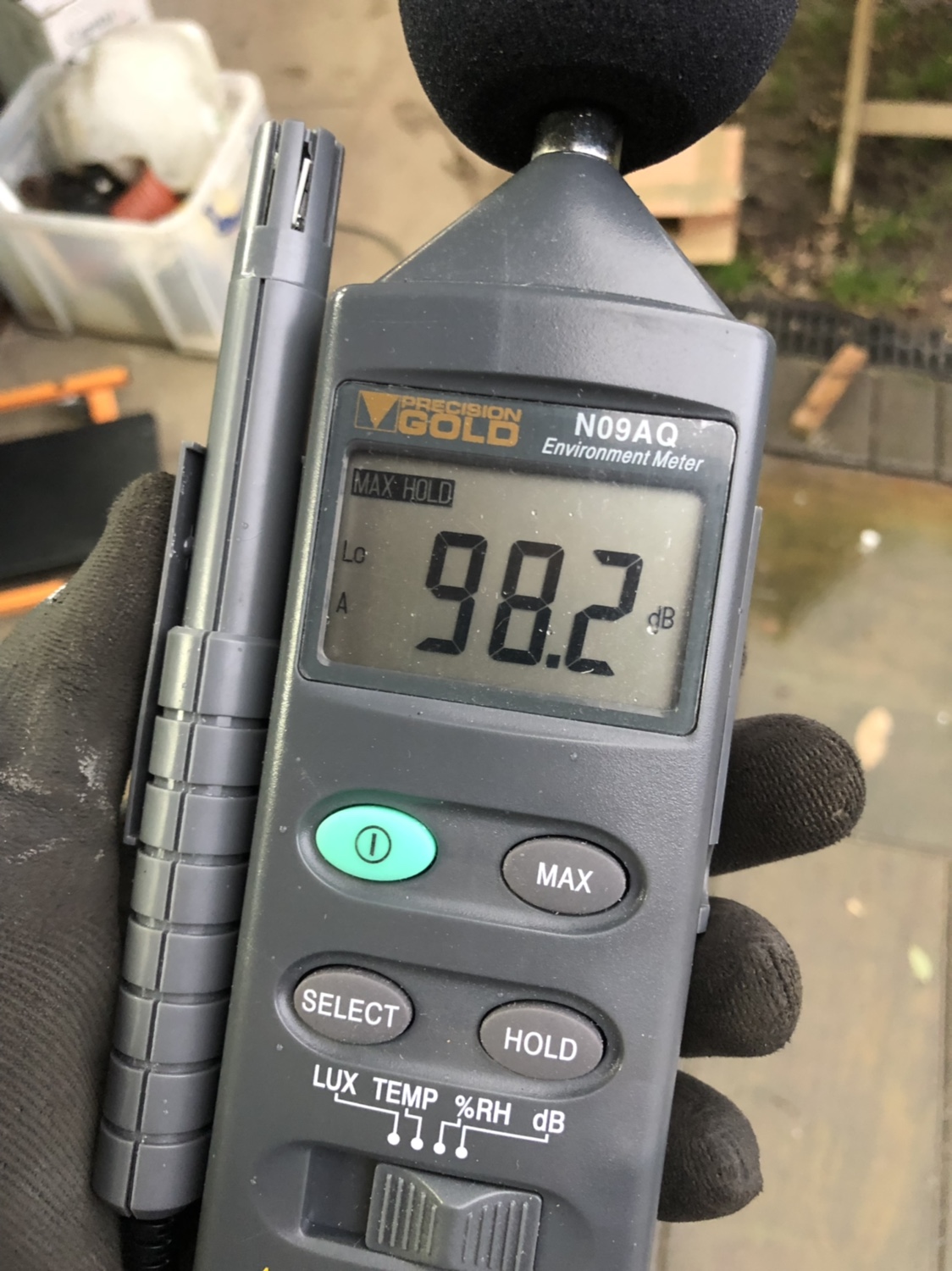

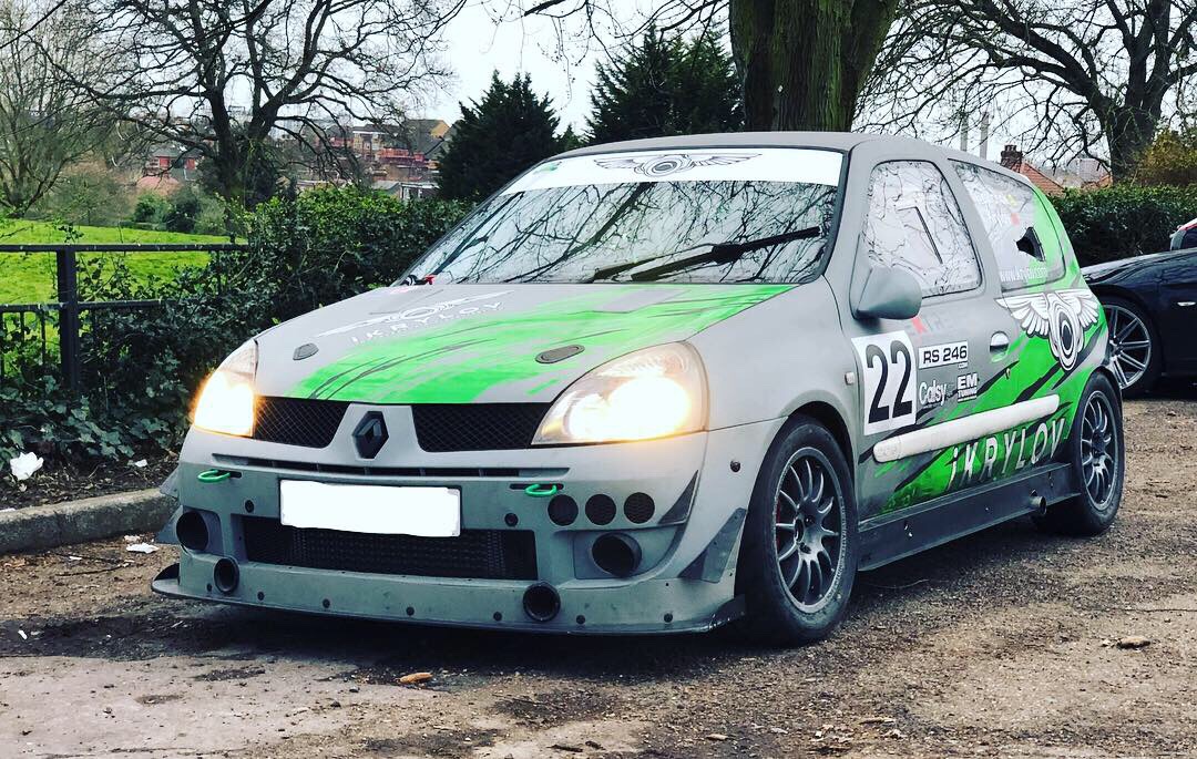

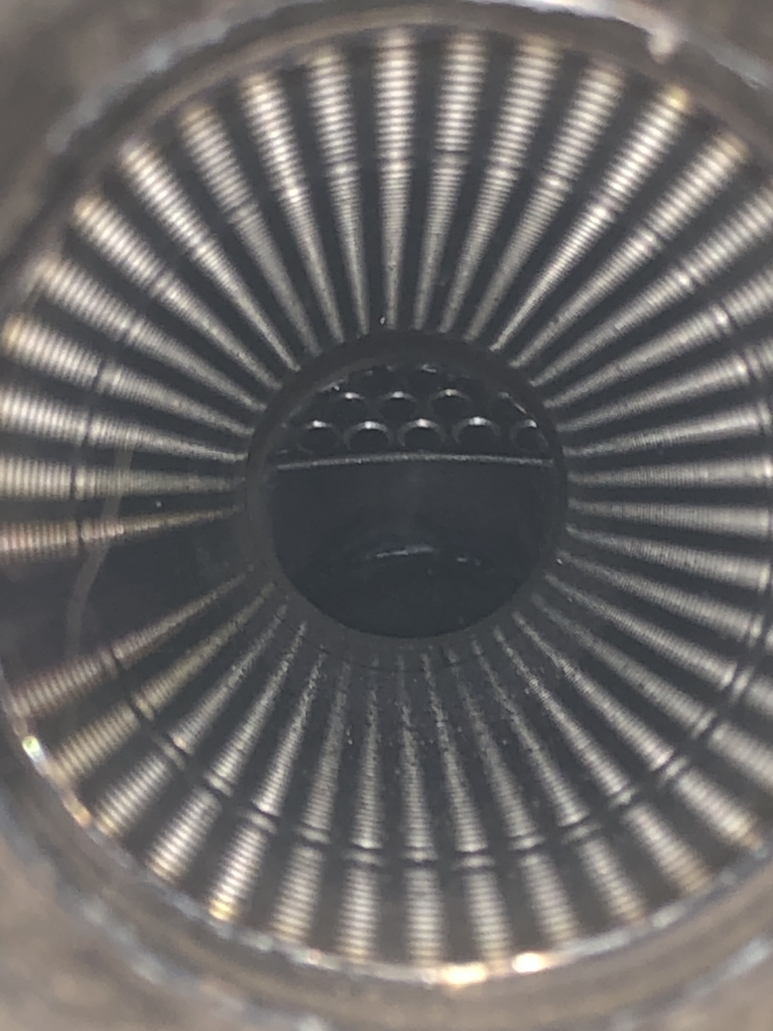

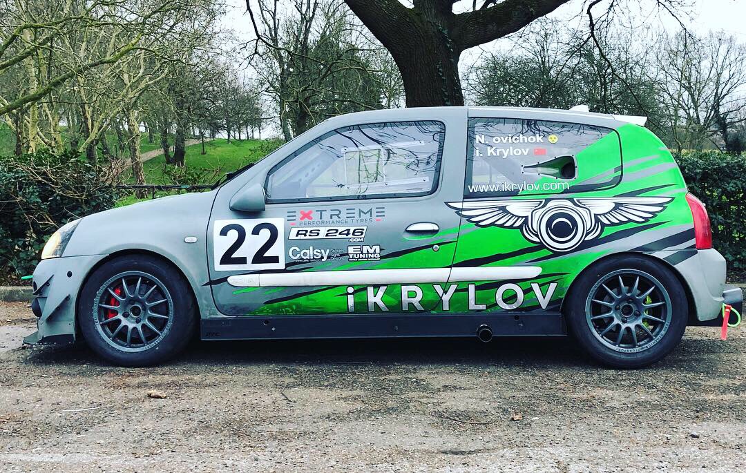

All done ready to test!
Sounds awesome. Nice and deep sound on idle. No drone! Inside the car only a tiny bit louder. BUT! According to my Db meter it’s still way too loud! This was out in the open. 5500 rpm. 59cm away at 45deg angle. Maybe my meter is phucked. Or it’s just too loud. Sod it! Ordered 24” 7x4” oval stainless silencer. Clearly 4” Jetex tubex silencer is shiite when it comes to absorbing the sound. Got some cool pic tho [emoji41]
