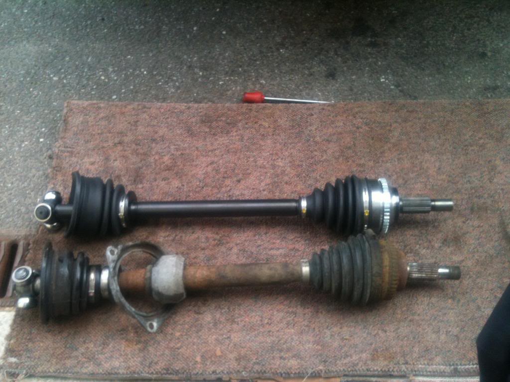

Very nice inferno mate! I'm still in the process of getting mine where I want it. Got it booked in on the ramp monday, dropping it 40mm with apex springs, fitting new n/s driveshaft (cv knocking like s**t!) and fitting front splitter. Should be an interesting day. If I've got time might start polishing the inlet coz imo it looks immense shiny!
Thanks mate. Aye, I also need a n/s driveshaft. Where did you get yours?

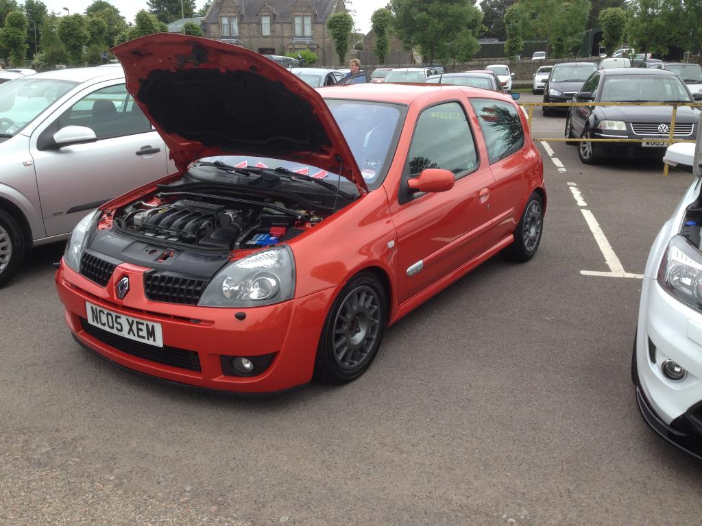

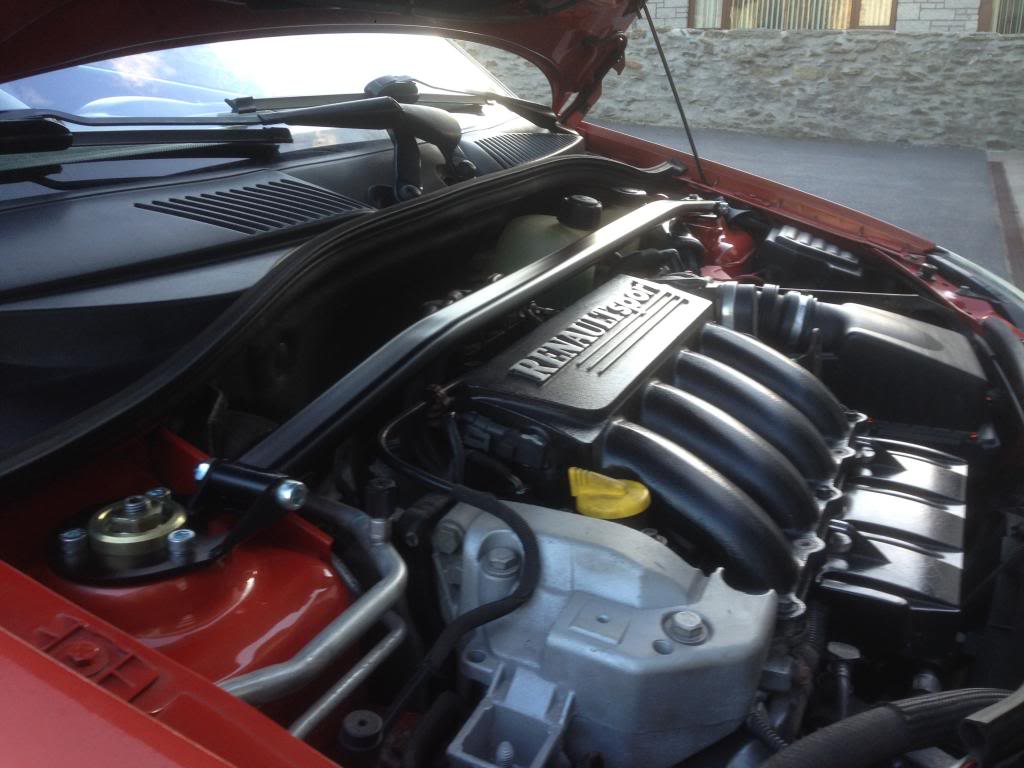

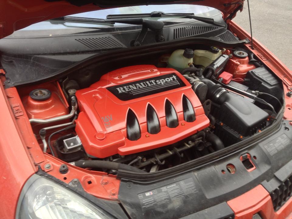

Engine bay nearly finished, looks much better imo. Still some polishing to be done on the lettering, and a few touch ups on the black parts, but will get that done. Oh and paint the fuel rail gaurd thingy the same gloss black like the inlet.
Also fitted some orange anodised bolts to the airbox. A quick pic:

Thats smart that. Looks very clean! Got it of ebay, brand new only £65 posted! From Ebay seller j_r2006. I'm not starting on the engine yet, few other more expensive things to sort like recondition the alloys :(!

Cheers. Ah, is that JR shafts? Is there a warranty with them? You not thought about some aftermarket alloys? Not 2118's though, or I might have to kill you :p lol

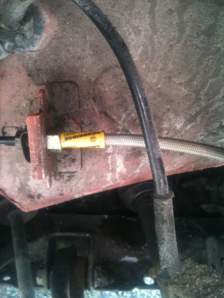

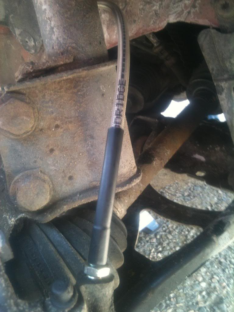

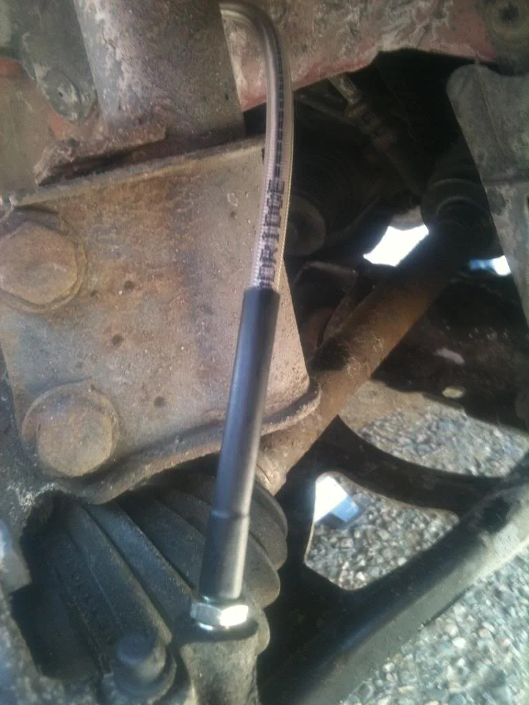

Today I changed the front and rear brake lines to goodridge braided lines and put in some new brake fluid. Brakes are much sharper now. It amazes me how some people overlook changing their brake fluid!
Started off up in the air, usual sight for a french car! :
And fitted:
Much better! :)

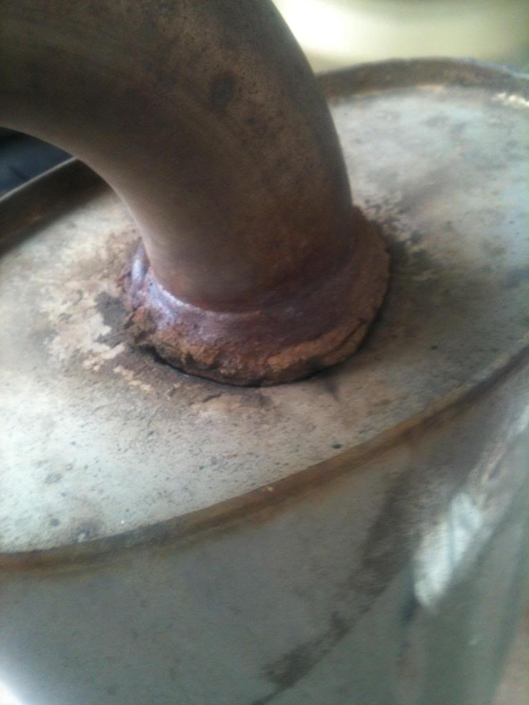

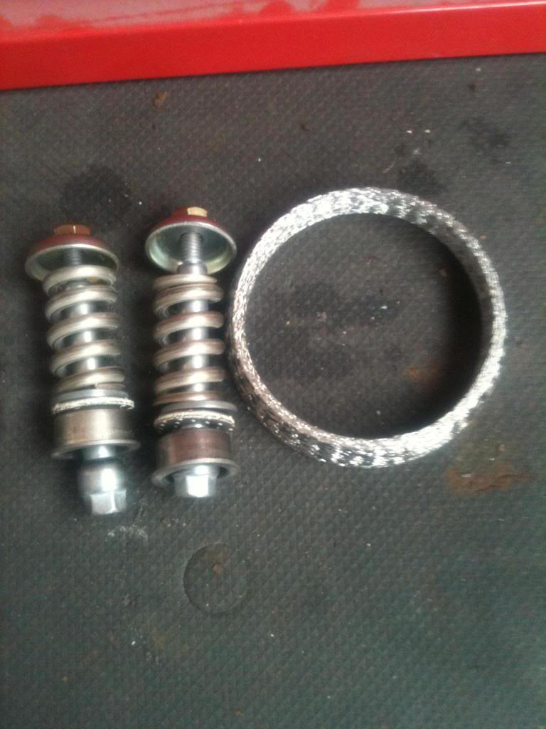

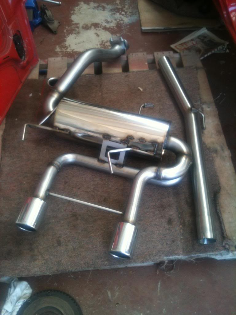

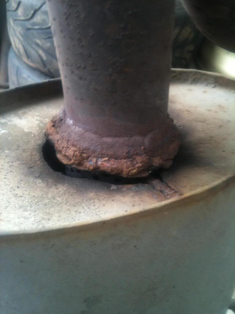

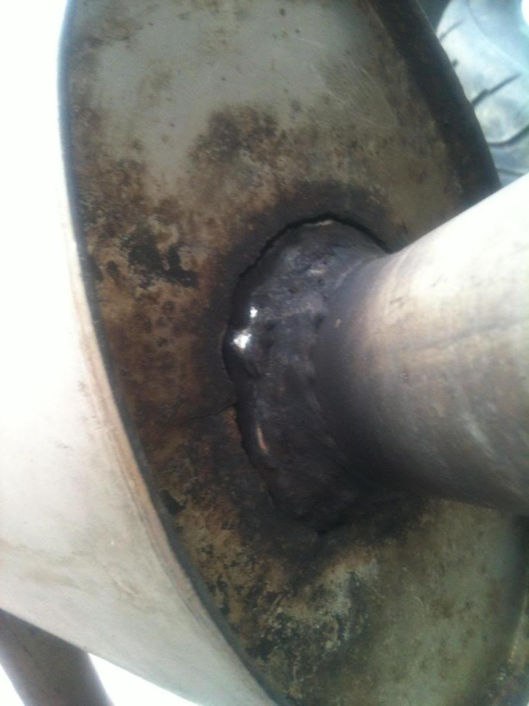

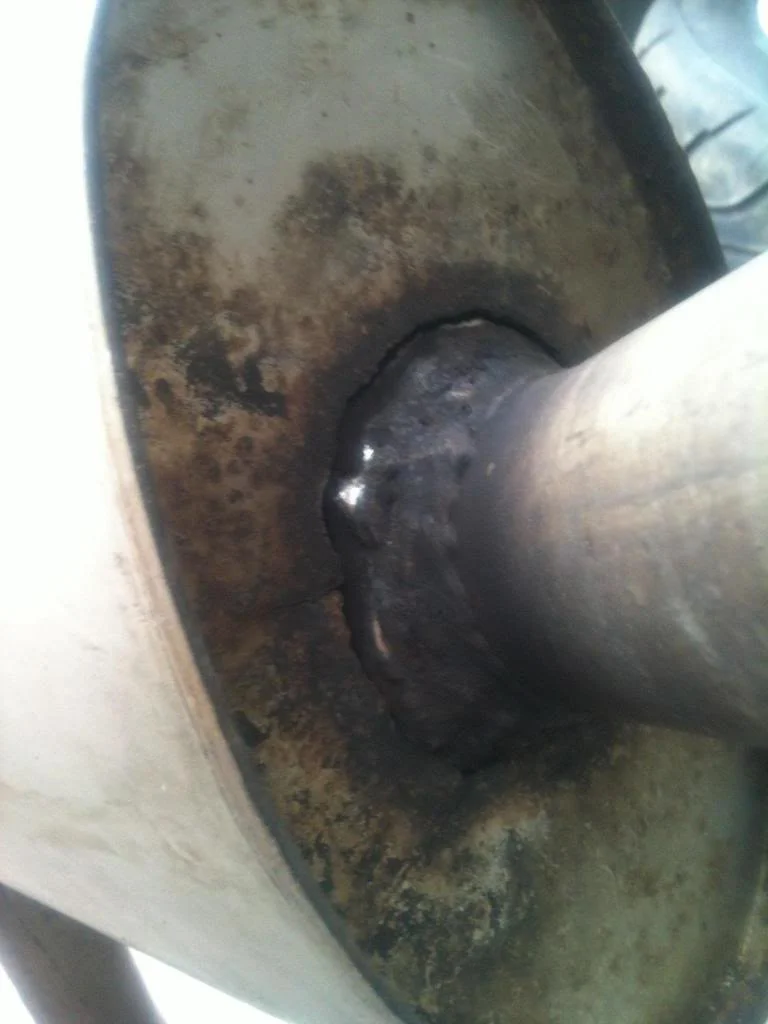

So yesterday I fitted my new k-tech exhaust as my miltek had cracked rather epic-ally (see pics below) I went for the supersports version without the silencer and it sunds much better imo. No more blowing everywhere! Its quieter on idle, and doesn't drone when cruising at 60-70 so Im very happy. Ordered it thursday evening and it arrived Monday, so a quick service also. :)
No fitted pics yet, as I still need to sort out the third mount at the back of the exhaust.
New gasket at the manifold:
Now for the cracked miltek, it had cracked at both sides of the box, so the box could pretty much move freely! Not impressed with the quality at all, and definitely will not be buying anything from them!

christ i bet that sounded fruity with them cracks lol .
​ive always thought miltek were decent as on zsoc.com they are the exhaust to have ... them cracks are shocking mind , have u contacted them ?

It was dire! haha. Aye I thought the same, had always heard good things about them on other brands. Nah, Iv no contacted them.

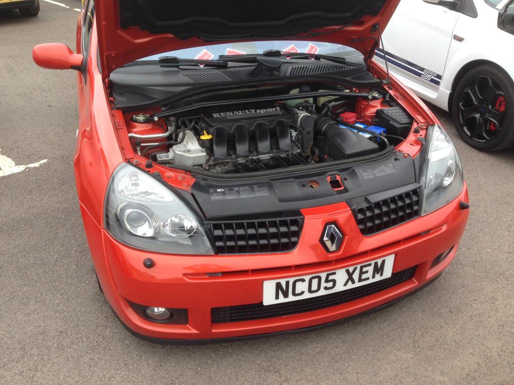

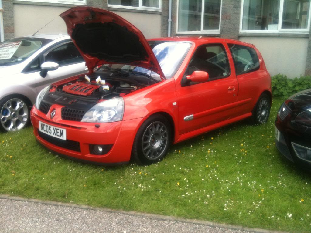

Was at a local car show today, so just a few random pics from that. Got all the tar removed, sticks out like a sore thumb on this colour, then polished and waxed it. Was looking great for the first time in a while :) Also got a machine polisher(das 6 DA), so will be getting a bit of practice and then will attempt to remove all the swirl marks on this. My alloys are still covered in what looks like iron or something, so will have to get that removed. Any recommendations on what to use?

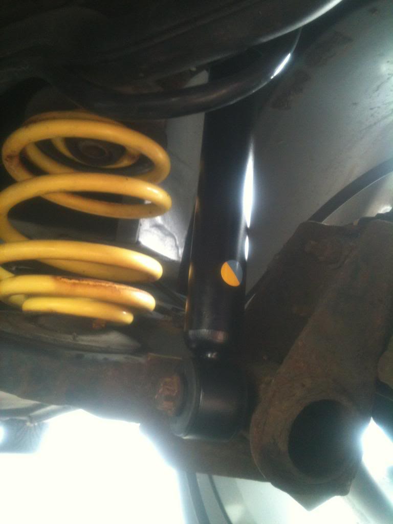

24/07/13 67, 430 miles

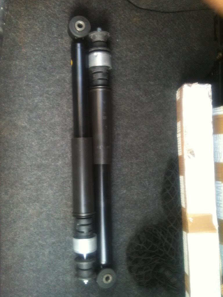

Fitted cup rear shocks. Back end was starting to feel a bot "loose" (ooh-err) Should hopefully sort that out! New windscreen fitted today, so MOT tomorrow. See how that goes :)

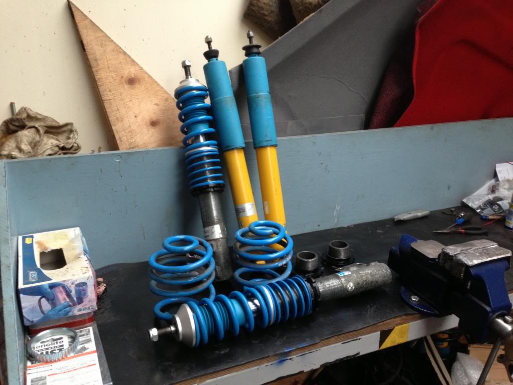

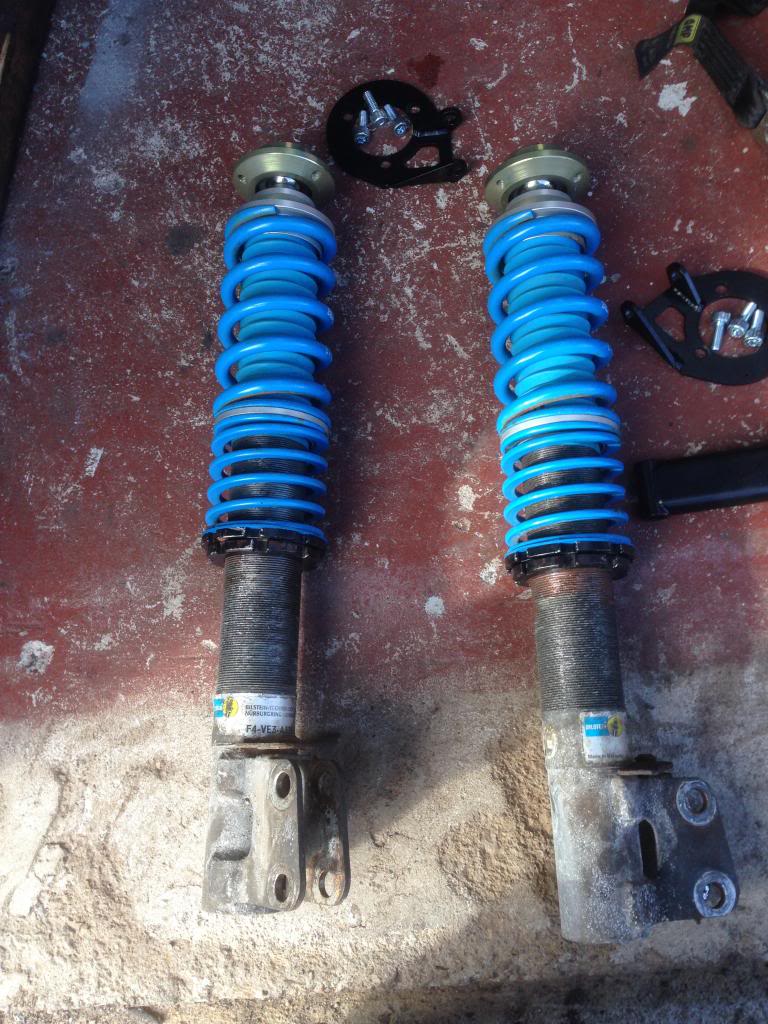

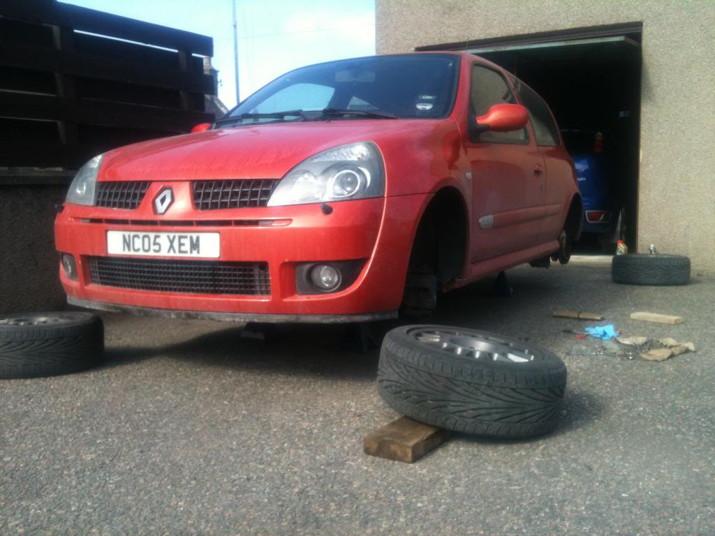

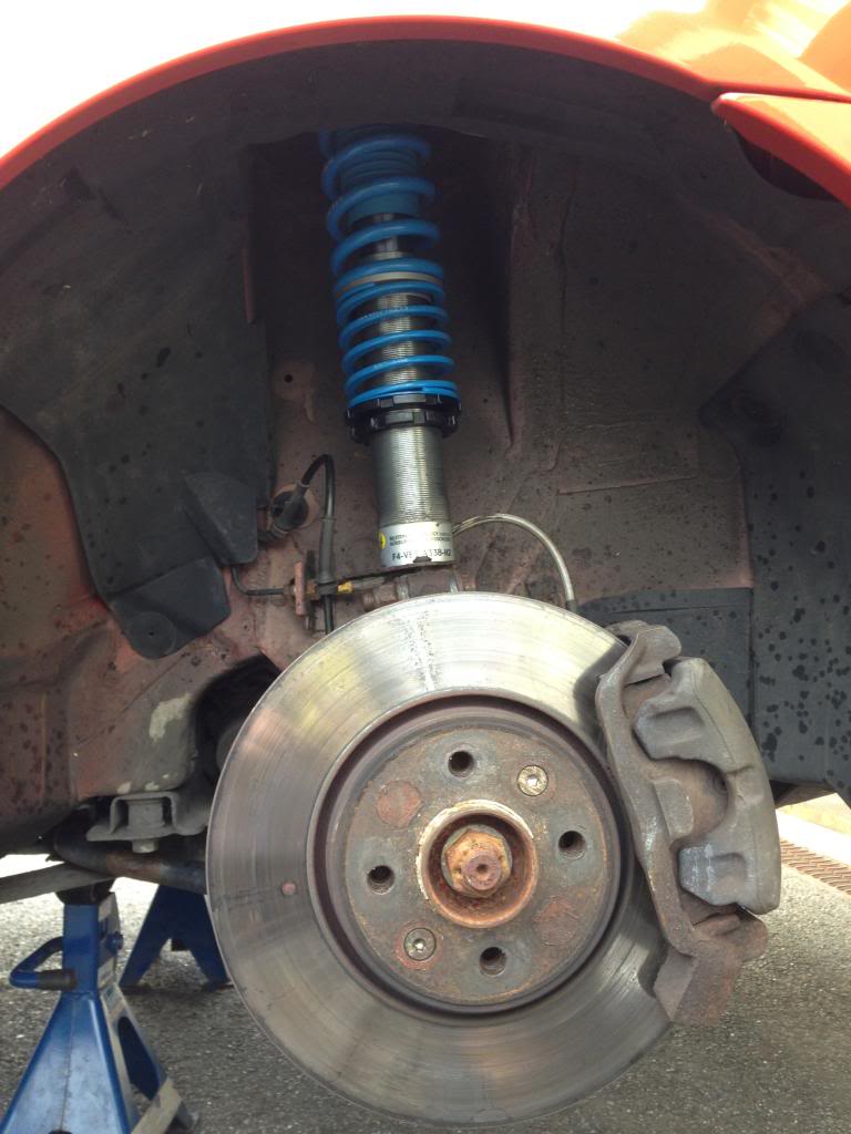

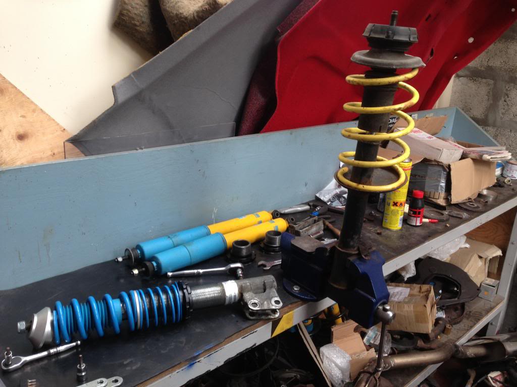

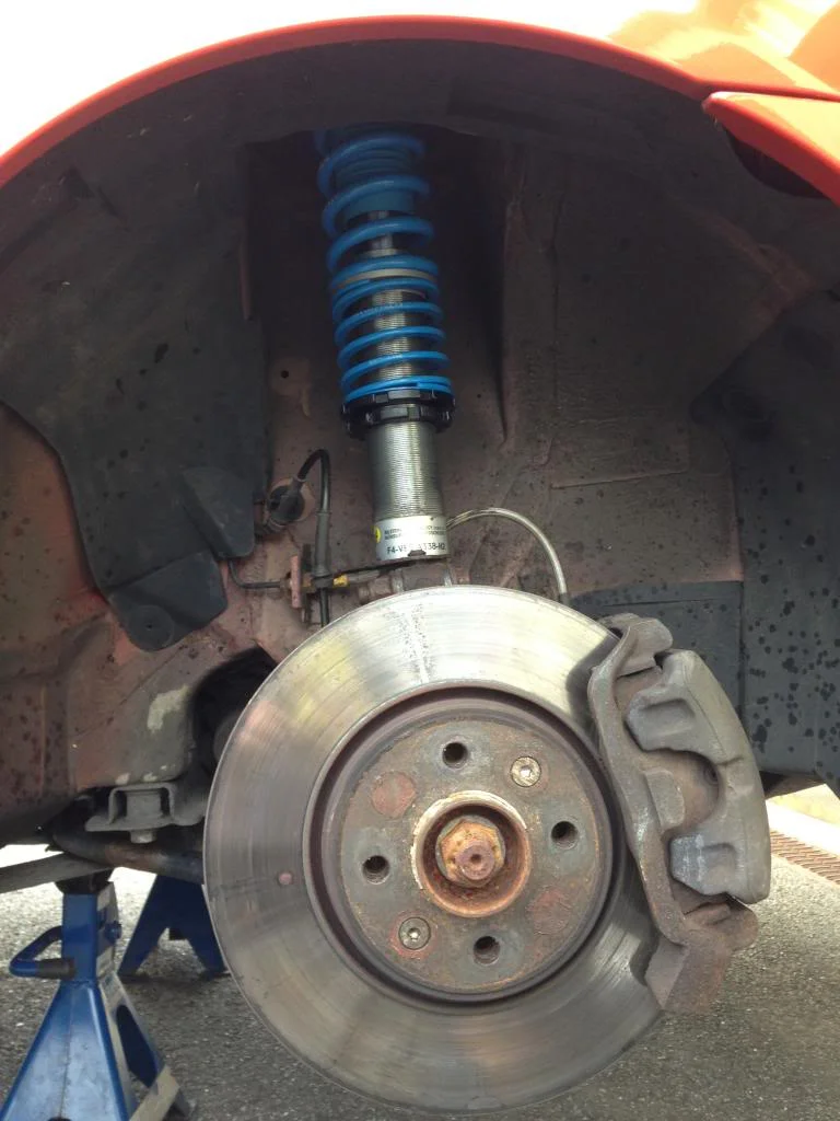

Bought these the other week: B14's
Came up for a nice price I feel, having just had the front 2 rebuilt. Fitted them today, and the ride quality is vastly improved. Its firm, but smooth at the same time, unlike when it was previously only lowered on apex springs. So, next on the list is to get some solid top mounts. Looking at the Pure Motorsport kit, but just seeing if there is any bargains second hand just now. Also, I need to sort the exhaust mounts. Think I will do the polybush "mod" that seems to be quite popular. Hopefully last longer than the standard crap mounts!
Anyway, a few pics of the fitting: Swapping over the top mounts:
Then fitted to the front.
Still need to adjust the heights, but the front is about the same as before (not bad for a complete guess at setting the adjusters!) Rear is currently higher, but will wait till daylight and find somewhere flat to adjust them.
Cheers for looking.

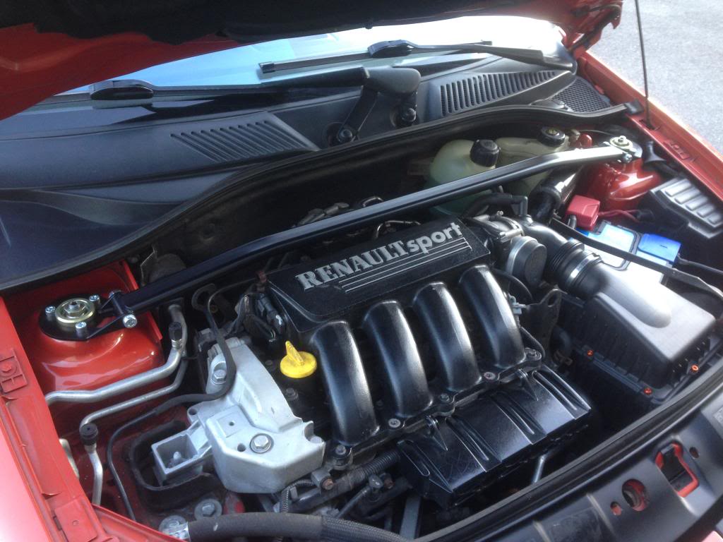

Pure Motorsport top mounts and brace fitted.
So yesterday I fitted my mounts and brace that have been sitting for ages! Got them back in the group buy that was on near xmas time. Can feel a nice improvement in the steering now and I look forward to my trackday this saturday, hope the weather holds out. I also gave the coilovers a quick clean down and re-greased the adjusters. Drilling the strut tops was a bit worrying at first, and I received a few weird looks from the neighbours lol, but got there in the end.

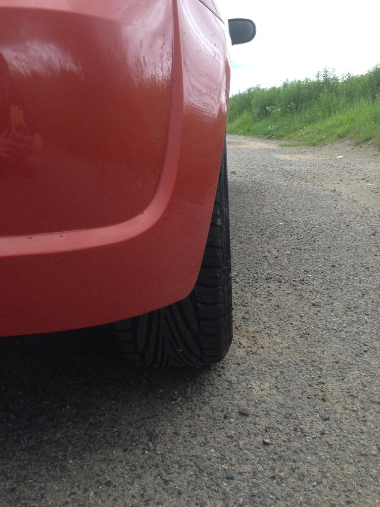

Firstly i fitted my 10mm 1 degree spacers, think they tidy up the rear end really well. Need some spacers on the front now lol.
Before:
After:

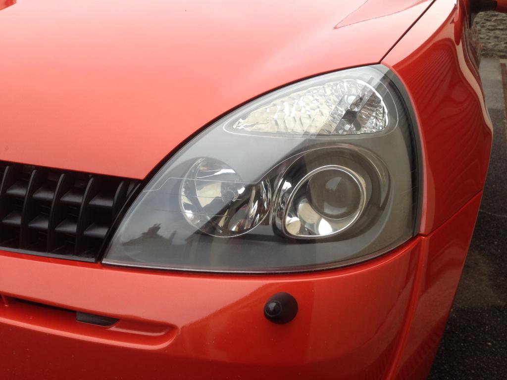

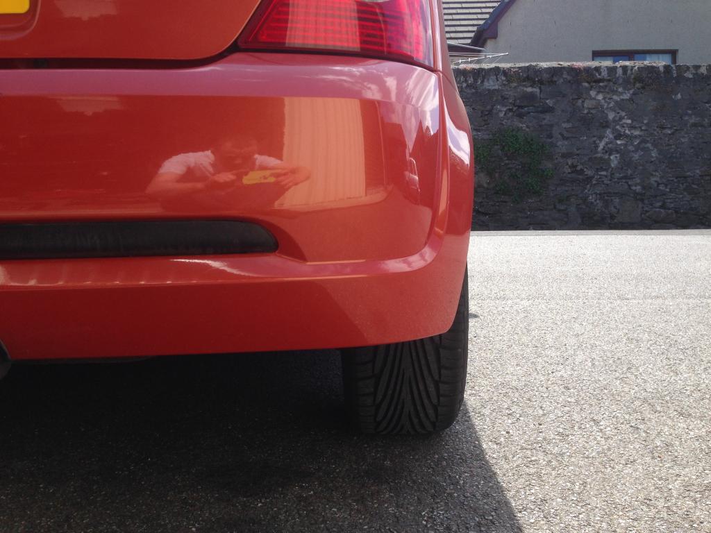

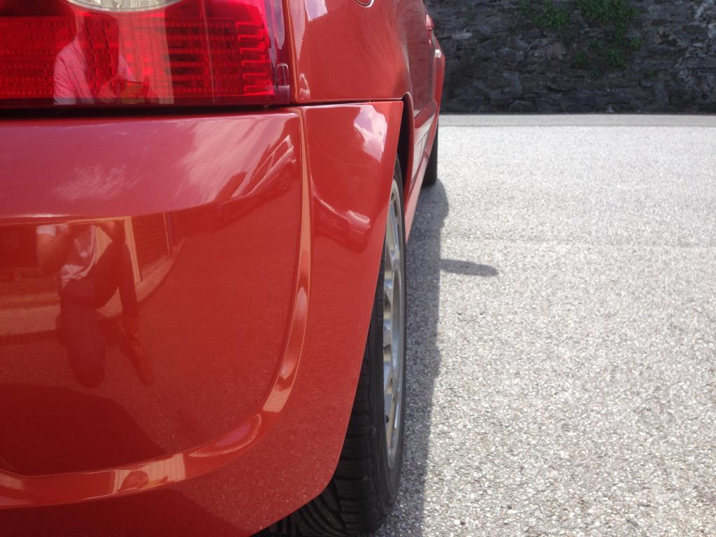

A mate wetsanded and polished my front lights for me, they came up brilliant. I felt they were really letting the front of the car down. Now all the stone chips let it down a lot :( I then gave it a good clean up, de tarred it all, polished then waxed with collinite again. The paint is starting to feel a bit rough again, so might be time for a clay again. Heres a few pics of it at a local car show looking all clean! :)

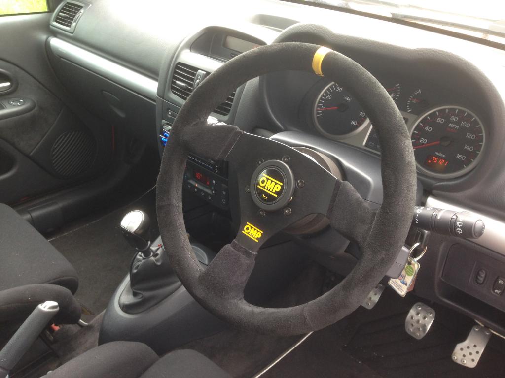

I then fitted my omp 330mm targa. It really is so much better to drive with a small wheel, especially on track. Sometimes felt like you were steering a boat with the standard wheel! I love the suede too, hope it doesnt go flat too soon! Any tips for keeping on top of it?

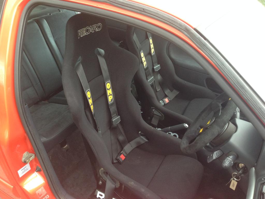

Next up i set about fitting my bucket seats and harnesses. They are soo comfy, cant wait to try them on track next!

99% sure they are Apex seats not Poles, car still looks awesome.
Just had a google you're right. It was only the Recaro lettering that looks an obvious difference to me. Good spot!
Ah ok, i had no idea tbh, i bought them second hand. They were really comfy and fitted me well so decided to go for them. Well worth spending the extra on decent seats!
