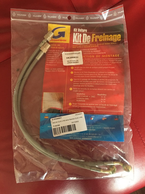

2) you will need new lines as they are different fitment. http://www.optimiz-access.fr/freinage/durites-aviation/durites-aviation-clio-2-rs-etrier-clio-3.html
buy them here, they are goodridge braided ones from France, perfect fit, dirt cheap (due to exchange rate) and takes a week or less for delivery. google chrome and right click to translate. if ordering england is rayaume unis on the order page (thank me later)

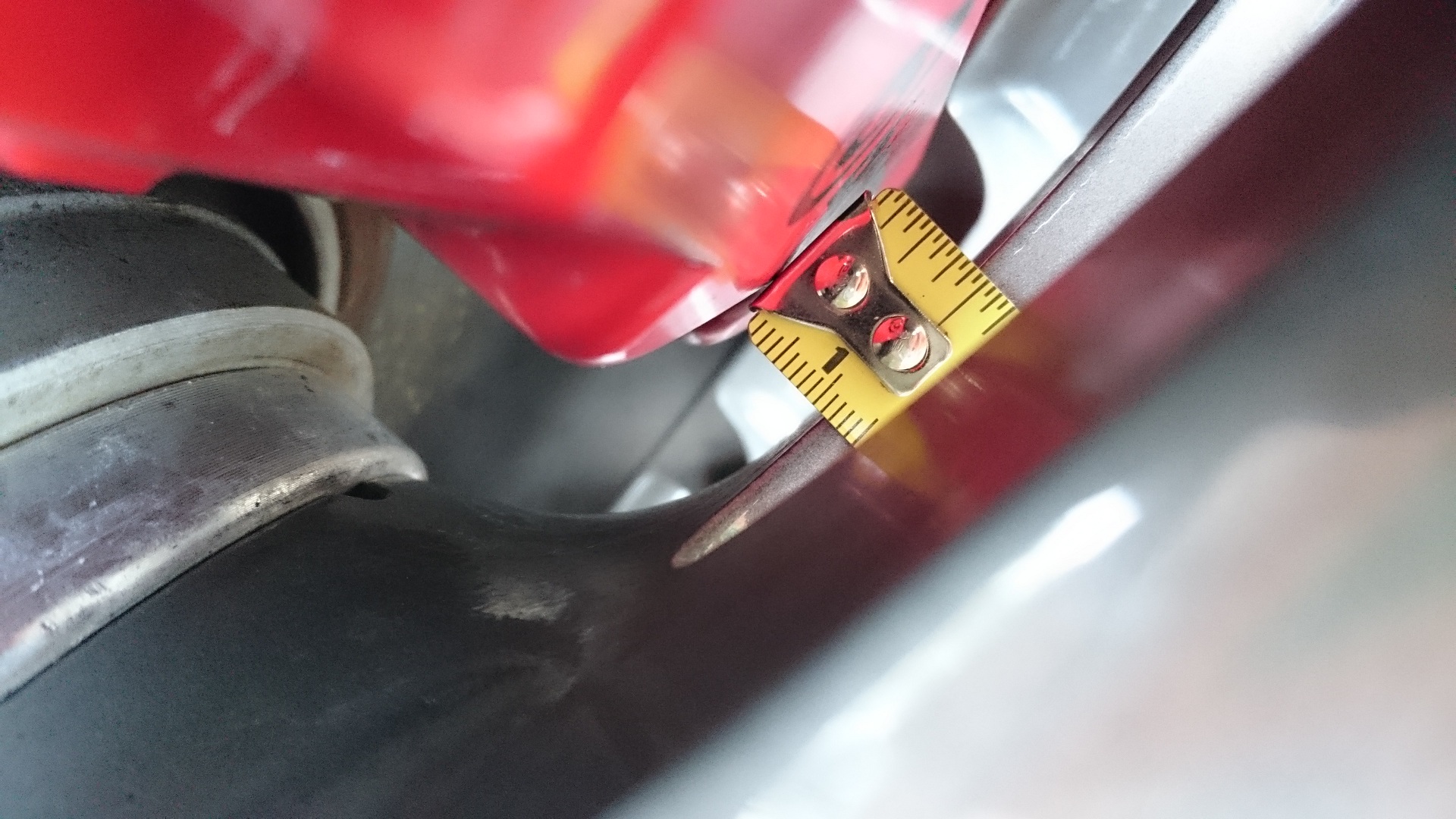

let me go and measure....
Gus
  182Turbo,DCi90

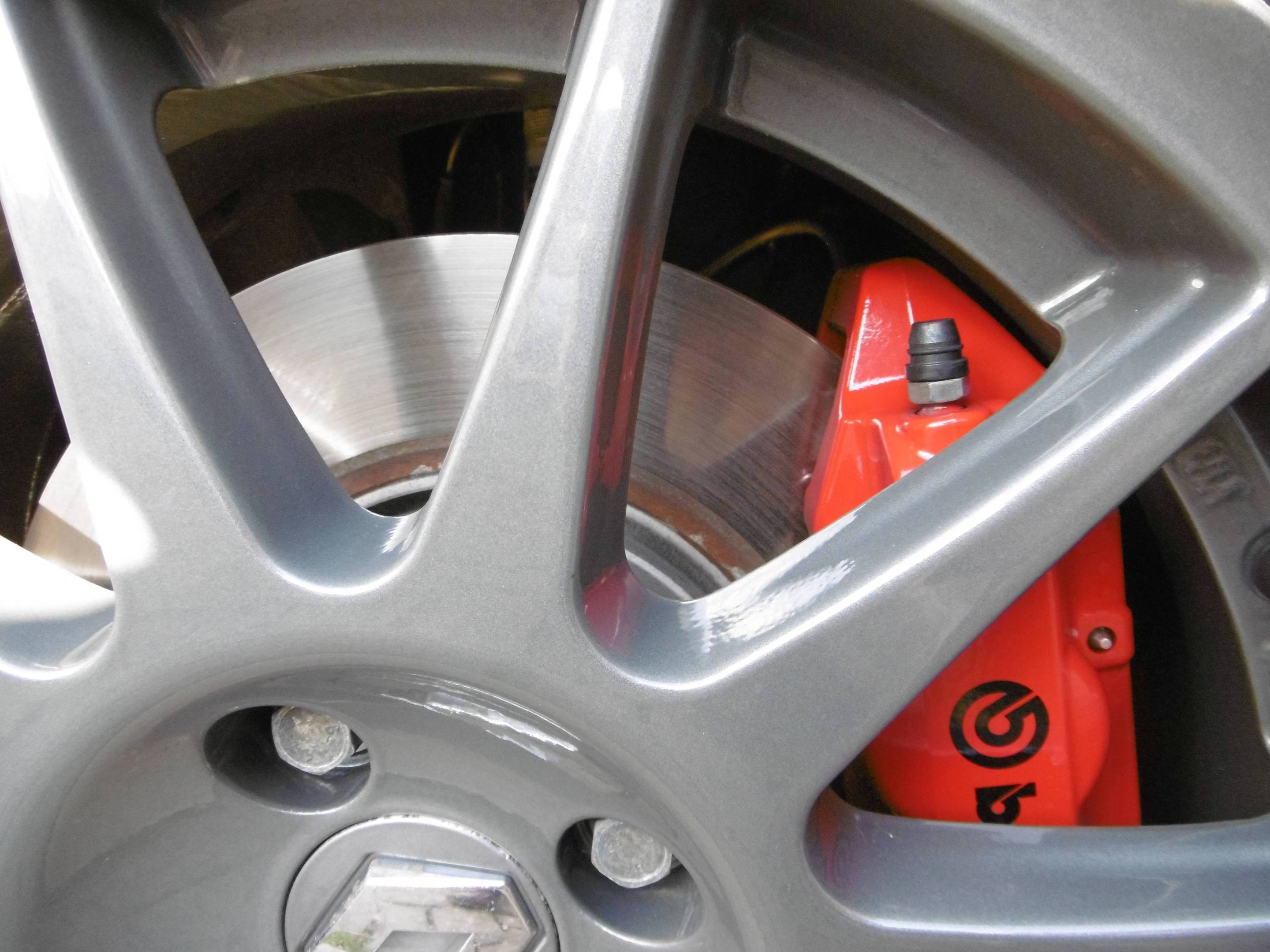

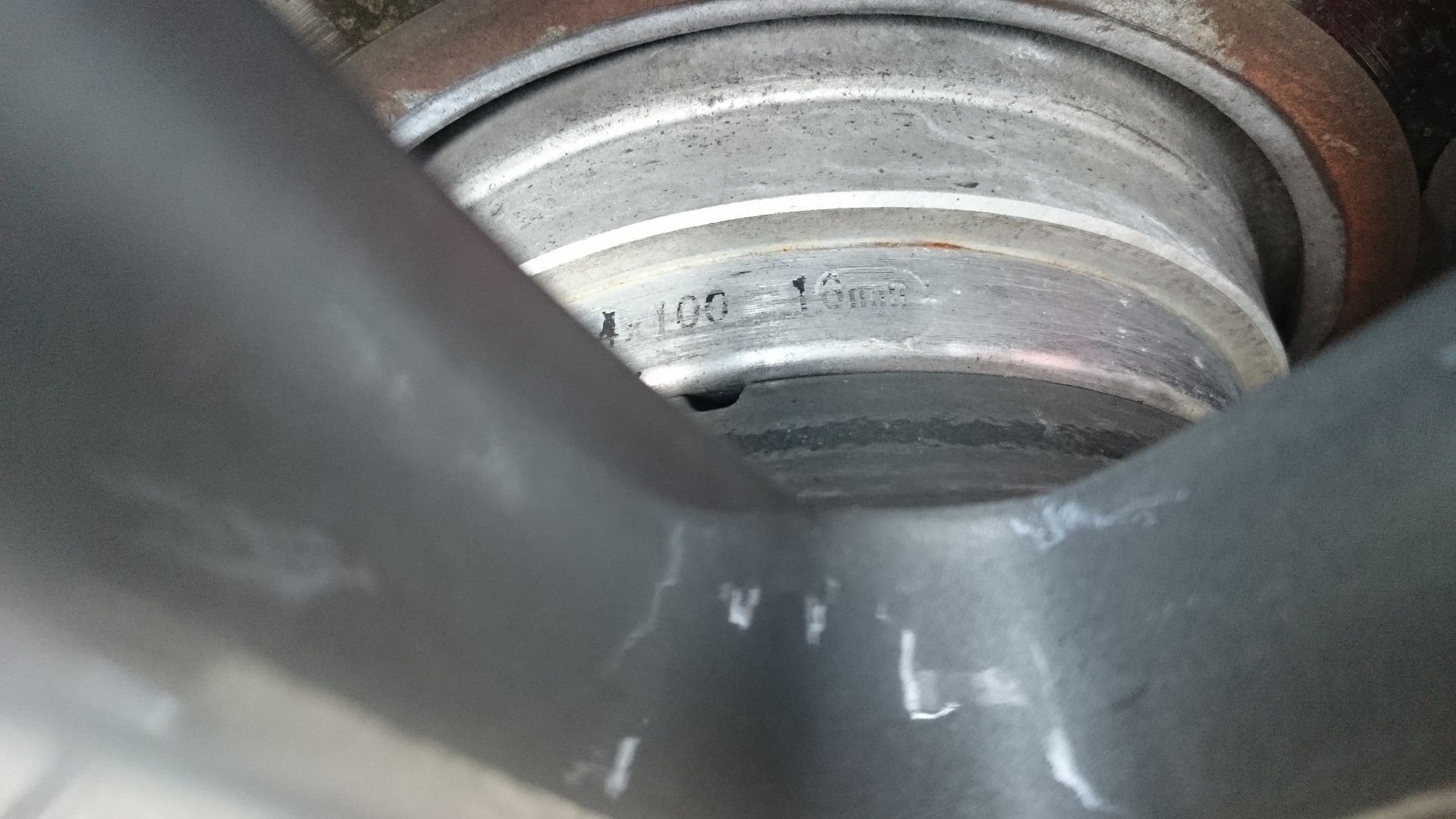

I use ET 45 Turinis (trophy turinis)
I have 16mm spacers:
and there is a 12 mm gap at the shortest point between the wheel and the caliper.

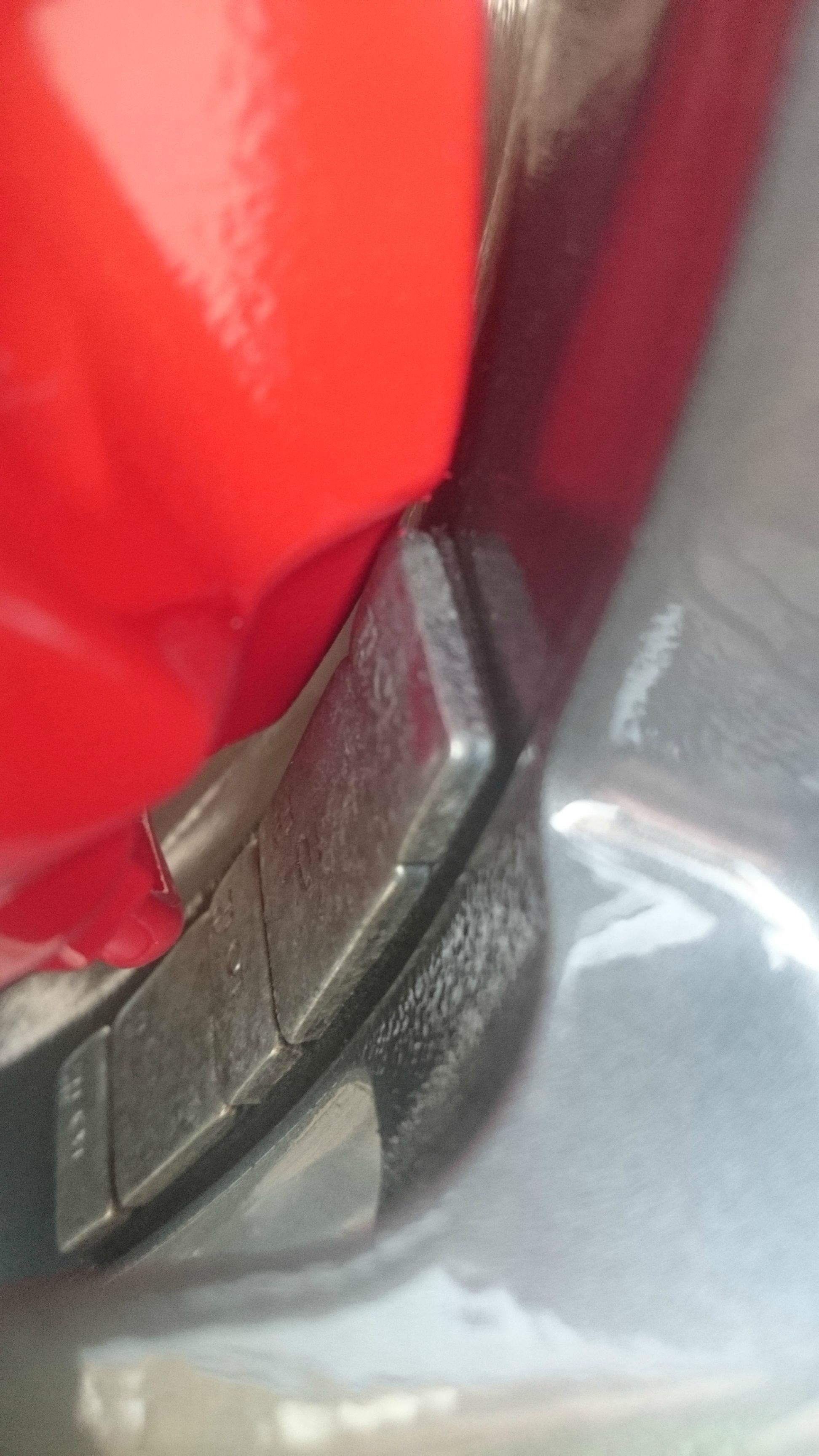

Here is an old pic when i first fitted the kit.
you can see the inside wheel weights foul the caliper so you will have to get the weights moved to the middle of the wheel and rebalanced.
Cant stress how awesome the brembo brakes are though !

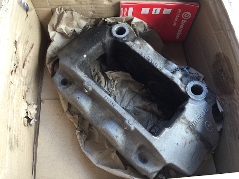

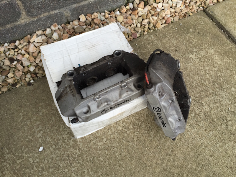

Today I picked up the following -
Front pad fitting kit - £6.00
Front 300mm discs & pads -£55.00
Braided 197 brake lines - £40.00
All that's left is the brackets from puremotorsport @ £190 odd
And the full refurb from Pro Calipers in London

I have spent hardly anything if I'm being honest.

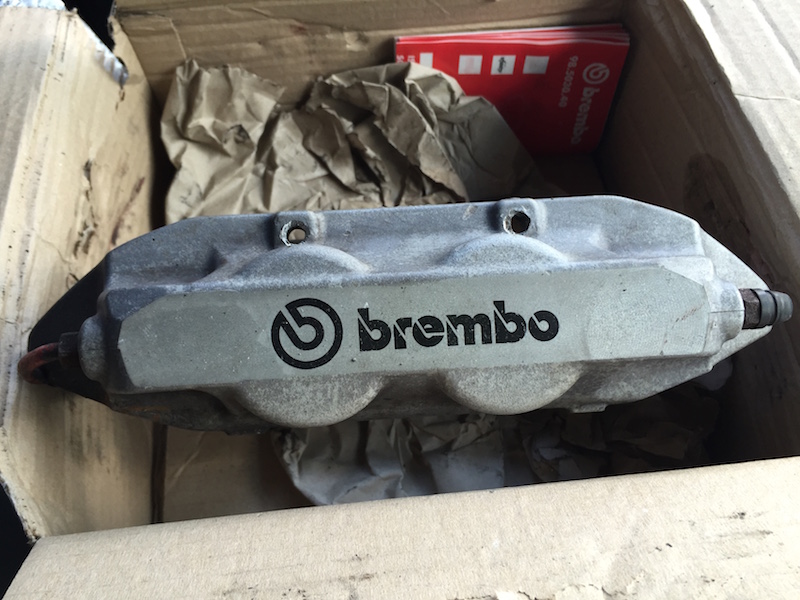

Calipers = £155
197 Hoses = £40
Pads & Discs = £55
Fitting Kit = £6.00
Callipers Brackets = £195

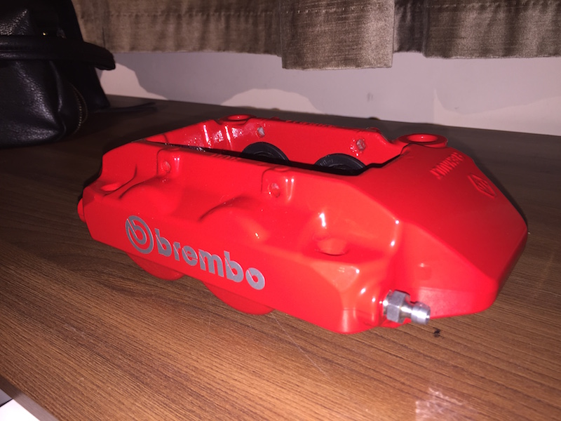

Full Refurb & Powder Coating will cost me £380
Total = £831
This is a lot cheaper than the Pure Motorsport full Kit @ £1145 saving me £314

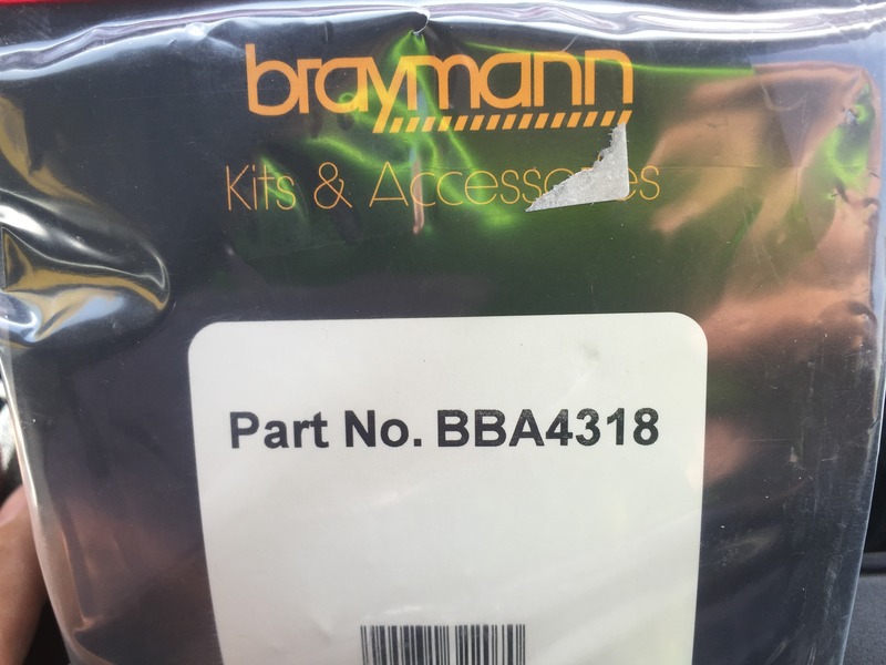

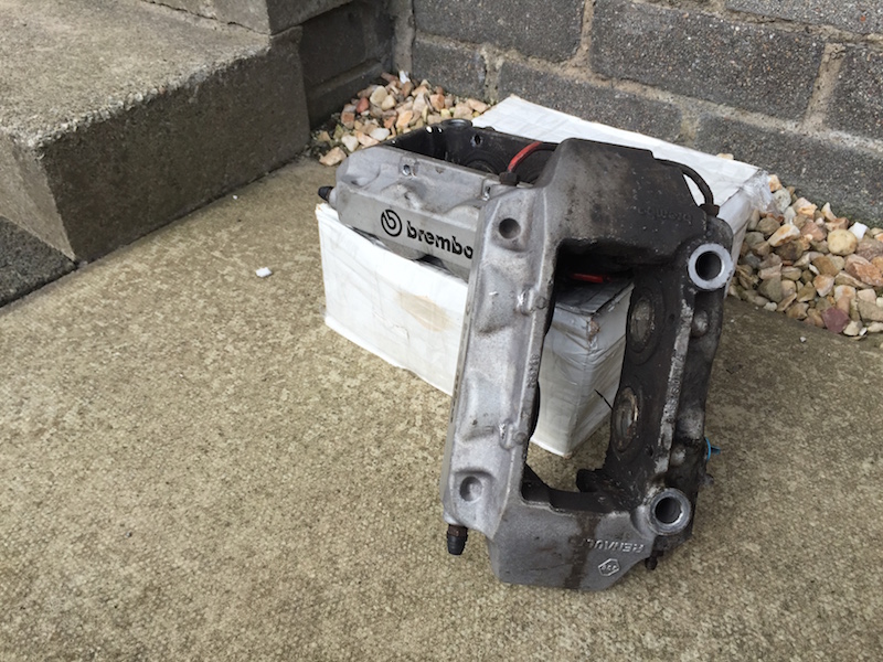

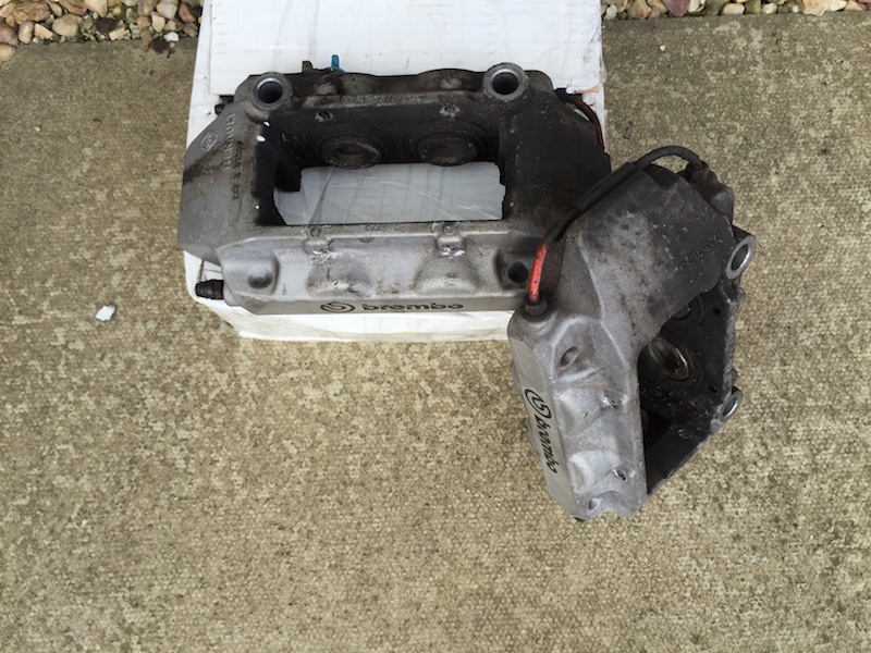

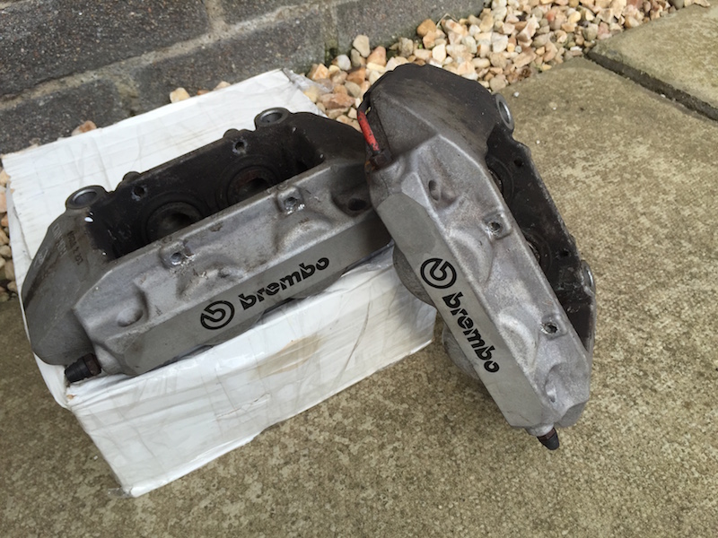

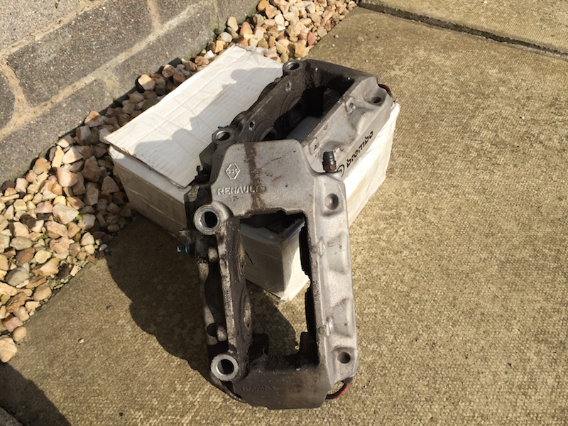

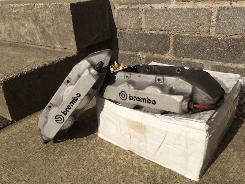

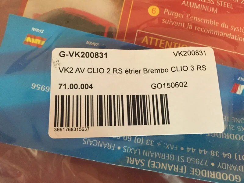

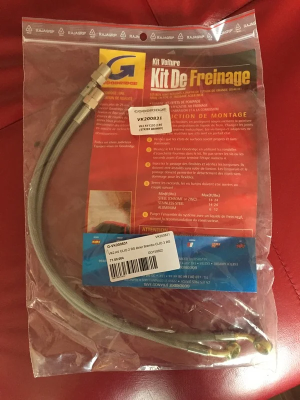

Small Update on this.

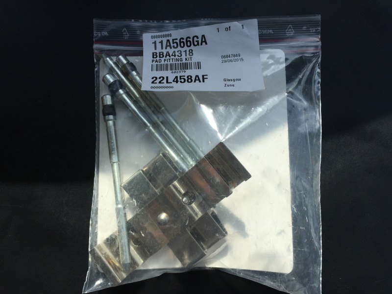

Managed to get my Pad fitting kit and the Clio 3 197/200 front brake lines.
Pad kit was £6.00 all in
Brake lines where £40 all in including postage from france and they are genuine goodridge lines also.

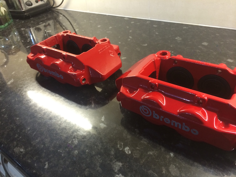

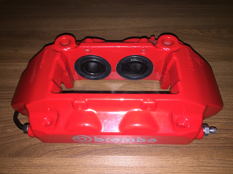

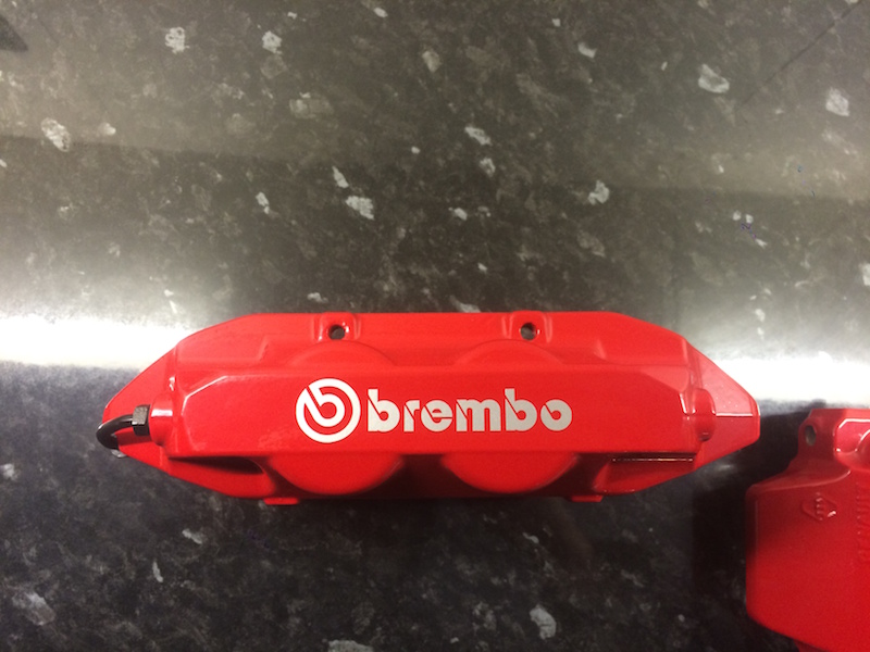

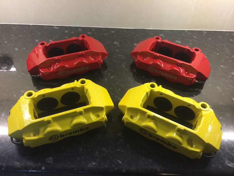

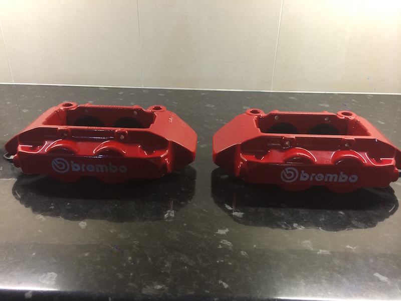

  182 Trophy
Coming along nicely! Another nice upgrade for the Trophy.
What colour will you be getting the calipers done?

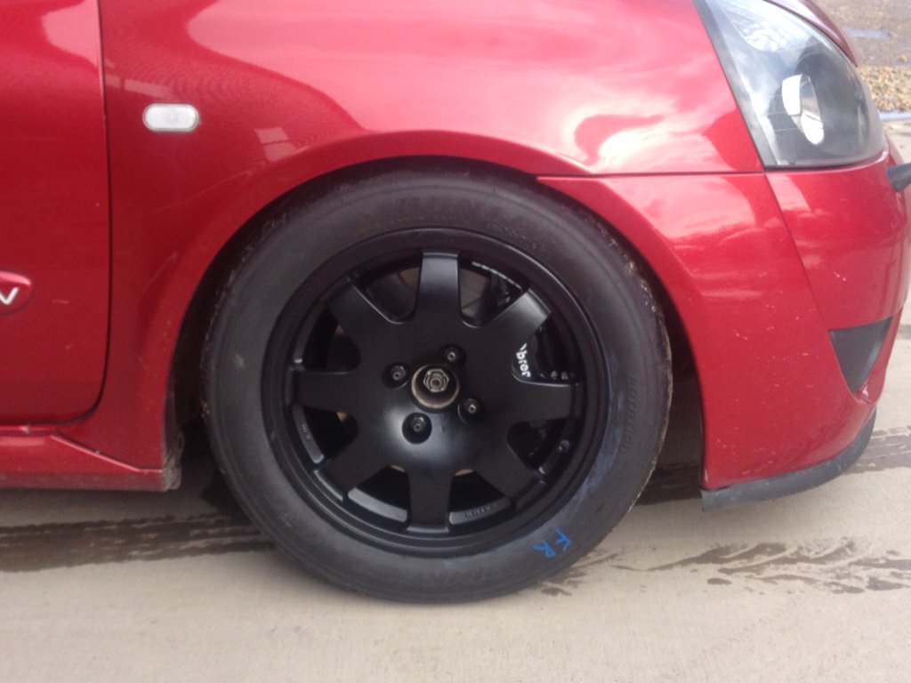

They look very nice now they're all done, pity these wont fit under 15" wheels they would be ok for track car.
They will fit under certain 15's, but you'll need spacers.
Indeed they will. Here are mine, with 16mm spacers, machined and with the roll centre kit and 15" Willys wheels. They won't go under OZ F1s. They go under TD 1.2 and 2118s with the right offset. With the track mine is now running, it has needed a very tight set up to stop it rubbing and also the clearances between the caliper and wheel is minimal. Like 1mm kind of minimal......
