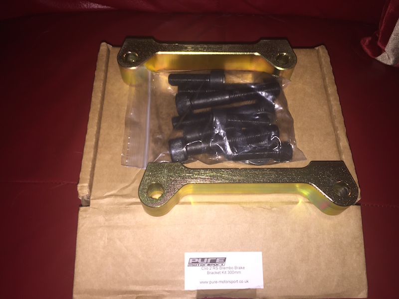

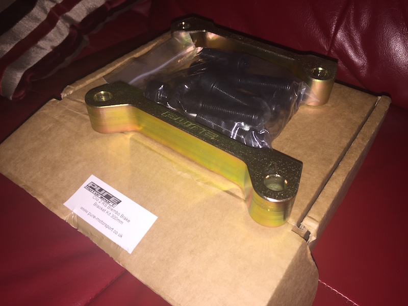

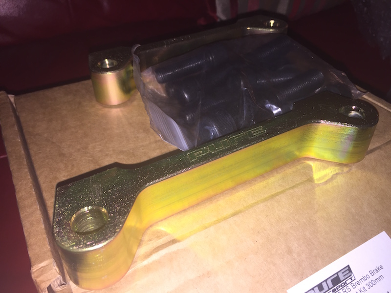

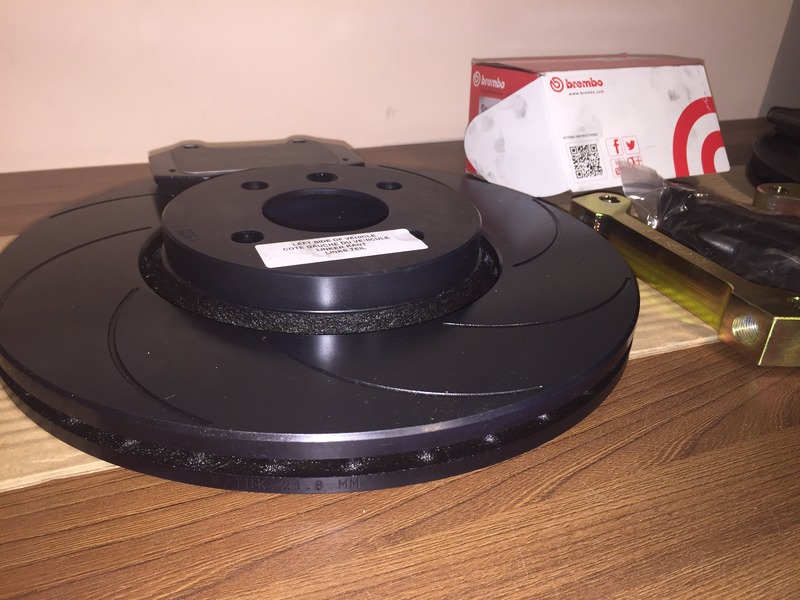

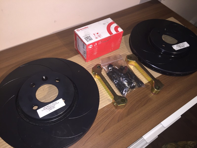

Well thats things almost at an end for the Brembos conversion.
Bought the following today
Pure 300mm Kit - £200
Brembo Pads - £19

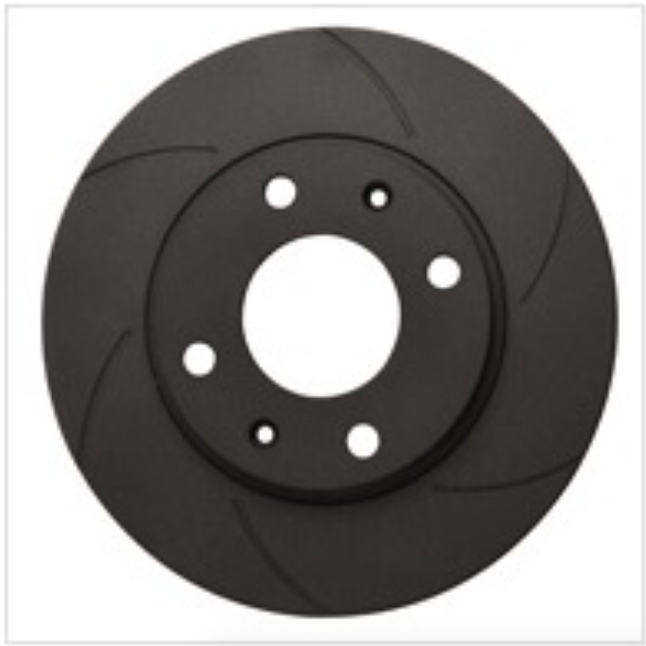

8 Groove & Vented Discs - Waiting On Them Arriving (Picture Below With 6 Grooves)

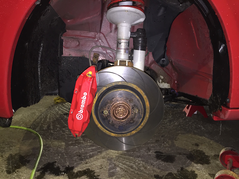

Worth mentioning that the black bolts in this pic do rust quite quickly. If I could go back I would give the heads a coat of paint.

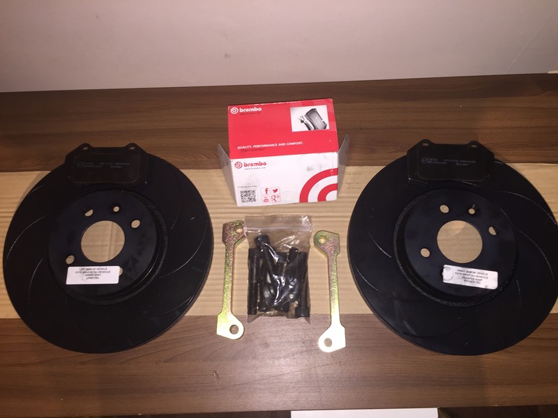

Pads , discs and adaptors are all here and well happy.
The pads where £19 notes and the discs where alittle more expensive as I got them fully coated at £65 the pair.

Its awesome when you have a completely brand new setup like that with everything new. Will look awesome when you have fitted it. Be careful with your wheels if you have wheel weights as I put my wheels on span the wheel and the weights smacked into the caliper.

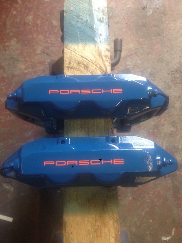

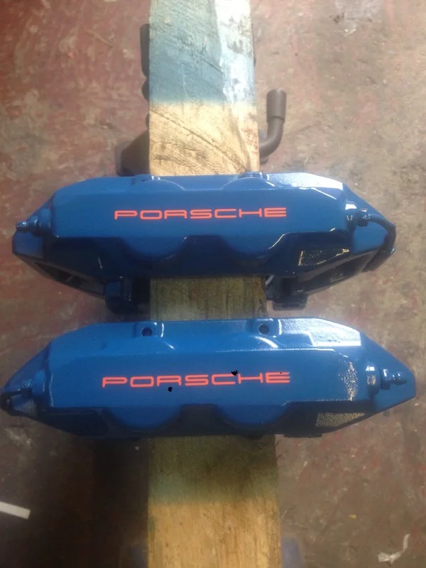

  Astra vxr
Love brembos. Iv just refurbed my Porsche calipers myself for my vxr and I'm looking for another set for my 172. Porsche and Megane and corsa Nurburgring all share the same caliper but Porsche seem to come up cheaper
If it's cup turinis you'll get away without any spacers.
