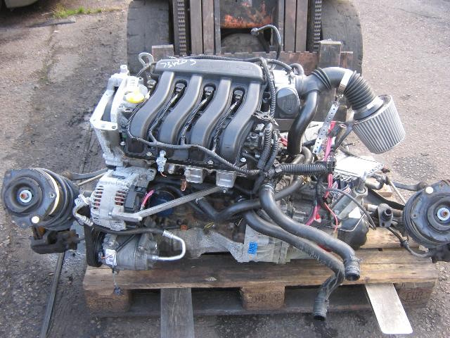

I have been looking at making quite a change to the air intake system on my car.
the first problem i have is that on the 1.4 and 1.6 engines the throttle body is at the back of the engine bay. so i was looking at getting a few samco hoses. but that was looking expensive.
Then i came across the inlet manifold on the new megane k4m engine with its side mounted throttle body, more like the sport.
http://cgi.ebay.co.uk/Renault-Megane-2007-ENGINE-1-6-PETROL-GEAR-BOX-/250555495247#ht_3634wt_939
I was just wondering if anyone knew if this inlet manifold would fit my clio as this new engine is also a k4m

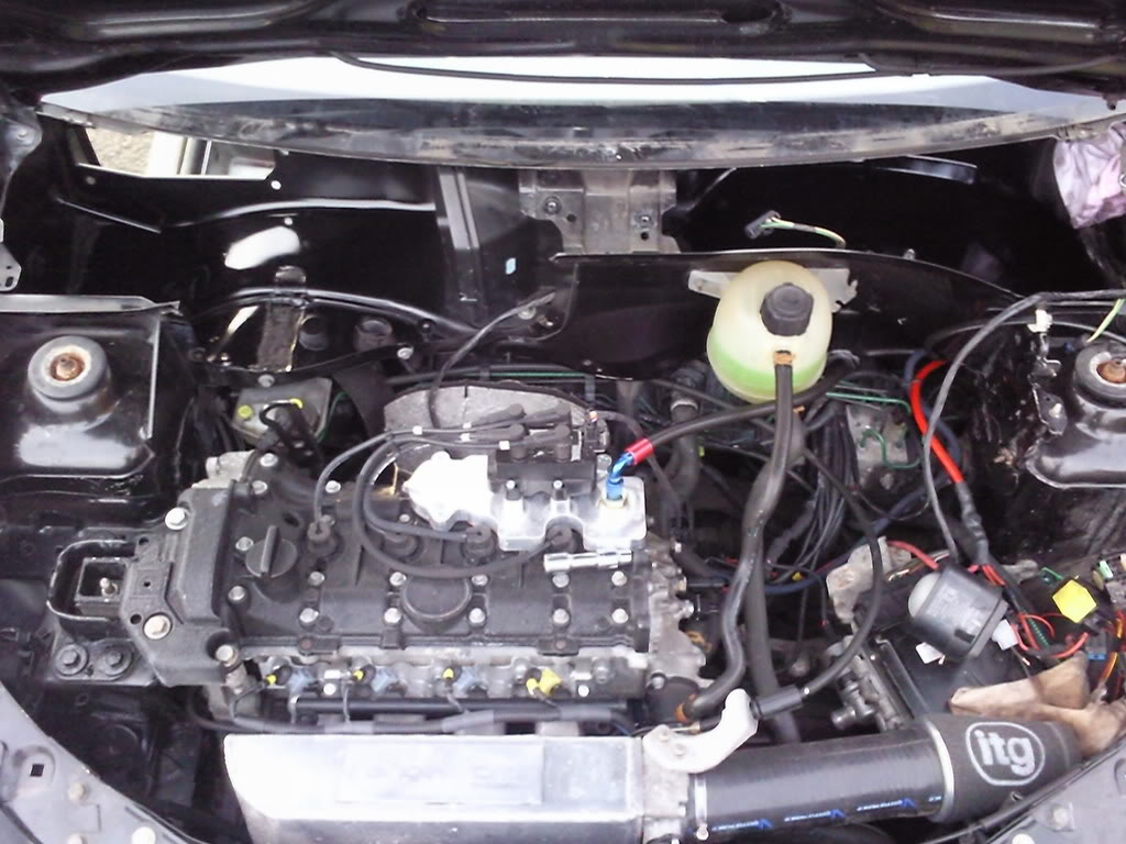

Buy mine and make an adaptor for your FBW throttle body.
don't use the twingo RS plenum. It just heats up the intake air too much. (city cruise ~30-40°C above ambient temp)
the "vent hole" isn't an oil breather, it's just a vacuum take-off that goes to the carbon canister. It's unimportant. There's a very small oil hole that you can just put a screw in
yes and the outlet for that is to the left (where the end of your arrow is), which connects to the cannistor.
