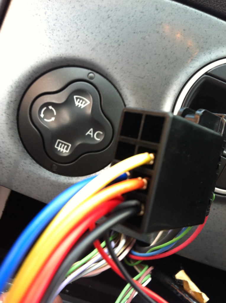

Took cd player out, wired up aux in and checked it was ok... Was fine, although it didn't charge (I'll ask for help on that later) but I figured that could be dealt with later.
Set away with ripping the centre consol apart to route the cable to the cup holder. did that. Refitted everything then started up the iPod again while I was putting the last bits away. Still fine. For whatever reason I started the car an the audio went funny :dapprove: it was hissing, breaking up (like on a phone call) and crackling
Uplugged it and plugged it back in. Still fucked.
Turned engine off. Worked fine.
Turned engine back on. Still fucked.
Any ideas? :(

the charging ive put down to
the lead is meant to charge apple devices but it doesnt.
the original loom has a wire in all 8 slots but this adapter only has them in 5... would these other wires charge the devices?

High pitched whine during engine on means a ground loop or a dry joint on the aux lead
The lead should be fully populated as the remaining wires are for things such as mute and speed pulse but wont affect charging
Checked fuse? Got a multimeter?
